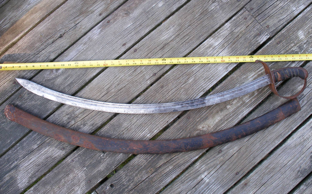

Question Sabre ?
This is a big one .
Scabbard is metal, no real Maker's marks, no wood liner; just a funny looking number ? on each side of the blade at the forte; one looks kind of like a 2 and the other like a 6 .
Wood carved handle with leather and wire .
Any ideas at all ??

Virginia Manufactory sabre type 2 (1803-20)
These were often shortened for Confederate use in Civil War.

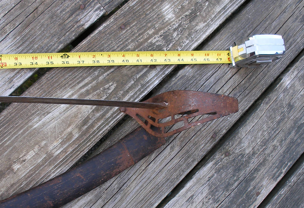

$35.oo!!! Must be nice! Beaut of a sword. The slotted side guard reminds me of the American naval cutlass of the same period with slotting to side guard.

Well, I was wondering about repro, actually .
The edge is rebated but this could have been done for display; no ? .
One hell of a distressing job if it is a repro; layers of rust .
The blade has great flex ....
[edit] If this sword is the real thing it was made between 1806 and 1808 .
Jim, this sword is huge; you need a quarter acre just to swing it . LOLZ !

Agree this thing is impressive, and when these were made swords were still very much primary weapons.....when these were called out again during the Civil War it seems they were shortened down. In my opinion this sword looks right, the rust on the hilt seems more recent, and the blade pretty clean, but the leather worn through on grip looks official. Incredible to find these kinda deals these days.......like the old urban tale of a lady who had a 'Chevy' in a barn for 50 years or some such...turned out to be a '54 Corvette with nearly no miles on it!

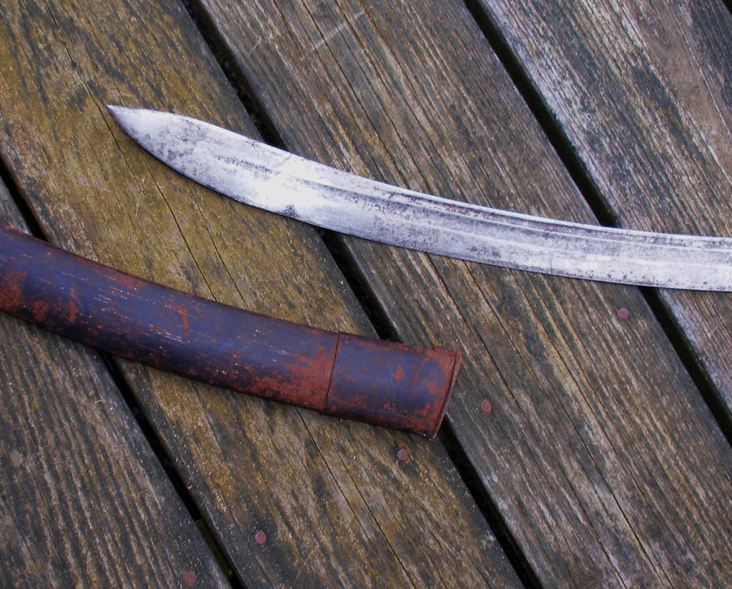

The scabbard seemed to have been japanned black from what remains of the finish . It is badly rusted .

Dmitry, I think the scabbard needs to visit a good autobody shop .
The area around the drag is pretty dicey .

I think it needs to be "messed with". It appears to have been in a humid environment. At least a good smothering of BreakFree CLP all over [but not on the grip!!!]. I would leave the bottom portion of the scabbard alone. It shows natural wear from being banged and stepped on, and is now paper-thin. Iron this thin is very difficult to improve upon.

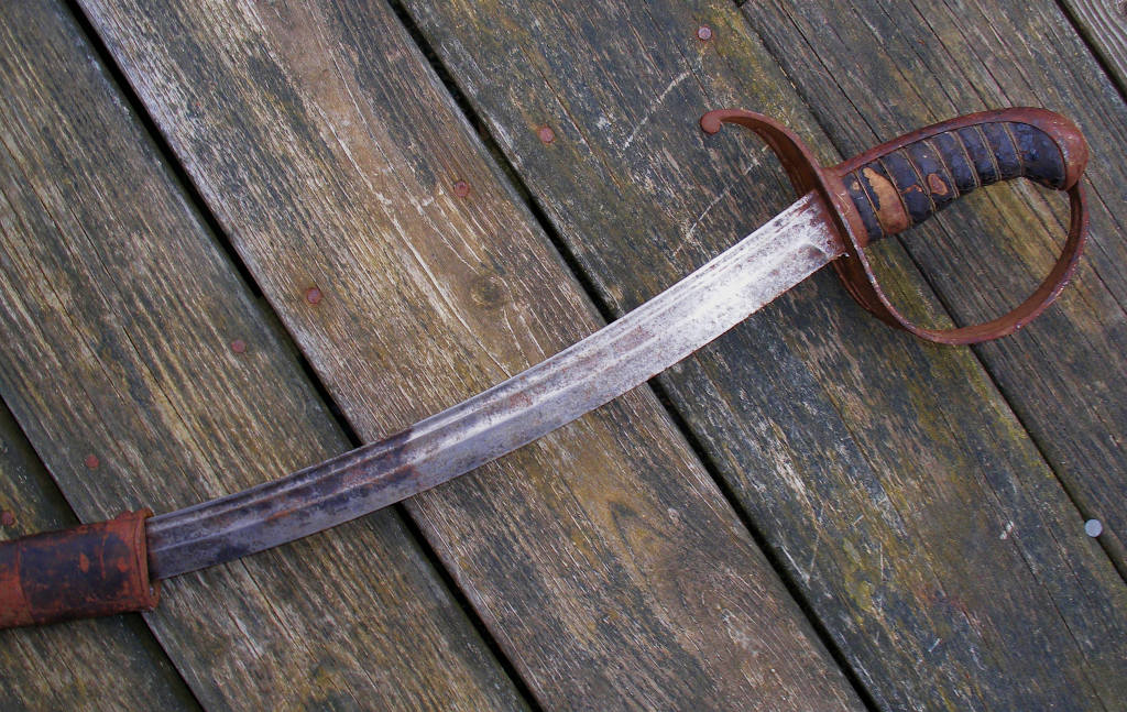

What is this about? Is it possible the edge was intentionally rebated at the time of manufacture?

Andrew, I have no idea why the blade is so dull .
Could it be 200+ years of being drawn and re-inserted in its scabbard ?
Guys, were these sabre scabbards saddle mounted ?
It is way too long to wear at the waist .
