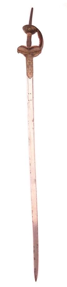

In a concurrent discussion on the 'jamadhar-kitari (katarah) daggers of Hindu Kush, the topic of fragmented European rapier blades used on katars led to a sidebar on rapier blade use in the pata and khanda of the Marathas.
From an apparently incorrect notion I had in place from a now forgotten source, I had the idea that the Marathas disdained the thrust, regarding slashing cuts as de riguer in their swordsmanship.
This led me to believe that post contact use of European rapier blades mounted in Maratha swords such as pata and khanda were more of a status oriented novelty for court type wear. This idea was influenced by the supposed European influence of hilt development from the traditional khanda to the so called 'Hindu basket hilt' from the hilts of European swords.
Since Maratha sword fighting technique was of course not aligned with European fencing, I thought that the use of a thin rapier blade would be unlikely by them. However, I have found examples of both these type swords mounted with rapier blades and clearly intended for thrusting in the manner of a 'tuck' (as described in Pant, 1980) or estoc.
On p.62, Pant describes the pata with a long, flexible 'regularly tapering' straight steel blade, almost always double edged and frequently of European make ...generally Italian or Spanish FLAT RAPIER BLADES.
Here there is some confusion, as often European swords with the heavier arming blades but having hilts as seen on rapier forms are termed 'rapiers' in narratives. In some cases there are blades with ANDREA FERARA inscribed of course spuriously, but these are typically Solingen produced heavier blades of the arming type.
Also in Pant (p.14) he describes the pata , "...sometimes we find NARROW bladed straight rapier with a gauntlet hilt. In this weapon British influence is visible". On p.70 he notes that after the British occupation of India rapiers became popular, and that the rapier blades were fitted to firangi and other Indian swords. In another note he states that 'INDO-BRITISH rapiers of 18th-19th c. have 'long heavy blades'.
So we have here a bit of a conundrum:
Did the Marathas indeed use pata and khanda with NARROW rapier blades in actual battle situations?
Or were the descriptions of Indo British 'rapiers' with arming blades simply termed 'rapier' in the colloquial manner previously noted.
As I mentioned, I have seen examples of the narrow blades mounted on both pata and khanda hilts, but clearly in seemingly considerably less common number.
What are thoughts here on this?

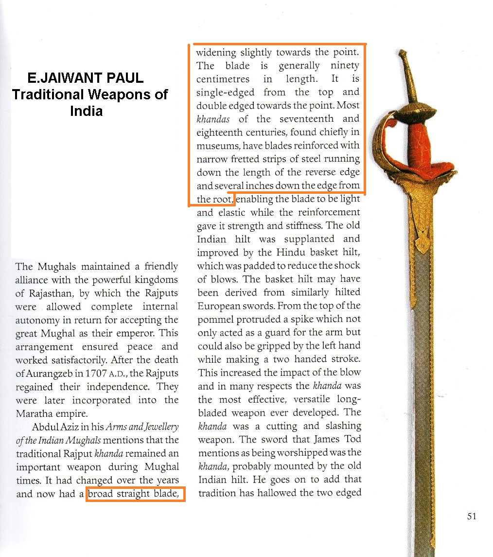

In looking at the khanda, it seems like the blades 'typically' end in spatulate (pattisa) and rebated or rounded tips, so the idea of slashing rather than thrusting does seem characteristic . The khanda itself was a very early sword type of course, which was revamped in the 17th century as the 'Hindu basket hilt', but its use extended from not only Marathas, but to Rajputs, Sikhs and Mughals.

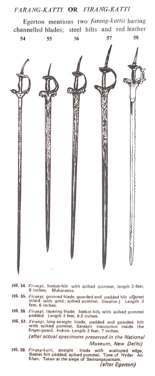

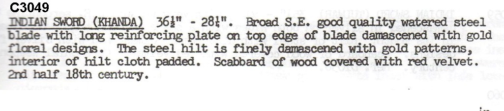

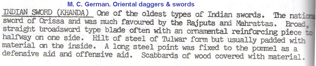

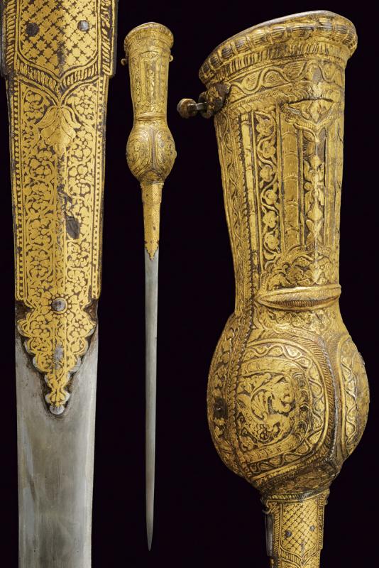

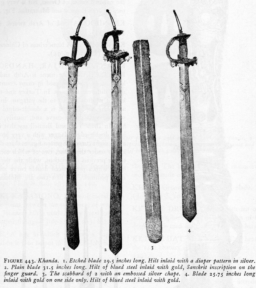

In Pant, there is another plate of khandas (attached here) where the thin rapier blade can be seen.
Also from "Arts of the Muslim Knight" (#66) attached is a picture of another khanda (firangi?) which is identified as a sabre(shamshir) ? and as a 'long sword with flexible blade for stabbing and thrusting'. While this is of course a 'basket hilt', it is clearly Mughal, as the inscriptions in koftgari are in naskh.
It would seem that obviously there were occasions for these 'basket hilt' swords, typically with extraordinarily long (over 3 ft. blades to nearly 4ft.) to have thin, flexible, narrow blades as in 'rapier'.
Clearly the Ottomans had some use for such thrusting blades, and India was not without influences from them.

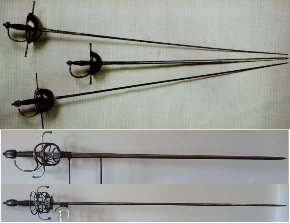

Have you a rapier, or ever had one, Jim ?
This is not the game game; skip over the etymology of the term and just ponder on what a rapier is. Not easy though but then, nothing is exact, and each one is the judge on his own right.
Forget Capoferro, Pallavicini, John Clements and all mediatic Gurus. Paraphrasing Judge Potter Stewart; i don’t know what a rapier is, but i know it when i see it.
Actually as the term rapier became a idolized at its, resistant countries (like Portugal) preferred to keep calling espadas (swords).
The rapier was a civilian sword, although apparently it is recorded that military regiments also used it.
Its blade could (should) be rather thin, even at times extremely thin, some with blunt edges. Some say they should be 2,5 cms. wide, although that is already within the range of a narrow sword blade; 2 cms. maximum being more within typology. But in the opposite, their narrowest section could reach 1 cm. thus touching the estoc range. My school fencing example measures 13 m/m in its widest square cross section. Only two of my eight cup & swept hilt swords are rapiers, for what i consider. Only three or four out of Eduardo Nobre’s collection he considers rapiers, those with blades width + or – 1 cms.
One thing is a narrow blade, another is an extremely narrow one. Same goes for flexibility; true rapiers, to my understanding, could not be extremely flexible, with risk not to do the job, which is perforating; notwithstanding some authors would admit they could also be used in the cutting but then, you are allowed to do what you feel like, and don’t go to jail for that. Same as with the pata; some say it could be used as a lance, but i don’t buy that, thinking is only authors imagination. Pata blades were bought (imported) with an intended flexibility, in order to slash as much as possible in combat; what Caravana calls arm abduction movement and Mundy’s considers them to be able to severe a bull’s neck. Furthermore, while katars could be mounted with European blade fragments (not my term) entire blades for patas were made to perform the intended purpose. But let me not talk about katars in this thread, with risk to be reprimanded for posting off topic material .

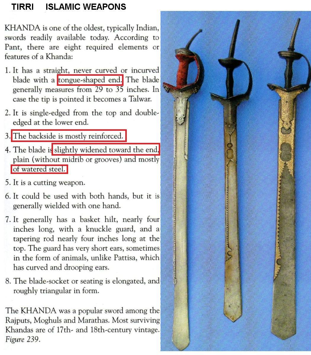

Khanda... What's in the name?

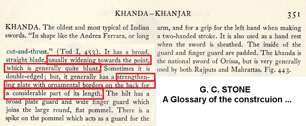

If we adhere to Stone and Rawson, then.. it is straight, has a a basket handle, spatulate tip, edge reinforcements with the resultant one-and-a half edge, etc.
However, here are 3 swords from the Elgood's Jodhpur book: all labeled as Khanda, all with " tulwar" 17 century handles, blades 16-17 century. One is single-edged, another double-edged, and a third one altogether saber-like. Obviously, he got the names from somewhere, and I tend to believe his veracity and judgement.
I was puzzled and asked him for an explanation. His response was that it was all in the local language use.

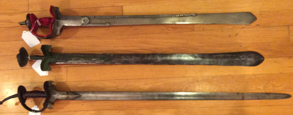

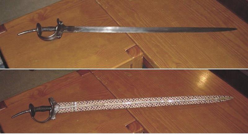

Kind of continuing ( this is more for Fernando).
Three Indian swords of mine.
Top to bottom:
Classical " Stone-Rawson-Pant's" Khanda
Khanda's old variant ( predecessor?), 18th century the latest, more likely 14-16th: it traditionally goes as Patissa in European sources.
The lowest one is Firangi with a European rapier blade ( see markings). In Deccan it was called Dhup, in Northern India it was Asa Shamshir.

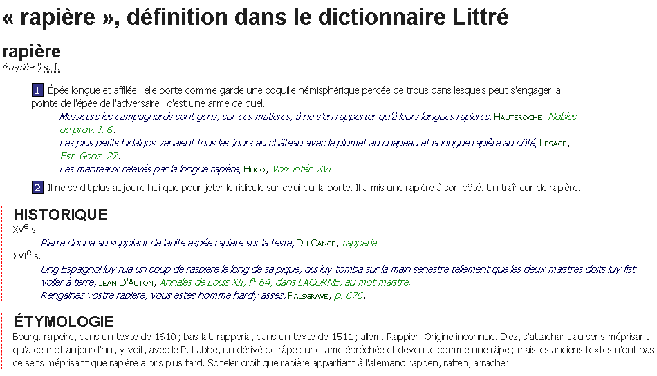

And this opens yet another can of worms: apparently, the word " rapier" was used in Germany, whereas in Italy, Spain and France the very same sword was called spada, espada and epee ( all of which meant simply " sword" in their respective languages).
These cut-and-thrust weapons ( broadswords?) were popular during the late Renaissance times, but in ~ 17-18th centuries got out of fashion and were replaced by a purely thrusting smallsword ( "court sword", "dress sword"),with a needle-like blade based on newer fencing systems. Despite being still called rapiers, they were not suitable for Indian use where a cut was the king. A minor modification of the smallsword's blade gave birth to Colichemard. Having deeply blued, almost black, handle the same smallsword was called in Germany Trauerdegen ( "mourning sword"), which is still in use in Northern Germany during funeral processions.
The bottom line, not only in India, but in Europe as well one encounters same weapon called by different names depending on the language, location, intended function etc.
Likely, the same principle was operating in India with Jamadhar, Katar, Katara, Narsing-Moth and Maustika . Bich'hwa, Baku and Vinchu are established examle. Probably, Chillanum and Jamadhar Katari might have followed the same suit.
Sorry for digressing from the topic.

... And this opens yet another can of worms: apparently, the word " rapier" was used in Germany, whereas in Italy, Spain and France the very same sword was called spada, espada and epee ( all of which meant simply " sword" in their respective languages).
... The bottom line, not only in India, but in Europe as well one encounters same weapon called by different names depending on the language, location, intended function etc....
I would definitely reduce the quantity of worms in what relates Europeans name ambiguities, when comparing to those in the Indian immense multicultural subcontinent. The rapier thing is an isolated case ... at least to support my theory .
As approached in my post #4, in a simplified manner, calling rapier a "sword" in the different idioms, was a reluctant way from fencing masters, or common man's uncertainty, to not address a weapon with such a 'fashionable' term, considering that its form in particularities was under competition, so to say.
I know your Portuguese is good enough to read that:
" É importante notar que a palavra "rapieira" năo foi usada pelos mestres Portugueses, Italianos, Espanhóis, e Franceses durante o zénite desta arma, os termos spada, espada e épée (ou éspée) eram usados normalmente (palavras genéricas para "espada") ".
To add that, even nowadays, calling a determined sword a rapier, is so often no more than a fancy (read appealing) attribution.

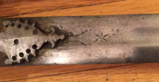

A pata I have has typical Solingen astral figures engraved on the blade, being another of these 18th century blades used on these swords.

While the most popular origin of the word “rapier” is traced to the Spanish Espada Ropera ( dress sword), there were opinions that it stemmed from Greek ραπίζειν “ to strike”, or French /English raspiere/ rasper “scraper or poker”.
Language is a powerful tool to confuse us. Not for nothing Divine creation of multiple languages ended human project of building the Tower of Babel and why Americans and Brits are called two nations divided by a common language:-)
Old 1st June 2019, 04:52 PM   #18
Amen to all that, Ariel.
I would add to the etymology quiz the suggestion by some dude called Scheler in that, the discussed term comes from the German rappen, raffen = snatch.
But, as in its genesis this sword style had about the same parameters in different nations, and their nationals adopted local idiomatic terms to name the thing, even possibly having given it a different use, evolution then followed its path according to each said nation's needs and imagination; civilian, military, cut thrust, whatever.
Not wanting to be tagged as a radical, i would not reject the perspective that traditionalists would decline the use of the rapier controversial term, despite the burden to spell out a couple describing words, to let know what they refer to.
In the end, the inexorable truth is that, before and after rapiers, swords remain swords.

In Pant, the plate of khandas I included with five examples (added below)of line drawings, the one on the far left seems to have a thin rapier blade, but this seems an anomaly or perhaps artistic license?
Rawson notes (p.23) that blades were intended primarily to cut, and only the Maratha swords influenced by European examples, which were given reinforced edged and basket hilts, seem ever to have bee conceived as parrying weapons.
While this suggests that European swordsmanship appears to have had distinct influence on the hilt, with addition of finger guard to complete the basket effect....and the bolstered edges which suggest same to receive blows in parrying.....it still does not seem the thrust was used. Again, this would negate the probable use of the narrow rapier blades.

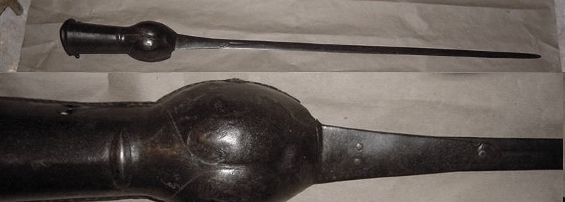

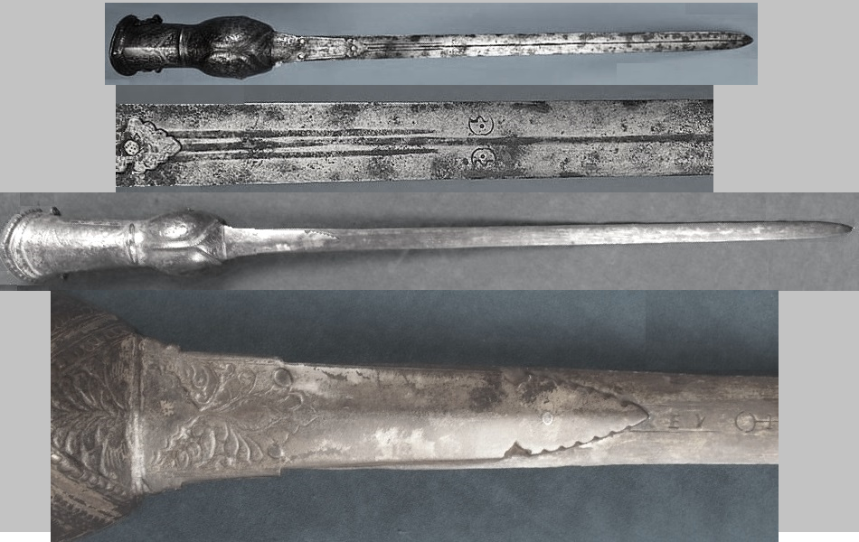

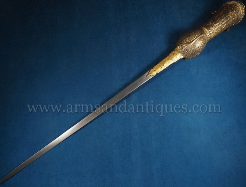

I think one thing this thread could benefit from is a visual gallery of sorts, like with the pictures that Fernando has already posted. This should help everyone get a better understanding of the swords that we are talking about, as no doubt everyone has a different image of with a specific sword looks like in their mind (I know I personally imagine a swept hilt when thinking of a rapier, but only nebulously imagine the blade as being long, pointy, and thin).
To that extent with a pata I personally have the image of a generic (flat/smooth) gauntlet hilt with a broad blade, as best represented by the first image I've attached below.
To somewhat diverge from my point, I feel like it is necessary to ask: has anyone seen a pata with a definite rapier (super thin & pointy) blade? I feel like the claim that "rapier blades were mounted on patas" can be debunked simply by a lack of physical, documented evidence of the practice. Though of course more swords have been produced in India than have been photographed, it is still valid (I think) to expect at least a couple of these "pata-rapiers" to be documented. More likely I think this is just a case of the previously discussed name-game, with the use of the term "rapier" meant more generically at the time, and only later misinterpreted by us forumites.
As a bit of an exercise, I'd invite everyone to post images of the closest thing to a rapier-bladed pata they can find - whoever finds one mounted with a smallsword blade wins! Of course then there will no doubt be the argument over how thin a blade can be to still be able to cut well in the "Indian style"
Either way, here's my pick (the second & third images) - a pata with a pretty decently thin tapering blade, allegedly native-made from the 17th century.
Nihl is offline   Reply With Quote

Posts: 10,851
Originally Posted by Nihl
Hi all,
Nihl, its nice to have you posting on this, and thank you for observing and reiterating exactly what I had queried in this thread in the beginning.....were there actually these THIN narrow rapier blades ever used in khanda and pata.

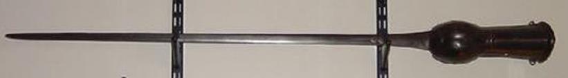

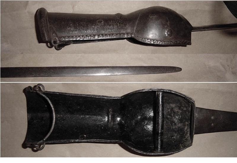

Old 5th June 2019, 03:40 PM   #24

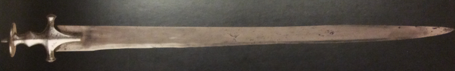

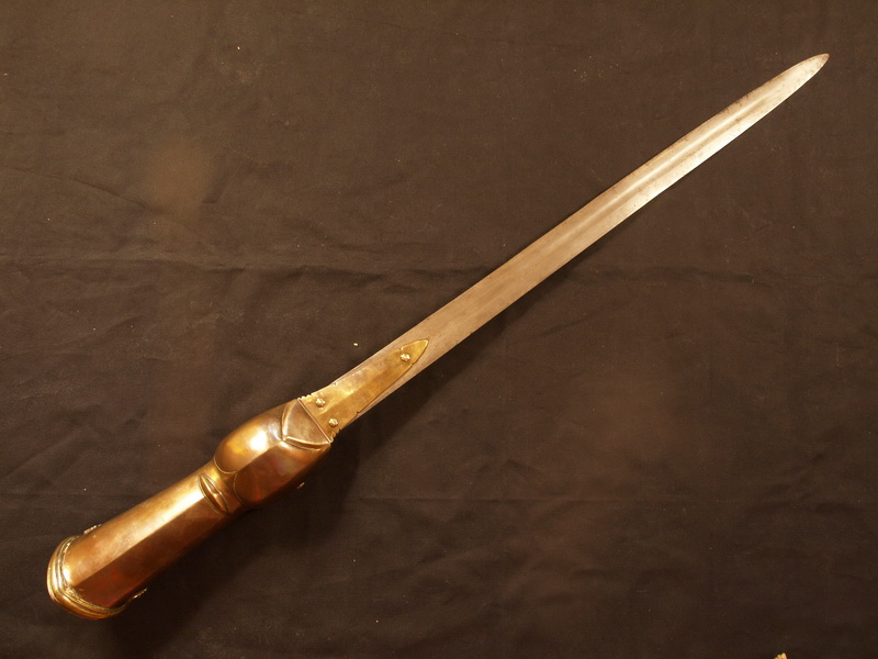

These are the pictures i can recover from the pata i used to have ...
Visibly a field weapon, not one for parade or big shot's show off.
A lenticular blade, not so sharp double edged, one fuller in the first third, slightly tapering towards the end, but not so pointy.
Length 96 cms. width 25 m/m. No marks.
This is to some, what would (could) be called a rapier blade. I will leave it to your discretion.
On a different note, one thing that occurs is that, the smith already has to have the blade in his hands to then design the 'forte' where it is going to be mounted.
