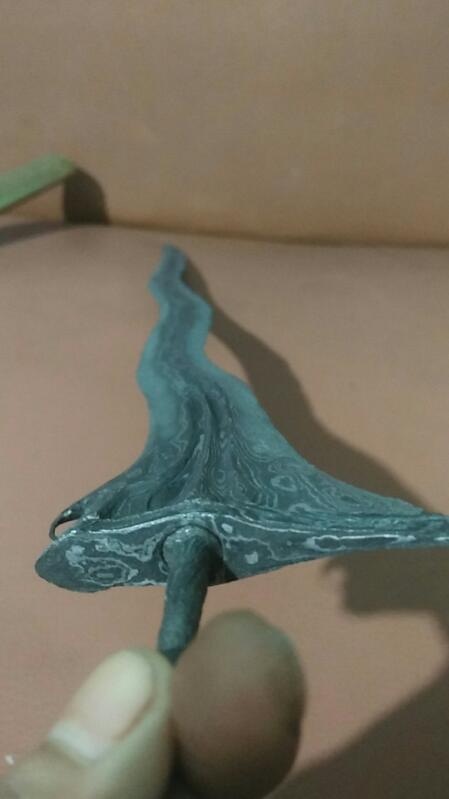

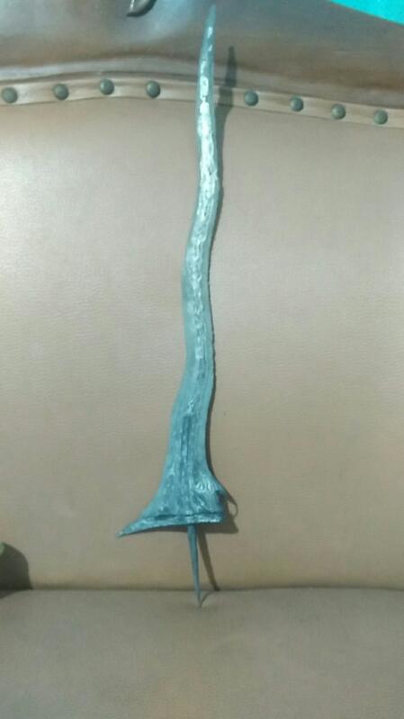

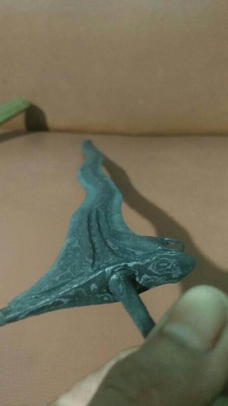

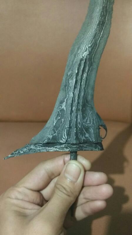

this is old keris..u can see the pamor all over from keris up to bottom..sometime i see new made of keris in java..that make difficult to analisis it.

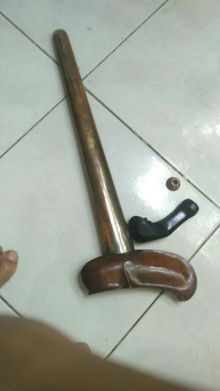

Hello ikkirosiki. I see you are new to the forum. I was new too, not too long ago. These guys here are awesome. When I look at your keris, I cannot give you much comment, because I do not own many kerisses and I do not have much to compare. Your scabbard looks Balinese to me, but I could be wrong. Your blade looks very good, but I'm easily impressed due to my poor experience. I'm sure the other collectors will come around soon to say something.

To address Johan's observations, this is a Javanese keris and it is dressed in a Surakarta sheath and hilt. The sheath is in the gayaman style meant for everyday wear. So nothing Balinese about this keris at all really.
The blade is a decent one, but not particularly special. It seems in fairly good condition though it might be nice to see it in full stain so that the pamor pops a bit more.
