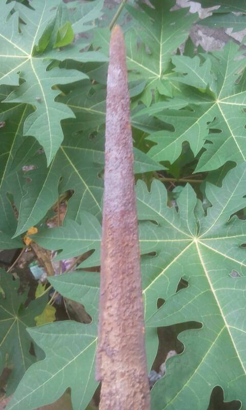

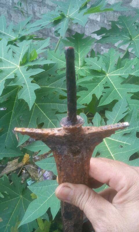

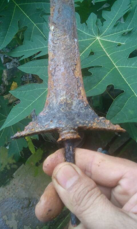

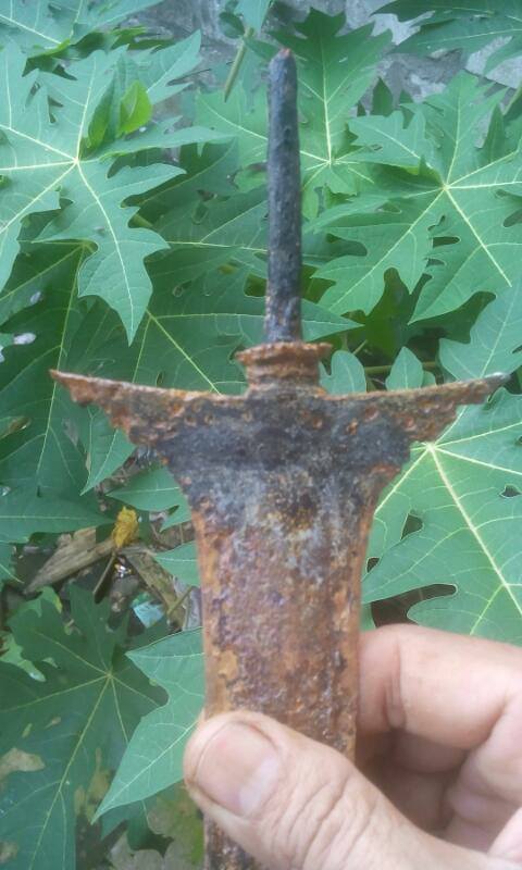

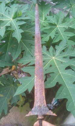

I made this thread for discussion about this keris. Well to be honest, I just read Alan's site and read about relief in ancient temples in Indonesia
here's another keris with mendak fused to the blade, it is said that this type of keris is very old. Kabudhan / Singosari era
but as we all know, we have to treat all stories from the owner with a pinch of salt
this one is said to be found in river deposit, I notice the similarities with keris in the relief pictured in Alan's site, just this one is more slender. The ancient keris looked symmetrical in appearance and kinda like Sepang dhapur like this one
any comments ?
and as usual, enjoy ...

Round pesi Donny?

Same sort of stuff as the previous ones? Look at the greneng.

Look at the whole thing Jean.
I'm amazed --- but please don't ask me why.

Are we supposed to believe this is "ancient?"
Are you testing us or what?
I do not know almost anything about kerises, but I am pretty sure this is a FAKE antiquated piece.
PS: This is from the same cheater like the previous one. The same manner of taking photos, the same "escavated" condition of the kerises and... the same leaves in the background.

Round pesi Donny?
looks like it, Alan ...
there are some clues I am currently looking at :
1. the corrosion rate of something on submerged for hundreds of years should be more than that
2. the shape of the blade is too long, as I believed that blade from kabudhan era should be short and stout
3. the fused mendak and the remnants of wood on the pesi is somewhat dubious
4. should the pesi be square ??
note that during my journey, only ONCE I held a true kabudhan keris, of which I thought to be genuine. I treated all other as "possible fake"
but I may be wrong
Donny
