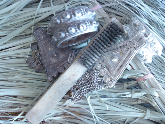

The Omani silversmiths use a stiff brass bristled brush for cleaning silver like this..
That is interesting Ibrahiim, that such a stiff brass bristle brush can be used. I've seen some silver kits, like Hagerty that come with a horse hair brush. I can see the brass brush is used though for more heavily oxidized/tarnished silver.
