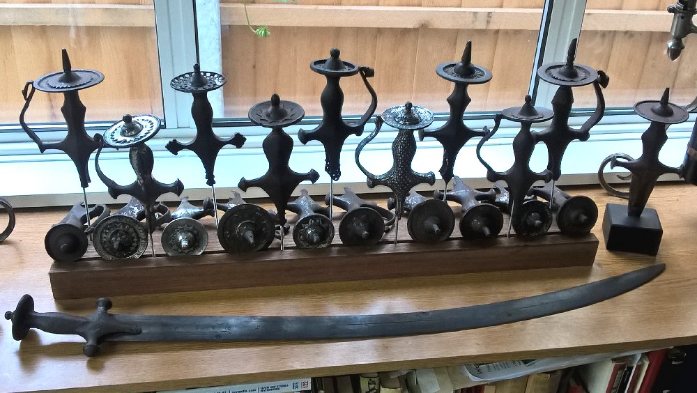

There are literally dozen of Tulwar handles on e-bay: day in and day out.
All look old, most are simple, but quite a few have traces of silvery decoration.
About a third of them have no saucer-like pommel.
This epidemics started about 3-4 years ago and is not abating.
I am wondering: where are the blades? What is the reason for such an abundance of old handles? Why no pommels?
Any inside information or just a supposition?
Thanks for enlightening me.

Ariel,
Someone once said, I have forgotten whom and when, that in the armouruíes many swords were not put together - for fear for an uprise! So they should only be assembled should a war be close! Sounds strange to me, as they were in a guarded armoury.
The missing disc on so many hilts is a big question mark to me as well, but someone (Tilly?) wrote that it had something to do with the hand size. I cant answer thais one, but to me it sounds very strange that a rather big number of these hilts should all of a 'sudden' turn up on the market.
I never visit e-bay, so I dont follow what is going on there.

In accord with Jens' note here, it seems to me that armouries were often the place where swords were assembled as required for rank and file, and perhaps even other categories. We all are well acquainted with the fact that blades were typically a separate commodity obtained through various means. Meanwhile, hilts, particularly tulwar hilts in India, were produced often en masse and distributed sometimes widely to other areas where often local decoration may be added.
I recall many years ago Jens mentioning this suggestion of tulwar hilts being stored unmounted so as not to furnish serviceable swords readily in case of insurgence, however that may have simply been presumed by British officials as these arsenals were inspected during the Raj.
It does seem that just as stockpiles of blades have often been discovered, such case might be with tulwar hilts in some degree as these as mentioned were often produced (particularly in Rajasthan centers) and distributed to other regions.
The case for hilts being dismantled for either valuable decoration or precious stones obviously is well known, but that does not sound particularly like the situation with the examples in question.
The pommel disc dilemma is another which has defied any plausible conclusion, just as the hand size lore pertaining to Indian hilts. It does seem that a removable disc option could have been feasible, but that is far from proven in most cases. It does seem I have seen tulwar style hilts which were without the disc (examples from Northwest Frontier regions) but cannot say whether they had been removed or never were there in the first place. It was said once in conversation to me that size of hands in Afghan areas tended to be larger, but that sounded a bit arbitrary I admit.

The story of separate storage of handles and blades and the alleged reason behind it goes back to Fernando's recollection of his conversation with Daenhart who, while in India, allegedly heard it from a Raja of one of the Northern principalities ( name and location not mentioned) who told him the story and showed ( or was willing to show) separate storage places. It can be found in the Archives of this Forum.
I was unsuccessful in finding another source, but have no reason to disbelieve either informant.
If anyone here has good contacts with Daenhart, it might be possible to get additional information.
Many examples on e-bay still have mastique inside.
Tirry had a single example of a pommel-less handle, but contemporary e-bay is chock full of them, all coming from India.
Quoting Churchill, "It is a riddle, wrapped in a mystery, inside an enigma; but perhaps there is a key. "

Taking a trip back to Birmingham, England between about 1958 and 1970, a major, very well known UK antique weapons dealer was using the mechanical damascus and wootz blades from Indian tulwars to create blades for well made but very fake Indian daggers.
At that time there was no internet and no international exchange of information, these daggers appeared in auction houses all over the world, they appeared in the catalogues of reputable dealers, they now rest in old collections.
When the Indian craftsmen caught on to what those Evil Englishmen were doing --- well, goodness, gracious me, they short-circuited the process and began turning out even better daggers than the Englishmen did. These Indian productions are still floating around and occasionally will be seen in most unexpected places.
I wonder what happened to all the hilts from those tulwars that were cut up to make daggers?
People tend to forget just how cheap tulwars were in the 1970's and 1980's. In the early 1980's I could buy Indian tulwars from dealers in Australia for prices varying from $5 to $25. Not masterpieces to be sure, but good, solid weapons with well made functional blades.

Regarding the missing blades in the original question, I remember reading somewhere on this forum that after the Indian Rebellion of 1857, thousands of Tulwar blades were destroyed by the British troops, many by being dumped into the ocean.
May this be at least a part of the answer to the original question?!

When you write about the weapons dumped at sea, I think you are thinking of when the Muhamedan Coorgs chopped the English magistrate down on his veranda in 1884. At that time more than 15'000 weapons were collected and dropped at sea - only few were allowed to enter into museums.
Otherwise the English mostly melted the blades down.
I dont know how comon it was, then, to keep loose hilts and loose blades, but in Memories of the Jaypore Exhibition 1884 Hendley shows five or six loose hilts, so maybe they did this to a certain extend.
Richard,
I too dont understand why they dont remove the blade, why they have to break it? Maybe it has something to do with the weapon laws in India, or that it is easier to send - as the weapon is shorter?
I dont really know, but it is a very strange thing to do, as they would get more money if the blade was intact.
Does anyone know how the white arms law in India is?

I have been told that any sharp blade longer than 9" is considered a weapon and strictly prohibited in India. That's why all the newly made replicas have a dull edge and that's one reason why I couldn't find a single genuine sword at any of the antique dealers I have seen.
However, this is anecdotal and I didn't check the Indian legislation myself.
As with regards to the swords dumped in the sea, I don't know anything more than a vague memory about reading somewhere here on the forum about such an event, and it might be the one you mentioned.

It seems not too long ago, it may have been posted here, there were a number of historically valuable very old Indian swords, including khandas and patissa forms. These had blades cut off about 1/3 down from hilt. They were well patinated, and sold in an 'as is' lot in an auction.
While no provenance was noted, it would seem these may have been in a small arsenal or store of weapons, and as they were important traditional arms, their retention may have been allowed if they were neutralized.
This is contrary to the outcome in the well known larger armouries where select weapons were held aside but the bulk were destroyed as scrap .
The items being dumped at sea were described in Robert Elgood's book on Islamic firearms but reference not handy at the moment.

One other possibility, which has not been mentioned above if I read correctly, is that these (or at least some) are modern made and aged copies. I have an Indian friend who has said to me that I should NOT buy anything from India described as "old" or "antique" unless I have watertight provenance. His comment was that India is the new China in terms of copies. This of course is not necessarily an all encompassing statement, but simply that extreme care should be taken when buying "old" items.
It should also perhaps be noted that there are, from time to time, many "old" and "antique" powder flasks being advertised from India, "made by" such well known makers as Hawksley etc.

''' The main charateristic of this arm is little known, but rather interesting. Apart from individual arms that were manufactured for high rank personalities, more simple tulwars were also produced, in large quantities, for the Sovereigns arsenals. Invasions, popular insubordinations and palatial revolutions were very frequent. Few were the Sovereigns that dyed of natural causes. The state of war between ones and others was a frequente situation. In this atmosphere it became obvious that the possession and access to the arsenals were a preocupation of the greatest priority. A system was invented that impeached the possibility of using an Indian arsenal from one moment to the other. The handles of tulwars were built in metal ( usually iron ), joining guard, grip and pommel in one only piece, which doesn't happen in the majority of white weapons of other origins, where all these components were separated one from eachother. As tulwars handles were one only part, it became easy to join all these in one arsenal ( we are talking, in round numbers, in the order of the one hundred thousand handles ), and build a tower where these could be well kept with "seven keys" ( my commas , for a Portuguese figure of speech ). In another tower, distant from the first one, the respective blades were kept. When a sovereign decided to invade a neighbour country or prepare himself to defend his own, such event would be known within months of antecipation, which allowed for the mounting of the blades in their handles. Such blades had a short tang, which was neither peened, screwed, or stuck by a pin. To couple the blade with the grip, the late was turned upsidown, pouring in into his hollow part heated pitch, therefore liquid, as the blade was inserted. Once the pith cooled down, the blade would be fixed enough for battle, during years. In case it started to oscilate, the fixing system could allways be repeated. A strategic Sovereign would know how much time he needed to mount his army weapons and, taking precaution, had his arsenals ready in due time for the distribution of tulwars. In case of a mutiny or a palatial revolution, there was no time to mount the tulwars, in a manner that the arsenals were relatively protected from improper utilization.'''

Concerning the tulwars being stored in separate places, he stil assumes what he has written in the book. But i have learnt that he was referring to a specific case, and not to generality. In one of his (three?) visits to India, around 1970, he met a certain Maharaja in the north whom, at time of visiting his arsenal, asked him whether he wanted to see the blades first, or the hilts. For the case, they were kept in two towers, located about one kilometer away from each other.
The reason explained for such attitude was the one we already know.
