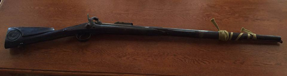

First post here and its been a long time coming. I picked up this rifle at an antique show last fall and have been curious of it since, I got it for a price im alright with but id like to know more about it, possible age, origin etc, or if its just a fake. Its smooth bore with a flip sight which is my main concern it could be fake or the sight added later, however the barrel and cap lock are very pretty if it is. The item is at my parents house as of now so any further pictures than the ones i provide might be a while in coming. If anyone could help me decipher this thing I'd really appreciate it. (the wrap near the muzzle is a piece of cord to hold the metal cap at the end of the stock on, the tacks had wallowed out long ago and the gaffers tape that secured it when i bought it was not in any position to be put back after i removed it to examine the musket)
(edited so pictures will now hopefully appear)

here we go, hopefully they'll appear now

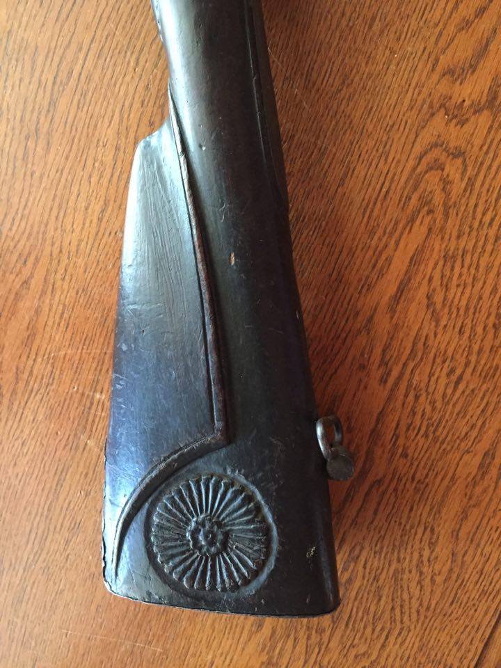

Very nice and interesting gun......the sling swivel and ladder sight suggest a military background with maybe some (later??) carving to the stock. The lock plate and barrel however do not appear to have a military origin, and show some nice decoration which looks to be very well done.
As to origin?.... well the "rosette" on the stock is found in Japan and India, and probably other places also, but design of this carving might just be coincidental.
You say you do not have the item to hand, but when you get a chance it could be worth removing the barrel to see if there are any Proof Marks present. If there are, then it is likely that (at least) the country of manufacture will be revealed.

the front of the wooden stock has a metal cover that covers the last few inches of the stock and a few foreward onto the barrel, and by the coloration there was a band there thats become lost over the decades. there is a plate on the butt of the stock as well, engraved with similar decoration as the piece on the muzzle end of the stock and as the lock of the gun. The rosette made me think Japan also but I dont know what a smooth bore gun of caplock style would be doing in japan, much less how it is covered in middle eastern or indian looking motifs and gold inlay Its really a mystery to me but then again, thats why ive brought it to this forum

The rosettes on engraved additionally on such stocks were common in Anatolya, too.

the decorations other than that seemed turkish or from that vicinity, from what I know and have seen on hookah pipes and other items from the area.

In North Africa too!
I bet this rifle is Persian/North Indian...

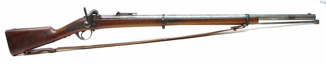

Hi Blacksmith.

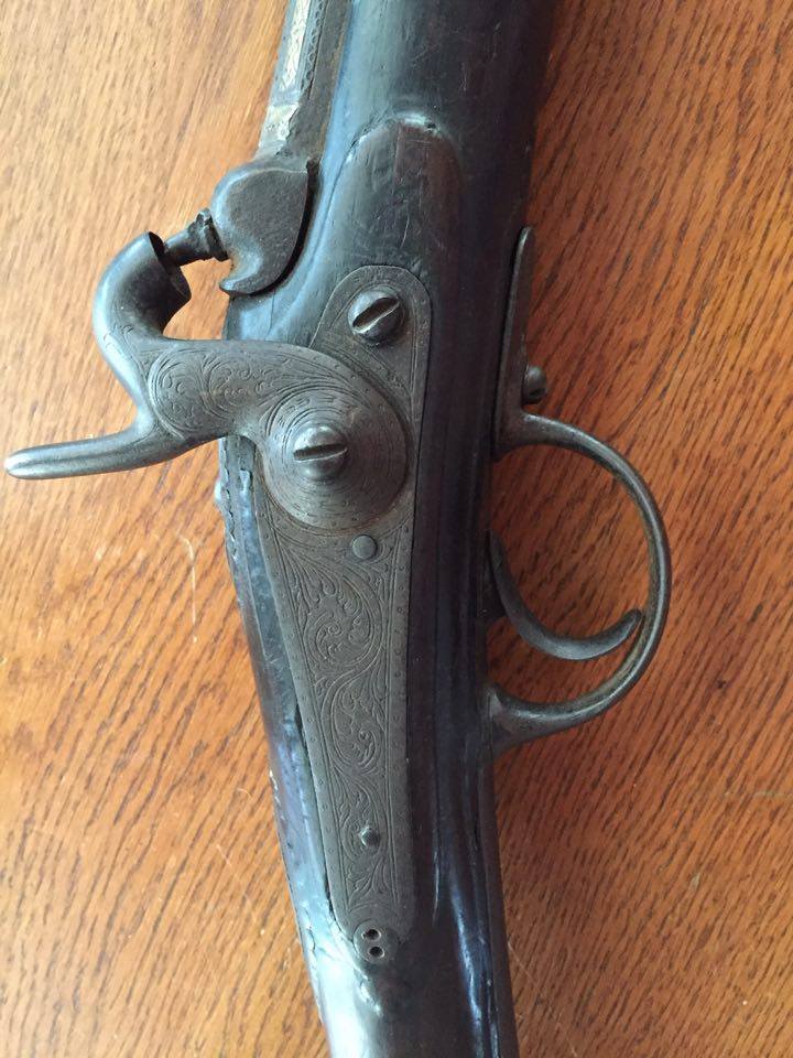

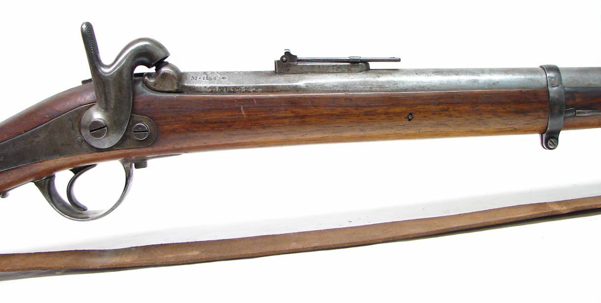

I think (?) the lock was from an 1859 French Service Musket, and engraved locally to suit the owner. See photos. And possibly the trigger, guard, and rear sight from the same musket. Maybe the Forum members from the European side can confirm this. The barrel and percussion bolster look to be locally made. And the stock made by a local gunsmith to suit regional/local taste. I'm thinking Indian or Afghan, and leaning to the latter. A tough call with this one. But also a very interesting gun.
It would be helpful if you could post some additional photos such as the trigger guard, butt plate, and that brass piece at the muzzle end. Also, the inside of the lock. There may be some ID on the inside of the lock plate, if originally a military lock.

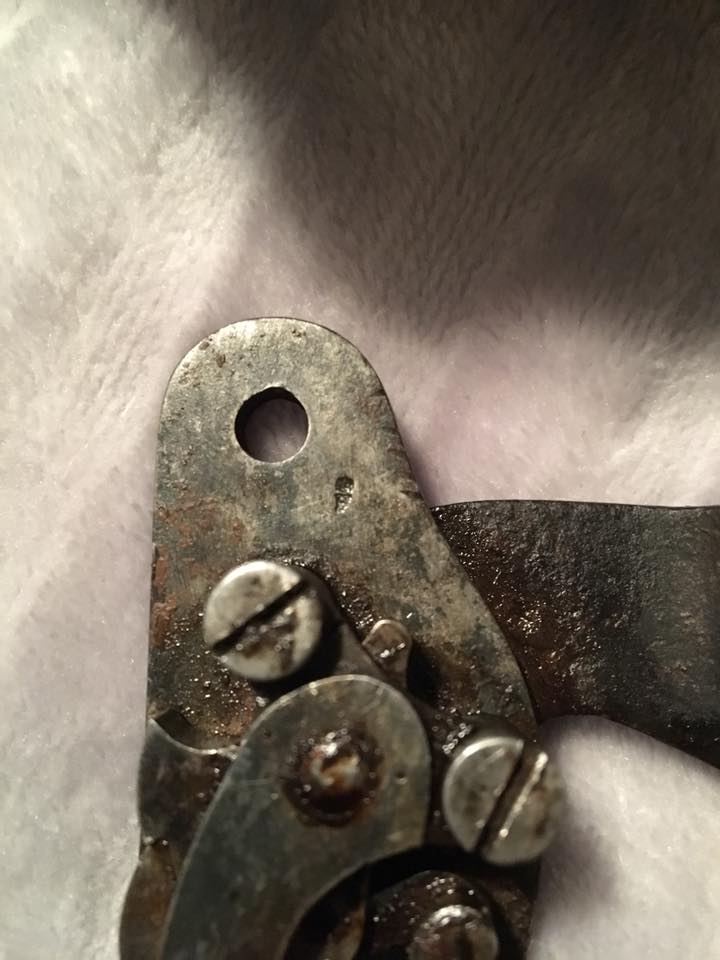

This is what is generally termed a back-action lock. What looks to be a screw with two little holes at the rear is likely not a screw, but just a positioning post. (don't recall the proper name) to help keep the lock in place. If you just put the hammer in half-cock position and remove the one large screw, the lock should just lift out at a slight angle. You will notice the reat of the lockplate will have a slot vs. a hole for a screw. Give it a try. Are there any screws on the left side of the stock ?

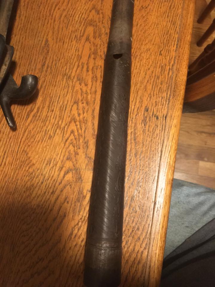

Long awaited pictures, and in reply to the statement about the lock lifting out, you were correct! it popped out. I cleaned it only slightly with a bit of 0000 steel wool, wiped wet, and then a wipe of oil, and im amazed at the beauty of this old rifle after just simply wiping way the surface rust and the crud that had accumulated over the very deep patina. the stock got a similar treatment with superfine sanding of the outer layer of dirt, and a good wipedown with oil. Its amazing seeing the dark patterns of use where the hands and cheek rested. There arent any screws on the left of the stock, however there is a roughly triangular lobed piece of metal recessed into the piece that serves as something solid for the bolt securing the lock to screw into. After it fell out while removing the lock, and knocking off a bit of dried something-or-other, there was a small hallmark of a crown with a W beneath it on that small metal piece.

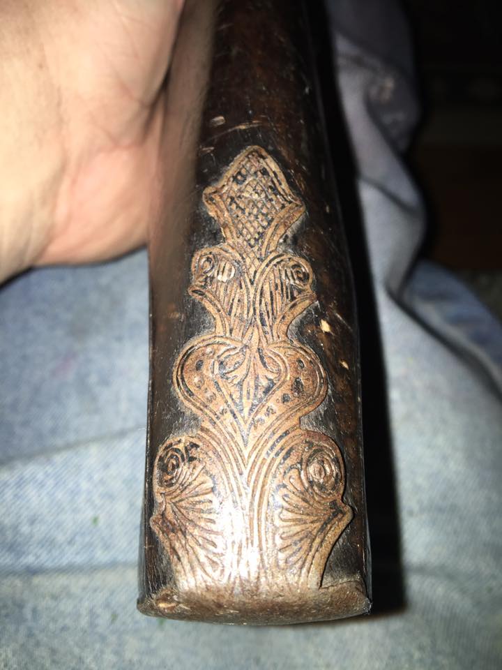

And now for the big event, some photos of various items. If all goes in order, the following show: the butt plate top. The plate itself is simple metal held by small nails around the perimeter of the butt of the stock, this piece folded over the top is the decorated bit.

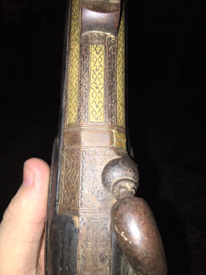

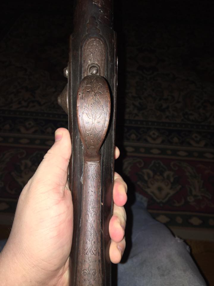

Next is the trigger guard decorations. If it helps to ID the gun, the guard removes by removing a screw in front of the trigger and the back of the guard swings out of a slot once the front is free.

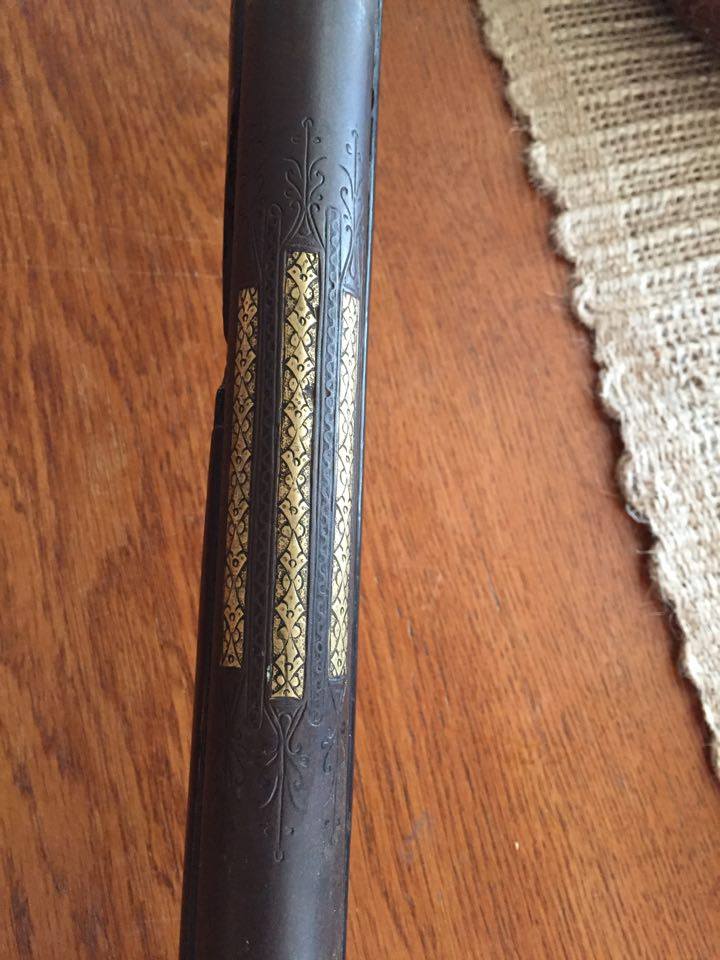

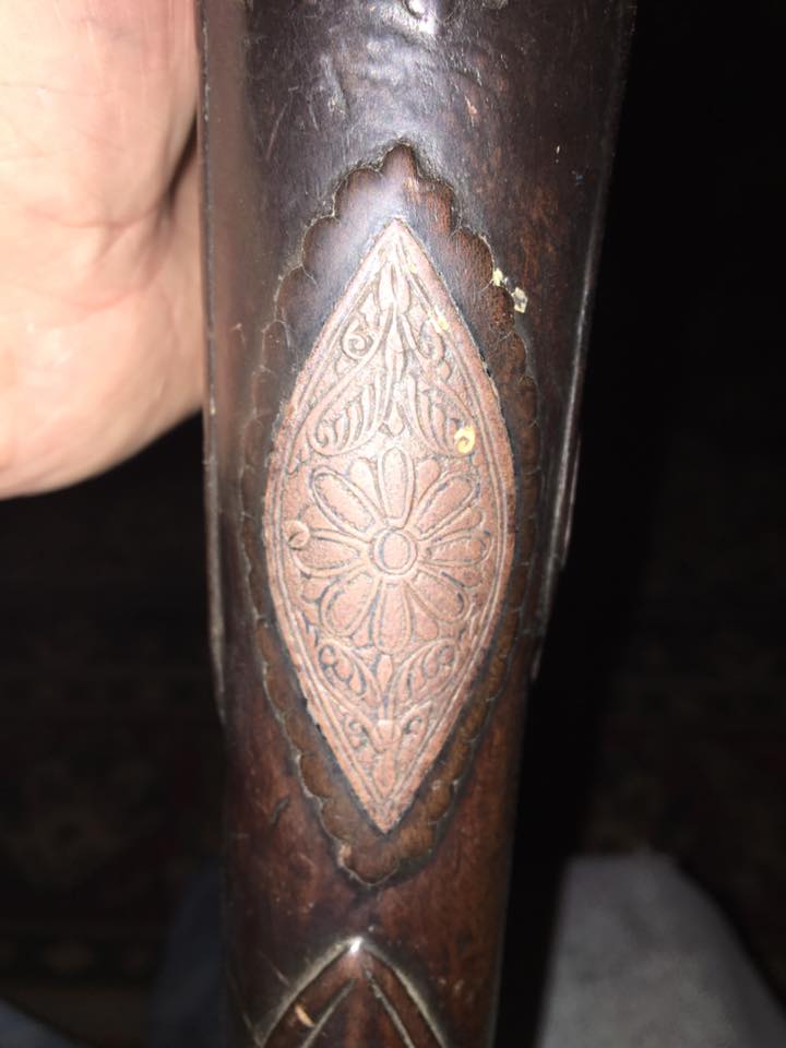

Next is a decoration on the grip area of the stock behind where the barrel screws on.

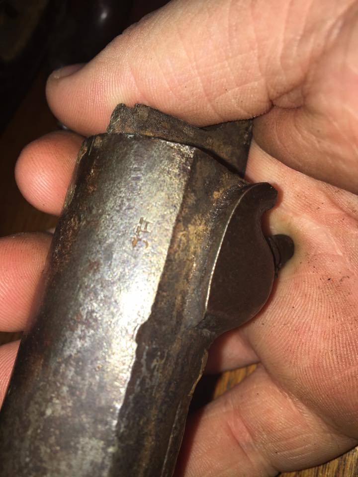

Following that is a view of the breach area itself,

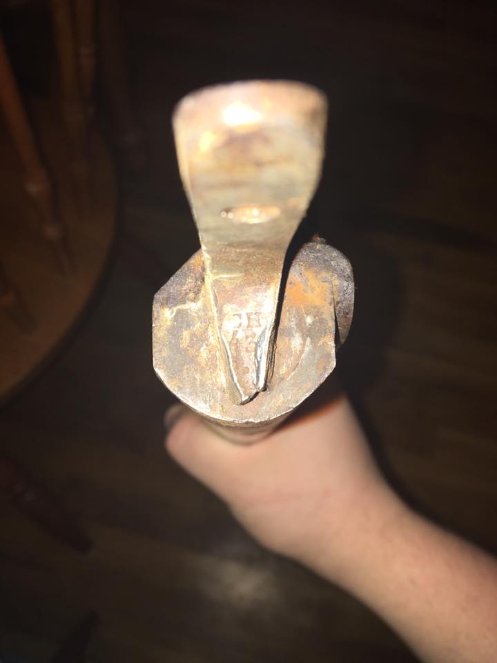

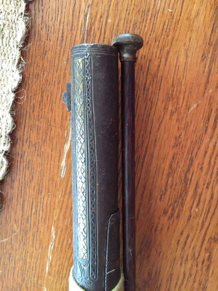

and finally there is an up close view of the metal sheath tht covers the front end of the stock and helps hold the ramrod in place

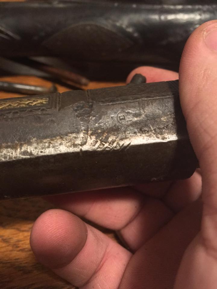

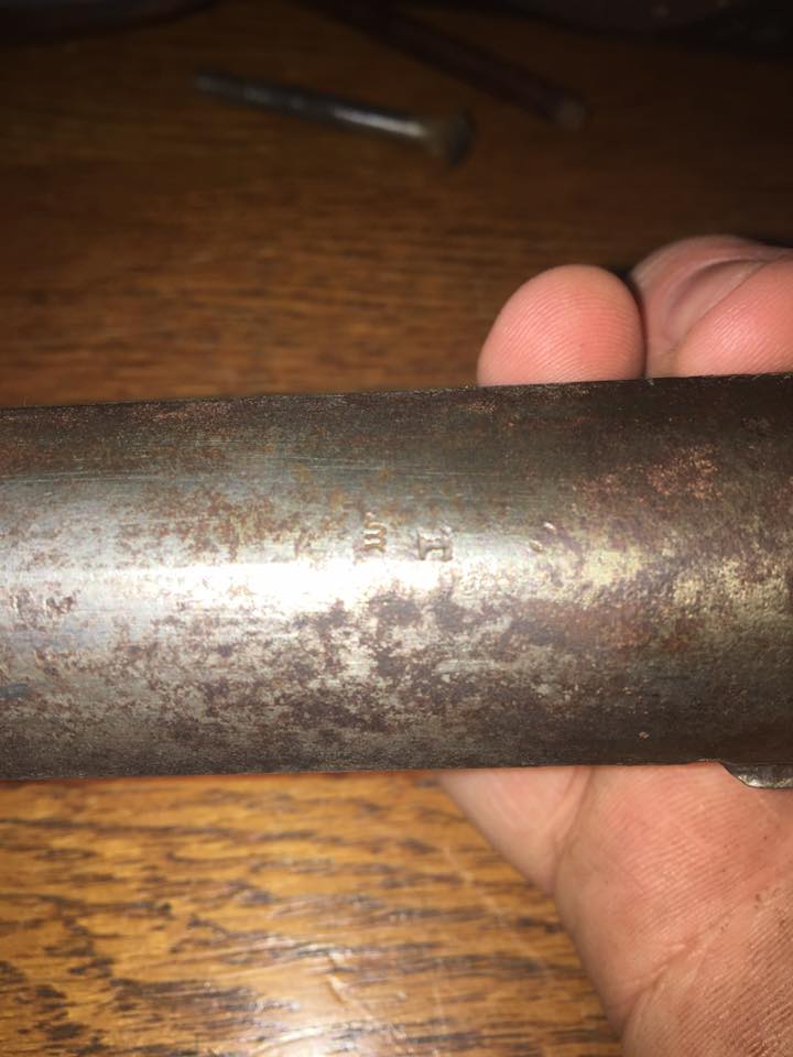

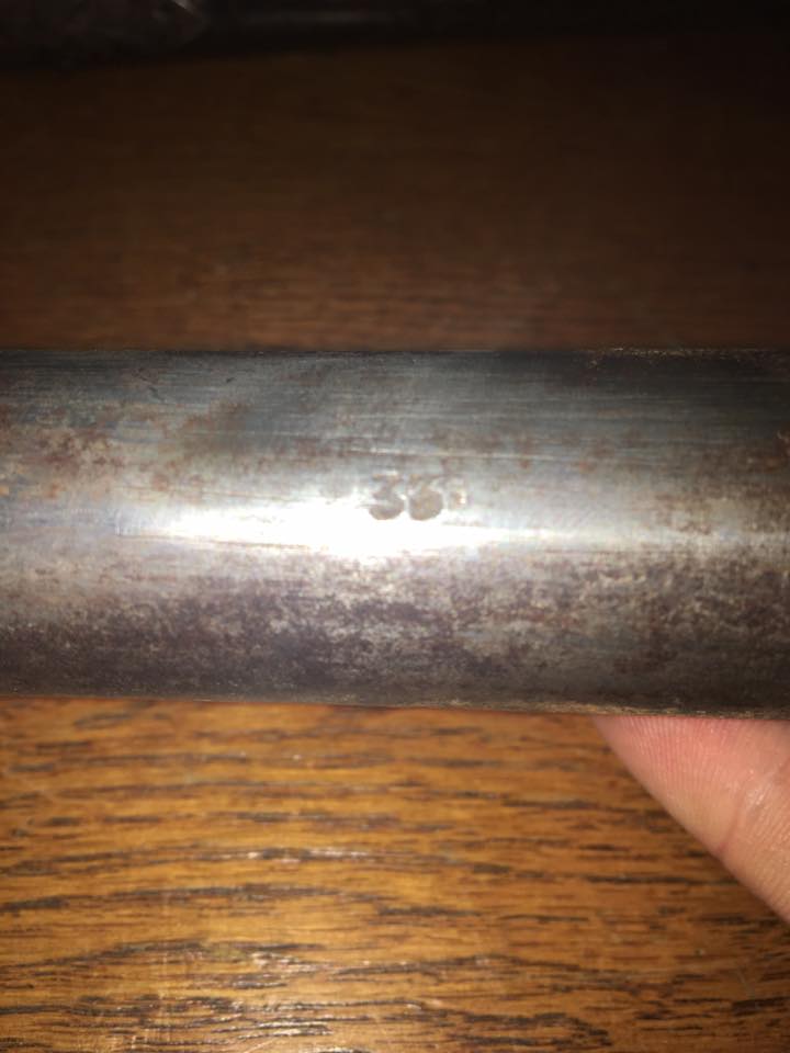

here are some more pictures, this time of barrel markings. The first two are on the underside approximately 2 and 8 inches from the breech end of the barrel respectively. the third one is right at the breach on the underside, the next one is right on the back of the breech plug. theres also a small mark of a letter, maybe an E, in a circle on the left side opposite of the nipple, and a small hallmark inside the lock of an F under a crown.

Thanks for all the additional photos. Don't know where to start. LOL Here are some additional observations:
LOCK: The lock, trigger, trigger guard, rear sight, and rear sling swival all appear to be from the French musket posted above. The trigger guard just engraved to suit local tastes. The lock even uses European pan head screws.
STOCK: That decorative wrist plate looks very similar to ones you see on Ottoman/Balkan style horse pistols, just larger. That long, brass muzzle cap is also something more likely to appear on Ottoman/Balkan style guns. Again, to suit local tastes. The brass butt plate being a locally made item.
BARREL: I believe this barrel started life as a European made item for use with a flintlock. The barrel being recycled with a locally made percussion bolster added. You can see the weld thread. The engraved brass overlays being added to the barrel, again for local tastes. The breech plug and breech look robust, and of European manufacture. I'm not sure about the barrel marks. The E with a circle around it may be a Belgium proof mark (?) It might be worth posting the barrel mark photos on the European Forum to see if anyone can identify them.
With respect, im not sure i agree. The barrel profile seems to match that of the french musket pictured earlier too closely, and Im not sure what you mean by weld lines on the bolster. There is a very shallow rifling in the barrel upon cleaning, not super deep but enough of a twist that it cant be considered a random scratch pattern inside. If the lock, trigger guard and strap hardware are from a french musket and the barrel of that musket resembles mine in available calibers, shape and details such as the size of the "tang" that secures the breech to the stock, as well as the size and shape of the percussion bolster, then im more inclined to believe that the barrel too is of one such french gun that had been put into a new stock and decorated with gold and carving as per some owner's taste. I am suspecting heavily ottoman/balkan inspired origins, partially from the gold, partially from the rosette decoration on the stock and a smaller spiral rosette on the breach tang, and also for the fact that there was a charge of what I found out to be cut lead inside the barrel, oddly without powder (thankfully) and that sort of ammo was often used in ottoman areas in a bind. The butt plate, muzzle shield and other stock accents are all steel or iron, btw, although I do suppose one could confuse them for brass because they arent very clean in the photos and there was a rather impressive film of gunky oil on top of them making them appear yellow. And on the subject of metal, the inlays on the barrel seem to be gold, as theyre too soft and nonreactive to be brass. they werent tarnished the day i got it, albiet covered in gunk, and even after cleaning where one would see brass objects at the least start to take on a slightly deeper or darker appearance, it remains shiny. I even wiped a q-tip of strong vinegar on an unoiled section of decoration to be certain, and this is the solution i use to deliberately patinate brass. still nothing. So by my count that rules out most things except gold as being able to fit the bill. (plus it is VERY soft)
Thanks for your opinions on this piece im still trying to get to the bottom of it as its been very puzzling to me. I appreciate your theories

http://damascus-barrels.com/Belgian_All_Proofmarks.html
Refer here. The barrel Proof Marks are Belgian so at least you now know where (at least) the barrel was made. See #2 and 3 above for the ELG mark.

OK. Since the barrel shows shallow-groove rifling (possibly 3-groove?) I stand corrected. The caliber should measure about .69 (18mm). The French and Belgium muskets of the period were very similar. Parts coming from the same arsenals.
The latter photo showing the bolster seemed to look very different than the earlier photos. I guess that was because I was looking at it with the barrel out of the stock versus in the stock. And with the additional information on the barrel being shallow rifled, I would disgard my earlier theory of the barrel, and agree with you. The barrel was designed to shoot the .69 minnie ball of the period.
So, it appears the entire service musket was utilized and re-stocked (possibly due to a broken stock?) somewhere to suit Ottoman tastes. Possibly at one of the many gun making centers in the Balkans (?). The decoration and engraving seem to be done in a generic fashion. So it's difficult to tell wheather it was made for a specific individual, or just re-stocked in a shop for resale to anyone interested. This re-use of parts was very common throughout the Empire. The gun could have been assembled in India, Afghanistan, or any number of different locations. It's almost impossible to tell for sure. And most of these guns were never marked as to their final maker. But the utilization of Europen parts would likely have put a percieved increase in value to the purchaser. This re-use of parts was very common throughout the Empire.

The letters surmounted by a crown are INSPECTORS MARKS. See #10 on the chart I gave you. Different Inspectors would likely be used for different parts as per their individual expertise. Note also that this mark was used between 1853 and 1877, so now you have a date span in which this gun, or at least the parts were made.
The other numbers are unlikely to be anything to do with dates. Simply (maybe) batch numbers. Remember that we are still talking INDIVIDUAL PARTS for individual guns, hand fitted. COLT was the only maker of the period to my knowledge,who made parts which would fit all guns of the same type without any further adjustment. In other words he could be regarded as one of the first "true mass producers" of guns.
Your comment regarding similarity to French locks is well founded. The 2 countries are side by side, and in fact many French guns were proved at the Liege Proof House. This one however, was not, as the Inspector Marks are not French.
