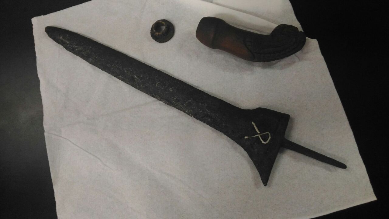

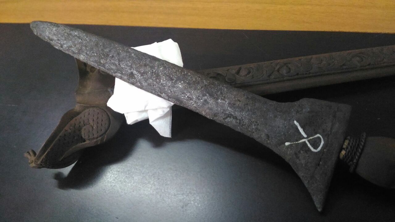

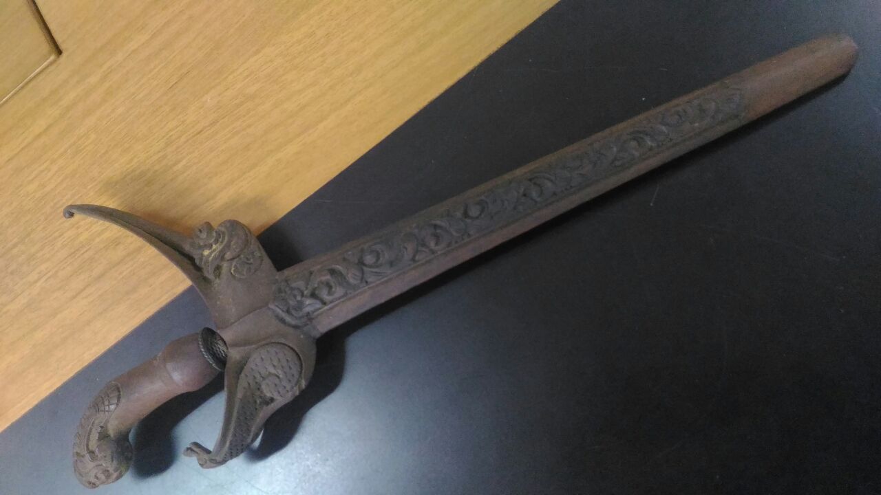

Hi
this one is from my private collection. Got this keris around 7 - 8 years ago, almost for free, after the previous owner died and his son no longer wanted to keep one
eyes can be deceiving, so is with this particular keris
this one is rather small, only about 30 cm in overall length with balinese dress, specially made for this blade - perfectly fit
what do you think ?
Donny

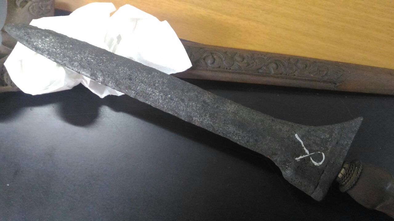

closer look

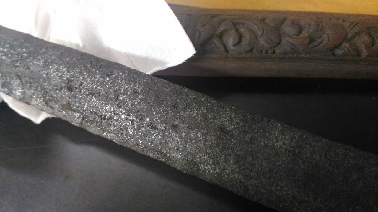

and why do I think this one is unique, because eyes can be deceiving
you can look closely and you'll find nothing unusual, just plain old keris in not so good quality
but this one, most probably THE BLADE was made from WOOD, not metal. It is very light, and by light I mean very light wood. You will be surprised when you see it and then held it personally
now the story becoming murky, as the previous owner's son only said this was one of the pusaka owned by his late father and specially cared, and even oiled regularly
why making a keris from wood ? and why bother masking it to look like a metal ? spiritual reasons ?
why wasting effort to make specific dress for it ? why care for it if it's just a "toy"
any comments ?
Donny

Hello Donny,
The dress is Madurese and probably recent, not Balinese? Astonishing wooden blade!

Posts: 7,298
Yes, i would agree with Jean that the dress is rather low end and recent Madura dress. This is the kind of dress most often found on replica keris sold in import stores around the world and probably in local markets for tourist. However, those usually have cast iron blades, not wood.

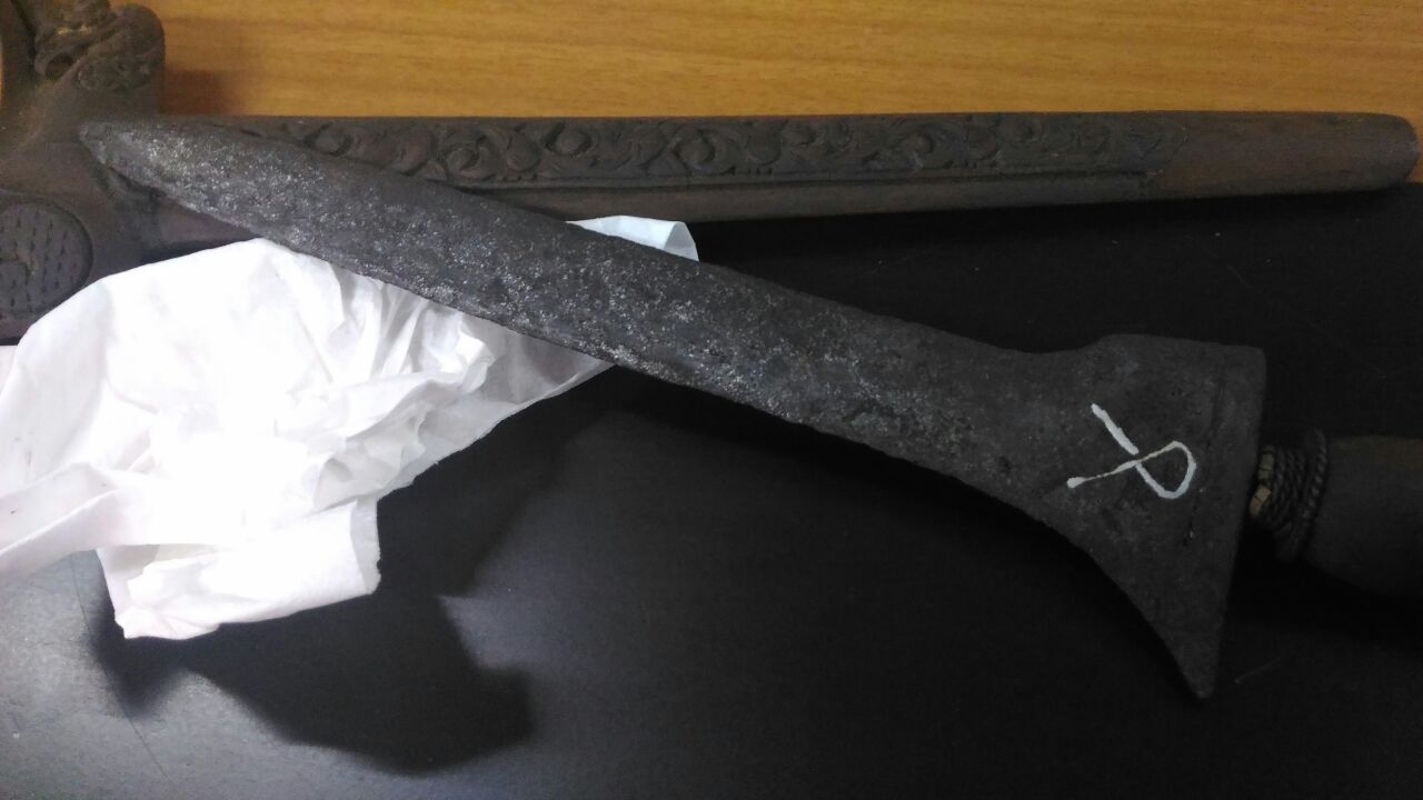

The symbol on the keris is interesting, it is used in Silat to denote a knowledge of ilmu kebatinan.
Pusaka is offline   Reply With Quote
I have also seen this symbol on a few actual keris, usually more contemporary pieces or older keris where the added markings are more recent. We should keep in mind that while kebatinan claims ties to ancient knowledge and traditions it is a relatively new philosophical movement beginning sometime around the 1920s and not really gaining any popular foothold until sometime after WWII.

This symbol relates to Sufi type knowledge and therefore would not pre date the spread of Islam in Indonesia. I believe this specific knowledge has its origins with the Wali Sunan Bonang who then passed it to Sunan Kalijaga.

This symbol is the isolated form of the Arabic laam-alif, it is the form used when the letter is written as a single letter and it combines the letters laam and alif.
The second chapter of Al Quran begins with "alif laam mim". The "secret meaning" of alif is Allah, the "secret meaning" of laam is the angel Gabriel, who delivered Al Quran from God to Mohammad, the "secret meaning" of mim is Muhammad.
This is Sufi belief and its use in Jawa probably dates from the time and teachings of Sayyid Hasan ’Ali Al-Husaini, better known in Jawa as Syekh Siti Jenar.
The Arabic alphabet was developed from the old Semitic alphabets, and the letters of the Arabic alphabet have numeric values, so a letter can represent a number or a number can be understood as a letter, which can then represent a word, thus several numbers placed together can represent several words, for instance, 'bismillah al-raham al-rahim' (in the Name of God, the Most Compassionate, the Most Merciful) is represented by the number "786", which is the reason that here in Australia we often see vehicle number plates with the number "786" driving around in areas with a heavy Muslim population. In Solo, Central Jawa I have seen several businesses with the number "786" incorporated into the business name.
In one of the Javanese alphabets the letter "dha" represents the number "8", and that in turn can be linked to the Candra Sangkala.
In the keris, where do we find the letter "dha"?
What Hindu symbol is almost identical to "dha"?
So belief depends upon what your religious belief system is:- nothing has only one meaning, and the more meanings, the better.
Why?
Because then only those who are intended to understand a meaning will be permitted to know a meaning.
Do not think for one instant that it is possible to understand everything that we think we can see or hear.
In respect of the laam alif symbol as represented here, I have also seen this symbol used on Indian armour piercing arrow-heads.

After some consideration and careful examination of the photos, I came to doubt that this keris is made of wood.
The mere fact that is very lite does not mean it is wood.
Nothing in its aspect looks like wood.
Moreover, the porous aspect tends to point to a heavily chemically corroded iron. I am not very good at chemistry but I have seen iron tools that after some acid attack turned into some kind of spongy coal that was very fragile and crumbly and this is exactly what I think it happened to this Keris.
Old 22nd January 2017, 07:11 PM   #23
Have you tried with a magnet ?

hi all
Thanks for the interest of the blade

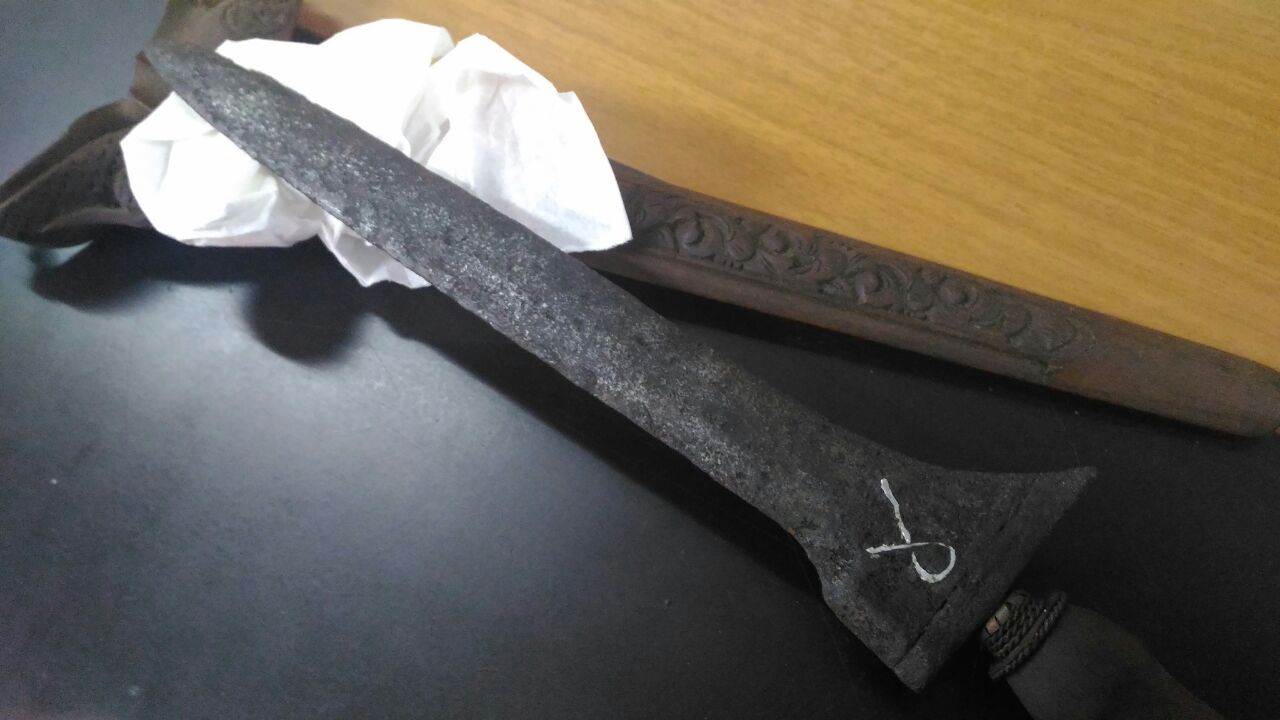

1. The blade stick to magnet !! this amazed me ... I used refrigerator ornament magnet and did not expect it to stick but it is !!
2. if you put it carefully on water, it floats !!
now what do I have here ?? getting more confused here
Donny

Hello Donny,
I agree it can be very misleading, but even floating on water doesn't prove anything but that it has a very low density (after all ships are made of steel too and still float on water). The low density is almost certainly the result of its spongy/porous structure, with many microscopic pockets of air.
This is almost certainly the result of heavy acid attack.
Marius

I have to admit (shame to myself) that I failed to recognize this piece as metal based
the sound when you clink other metallic object to it, the weight, the feel , almost anything about it is not-metallic like
I even almost sure the blade won't stick to magnet, and it does stunned me for awhile to feel it attracted to magnet ....
got me fooled, this one
so, real keris, old and repeated washing and staining corroded the metals and left it porous and spongy ?
Donny
satsujinken is offline   Reply With Quote

Hi Donny,
I do not know what exacly caused this keris to end up like this but it definitely isn't repeated washing and staining. There are blades that are hundreds of years old and have seen maybe hundreds of washings and stainings and didn't turn into sponge.
More likely it was an unintentional accident related to some acid treatment. I assume that new blades are artificially aged using acid and this one may have been the result of such a treatment. Maybe there was the wrong acid used, or the wrong concentration, or the blade was left too long to soak.
Marius

Originally Posted by Jean

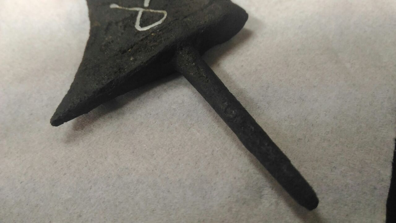

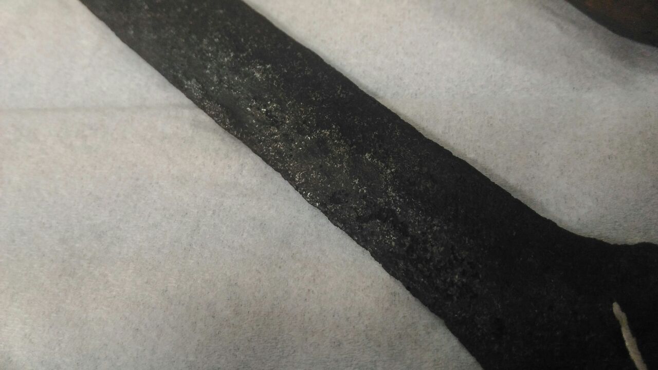

I cannot believe that an acid-treated iron blade (and looking solid) can float on water unless it is hollow?
A normally acid treted iron blade won't float but one that has been turned into sponge will most likely float, at least for a while, until the air pockets within its structure get filled with water.
Old 24th January 2017, 03:55 AM   #30
satsujinken
satsujinken's Avatar
Join Date: Sep 2012
Location: Surabaya - Indonesia
Posts: 199
the funny thing is the blade is light but not that spongy. It is solid ... trust me it really felt like wood, well - until you put a magnet unto it
too bad we live so far apart ... I am dreaming of a gathering in a room with coffee and lots of blades :P
Donny
