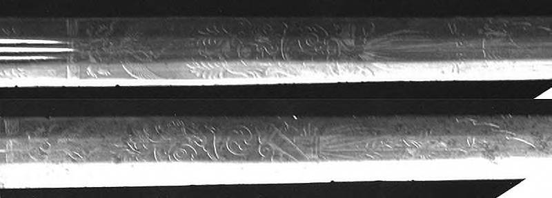

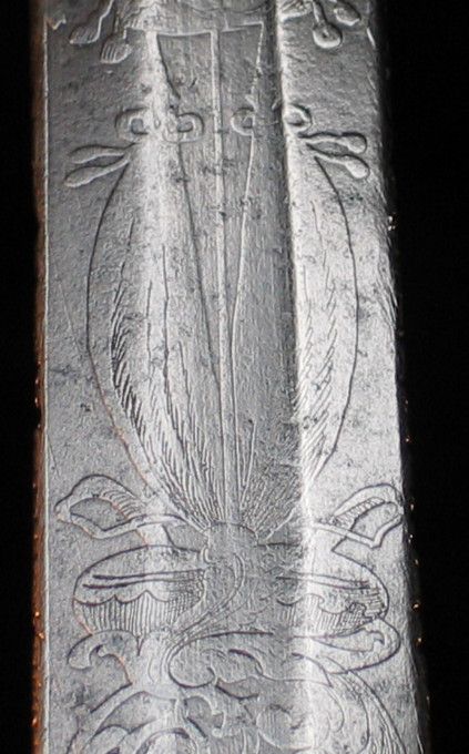

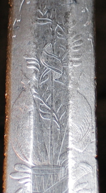

I'm attaching some better photos of the pattern.
Any thoughts?
Matt

You're doing some great research on this!!! I really like the thorough approach you are using !
Can you possibly show the entire sword, I've forgotten what hilt it is mounted in.
Which unit was your grandfather in.
Nice work locating the bladesmith in Oaxaca. I'll work on finding way to contact him if possible.

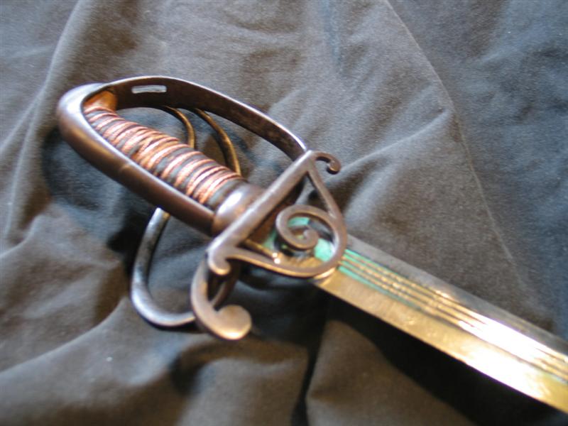

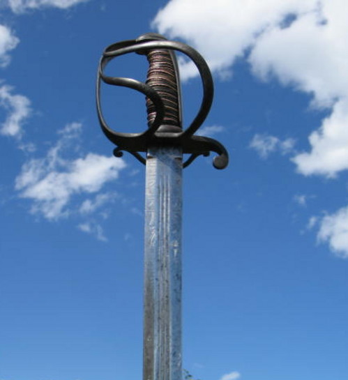

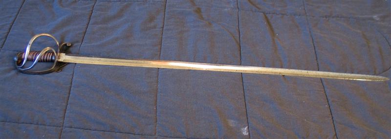

Default Full Sword photos

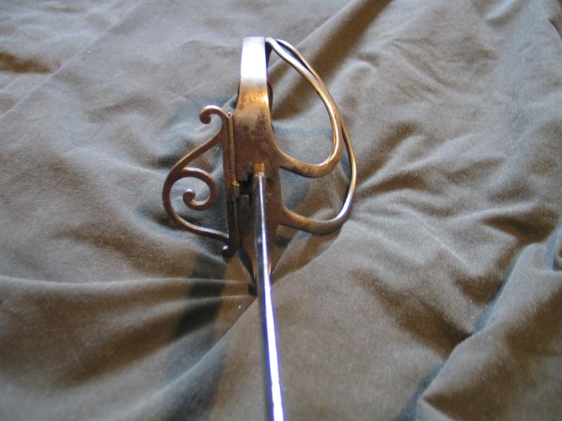

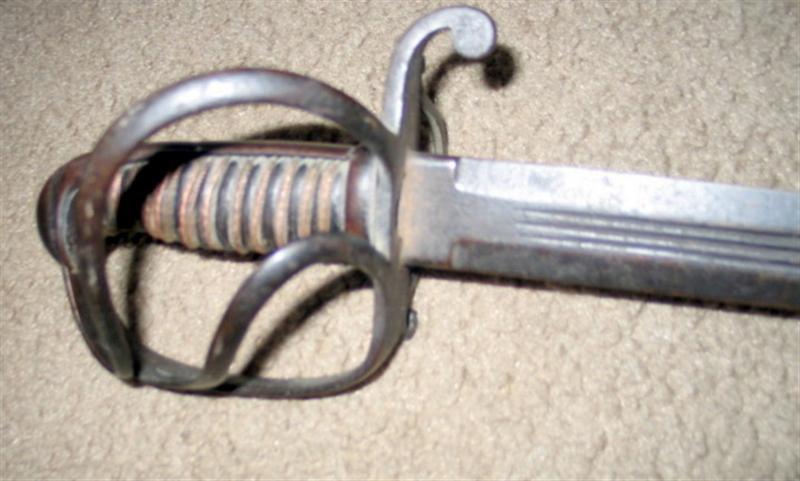

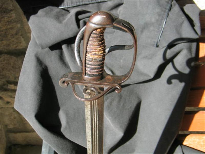

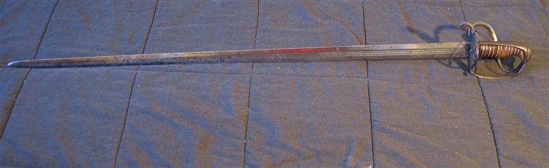

Thanks Jim!
Here are a couple full views.

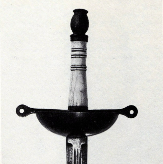

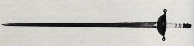

On reading more about the Espada Ancha ( my sword has almost the exact dimensions as one in Spanish Colonial Weapons...sword 3 plate 131) I have found that a lot of spanish and mexican blades were Iron, I have assumed that my blade is steel. How do you tell?
The 3rd photo is listed as a dish hilt hanger, it is 1/4 inch longer than mine and is listed as having probably been cut down???
I am trying to get a better photo of the P D L...more on that later.
Thanks Again
Matt

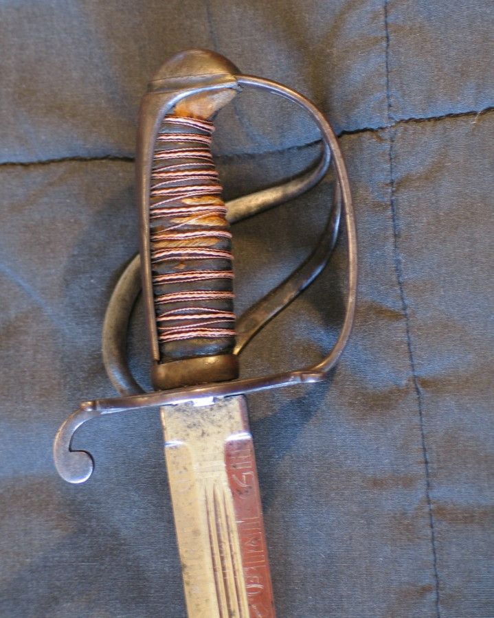

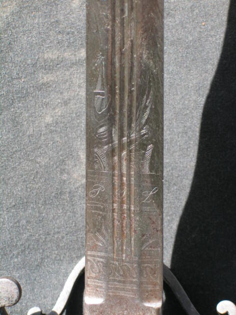

Here are some photos of the PDL and the recasso on my sword.
Re the PDL, I have not found a Luneschloss blade that had the initals ingraved in the blade in cursive, so I've been thinking that they are spurious or the initals of the sword owner. Perhaps you are right about Germany, Juan J. Perez has said he thinks it is a soligen blade but I have not found one that is close or has the tri fullers like mine does so I was looking at Oaxaca as a possability.
In the photos you can see the ricasso on my blade is the same size and shape as the dish hilt hanger, and the fullers are in about the same place, I can't tell how long the fullers are on the hanger so I don't know if that would match.
As I said earlier, I don't know how to tell what the blade is made out of so any info on that would be great.
I saw a short article on Espada Anchas where the autor said that a lot of them were rehilted with 3 bar iron hilts from England around the Mexican -American war, and mine does look lihe cast iron.
My ggg grandfather was in company I 10th Michigan Infantry. He enlisted as a sergent and was made company wagon master Nov. 20 1861 and was promoted to Lieutenant after the afore mentioned skirmish.
Thanks for all you're work Jim and all the info!
Is there a way to tell if my blade has been cut down?
Is there a way to confirm the PDL?
Best Regards
Matt

Hi Matt,
I'm glad you have spoken to Juan Perez as he is one of the most knowledgable people I know on Spanish swords, so I am glad that he agrees this blade is, like many of the other triple fuller examples, from Solingen.
As Chamberlain notes in his book, many of these blades were hilted in Mexico with three bar iron hilts in the 1820's and 30's. English hilts seem quite likely, although the three bar hilt became popular with a number of countries during those times. Yours does seem English.
Interesting on the PDL, which certainly seems to represent Luneschloss, who furnished edged weapons for Britain, France, Belgium, Holland and the U.S.- "where Luneschloss supplied both sides during the US Civil War of 1861-65"
("Sword and Bayonet Makers of Imperial Germany 1871-1918", John Walter, 1975, p111-114). This reference notes further, "...quantities of etched and engraved weapons were also marketed alongside cutlery and tableware".
While this reference clearly is assigned in scope to the period after the Civil War, the existing history of the makers prior to that time is discussed briefly.
It should be noted that Luneschloss worked closely with London dealers, much as many German makers had for many years, and that England was of course quite active in supplying Confederate forces. Although the obviously Mexican motif seems misplaced on a sword found in Confederate hands, it does seem as I mentioned, not that surprising given the complexities of supply networking during those wartime years. While most of the Luneschloss blades I have seen were stamped, especially the U.S. examples. On an interesting side note, when the U.S.pattern 1840 cavalry sabres were introduced, the earliest examples were actually German made! until Ames took the contract.
I still am inclined to think that the blade may have been decorated in Germany, it would appear by Luneschloss, and the cursive script may have been because it might have been intended in some diplomatic sense? It is really difficult to say, yet we know where it ended up
Do your records show what location in Tennessee the action took place?
I lived in Nashville for nearly ten years and the history was fascinating, though I didnt really get into it as much as I should have then. It seems all the focus was on the Battle of Stones River (Murfreesboro).
Your blade seems to me full profile, so dont think it is cut down, and it is of course forged steel. The hilts were iron or brass.

Hi Matt,
The title "German Swords and Sword Makers" by Richard H. Bezdek is available on Amazon books.
Outstanding and exciting photos of the sword in your grandfathers possession! It is so remarkable to see one of these swords that is so faultlessly provenanced. Nice follow up research you are doing as well.
There is a photo of the Najera sword in the book, but as always very poor quality. Possibly contacting that museum they will furnish a photo.
Thanks for keeping this going and keeping us up with the research as well as sharing the great photos!
I think your shot of the sword against the clouded sky is a masterpiece!
Pulitzer prize stuff!!

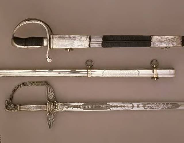

Hi Jim,
Here is the Museum's online image, it is under 2 captions, one says the sword of Lts. Col. Nagera who lost the fight to Hayes. The other says, a presentation sword given to Maj. Hawkins for the defense of Fort Brown.
I'm guessing that the top sword Was Najera's, the hilt is the same as the etched swords on my blade.
I wonder if you have noticed if diffrent bladesmiths shape and size their fullers and ricasso in the same way on all they make, like a signiture, or do they vary due to the technology of the time?
The fullers on my blade stop farther away from the hilt than those on the sword in Spanish Weapons in Colonial...
Just wondering if this may have been a regional or specific makers trait.
Thanks again for all the help.
Best Regards
Matt

Hi Matt,
The top sword is indeed the Najera sabre, nice work on locating the photo!
Interesting idea about fullering being distinctive to a particular maker. It would seem that in general the forms were very similar in accordance to the technology or popular style at the time. It seems there was always a great deal of innovation and testing being done on swords, ironically much beyond thier being superceded by firearms. There are instances where certain blade forms used key cross section patterns in the work of some makers during certain periods, at least in some research I can recall in studying British cavalry swords, but not with enough consistancy for certainty. I think any variation in the fullers as you mention would be more inclined to deviation in manufacturing process, possibly subcontracted work, as became more often the case in advancing industrialization in centers such as Solingen.
I still think the PDL engraved in script is an interesting anomaly worthy of more research. I am waiting for the Bezdek book myself in hopes there might be something in it concerning that. There is a lot of data published in Germany on the history of Solingen, but without translated material, not very accessible. I know that the journals of the German arms and armour society which go back into the early years of the 20th century have articles on German makers, hopefully the Bezdek book will reference.
All the best,

Default Searching
Hi Jim and Mark,
Thanks for you're input!
Sorry for the absence, I didn't get any notification about you're posts,
( I was getting e-mail when ever someone posted on my thread but have not got one since last month)
I have been doing searches looking for images of swords to compare to mine,
and trying to contact long lost relatives who might know more about how my GG Grandfather and the Sword, his Whitney Ball and Cap Revolver and a Cane Sword that I have that I think was his.
I have not heard back for Casa Aragon or The Klingemuseum.
I am somewhat at a loss about the decorations, I have seen some good examples of tri-fuller blades with the spanish motto draw me... but I have not found one with the eagle, canon and floral pattern with flags.
I had hoped that the Klingenmuseum would have some record of P D L etching blades with these themes.
Thanks Jim and Mark for you're input!
Is the "Wallace Collection" in a specific book?
Jim what do you make of the eagle, canon, and flags?
I have not been able to find a connection to the Treaty Map, but it seems to me that the eagle with the canon and flags could have something to do with the end of the Mexican/ American War, would those lend more to an Infantry or a Calvary unit?
Best Regards
Matt

Hi Jim,
I am still looking for more information on Spanish Colonial Swords.
I expect to acuire a copy of German Swords and Sword Makers soon.
I posted again on the SFI German language forum and a gentleman there also thinks the blade is Lonenschloss you can see the thread on SFI
Is there anywhere to look for more on the rehilting of these swords?
Matt

Hi Jim,
I've been trying to find the information you wrote here so I could document it, and I'm having trouble finding it after many searches.
Do you have a copy of any of Albaugh's 3 books on confererats swords? I can't afford all the books I've found.
Do you remember where it is recorded about the PDL etched or inscribed in cursive blades?
Is the Wallace Collection a book? When I do a search, there are thousands of hits but not a sword collection.
I finally got an e-mail from Guerillmo Aragon and sent him some pictures, have not heard back yet.
I have not heard back from the Klingenmeuseum yet either.
I did find a book that was written by one of my ancestors and published with a Michigan historical society that mentions the sword and pistols in my g great grandfathers house right after the Cival War.
I'm still trying to figure out the decorations, still can't find anyting like them,
I can't travel to the museums with good collections.
Thanks again Jim for all you're help, got any suggestions on where I can find information on the decorations?
Matt

I have e-mailed a link to my thread to some people to see the photos of my sword in hopes of more information on the decoration. I wanted to post a couple more photos of diffrent details.
