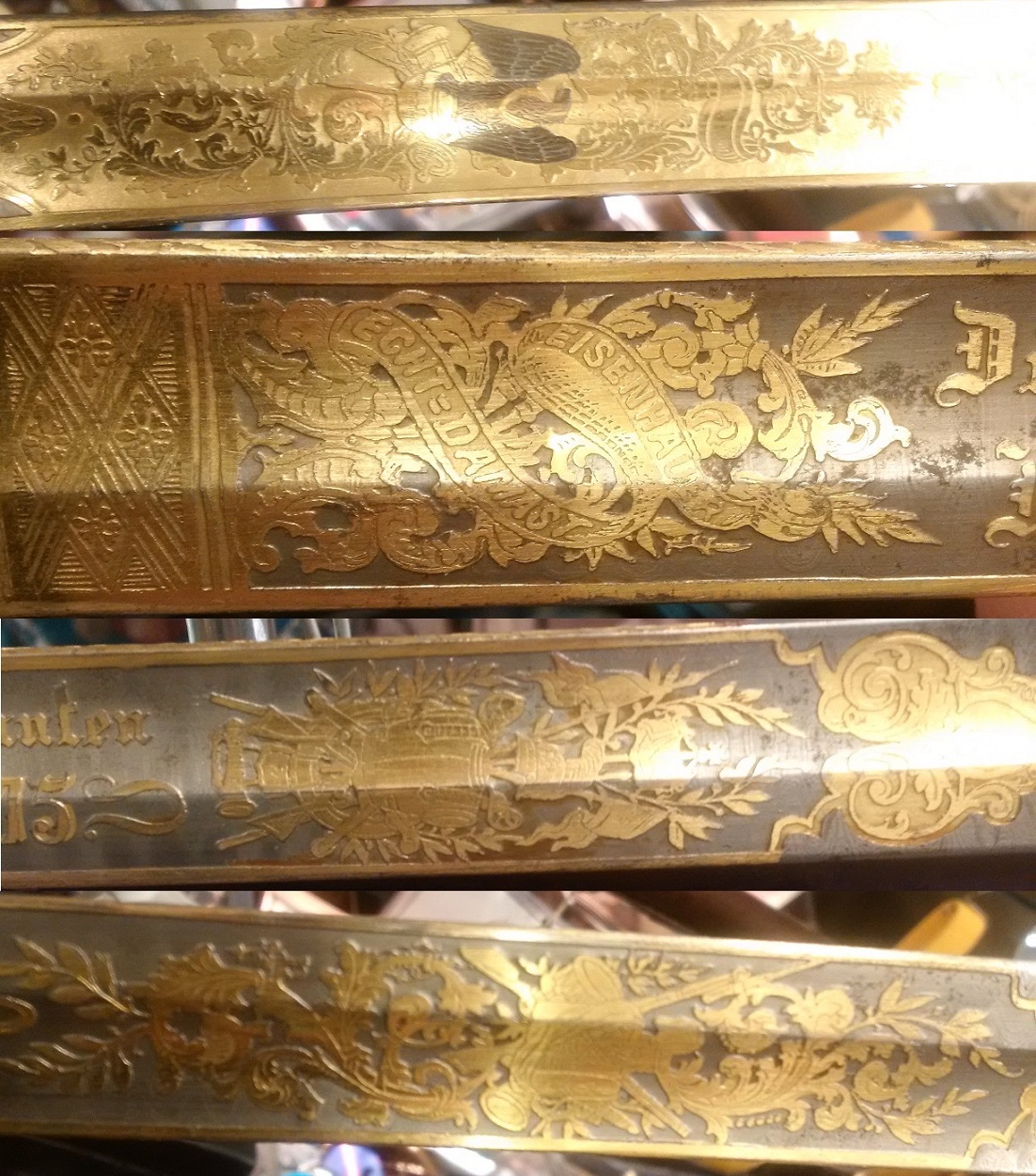

Here's Solingen presentational sword with gilt decorations and inscriptions and fine damascus pattern.
Old 10th January 2017, 12:06 PM   #2

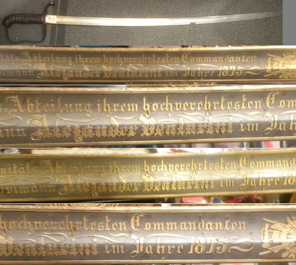

Excelent example, Alex. Can you translate the text for us ?
Old 10th January 2017, 05:37 PM   #3
Posts: 10,867
Hi Alex,
This is a magnificent Prussian army presentation sword! and the intriguing letter font using what appears to be 'fraktur' adds to the handsome etched inscribed panels and decoration.
This stirrup hilt form sabre is of course long standing from Napoleonic period through the 19th century and actually continued up to WWII.
While I cannot translate the words exactly it appears to denote a particular regimental 'command' and the sword was presented to a hauptmann (captain) of this unit in 1875.
The high quality blade is indicated with the term 'eisenhauer' (= iron cutter) both in the blade above makers name at forte as well as in the decorative flourish etched on the blade (iron cutter etched in damask) . The etched Damascus pattern is decorative of course.
F. Horster was of this Solingen family of producers with Friedrich listed 1825-1875.
What is most interesting is the year of this presentation, 1875. The Franco-Prussian war had ended in 1871, but tension remained high. In 1875, in what seems to have been a strategic ploy, a news headline was generated suggesting war with France was again imminent. This created or perhaps better described as perpetuated the strained diplomatic maneuvering between most of the European super power nations, which eventually would result in WWI.
A book reviewed in the Oxford Univ Press journal 'German History', November 4, 2011 best describes the military climate in 1875 Germany,
"The War Scare of 1875: Bismarck and Europe in the mid 1870s" by James Stone; Stuttgart, Franz Steiner Verlag, 2010.
Perhaps this Prussian captain was awarded this sword either for meritorious service in the Franco-Prussian war during ongoing military recognition of that conflict. Possibly this may derive from 'military posturing' during these circumstances in 1875 as well.

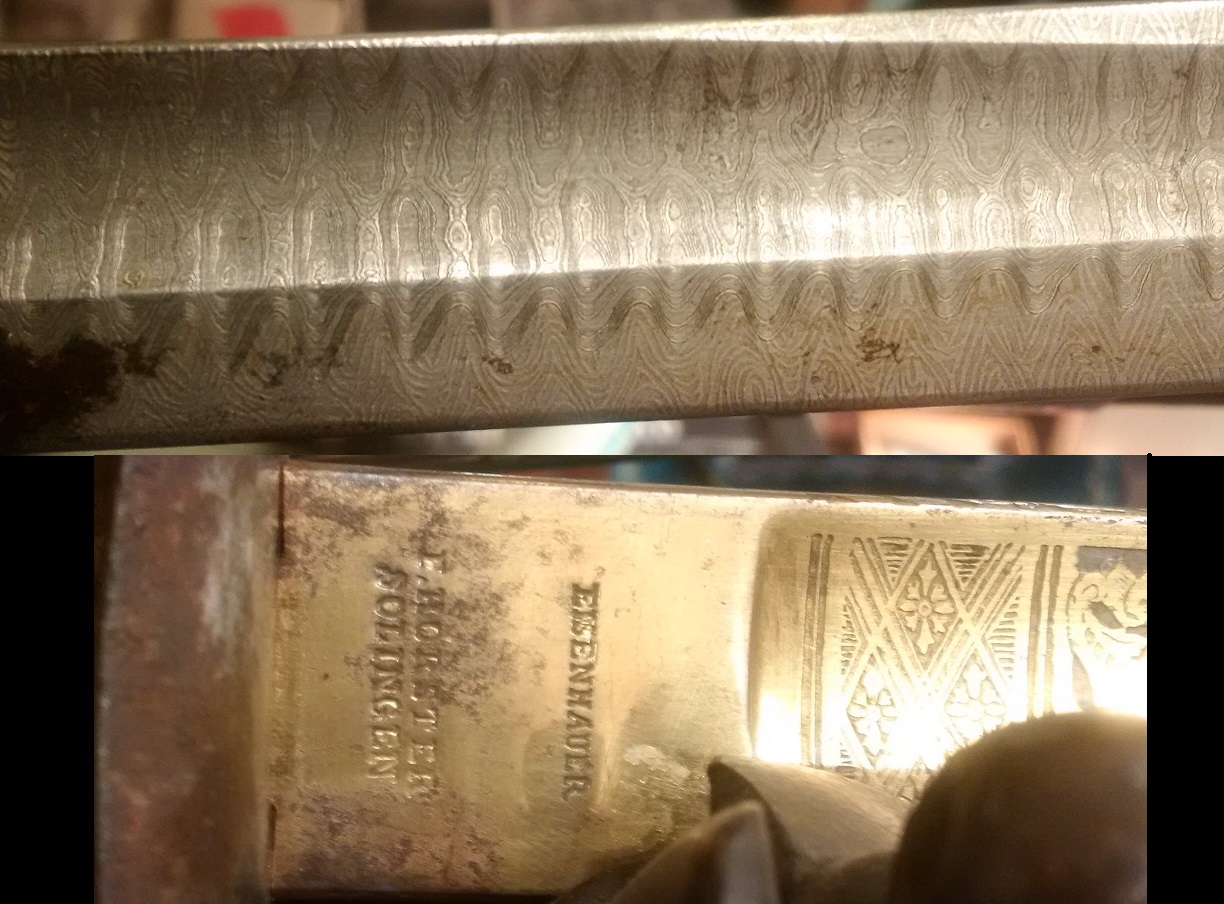

Hello Jim,
I know next to nothing about the blades from my own country but I am maybe able to help with the inscriptions. I've googled a little bit and found that the term "EISENHAUER" is a quality grade and mean that the blade is proved by "Nagelprobe", a prove of the edge quality when I understand correct.
The other term seems to say that the blade is from real Damascus also when I would agree with you, it look like "fake" Damascus. But the term say clear "real Damascus"!
For the other words I respond later.

The other inscription is not complete, who is the presenter from the sword I can't see but it was given to the "more as highest venerated" (hochverehrtesten) commandant....(here again is a part I can't read because not visible complete) Alexander Venkarini (?) in the year 1875. I just need to read it complete.
The Presenter is any division.

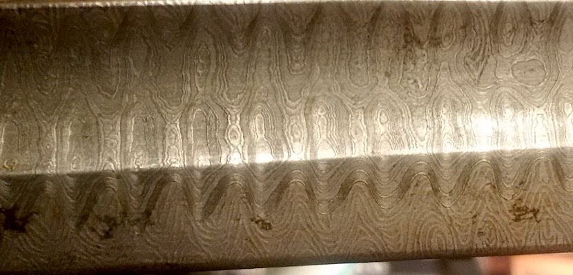

I can see why Jim and Detlef saw the pattern as being acid etch, i.e. artificial surface applied. May I question this? Having some resemblance to wax resist method, it lacks the details that such method would produce due to application of a template that results in sequential repeats in the pattern. I do not see such repeats, nor the template being used here. To me this indicates true mechanical Damascus, in line with such stated description on the blade. Is there another resist method that could be used to yield a random pattern, etc?
Old 11th January 2017, 06:37 PM   #8
Alex,
now I am very sure to see real pattern welding and I am not surprised about this. It's not only a identification by seeing but also a matter of feeling. I am sure that the blade is pattern welded. Roland could be a candidate to tell more about this.
Old 11th January 2017, 07:14 PM   #9
Lightbulb
Hello Alex,
The upper part of the blade is clearly pattern-welded: the darker sigmoid pattern (my added green line) is the lowest pw part.
The pattern below this line is clearly faux in my book: despite trying to look like pattern-welding, it is quite erratic and just doesn't make sense from a blacksmith POV (I have indicated a few of the more obvious areas that look problematic. I believe this was done to also decorate the inserted edge en suite with a similar pattern.
I reckon not many lay people will recognize this trick; I believe the etched pattern (or rather the wax) was drawn by hand - a technique also utilized in other regions of the world (in varying quality).

Originally Posted by Sajen
Hello Jim,
Hi Detlef,
"Nagelprobe" is something different! "Nagelprobe" has nothing to do with "Eisenhauer". Even the german Wikipedia explanation is wrong.
"Eisenhauer" means that the blade is able to cut through an ordinary 0.5" (or similar) nail without traces on the edge, except a tiny discoloration.
All the early "Eisenhauer" blades had to pass this test, later it was more a symbol for quality without a specific test.
Best wishes,
Roland
Old 18th January 2017, 04:40 PM   #11
Hi Roland,
like said, I know nothing about this area of collecting and repeat what I found by google! And like said in up, I've thought already that you will be able to tell more!
Old 18th January 2017, 07:12 PM   #12
Question
Hello Roland,
Could you please expand on this?
Nails are usually made from very mild steel; if you anneal them, they should pose no problem to any hardened steel blade. A thick iron rod may still pose a challenge - it seems more of a test for a good edge geometry (and sword technique) to me though!
Old 10th January 2017, 05:45 PM   #13
I would be able to translate it, it's German text but not complete.
Old 10th January 2017, 06:15 PM   #14
Perhaps Alex is able to show us the whole inscription ?
