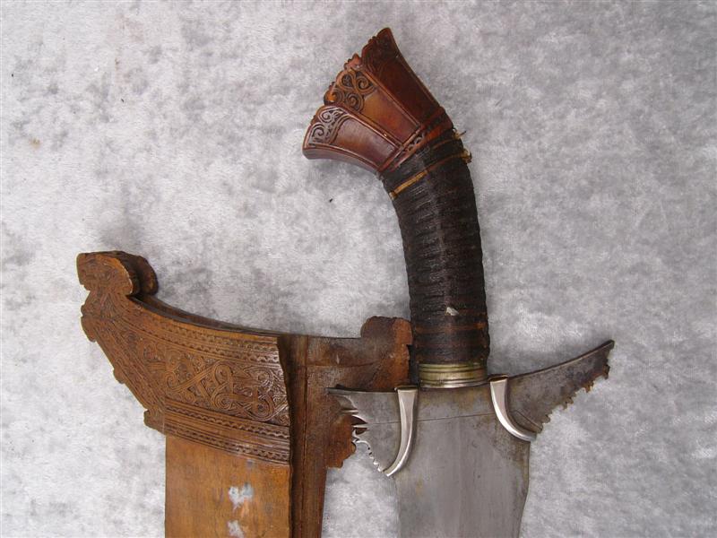

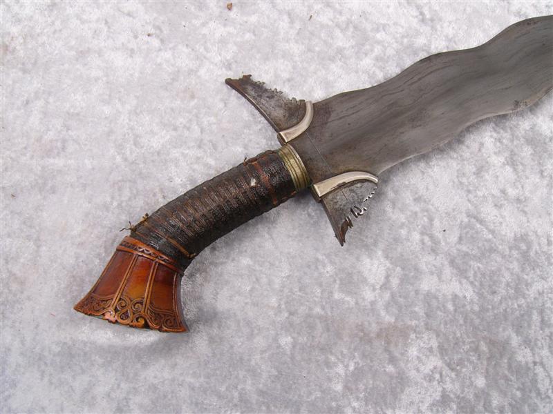

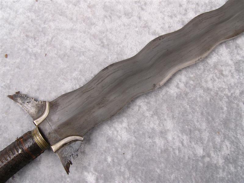

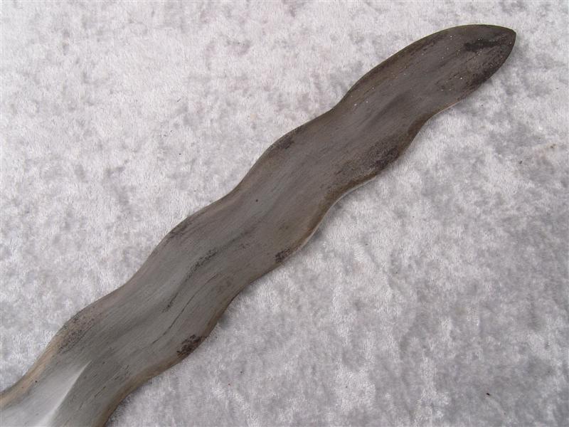

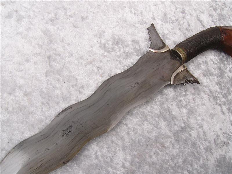

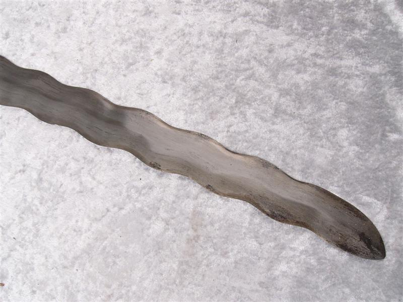

The blade did not really look all that good after I finished polishing it, but some interesting patterns appeared when I wiped it with a mixture of vinegar and PCB (ciruit borad etchant).
Not so sure I like the colors, but some interesting patterns. What can I do to make this better? |

Hi Bill,
My personal opinion is that you should not mix two etchants together . I have a suspicion that the blade you're working on might be monosteel . |

i remember that awhile back there was a post on renew the pattern on these blades.... I believe it was something with arsenic trioxide and lime juice......
-- think thats the more traditional way? I agree with Ric.... don't mix the acids..... acetic and ferric chloride may make it muddy... just the acetic should be fine and it may take abit....since it's a very weak acid... . also... can you remove the handle..... don't want any acid on that... & don't forget to neutralize it - positively degrease it before any attempt at an etch... - also... full emersion of blade in etchant is the best... ( at least from my experience ) take care Greg |
#4 |
Posts: 7,303
Hi Greg. Arsenic and lime (warangan) is the traditional manner of staining Indonesian keris. It is not used, AFAIK to bring out patterns in Moro kris (it is not a fast rule, but the tendency on this forum is the spelling keris=Indonesian/kris=Moro).
Handles can be removed from Moro kris, but it is much more involved than it is with the Indo keris. Personally i would wrap plastic wrap really tightly around the hilt before working. Brushing on warm vinegar is pretty effective on kris. It is slow acting and easy to control. If you keep the vinegar moving you can get good, even results. Full imersion is a good way to go, but not really necessary. I have also stained Indo keris with warangan and i use the brush method using a soft toothbrush. I have gotten very good results. Your advice that the blades be degreased first and neutralized after is excellent advice indeed.

my bad glad you set me straight on the etch... (its definitely not my area as i'm a wootz man )however i really love the patternwelds on these kinds of blades..... i don't post on them because i'm very lost on the language and descriptions... by the way... the blade looks to be made of bloom steel... i've hammer welded some steel from wrought iron (wrought being a processed bloom steel) ... and after it is etched, will have very similar surface pattern...... it is really apparent as you polish because you will notice small inclusions in the steel (which are silicous slags from the original bloom ).... this is not the same as welding flaws... take care Greg ps... more pic's please

Soaking a blade in cool vinegar often removes prior stains but, due to the more etched surface, can result in less "crisp" staining. Regards, Kai |

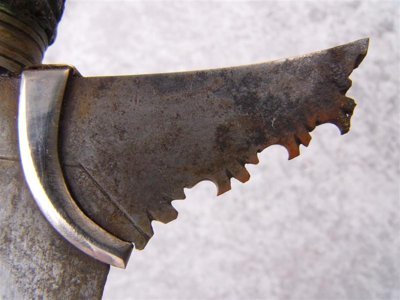

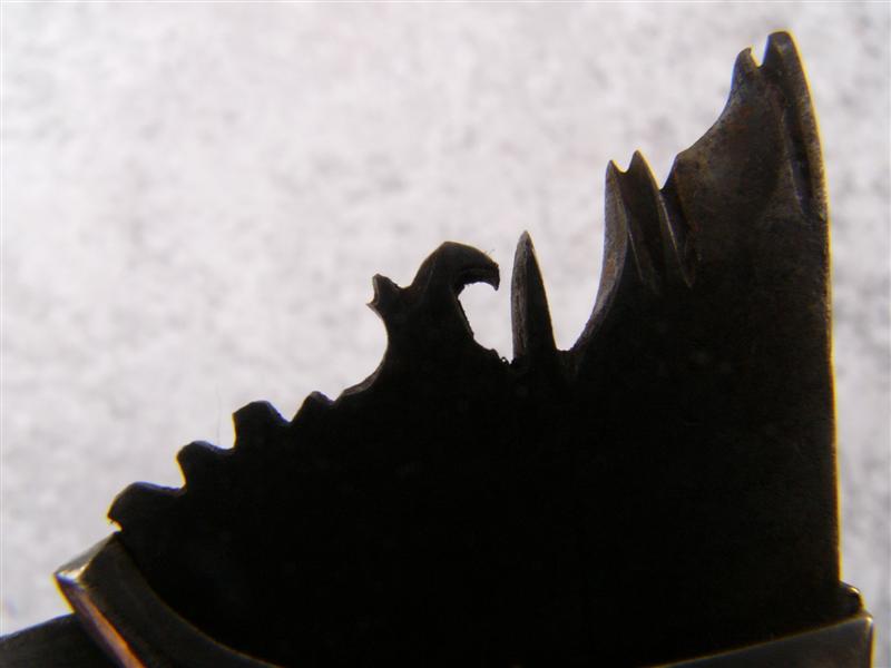

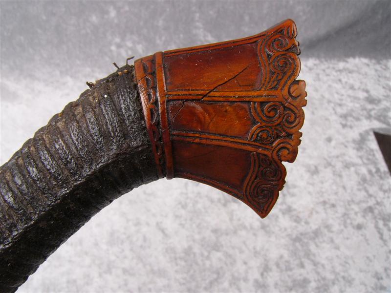

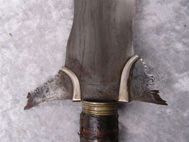

Is it just me or do others think as well that this might be a really nice kris from one of the Lumad groups? From my observations, the carvings at the gangya area appear atypical for Moro designs. Especially the weird file work around the "elephant/eagle mouth" as well as the rather short & stubby other side of the gangya seem to be more consistent with other Lumad examples.
Could someone of the more knowledgeable folks comment on the hilt carvings, please? Any hints here? BTW, Bill, can you ascertain that the gangya is separate? Regards, Kai |

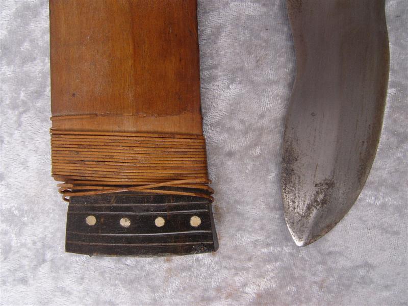

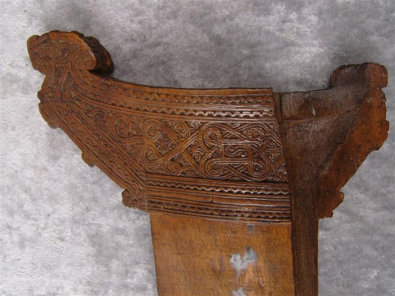

Kia, I would really like to know more about this piece. The ganga IS separate. I also have a scabbard that looks like the handle carving. Unfortunately the scabbard is brokena nd has pieces missing. I did re-stain it tonight, but forgot about heating the blade first, so the stain did not work very well. Cleaned and neutralized it (baking sods?), rinsed and dried it carefully. Will work on it some more tomorrow night. Bill |

I will make some closeups of this area and post tomorrow night. Manong |

I always dilute the PCB etchant 3 to 1 with distilled or pure filtered water. I find it works much better that way. If you put it on straight you get a weird hue on the blade. Then of course neutralize with baking soda. Stephen |

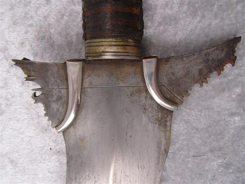

Bill,
This is probably a stupid question, but are you sure the gangya is separate? In your (very good) pictures, it looks like it could just be an incised line. Either way, it's a fine piece! Here's a pic of my carved hilt sundang with an attached gangya. Mine has sloppy engraving of the line, but a nice pattern welded blade, and nice wood. Steve ![]() ![]()

Hi Bill. I am also having a problem seeing you gangya as seperate, espicial when i try to look closely at the point where the line meets the elephant trunk. It sure looks like an etched line to me. (scratches head)

Upon close inspection, the gangya is not separate. Sure looked like it until I got really close. See pics.
Ferguson -- Looks like the hilt was made by the same guy or shop as mine. Mine does seem to have a laminated blade. Still staining. any other info you can tell me or want from me? |

Hi Bill:
Looks like mid-20th C. or a little later Sulu work on the hilt and scabbard, probably Tausug. Ian. |

I agree with Ian and also say that the ganga is not separate, but incised.
