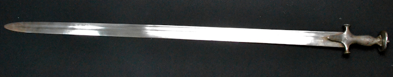

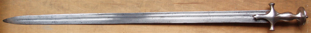

Default Strtaight Blade Tulwar
The second of my recent purchases from the re-enactors market. Again it cost not a lot but I was attracted to it because of the straight blade which I haven't seen often on a tulwar. I don't know if the blade is European or indigenous. It is a light and flexible blade which reminds me of a Scottish backsword type if I had to pick something European.There are twin fullers, one central down to the tip and one to the back rdge which ends bout 10 inches short. The hilt is very plain, no knuckle bow and not even a hint of decoration around the boss of the pommel dish.. No markings at all on hilt or blade.
Weight: 1lb 8oz (0.68kg)
Length overall: 37.5'' (95cm) Blade: 33'' (84cm)
POB: 8'' (20cm)
Profile taper: 1.51'' (38.5mm) at ricasso, 1.27'' (32.4mm)at mid blade, 1.02'' (26mm) 2 inches from tip. Blade widens to about 1.2'' (30.7 mm) roughly 7'' (18cm) from the tip.
Distal taper 0.24'' (6.2mm) at ricasso, 0.13'' (3.4mm)at mid blade,. 0.09'' (2.3mm) 2 inches from tip.
All comments gratefully received as always

Robert, as you have already observed, this sword is pretty rudimentary, and probably not of great age. While the hilt is of course 'tulwar' in the standard Indo-Persian style, it is unusual to have a straight blade.
These are described in Rawson, ( "The Indian Sword", 1969, p.30, p.90),and termed in the south in Hindu parlance, 'sukhela', in the Deccan, the 'dhup', and in Mughal , in Persian 'asa shamsher' (=staff sword).
A number of these kinds of swords were found in the Tanjore armoury when it was broken up in 1863 (" The Old Tanjore Armory", Walhouse, 'Indian Antiquary', Vol. VII, 1878). While this example likely well post dates this event, I added that as a point of reference.
This does not seem to be a European blade which would of course have been so marked.
The term 'firangi' is applied generally to virtually all forms of Indian sword mounted with 'foreign' blade, and supercedes the locally recognized terms I most cases. Again, just for reference if this had been a European blade.

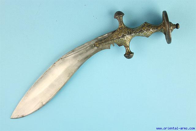

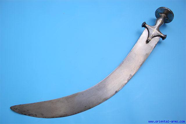

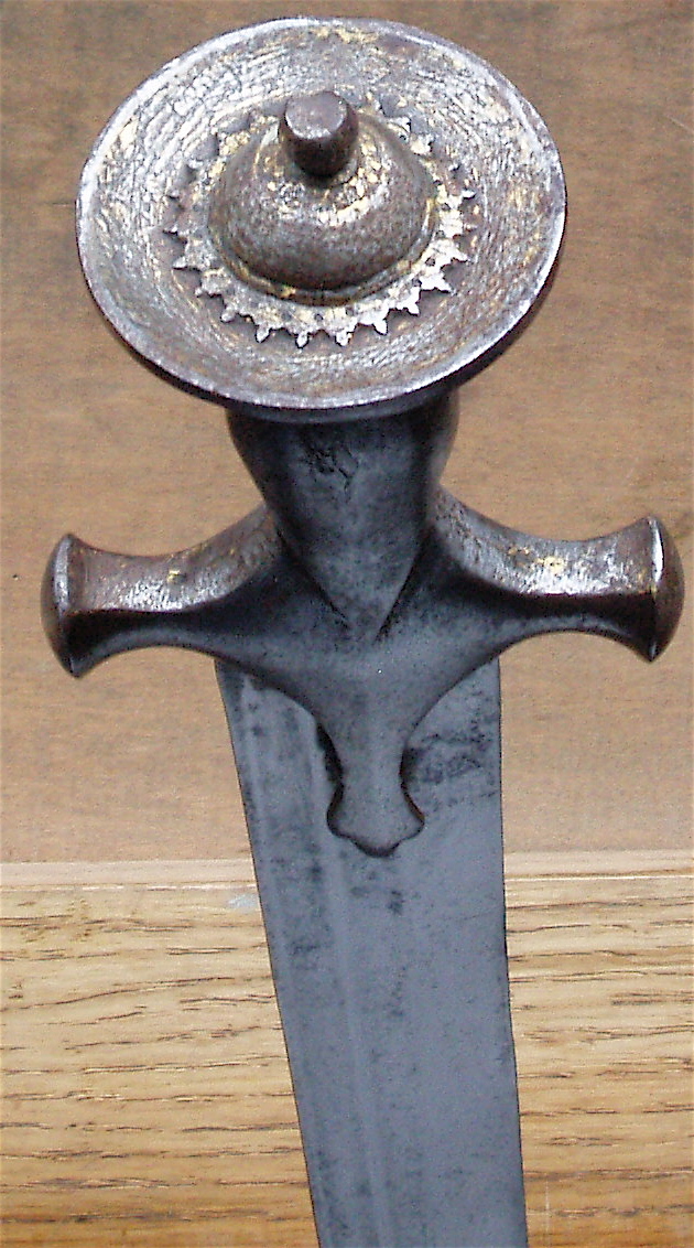

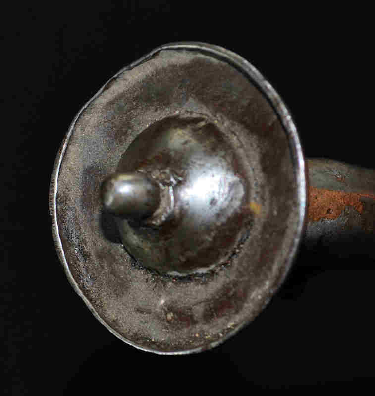

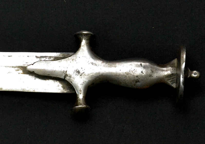

Hello Robert,
I think that what you are talking about is a Firangi not a Tulwar.
The Tulwar is characterised not as much by the hilt (which is common for several North Indian swords: Tulwar, Tegha-first photo, Soussun Pata-second photo, Firangi, Shamshir and even Kukri-third photo) as it is by the curved, single edged blade, occasionaly featuring a yelman.
Regarding the blade, it looks almost certainly European (Solingen?) but is difficult to say for sure from the photos.

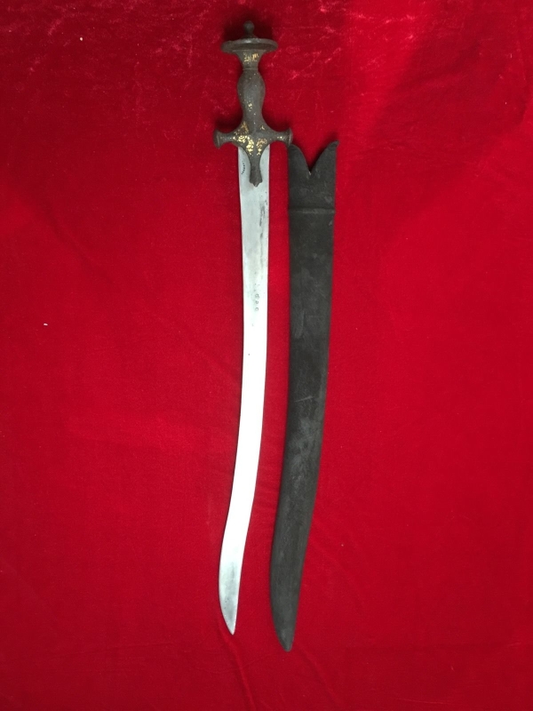

Old 22nd March 2017, 09:05 PM   #13
Norman McCormick
Norman McCormick's Avatar
Posts: 1,657
Hi Robert,
Here are some photos of my straight bladed Indian sword. The blade on mine is definitely not European and as yours looks like a very close relative I would suggest neither is yours. The hilt on mine was gilded at some point so not a munitions grade weapon. The hilt on yours is of a low quality as I'm sure you know but as has been said previously blades were rehilted as and when necessary so the hilt your blade now sports is not necessarily the one it started out with. I tried to look into this type of blade as much as the internet and the books I have would let me and I came to the conclusion, rightly or wrongly, that this is a Sukhela primarily because of the straightness and flexibility of the blade rather than any other attribute. I also think that my blade and I suspect yours do have a bit of age, at least the early to middle 190thC if not a bit earlier. I think these are good blades, light and fast, and my example is one of my favourite pieces.
Norman.

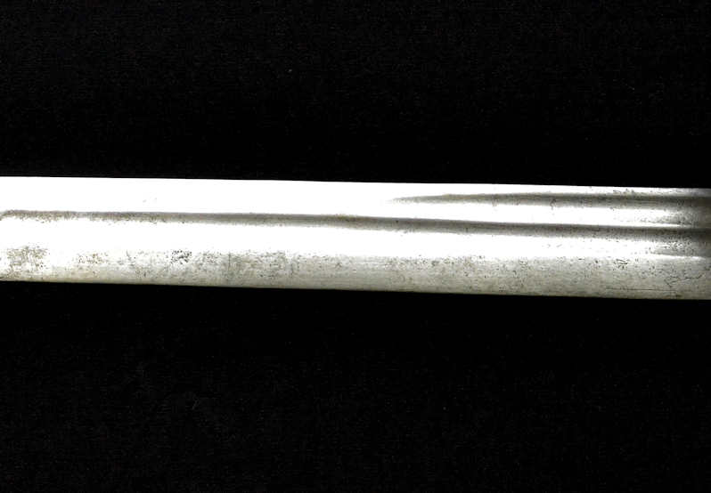

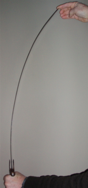

Old 22nd March 2017, 09:23 PM   #14
Posts: 6,436
And submitting this example for the umpteenth time.
Very fine grained wootz; light and flexible.

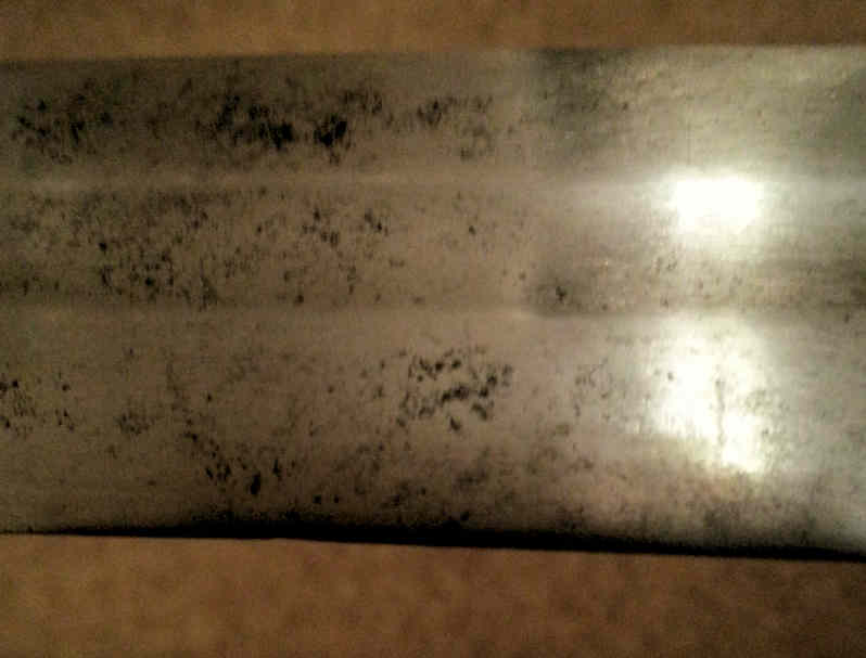

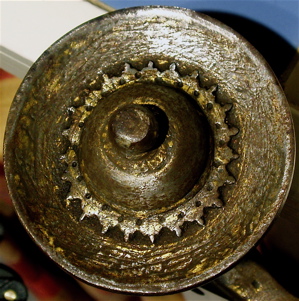

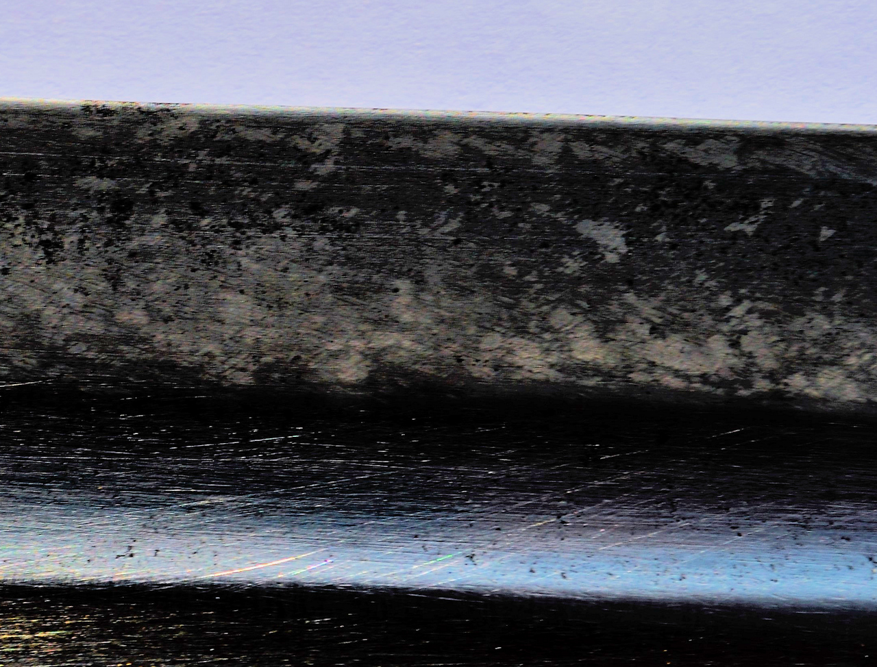

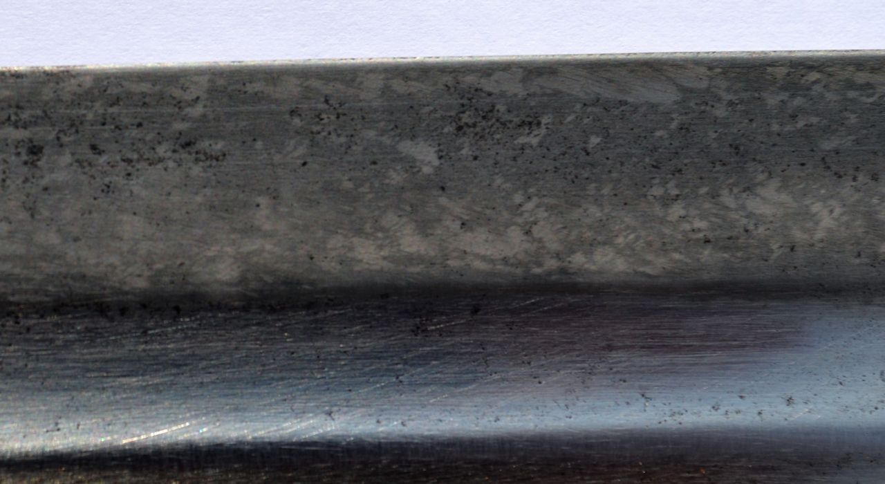

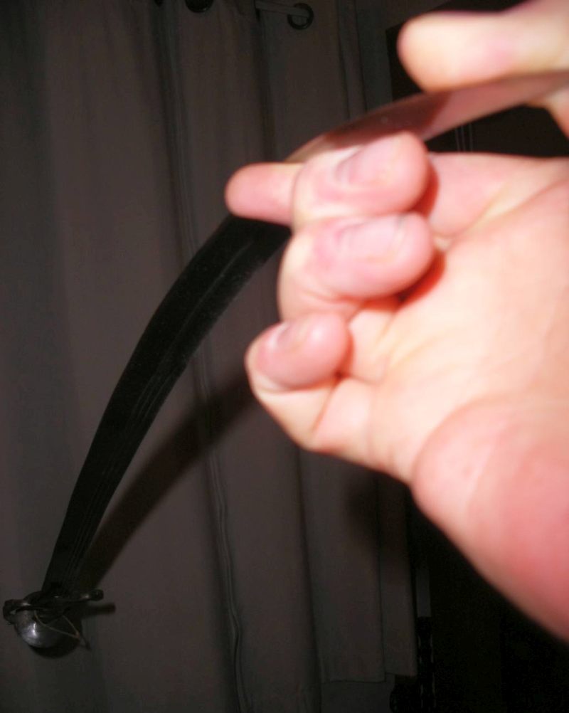

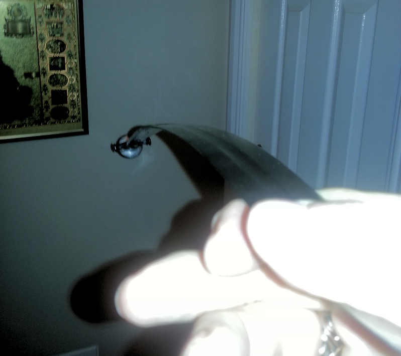

Wow, thank you all for your replies. A lot of information there. I guess that teminology can be a bit of a minefield in this area. Straight bladed tulwar , firangi (firanghi?) or Sukhela. This is facinating stuff, especially when fired up by a £40 sword.
Norman, your blade does look identical although mated to a nicer hilt.
Rick , I have tried to dupicate your picture with a little success. These really are nice blades.
I have tried to get a better closeup and include a picture taken with a USB microscope. I think the blade is mono steel but the pattination and pitting makes it difficult for me to tell as I have no experiance of wootz in the flesh as it were.
RobertGuy is offline   Reply With Quote

Def. the same blade characteristics.
From my experience these swords are uncommon.

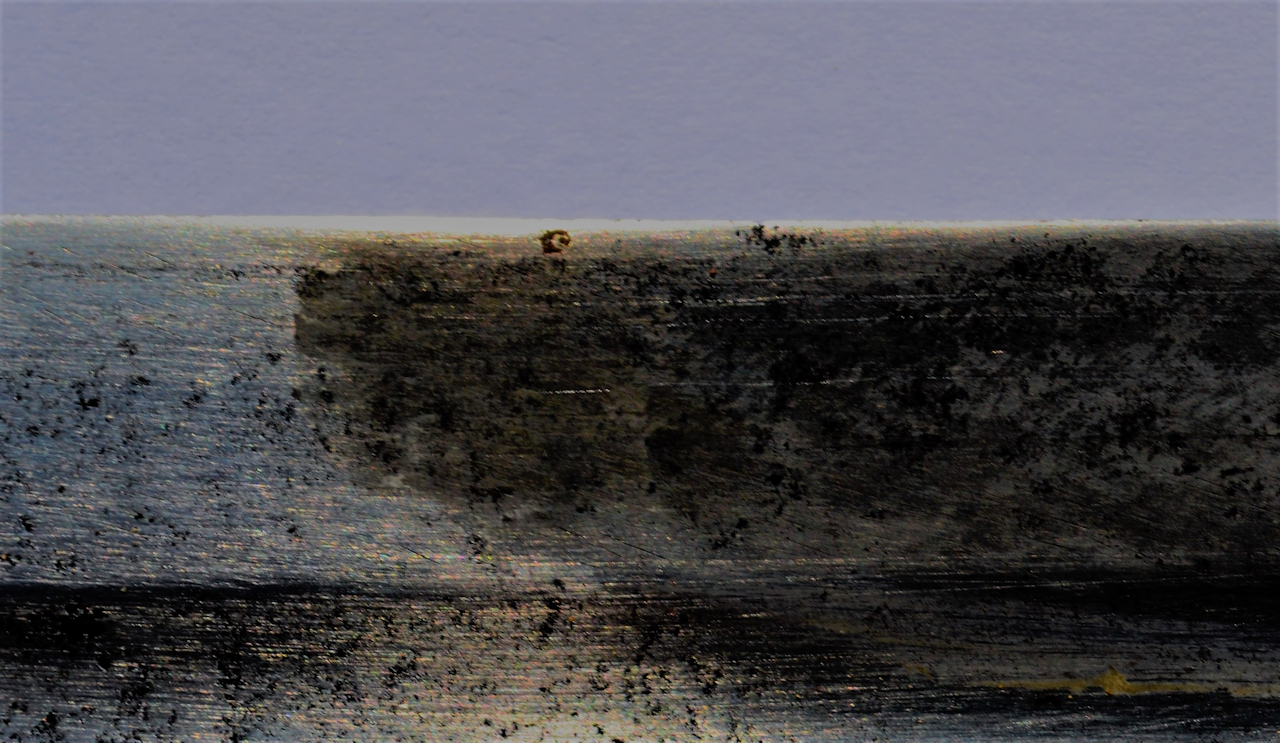

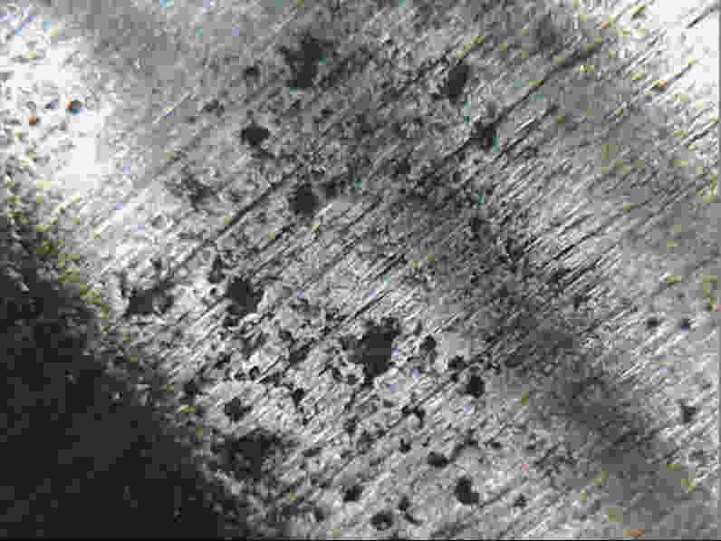

I've been thinking about Wootz and have tried to get some better pictures. I buffed up a portion of the blade and applied ferric chloride etchant to the blade edge.. Here are closeups with different filters applied.There mis a structure to be seen but is it Wootz? I do not have the expertise to judge. What do you all think?
Old 23rd March 2017, 03:56 PM   #19
mariusgmioc
mariusgmioc's Avatar
Join Date: Sep 2014
Location: Austria
Posts: 1,918
In order for etching to work, the surface must be first polished to grit 2000-3000. Then you may get some relevant result after etching.
However, I don't think there is any chance for your blade to be wootz as it doesn't even appear to be Indian.
