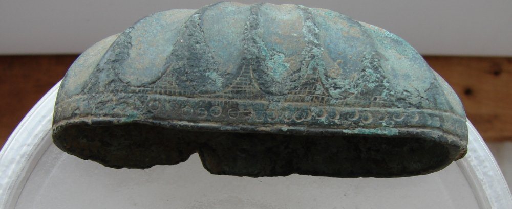

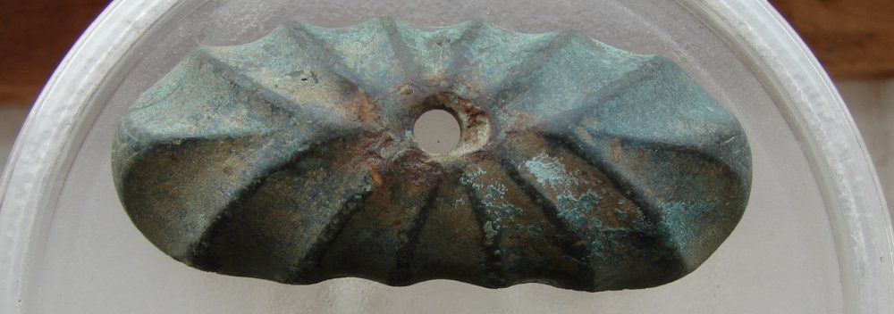

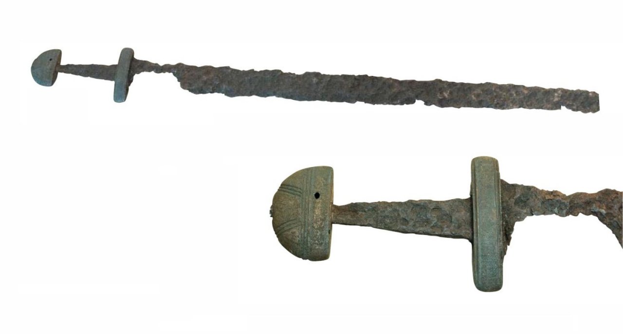

Colleagues,
Please, help to find out origins of this pommel from western part of Russia (Smolensk region). It's made of bronze.
Thank you in advance!

Originally Posted by Evgeny_K
Colleagues,
It looks Viking...

This pommel looks unusual for me:
- it has a different form,
- it's hollow
- it's made of bronze
I can't find similar pommel
- it's hollow
I think your pommel could be older, maybe from bronze age.
The pommel seems to be viking but the vikings were inspired by older designs, the Spatha or straight persian bronze swords for example.
https://en.wikipedia.org/wiki/Spatha
https://be-tarask.wikipedia.org/wiki/Спата
https://www.google.de/search?q=spath...w=1352&bih=763
Roland
- it's hollow

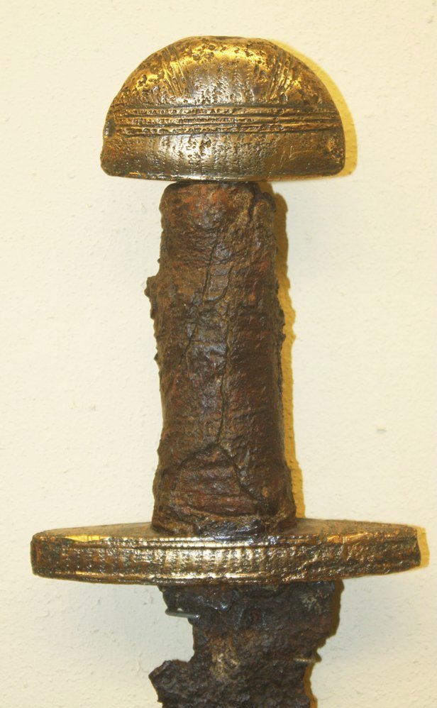

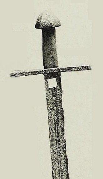

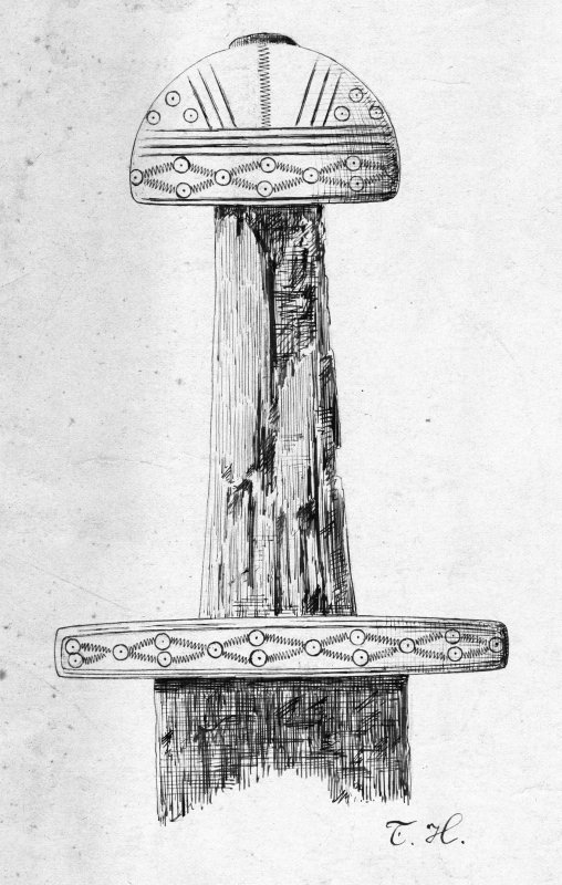

If it is from the Viking Age (which I am not certain it is), it should be compared to Petersen's type W, which are cast in bronze and hollow, and usually have some simple geometric ornaments. Here are two examples from Norway and one from Russia.
The fluting or faceting may point to a non-European or non-Medieval origin... I have only seen one example with something like this feature, and it is not related to the type W pommels.
Reventlov is offline   Reply With Quote
