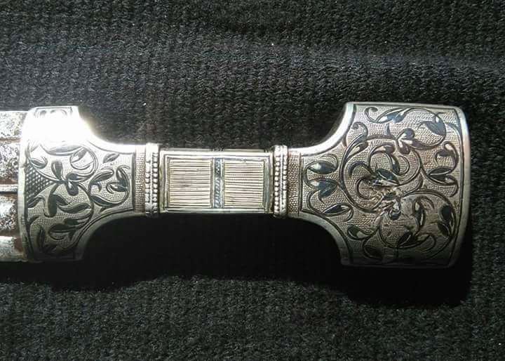

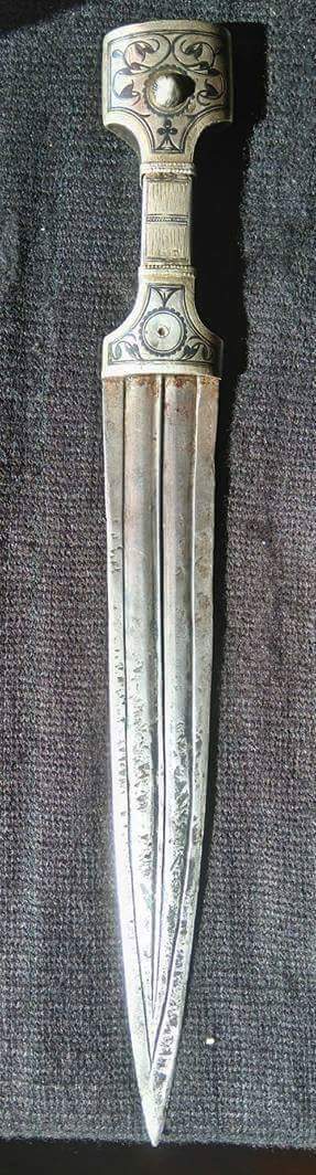

I would like information about this kindjal . I am aware that the holder was a Greek who brought from the war of Crimean.
The initials of the manufacturer is A. H and date 1843. It has yet to stamp on the silver 84 had in Russia. 40 cm long and wootz blade. What you say that could be the country of the construction area?

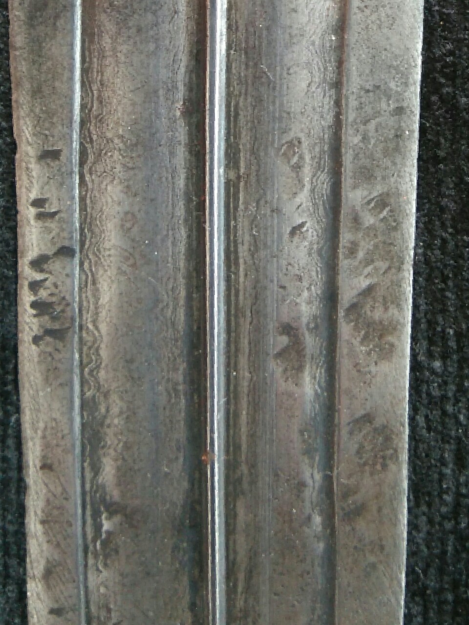

I see no wootz or just damascus.
Most likely, it is a Georgian manufacture, likely Tiflis ( Tbilisi).

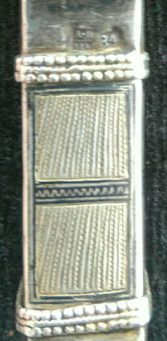

If there is a stamp, it would be nice to see its close-up pic.

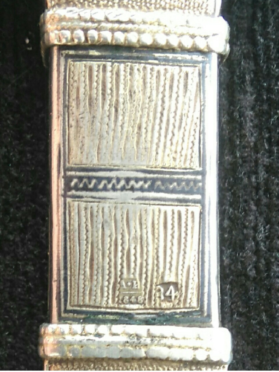

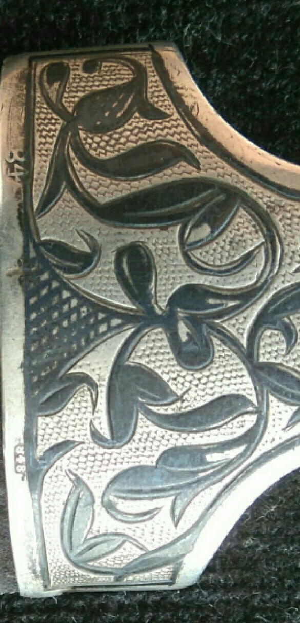

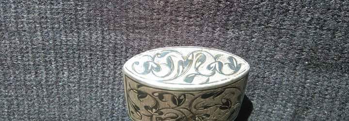

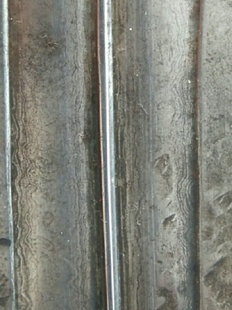

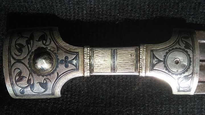

Hello
Some photos with mark's and the blade.

I was wrong to date , the correct year is 1848

I believe this is not a maker’s but a Russian assay mark. The second letter is an И (Cyrillic I). It looks nearly identical to the mark of assayer A. Inozemtsev of Novocherkassk , but he was, apparently at least, active between 1844-1847. There should normally be in addition a maker’s mark and perhaps a town mark. Comments from members versed in Russian hallmarks would be very welcome.

Hi Stelio,
Very nice Kindjal thanks for sharing. It is very similar in style to the Turkish Trabzon kindjal but the decoration and marks show it to be probably Georgian as stated by Ariel. Andreas is spot on with the name of the assayer. Anyway it is a very nice piece. Does it have a scabbard as they sometimes carry marks.

Old 5th September 2016, 06:01 AM   #7
estcrh
estcrh's Avatar
Join Date: Jun 2012
Location: USA
Posts: 1,492
Originally Posted by stelio
Hello
Hard to tell, maybe pattern welded.
