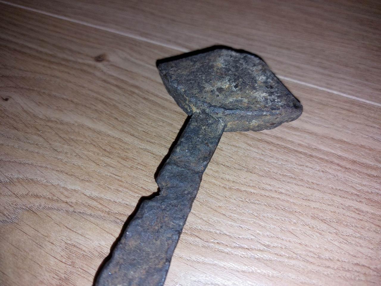

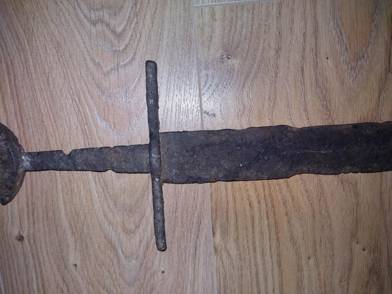

Ussually swords do not find their way into my collection but this one sparked my interest. Someone more knowledgeable told me it could be dated to the 1150-1250s. Found in the Donauknie.
Total length is 90 cm
Blade is 74,5 cm
Pommel is 41 by 70mm
Guard is 153mm
Blade is 46mm in width
Single fuller runs up to 57cm on the blade
Curious to know more

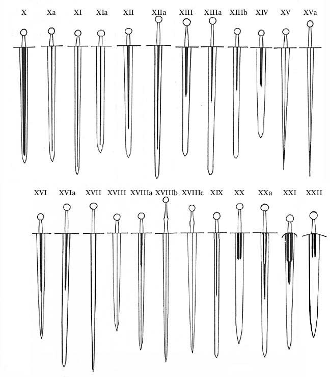

If i were to guess, it is a Oakshot type XII due to the tapered blade form and long fuller.
Personally i don own any reference books but a friend was so kind to show me these sources for the pommel shape. It would date the sword to 1150 up to 1250 (?)

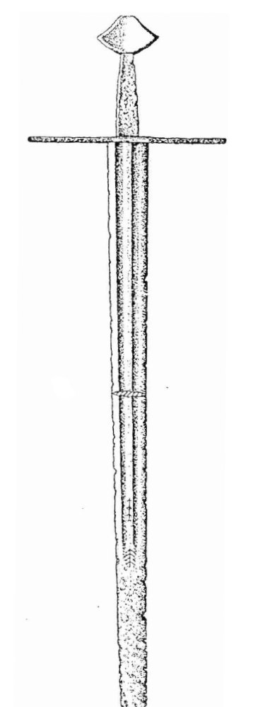

Looks a bit like these:
http://clasate.cimec.ro/Detaliu.asp?...075BEB0E4B5AF4
http://clasate.cimec.ro/Detaliu.asp?...AFDA7495D1E5F1
