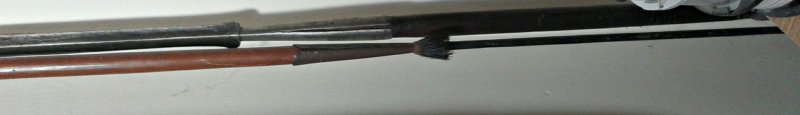

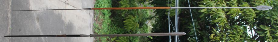

picked up this spear on e-pray, arrived wed. listed as: Tribal Spear - Prop - Theatre- Wall Display.
however i didn't think so. gambled a few pounds on it and won it.

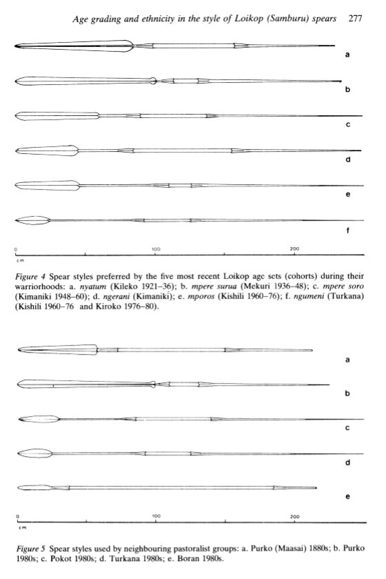

in 'Age grading and ethnicity in the style of Loikop (Samburu) spears' by Roy Larick (1986) it corresponds to the turkana style favoured by some senior warriors.
head is 23cm. x 6cm. it is VERY sharp & pointy with a central reenforcing ridge to the point
upper steel section, inc. head is 86cm.
wood centre section is 28cm.
lower steel section is 106cm, which includes a 2.5cm square end section with a rounded 'point'
balance point is 7.5cm. down the wood haft from the front section.
total length is 2.2 metres.
Samburu warrior with spear almost exactly like mine, followed by photos of my new one. it's leaning in a corner next to my maasai lion spear which is a tad ('bout a foot) shorter.nmote the little hair skirt just below the socket of the lower section, appears to be a 2.5cm. bit of cow tail skin, it's not sewn.

Looks authentic. These aren't very tourist-friendly - even disassembled they are luggage-challenging. Modern tourist ones are usually shorter in my experience (and often have fancy carved middle sections).
In the photo, the hollow sections of the blade look forge-blackened (tourist ones are sometimes painted black). That's usually a symptom of recent manufacture. If, instead, it's had the original forge-blackening polished off and is dark because it's patinated, then it's older. I can't tell which from the photo.
Given that the shank and most of the tail are round and of uniform diameter, the easy way to make one (for approximately the last hundred and a bit years) would be to start with round rod, and just forge the blade and socket. Which makes me wonder:
(a) whether the rod usually used has enough carbon for useful quench-hardening of the head, and if not, whether steel edges (or even entire steel blades) were added to the heads, and
(b) whether these long-shanked, long-tailed spears were made before imported iron/steel rod was available. It can be done, since similar long-shanked spears were made in antiquity. Does anybody have an example not made from rod to show off? I wonder whether the shank would be as uniform in diameter.

an excerpt from the ref. i listed earlier:

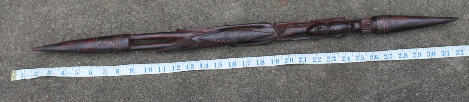

There are tourist spears made that are quite different. I've seen very small (total length only about 4'/120cm, assembled), centre grip section carved as a human figure (not good ergonomics for a working spear), and more. Clearly ornaments rather than tools/weapons.

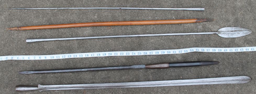

Here is my one of these, and my lion spear.
In the assembled photo, the clothesline they're leaning on is about 170cm/5'8" high.
And because I was talking about them, the middle section of an ornamental spear. Despite the large size of the wooden section, the head and tail were quite petite (they're probably in my magic box of spear parts, which I can't easily reach at the moment).
