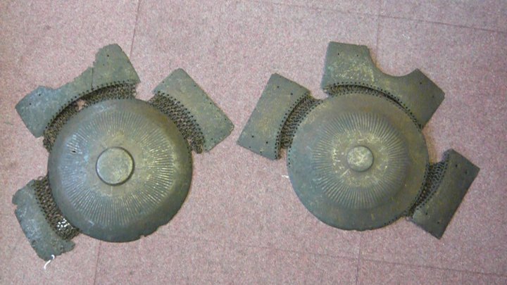

For consideration;
16th century Turkish, Ottoman Krug, front and rear breat plates and attachments.
An exceptionally rare find.

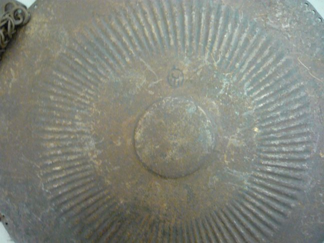

Armourers mark from the armoury of St. Irene in Constantinople.
Genuine enquiries only.
Further images available.
Cleaning/rejuvination available on request for free.
For sale by POA and offers
I have been asked to publish these in a forum discussion but I have refrained as they are for sale.
I will be more than happy to participate in a discussion upon their sale and if the new onwer approves use these images and that of others for a discussion topic.
Thanks to all for your continued interest, still many things to list and many more enroute.
PM or email through here or my site.
Gavin

It would be pretty rare if they were a set but these are both breastplates. Ottoman backplates are a little different form

I do beleive you are right though, I did however think the rusted top panel attached to large centre circle plate typical of rear Krug plates was once straight and the smaller circle breat plate was the front piece consistant with front plates having smaller circles???
Stone's glossary show on page 39 that they are almost identical as per the image from the presentation in the Reale Armeria di Torino.
The only exception between front and rear is the rear has a straight cut top plate attached that the gorget/shoulder plates join to. I will gather some more images of this armour in due course and publish them on the site.
Gav

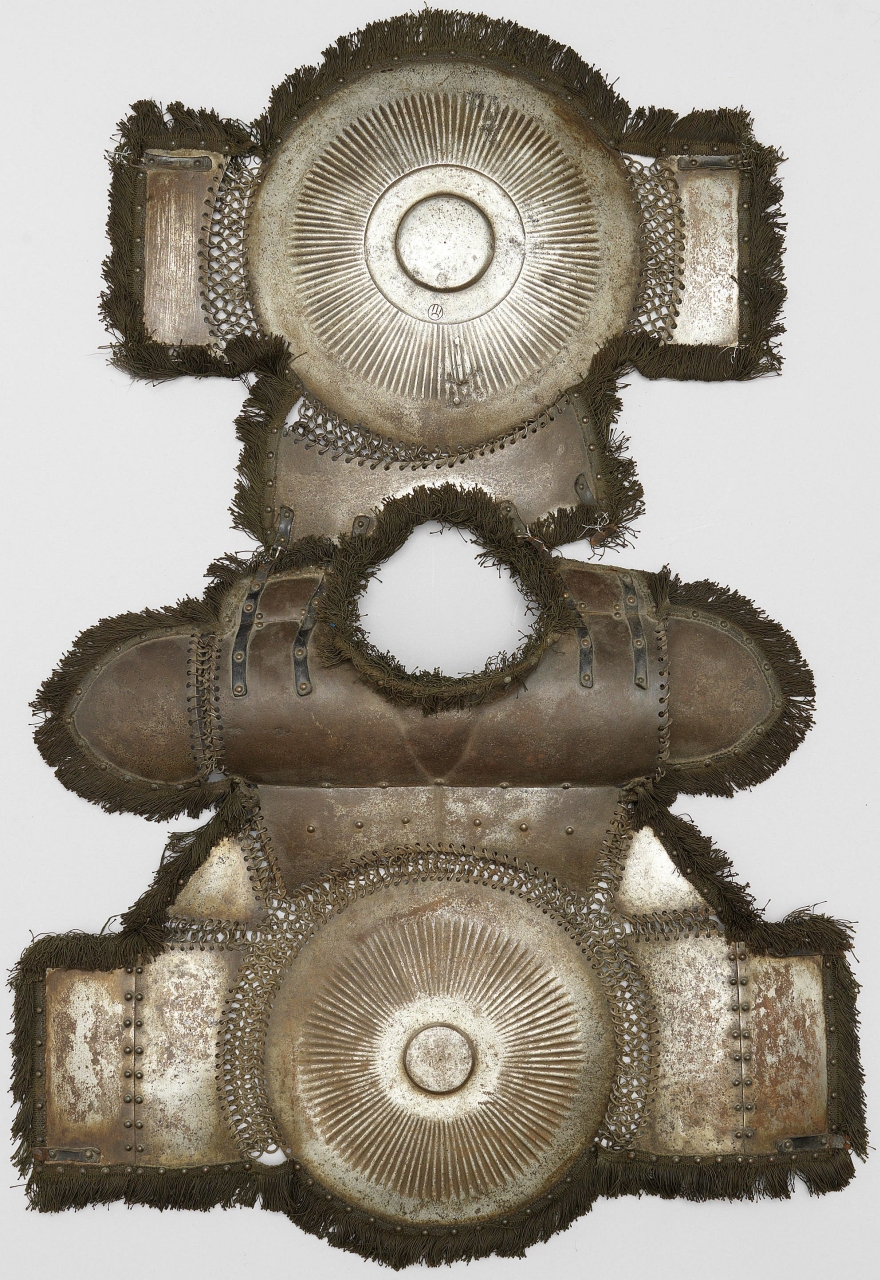

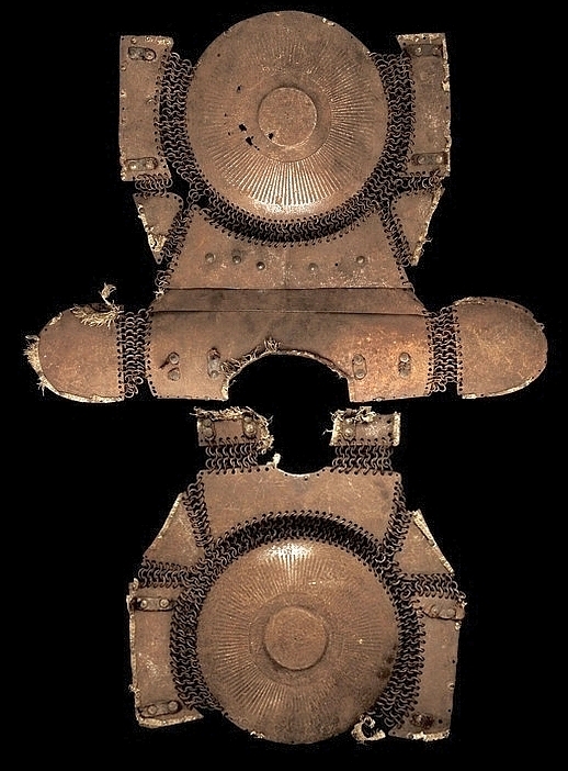

A couple of full krug images laid out so that the individual parts can be seen, these images were not available when this thread was started. The breast plate would have a curved area for the neck, the back plate would be straight as the shoulder plate that the back plate attaches to has a curve for the back of the neck.
