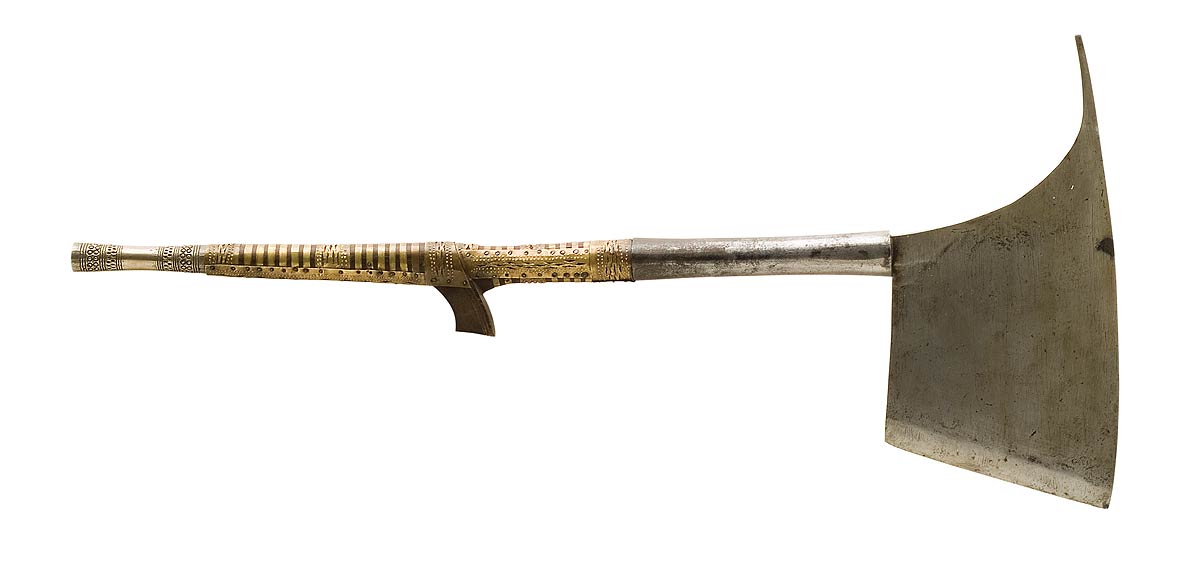

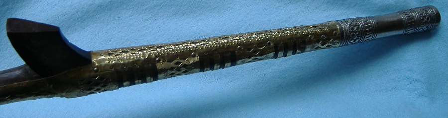

I generally don't collect items outside of the Muslim portions of the Philippines, but this Kalinga axe was so strangely elegant in its own right that I could not resist. I know very little about the Kalinga other than that they were headhunters and this was supposedly their "head axe", but like so many tribal people, I believe this evolved from a tool, or at least had a dual purpose, with the elongated spike stuck in the ground to create an upright and fixed cutting edge.
This one is 23.5in. in length with an arch-topped heavy axe head of 15.5in. suppported by an 8in. steel ferrule. The remainder of the haft is wood decorated with hammered brass rings and pierced bands and vertical strips. The haft terminates with a silver alloy butt that may be cast. I don't see how this one could be a fighting axe as it has no balance at all past the bottom of the steel ferrule. It feels clumsy and fragile if held by any wooden portion. I am supposing all the "bling" made this example more of a status or ceremonial piece? I'd love to learn more about these, and an estimation of the age of this one. I have cleaned up the brass and silver to accentuate their details. |

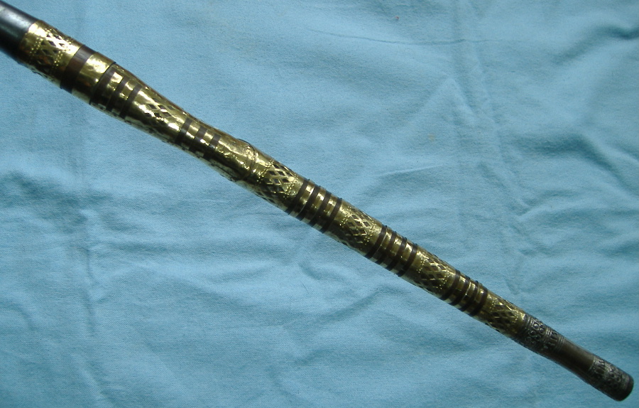

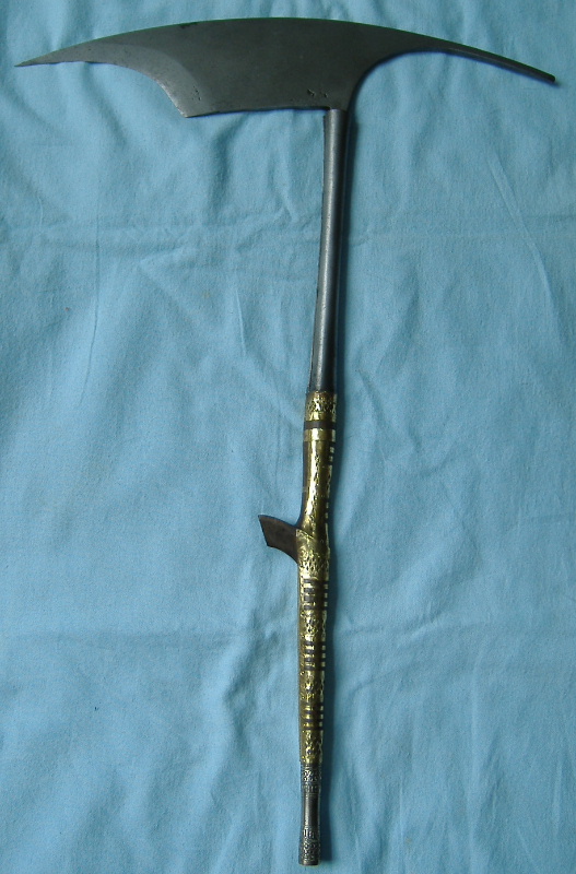

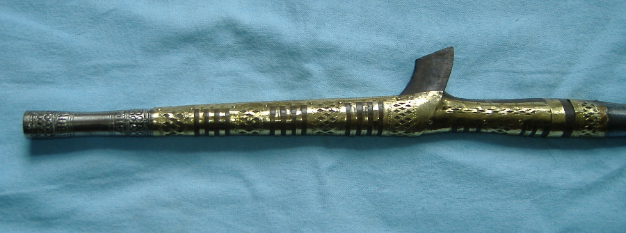

Robert is right, the thread he links to is a great discussion. I enjoyed it as I was reflecting on this recent acquisition from Oriental Arms.

Marcus, thank you for posting photos another fine example of what IMHO I believe to be a later (though very nice example) of a kalinga axe for comparison to the one Charles has been so fortunate to acquired. I would have felt very fortunate indeed if I were to have been able to add either of these pieces to my own collection. My congratulations to you both on your good fortune.

Marcus, it's good to see the authentic brass inlay style. There are some recently made versions that use metal staples to produce a similar pattern and these are just brutal to hold or try to use--bloodied palm and fingers from gripping the sharp metal inserts makes them purely display items! Ian |

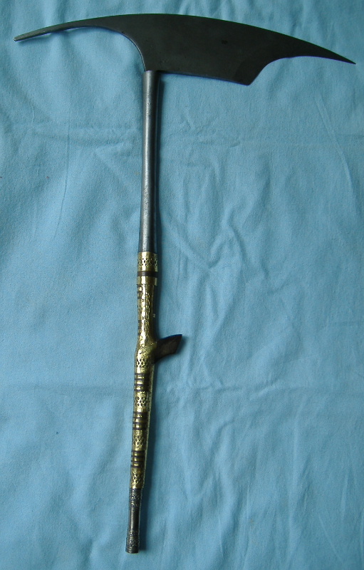

I just got in an old copy of the book by Samuel Kane. This is the front piece.

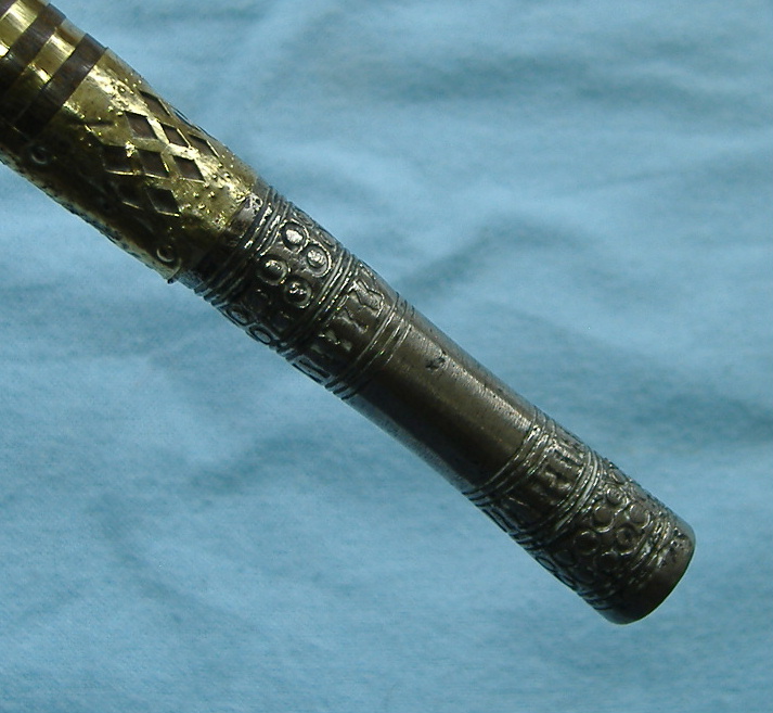

the tip on that is silver??? now i have to look at mine closely if it is as well, lol. |

This is indeed a Kalinga status and ceremonial piece. In the past I had been saying that this is a datu piece, but since then I have discovered that this type belongs to great warriors of note. The designs are based on body tattoos (that are earned through head hunting and deeds). Such a person might even be a leader or pangat, but decisions are made by a counsel of pangats, unlike the datu in the south. The Bontoc, et al, also hold similar practices when it comes to this type of head axe. A very prestigious piece. |

And t dennee, silver, copper, and brass are ok to polish and clean, but not bronze (I do). So polish away!!!!! ![]() And Marcus, I think yours is more for usage than ceremonial - looks a little stronger than the ceremonial ones. Again, however, those inlays are more from tattoo designs, basically tattoo-ing the piece in a different method than Charles' piece. |
