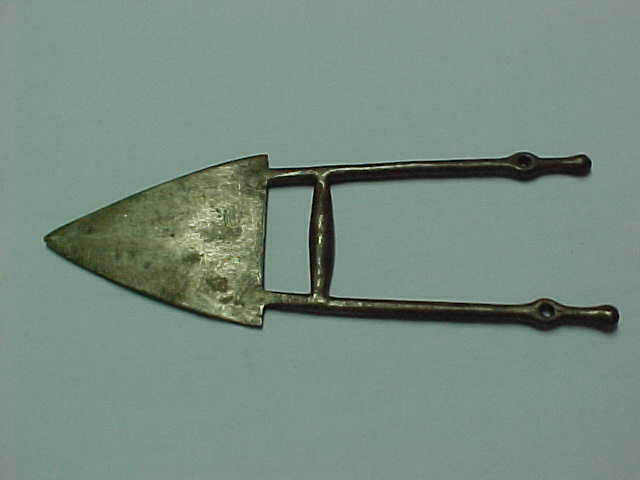

I have picked up a couple of unusual pieces that I have no clue as to what they are and would like some help from the broad range of knowledge this forum consists of. I don't know what to call this first odd piece. Is it a bayonet? Is it affixed to a pole for fighting? For gardening? It does have a strong ethnographic feel to it. The "blade" is triangular and has some simple line decorations. They look familiar to me but I am unable to put my finger on it. There is a cross bar near the blade and then at the end of the horizontal bars are holes. These horizontal bars end in a knob like shape. The angle of the holes are peculiar to me and I just can't picture how it would be mounted up. The "blade" is quite sharp. So, any thoughts on this piece?
Old 2nd April 2006, 03:42 AM   #2
Posts: 6,436
Arrow IMO
Certainly looks like a crude katar .
Is it of a size to be so ?
The eyes could be for binding it to the forearm with a cord .

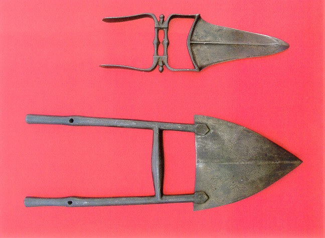

I doubt that you will find many of these, but you can see one in Tirri’s book ‘Islamic Weapons’ page 297, figure 218 (see below).
Here is what he writes about it. “Jamadhar Nimcha is a short bladed Jamadhar (Katar). The short, three-to six-inch blade is usually proportionally wider.”
The fact that he shows it together with a katar from Sind, does not mean that they are both from Sind. Not all smiths were weapon smiths, but they could still make weapons.

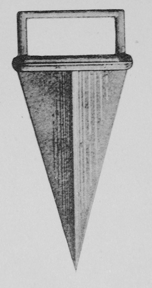

I have a picture in one of my books of a katar, at least as curious as the one shown. It is in P. Holstein’s book ‘Contribution a l’etude des Armes Orientales, vol. I. Plate XIII, no 19.
Besides the way it looks, there is another strange thing about it. In the text to the figures it says, “Garsoe-katar (Bhoudj, Catch). Collection Henri Moser, actuellement au muse de Berne”. I have seen the Moser collection several times, but never seen the katar, so I contacted the curator of the department and asked about the katar, but he denied that a katar looking like that was in the Moser collection. So it seems as if it either disappeared shortly after Henri Moser had given the collection to the Historisches Museum in Bern, or an error was made in Holstein’s book. Strange also that it is called a ‘Garsoe-katar’ as a Garsoe-katar looks like the upper katar shown in post #4 from Tirri’s book. It is the way the sidebars are made which makes it a Garsoe-katar, and the one from the ‘Moser collection’ does not even have sidebars.
If we say that the width of the grip is the same as on a ‘normal’ katar about 7.5 cm then the blade would be about 17.5 cm and the total length 22.5 cm. The way the blade looks, this would make it a very heavy katar, and no doubt difficult to used without sidebars and with only one crossbar.

Yes, it is of a size that it could be a Katar and given the additional information provided by Jens(thanks for the other example) I think we have figured this one out. I had given thought to this thing being a katar but just couldn't figure out what the holes were for. When you place your hands on the bar the two bars fall next to your forearm rather nicely and I can see how a leather strap would make for a very secure and stable weapon.

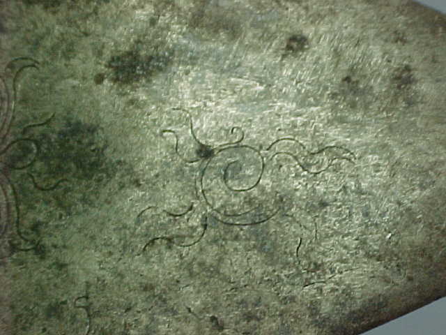

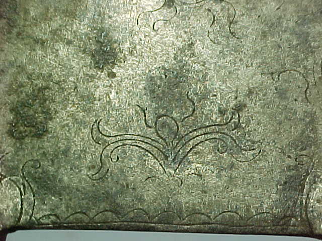

The inscribed marking are most interesting, any thoughts on the meaning or symbolism of these?
