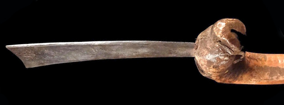

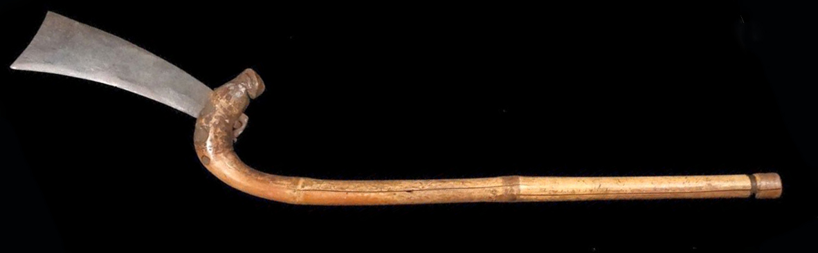

my Cambodian Mak axe for info, should arrive from USA in a week or so...

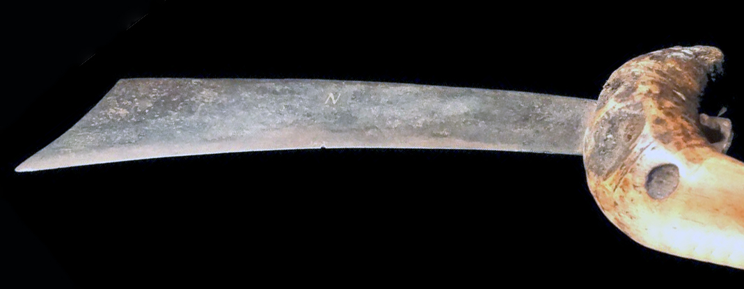

billed as mid to late 19c, hollow bamboo haft with bent base at solid root ball which is cut out to form a socket for the blade. blade measures 11.25 inches long by 2 7/8 inches at it's widest. sharp edge is on the inside of the curve. held tightly in place by a horizontally hammered in pin. length overall is 33.5 inches. haft needs a bit of tlc.
note the 'N' stamp on one side of the blade (?)
thanks in advance for any comments.
been looking for an affordable moro panabas, this reminds me a bit like one.

Nice example Wayne. More likely first half of 20th C I think, but a good solid exemplar. As you say, the shaft may need some oil and a little work.
These are still being made and used in parts of Cambodia, Laos, Vietnam. They are primarily a tool, but have certainly been used as weapons in the past.
Ian.

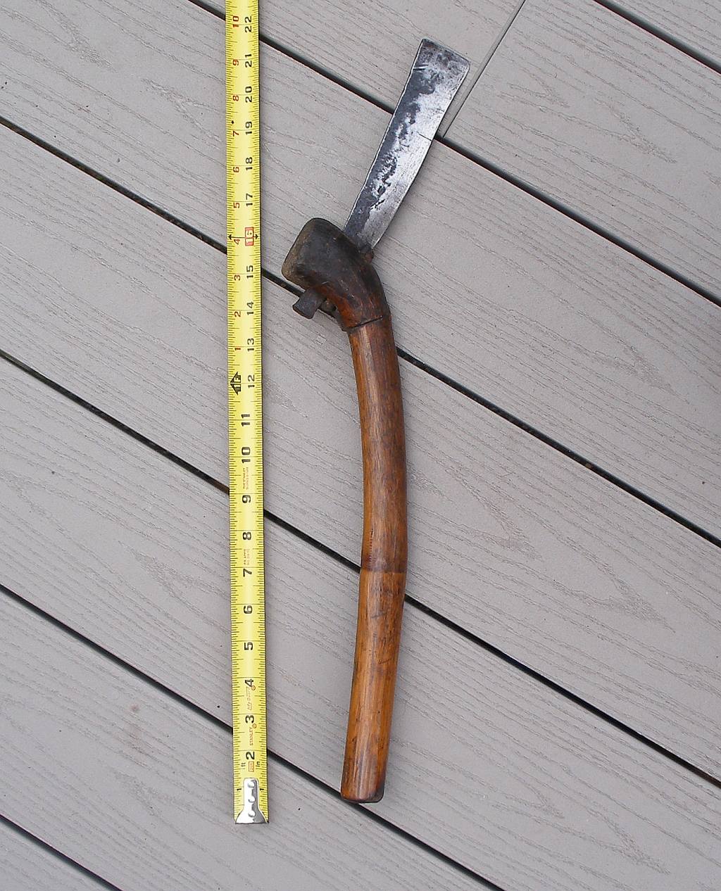

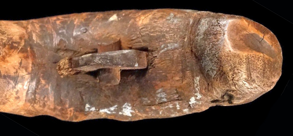

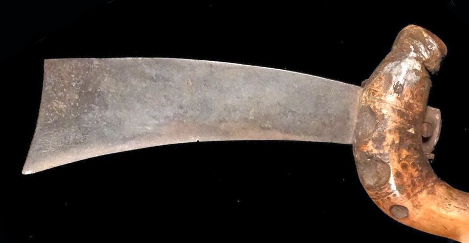

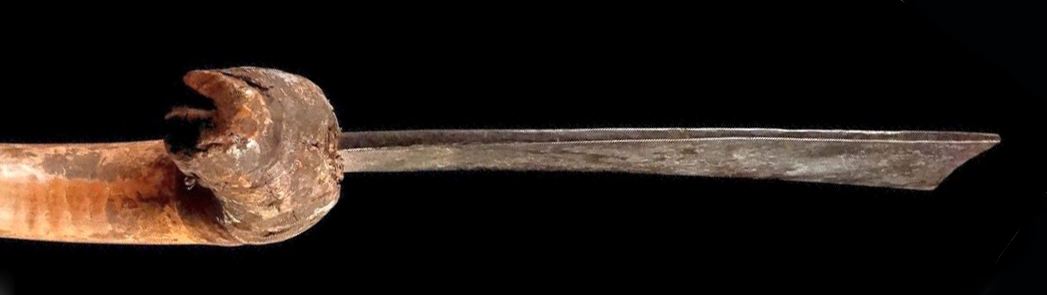

arrived this a.m.. as described. there is an added thin wedge inserted to tighten the blade to the root ball socket. looks like 'male' bamboo, very thick walls. looks like there was a band of wire or sheet metal about halfway down the haft, as well as the wire wrap at the base. blade spine is 5mm at the haft, distal tapered to 3mm at the tip. haft is 3 cm. dia. at the end. weighs 647 grams. sharp as heck. bit awkward for horizontal or angled cuts, overhead downward cuts are easier. will take a few more pictures later...
