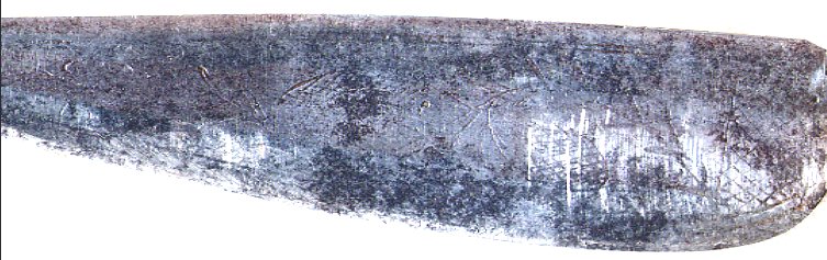

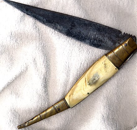

Rsword suggested months ago that I post this puppy. I got this years ago when I first started collecting. It is a clasp knife Navaja, but with white horn and African patterned brass mounts. On one side there are heavily worn engravings of either acorns or pineapples, and on the other side there is an engraved inscription in cursive: "Van aboor in varen" which I had a friend from South Africa translate from the Afrikaans ""From a true Boer" . Had someone else date it years ago to possibly the 1830s around the time of the Great Trek in South Africa. Enjoy.

I instantly recognised your navaja because I have one that, with one important exception, is very similar to yours. The inscription on mine says "Soy Anda de Sevilla". Other than this, the blades look like siblings. Mine has some brass inlay on the hilt scales (the center inlay is missing) but the shape of the blade, bolster, and butt cap are just like yours. Even the engraving on the side opposite the inscription looks like yours. Given these similarities I wonder if these blades were produced by the same company and variously engraved to appeal to specific ethnic clientelle. The backspring on mine is missing. Could you post pictures of yours? I would like to make a backspring but I need to know what it originally looked like.

this is not an African but a Spain / Sevilla navaja.

That is almost certainly a Spanish navaja, and given its general shape, most likely from Sevilla. According to samples given in Forton's Navajas Antiguas, it was probably made in the late 19th century, at a time when the navaja was on its way out of usage in Spain and the few cutlers that remained tried to sell their wares in the remaining Spanish colonies. How that one ended up with the Afrikaans inscription is a bit of a mystery as the blades were generally etch engraved before the knife was assembled. It could have been custom made in Spain for a Boer customer, or alternatively, the etched engraving could have been added later
There is always the possibility, though remote, that that knife was made not in Spain, but elsewhere, as they were made in many parts of the world, as afar as India, their basic construction being very low tech, though quite labour intensive - Perhaps by a Spanish cutler who migrated to S.Africa. The style of engraving on the bolsters and the blade strongly suggests Spanish workmanship.
On second thought, are you sure that inscription is in Afrikaans and not misspelled Spanish? Those cutlers were for most part illiterate and their spelling was notoriously bad - Those words could overlap with misspelled Spanish.

I am quite sure it is Afrikaans, especially since I am somewhat familiar with Afrikaans and even more familiar with Spanish. I think the message was engraved later than the manufacture of the blade.

It is indeed fascinating that this spanish navaja ended up in SouthAfrica.
Forton assures that national production was so short, comparing to local demans that, in fact, during 1850-1869 ( there are no prior registration records ) Spain has imported an average ( imagine ) one million navajas per year ... no razor specimens included ( the name navaja actually comes from a type of razor blade ). Instead, their exports were minimum and practically directed to Portugal.
So hardly this is a trade piece ?
I have resided in Durban for a couple years, working with Afrikaaner coleagues. Their language is fascinating, both sound and construction wise.
But it appears that afrikaans started to be written in Latin alphabet long after the Boer war, like around 1850... as it was written in Arabic before, for circumstancial reasons. Could it be that the inscription is from an iliterate ( like the majority at the time ? ) doing "verbal" writting ?. Couldn't an "official" text be close to VAN A BOER (IN) WAAR ?.
But then, if this specimen is "from a true Boer", doesn't this mean this is a presentation navaja, from a Boer to somebody, probably another Boer?
Such an interesting piece.
Sorry again to have interfered.
Old 7th March 2006, 08:19 PM   #10
Posts: 7,407
Oh no interference at all Fernando. In fact, you hit the nail on the head. I agree that the inscription was done by someone who could very well be illiterate and presented to another Boer.
