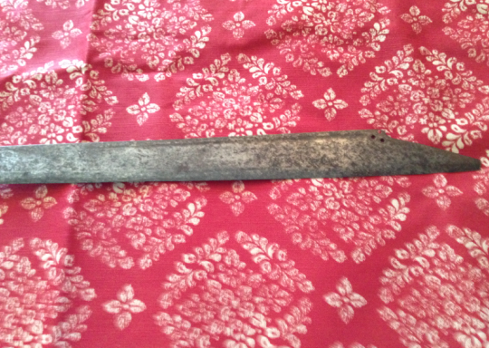

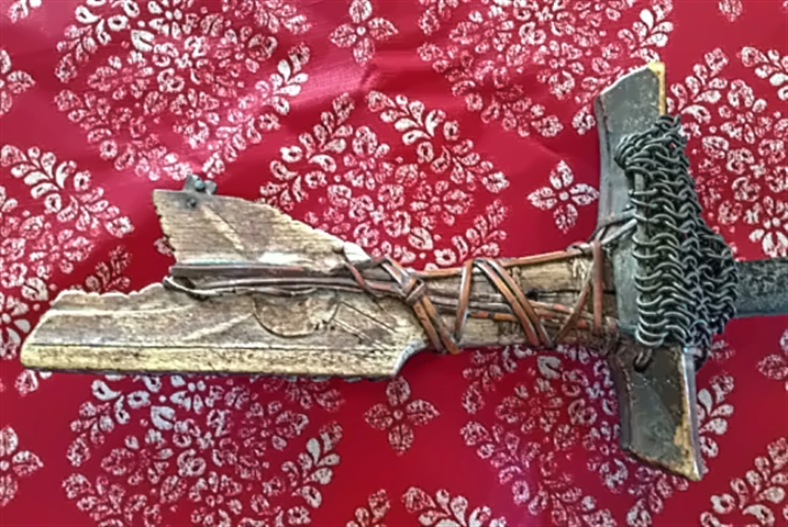

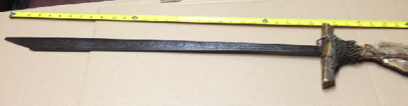

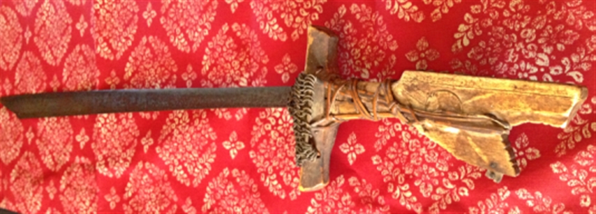

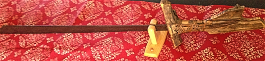

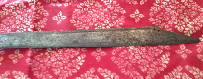

Hello Everyone,
I need info for this Kampilan. Age? description? When was this handguard used? Thanks for all inputs. Oldschldude
oldschldude is offline   Reply With Quote
Old 19th March 2016, 02:53 PM   #2
Very nice and great kampilan. I would guess that it is a middle until end of 19th century example. Would like to see the blade cleaned and etched. Also some better and bigger pictures. Can't remember to have seen a guard with chains attached. Maybe a Lumad influence?
Old 20th March 2016, 02:02 AM   #3
Posts: 7,407
Yes 19c. Needs some restoration and polish and etching. However, whalebone kampilans are hard to find.

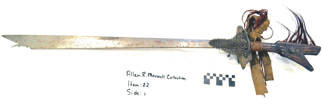

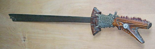

Actually Detlef, occasionally Moro kampilans will have 4-in-1 chain maille as part of the hand guard. This is not Lumad but Moro. Good question though.....
I also agree that larger pictures and close ups would help tremendously when you get it.

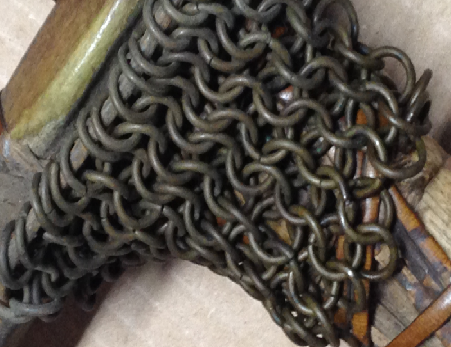

Hello Oldschldude and welcome to the forum. I am in total agreement with what Detlef and Jose have already told you. I did though try to get a little more detail out of your photos. Not much better than the originals, but will have to do until you can post better ones after it arrives.

Thanks, Ill put some new ones tomorrow. Also Thanks for peoples reply

Old 20th March 2016, 08:17 AM   #6
Hello Jose,
like said, never seen this before. Can you show samples?

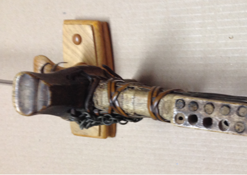

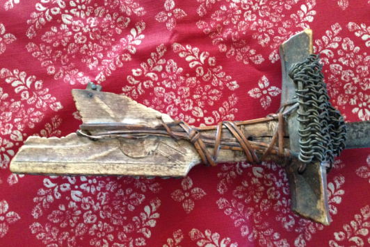

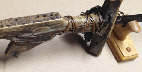

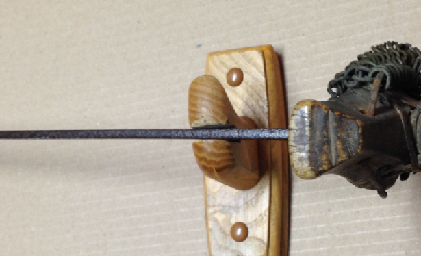

Default More Pictures

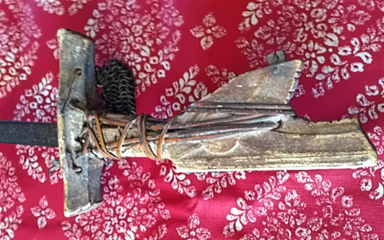

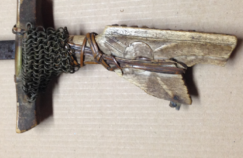

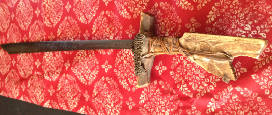

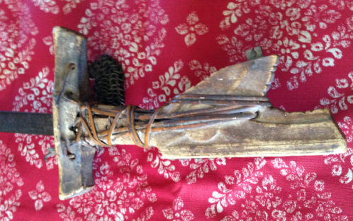

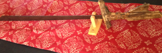

Here's some new pics. Hope this help..Thanks!
P.S.
Just got a few questions. Just curious, Why dated mid to late 19th century and not an (late) 18th century sword (I wish). Is it determined by the chain mail used in the guard introduced during that time/ moro armour. Filipino whalers during that time? The wideness of mouth of crocodile on the hilt(shape of hilt)? Shape of blade?
Oldschldude

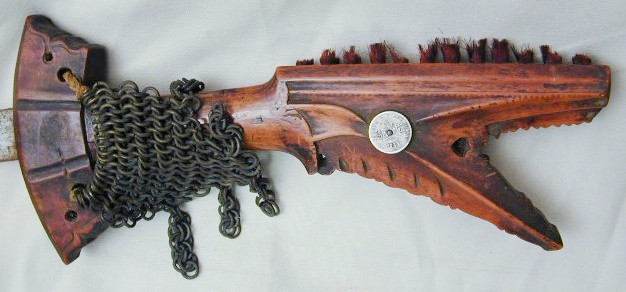

Since you asked, here are some pictures of one that was on eBay (and later owned by Rsword):
Old 22nd March 2016, 02:56 AM   #12
Posts: 7,407
And here is another example from the Peabody Museum here in the United States:
Oldschldude
All good questions. On dating, you do have a good point. It was a safe dating, especially since many I have seen are from this time period. However, after looking once again at the patina on the cross guard,perhaps it could be earlier. Not much is known about these and dating.

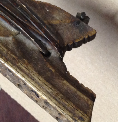

Oldschldude:
Very nice kampilan and congrats on finding such a good piece.
I just have one question. Are you sure this hilt is whalebone? Old wood that has dried out and been "weathered" can look very similar. I'm not seeing the porosity in the hilt material that I associate with whale bone, but I can see a longitudinal "grain" that makes me think this is perhaps wood. Also, the carving has remained very crisp for whale bone, which tends to crumble a bit with repeated handling. The cross guard appears to be wood. Whale bone would also be a rather fragile material on which to hang chain mail.
Just a few thoughts.
Ian.

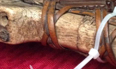

Originally Posted by Ian
Oldschldude:
Ian.
Hello Ian,

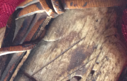

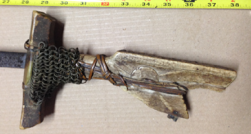

Thanks for the greetings! Good point there. Yes I'm sure its bone and not wood. I would like to take more close up pictures but its very fragile as the rattan reinforcing the hilt to the guard had already snapped. Although there's a part on the guard where the chain rubbing on the guard had rubbed off the dark patina exposing the bone and polishing the bone. (In one of the pics I already uploaded.) Its also possible to my opinion, that the guard is probably from much stronger part of the whale(or maybe even ivory) hence darker patina and stronger than the hilt as to supporting the chain as you mentioned. Thanks for your reply. Oldscldude.
I've edited this reply cause I found more pics in my phone. In one of the pics I attached, the hilt/handle looks like whale bone grain. One of the pics also is a close up. You could zoom into it. This Kamp is just really really old and needs attention but was stored safely for a long time. Thanks again..oldschldude.

By the look of better pictures, it sure looks bone to me!

Default better pics, again.
Sometimes its hard to tell or analyze without clear or closeup pictures. (Got me looking at it again.) From some philippine swords I have seen in the internet, few do have white weathered bleached wood with patina or driftwood looking hilts or scabbards. Thanks Battara and everyone for their inputs...Oldscldude

Yup that's bone alright!
Great close ups!
