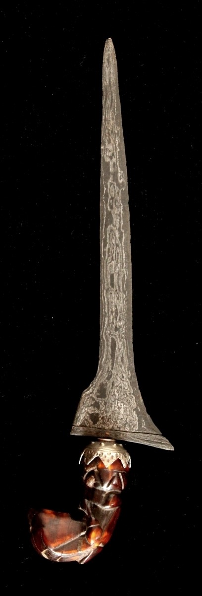

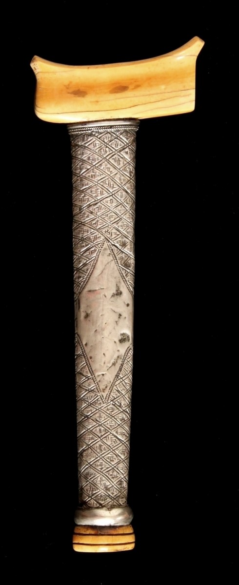

I own this small kris (the blade is 20 cm long) and I guess that it originates from Sumatra but it is not typical of any regional style so I am looking for your opinions. The piece has age, and the blade & scabbard are matching well and had been together for at least several decades. The Jawa demam hilt, sampir, and buntut are made from ivory.
Old 30th March 2016, 06:31 PM   #2
Posts: 7,297
Thanks for posting this Jean. I love patrems. This is a lovely example. I would agree with Sumatra, but i am afraid i cannot pinpoint it further for you. I have found that many patrems do not exactly adhere to regional styles.

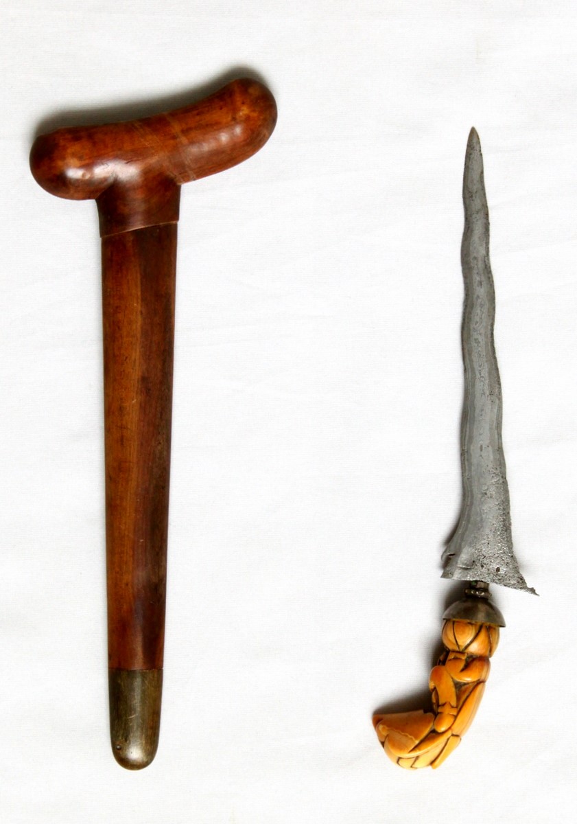

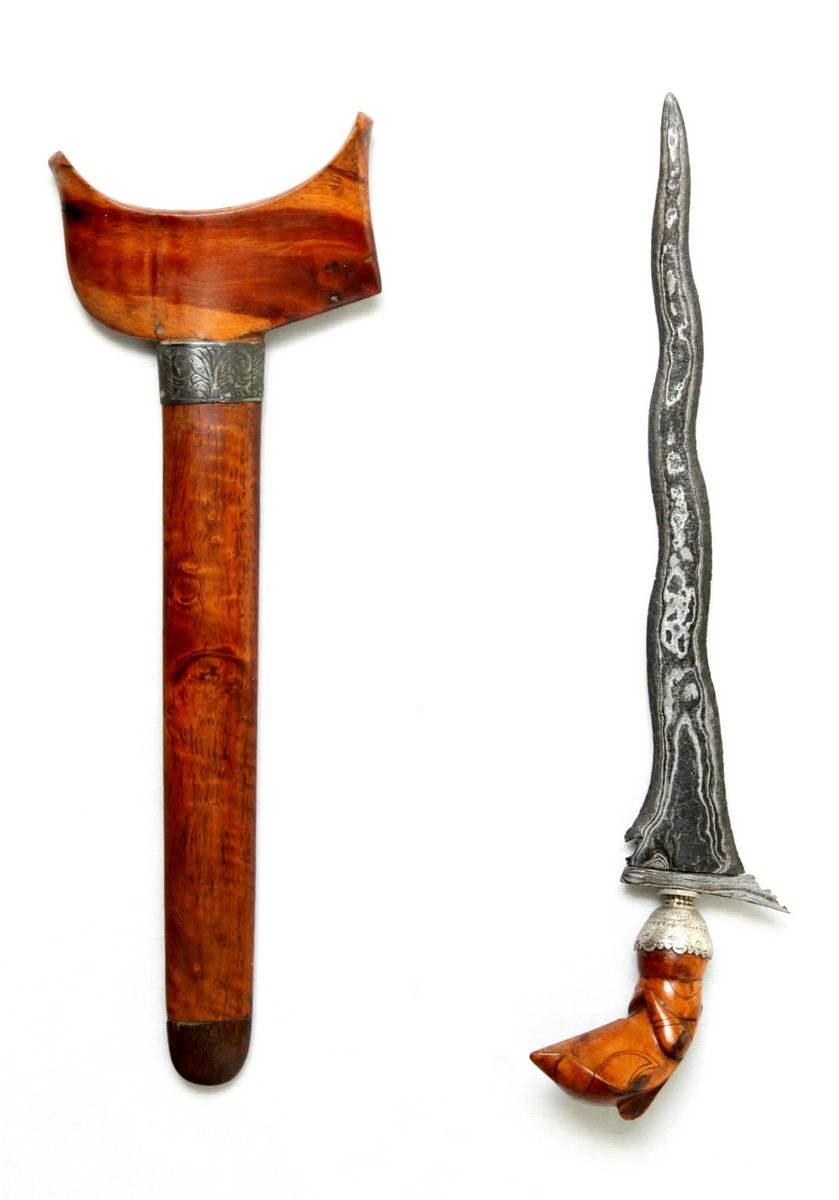

Since David loves patrems, I am showing 2 more small krisses also expected to originate from Sumatra, but other opinions are welcome:
. The first one is a small Bugis kris from East Sumatra?, the blade is 23 cm long and was recently stained.
. The second one is a miniature kris (blade lenght 16 cm) with a matching Jawa demam hilt from ivory, and the style of the scabbard is peculiar.

Love these too, but my favourite remains the first one. Thank you for the photos!

I guess that these pieces were worn by women or even a kid for the last one but who knows?
