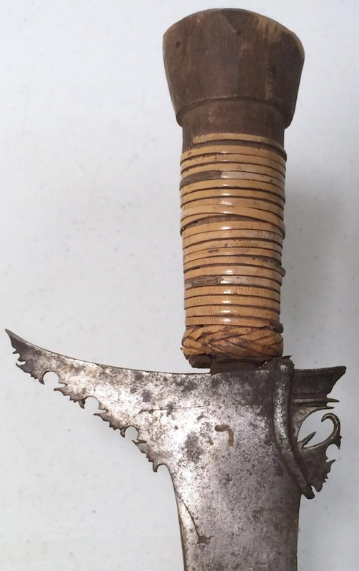

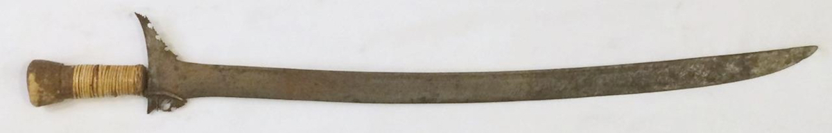

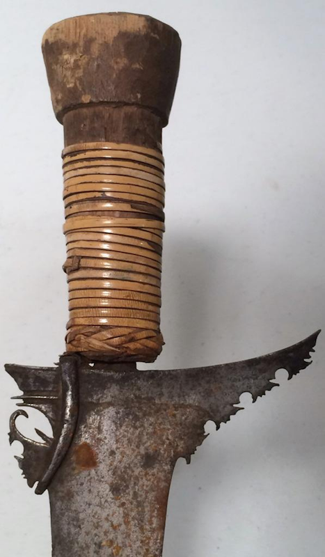

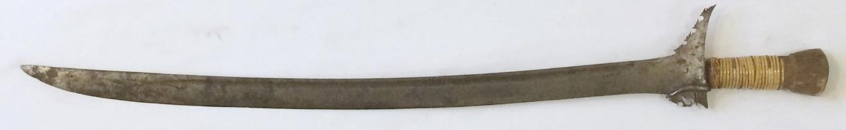

This one finished online today. A most unusual curved Moro kris.
Saber-bladed Moro kris are seen from time to time and appear to have been made by Moro panday as a "custom order." I have not seen a foreign blade remounted in this manner, but my experience is limited to no more than a dozen examples over the last 25 years. Others may have knowledge of such examples.
Curved blades were obviously used widely in the Islamic world, and there are plenty of examples from nearby countries. The presence of colonial powers (Spain and the U.S.) in the region no doubt offered further examples to be examined and imitated. However, just why a Moro warrior might want to make a radical change from a kris to saber, and learn a completely new set of skills that were not well developed locally among his people, is an interesting question.
Ian.

My assumption is that this is a foreign blade that has been re-forged. I have seen at least a couple more similar to this. I am sure there are photos somewhere in our archives.

I saw it and was a bidder. It went way to high for me. I did not have it in hand to be sure. However from what I can tell it is indeed a saber point kris that was made that way. There did not seem to be any indication of it being reground or reworked to that type. The only reason I was not willing to go higher is the handle is not correct. Other than that in my mind it is for sure a Sulu kris.

I am still not convinced that the example that started this thread isn't a re-purposed old saber blade. Blades can be re-worked. We don't need to see attachment weld marks for this to be the case.
