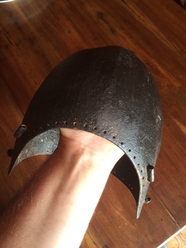

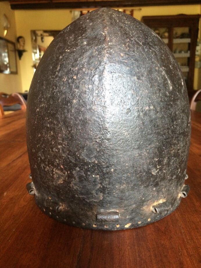

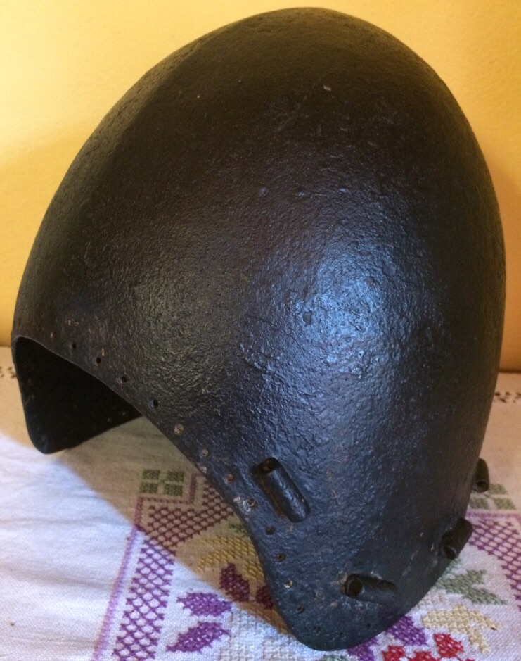

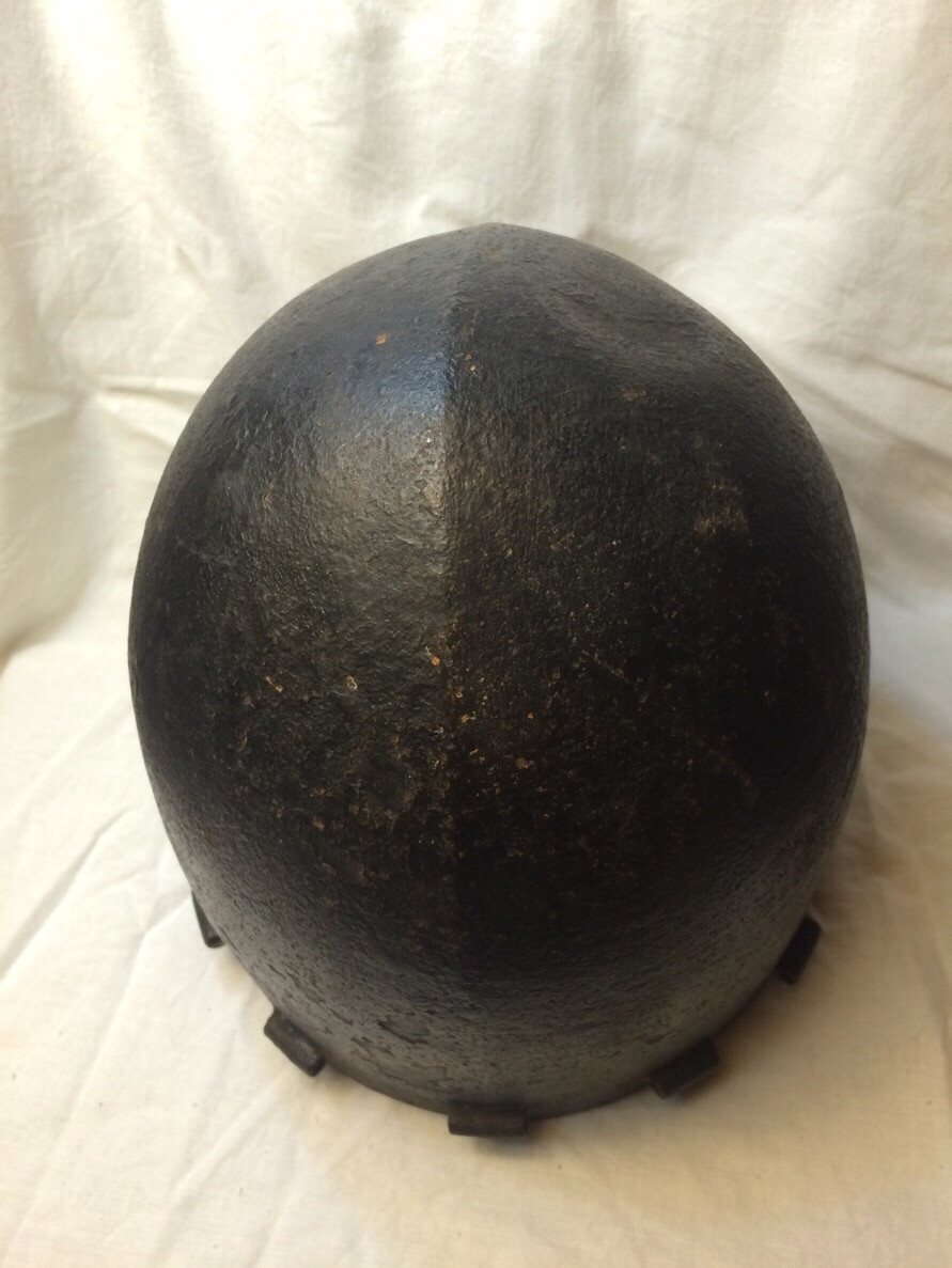

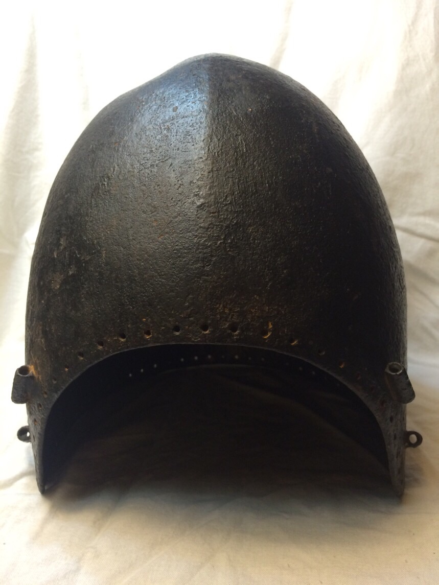

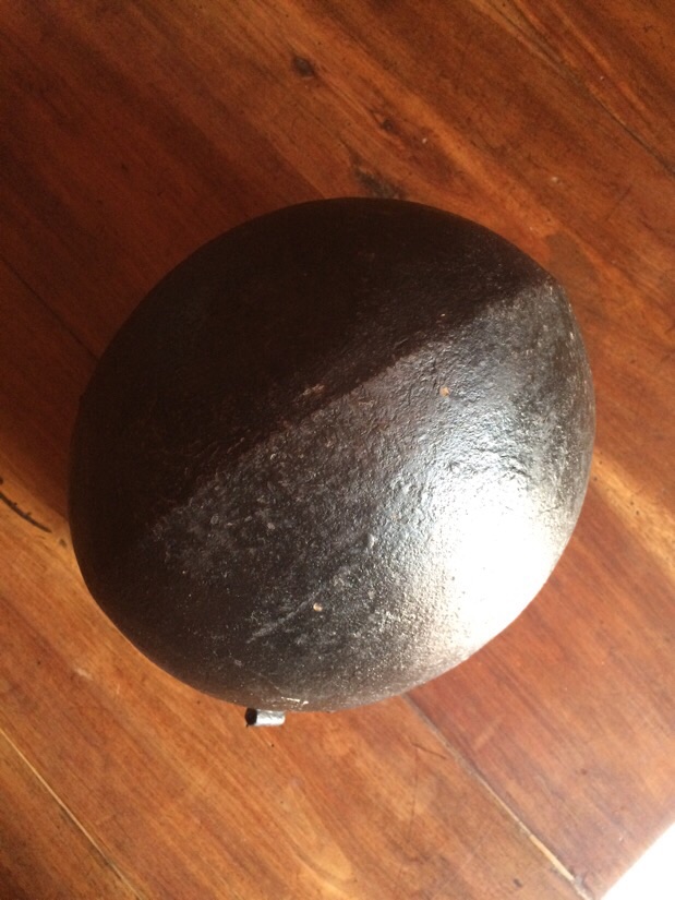

Hi at all , I Recently purcheased a collection in Germany And there was this helmet I m Really fonding hard determinate the age !
Any comment ! Input in this type etc !? Thanks berberdagger |
#2 |
Location: Netherlands
Posts: 543
This is either a very nice replica or a 1470s orso helmet.

Ah it is 2,6 kg And Size is 22x20x21

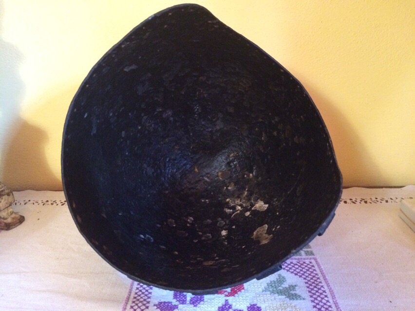

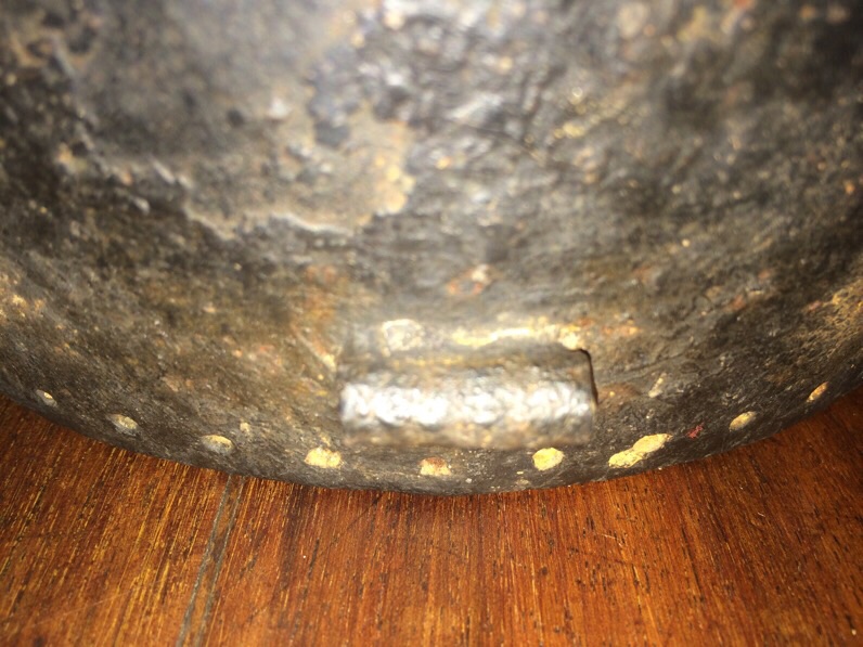

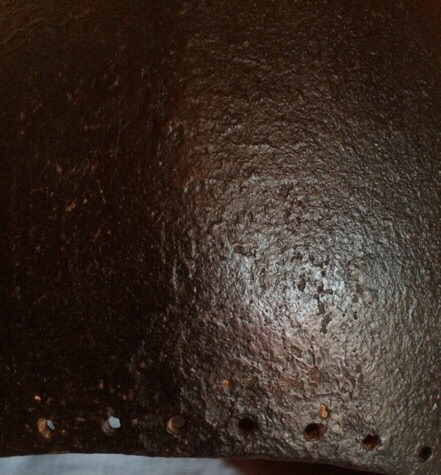

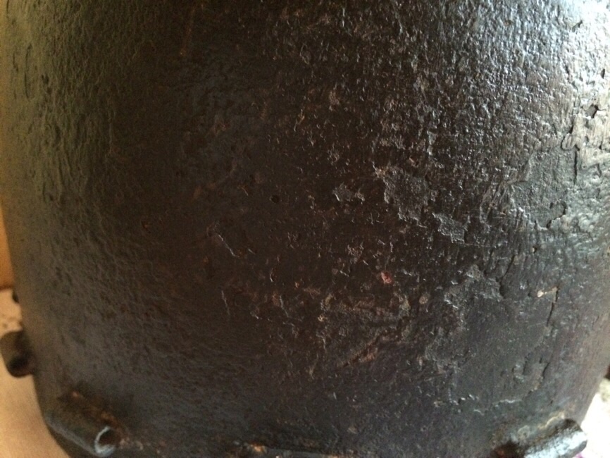

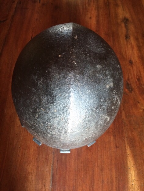

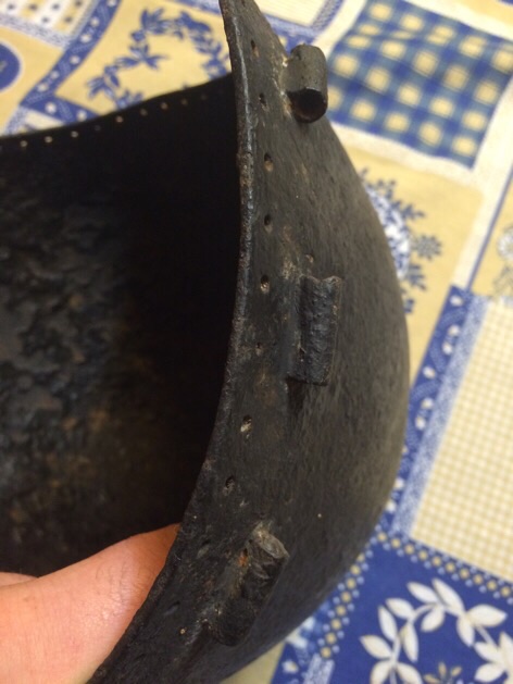

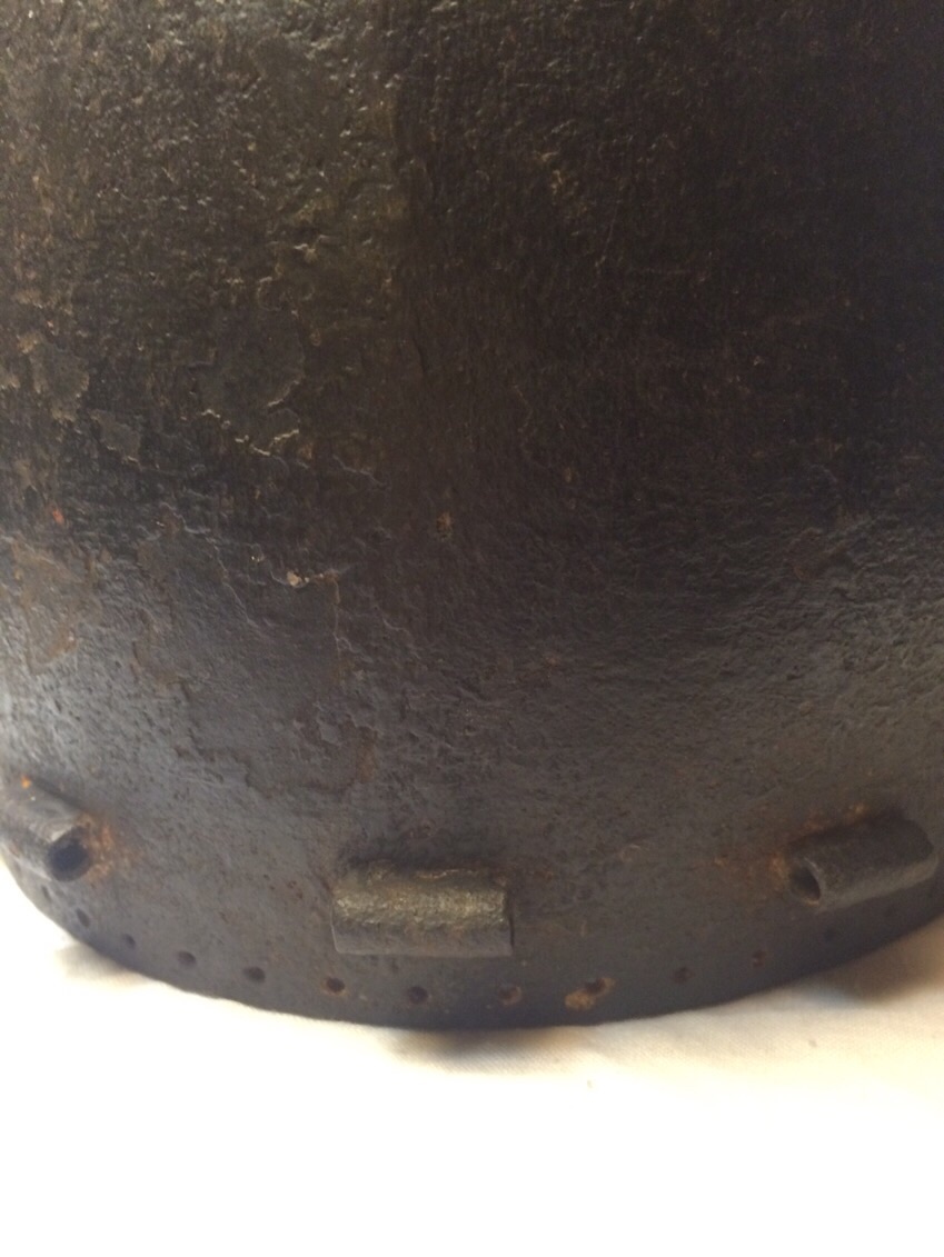

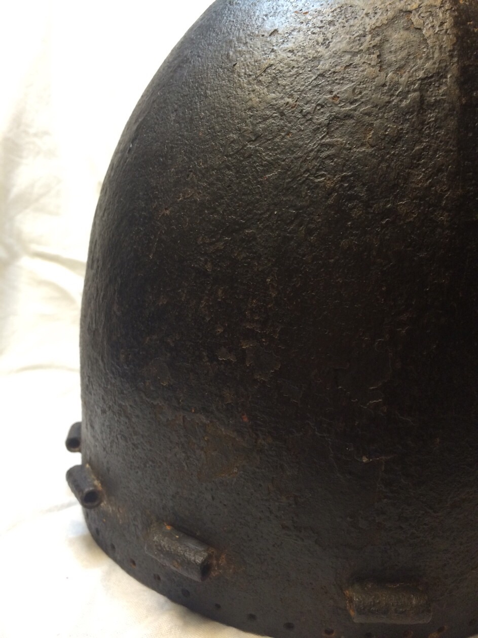

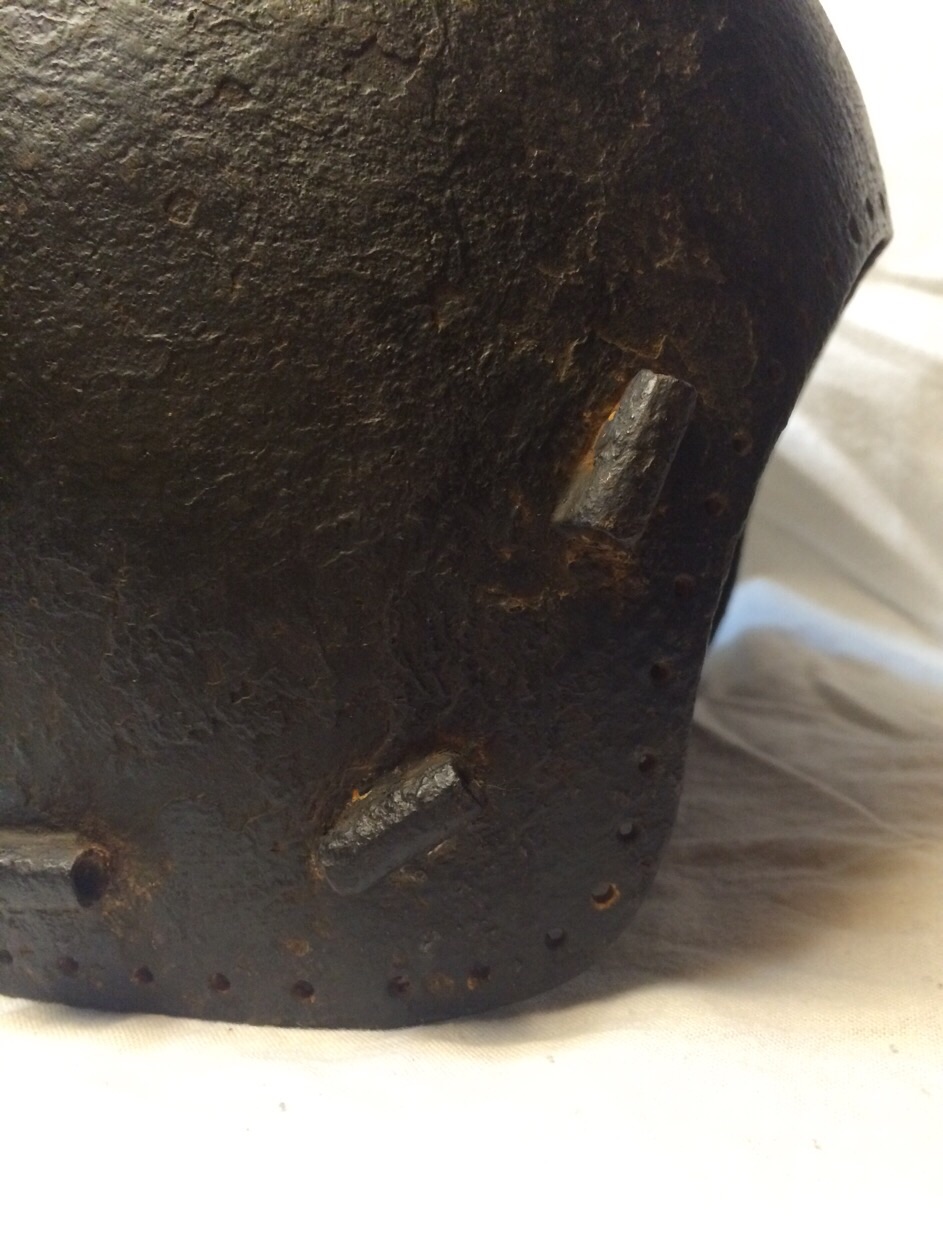

The weight seems right for 14th c. Can you possibly get a close up pic of the inside where one of the vervelles ( the little tubes that suspend the cord/wire that keeps the leather band to which the mail mantle is sewn in place ) is attached and perhaps at the peak of the helmet where the slight medial ridging is?
#6 |
Join Date: Jan 2007
Posts: 247

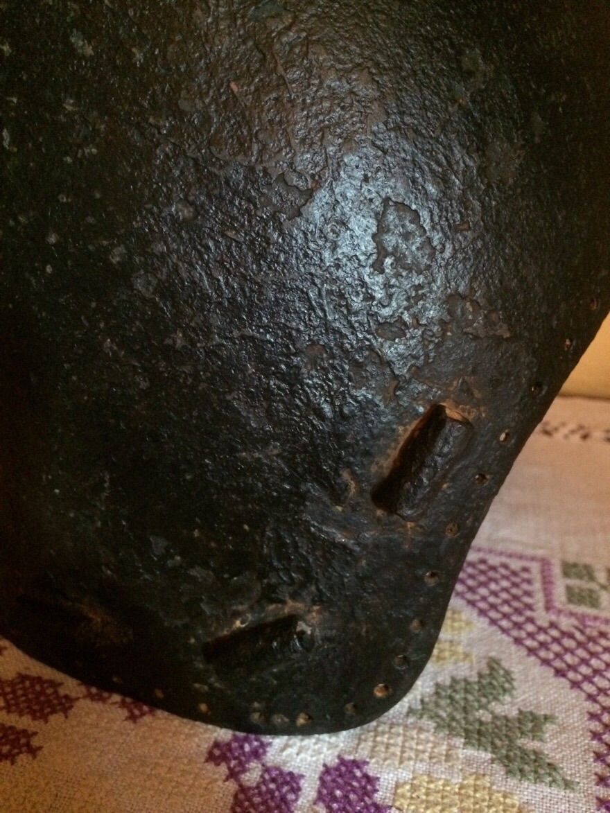

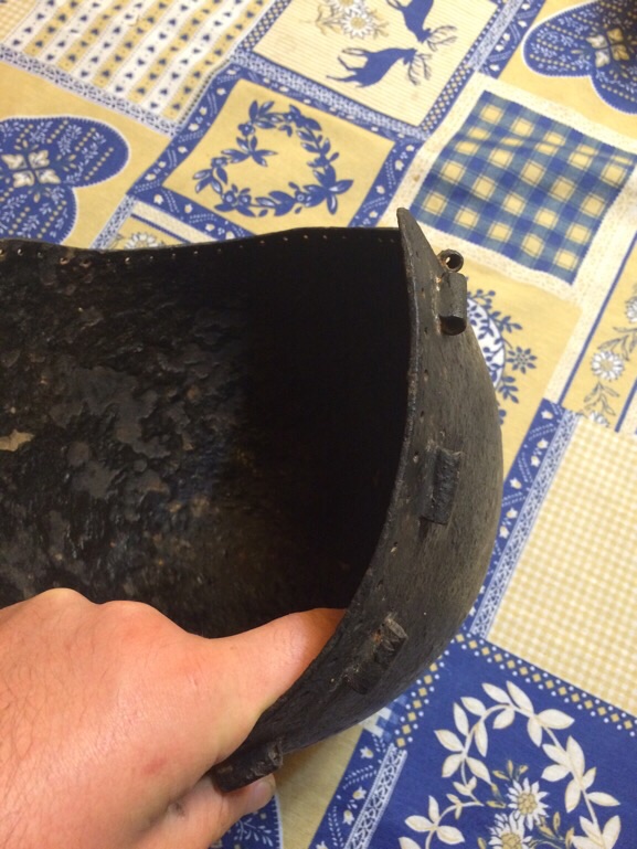

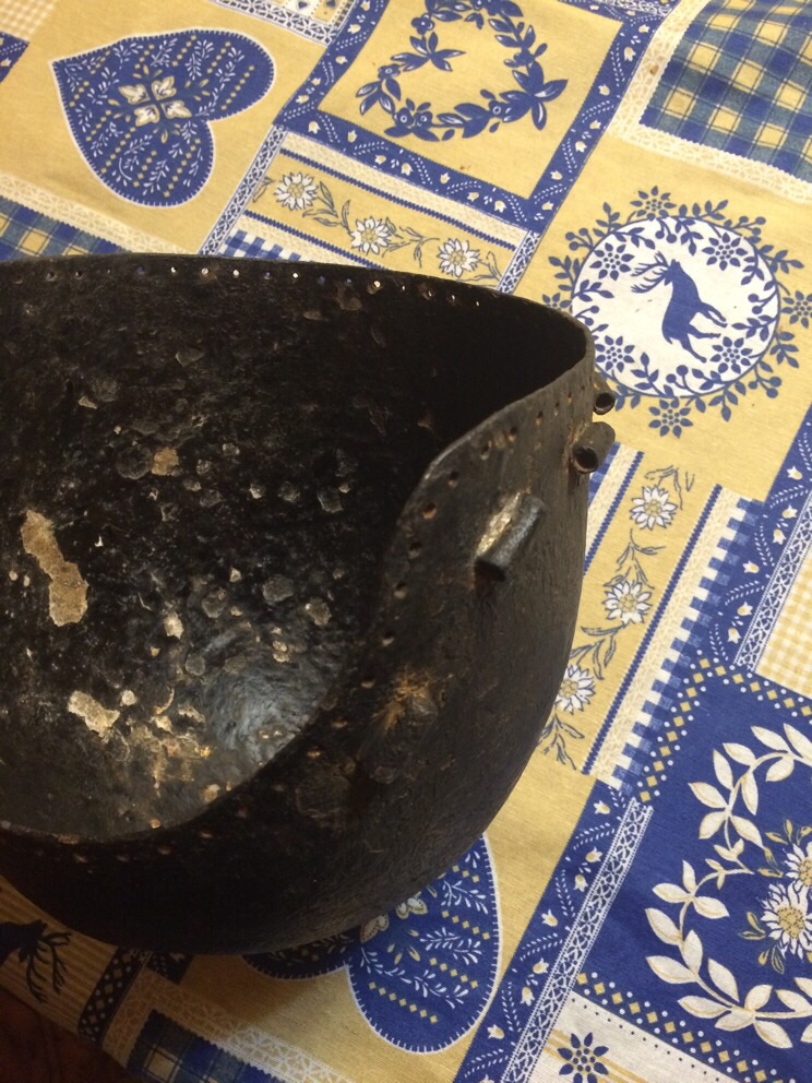

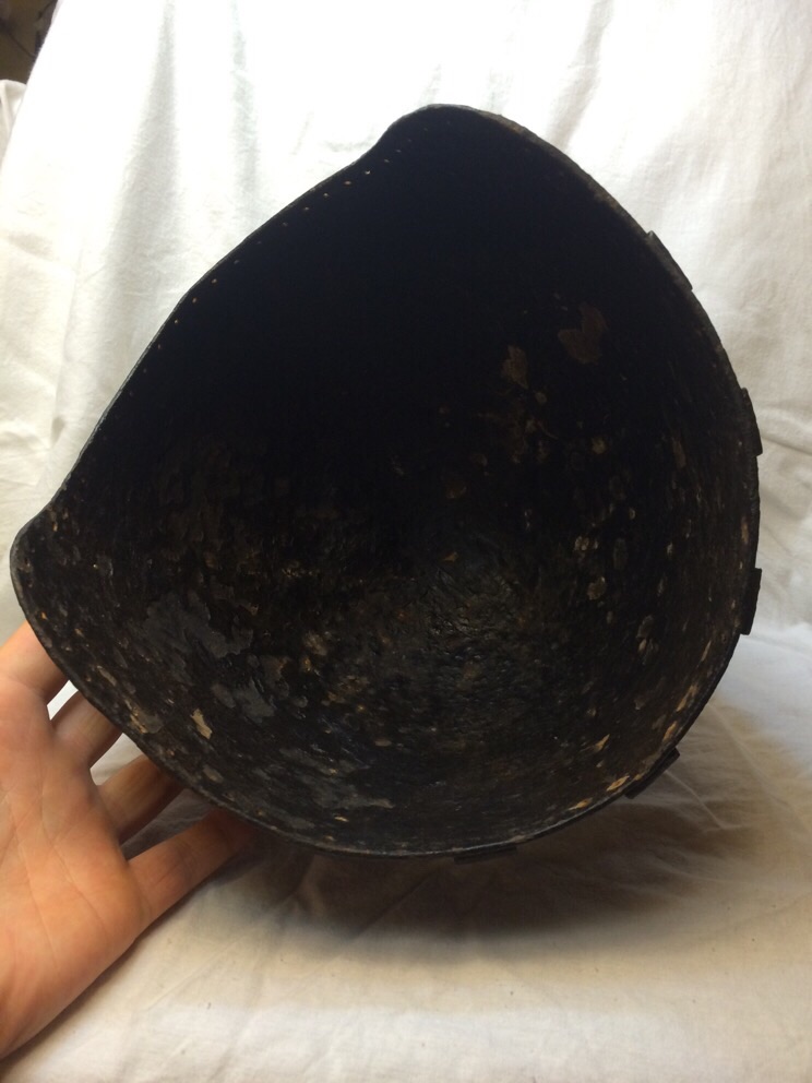

Hello Thanks for your input ! Here Others pics !!
#7 |
looks very french*. if the tubes hold the leather binding of the maile skirt, what are the series of peripheral holes for? what kind of inner suspension would it have had?

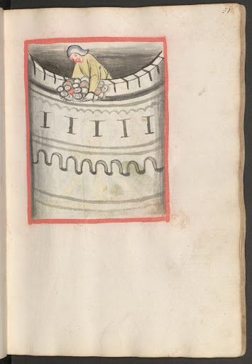

From the "Krieg und Feuerwerk Buch 1411" (war and fireworks book from 1411).
There are multiple drawings with very similar shaped helmet types, so they might be quit alot older than i first thoughed. I think i saw them in some other manuscript as well, hope to find it. The small holes alon the edge are most certainly the attachement holes for the mail head piece, which would have protected the forehead, the neck and the back portion. It would fall over the mail shirt and thus protect you from the head to just under the waist. Those other tubes are new to me, i never saw anything like that. It is not my field though so i am sure a more competent person will adress that. |

The small holes are where the inner lining of the helmet was stitched in place; the hollow tubes, called 'vervelles' (as A.Senefelder says above) are usually just small rings rather than tubes but the leather band which is attached to the edge of the camail is pierced with holes which fit over the vervelles and then held in place by a wire threaded through the vervelles. The unusual size of these vervelles is the only thing which worries me about the genuineness of this bascinet.
Neil |

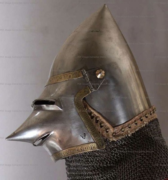

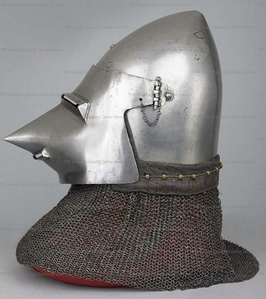

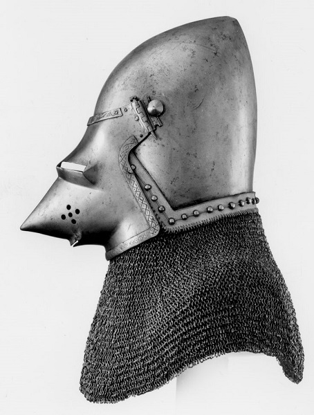

Several more examples attached from Churburg and Leeds. The example in the OP is of a lower peaked without visor ( at least I so nothing for affixing one nor evidence that it ever had it ) that would date it stylistically to the 1340's - 1360's as it would have been worn with a late great helmet. A fine example of the type can be seen in the article on Colaccio Becadelli ( died May 3rd 1341 ) from his funnery sculpture in " Arms and Armor Annual " 1973.

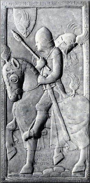

Becadelli effigy attached showing the great helm hanging behind on suspension chains.

What type of exams I can Let made to find a correct age of this helmet ? Thanks |

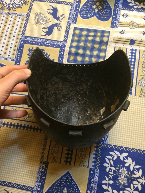

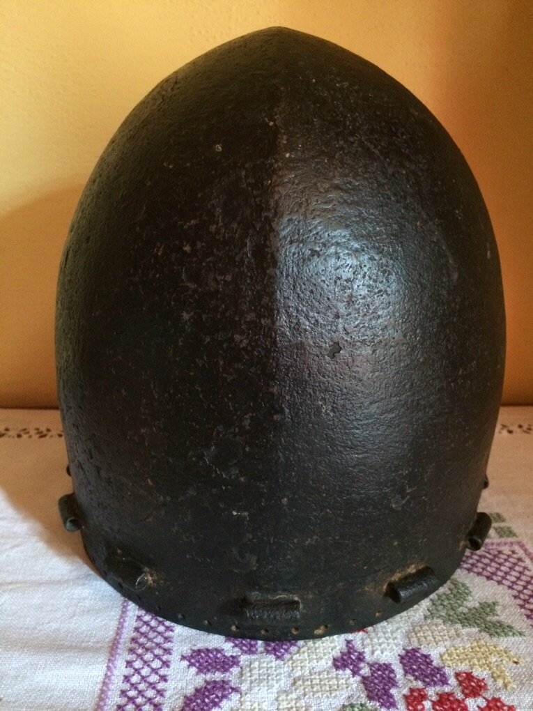

I m searching to do some better pics !! If can help !

Join Date: Jan 2007
Posts: 247
Others

a beautiful helmet, thank you for showing. I think your example is authentic. Here are two pictures of my favourite actor with this helmet. Roland |

After some researching I would say, your helmet is an original bascinet, which has lost its aventail. The actor wears a sallet or burgonet. The movie plays in the year 1560 and is very recommendable: "Aguirre, the Wrath of God". |

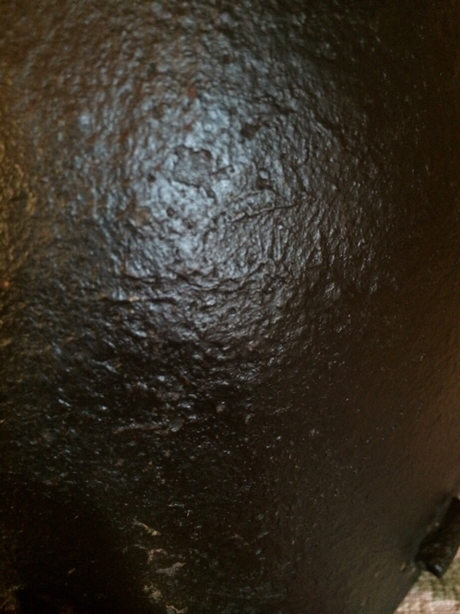

If you look at the holes in the helmet under a high quality low power microscope(would recommend 10x) and determine if holds are made by punching or drilling. Punching indicates older, drilling indicates newer.
rand |
