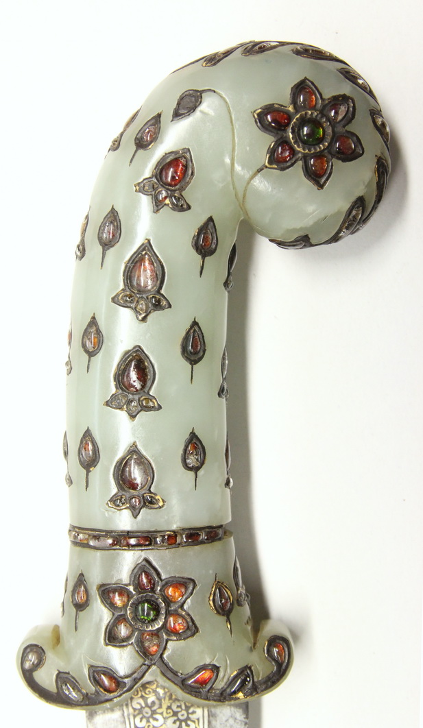

now when I got your attention:-) there's a growing trend hitting the market, and particularly eBay, of mughal kundan imitations. Not to discredit a particular seller (as there's no mentioning of word "kundan"), but to educate those who may not realize this is not kundan, as it looks like some do not know, based on prices and feedbacks. So look at the below closeups: the real kundan requires stones to be placed (pushed) into carved patterns into melted gold. What we see here is a clever surface application with twisted wire and stones being glued on top. The work is actually quite sloppy, there's even some glue residue left and I'd feel sorry for anyone during Mughal times who'd dare to produce such "quality" - that person would be expelled from the workshop and loose an arm. Nowadays, this is what buyers do:-). One can write a few pages of what's "not right" with those daggers, but pictures worth a few pages more...

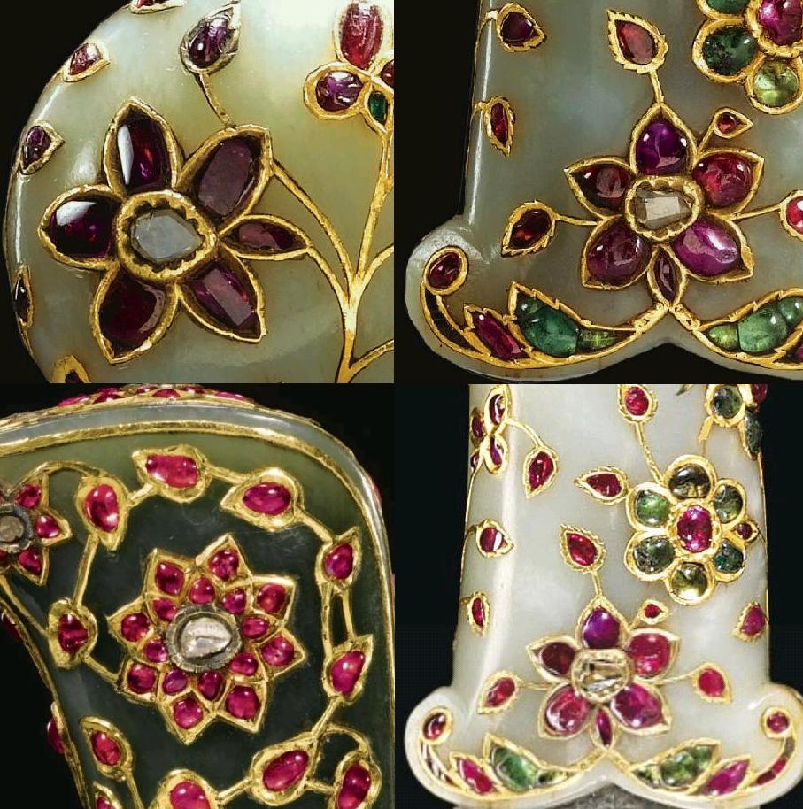

Originally Posted by Stan S.
Any chance fo seeing pictures of similar but confirmed mughal period weapons for comparison?

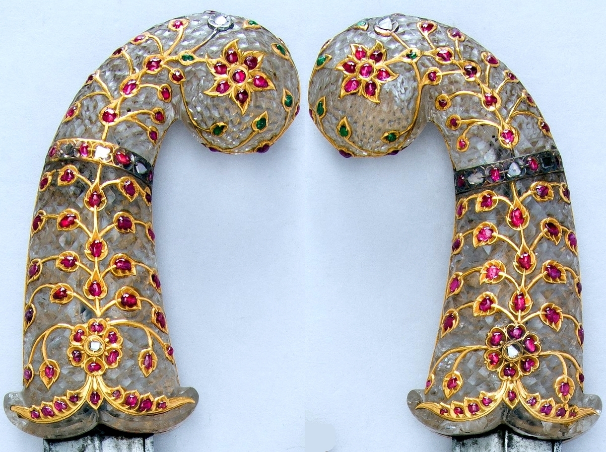

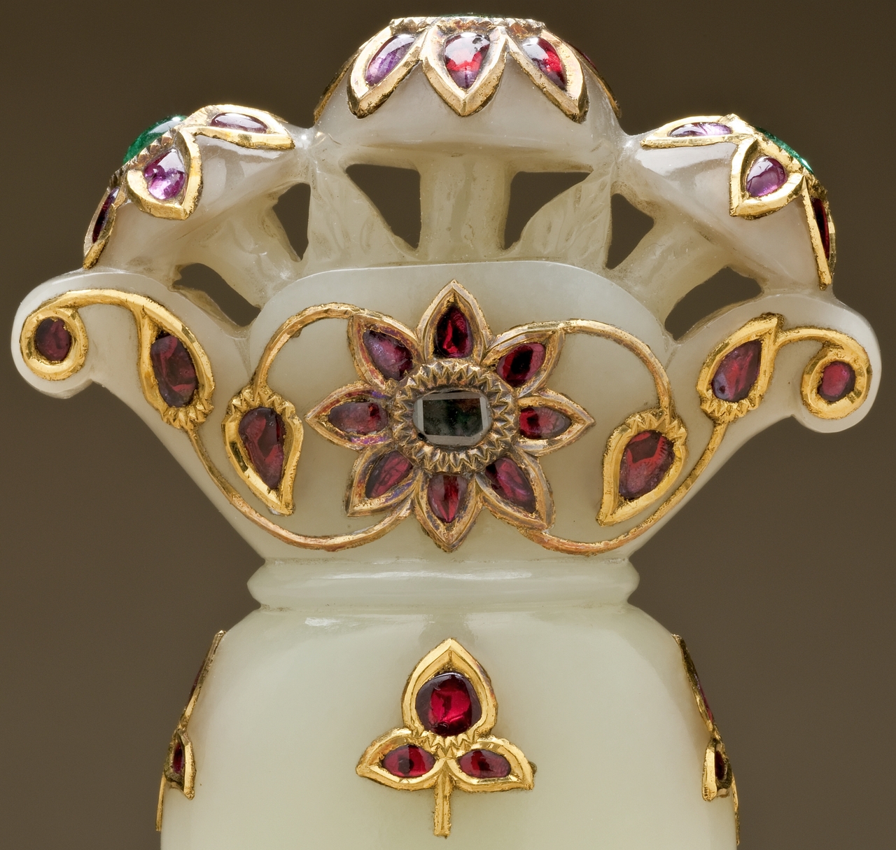

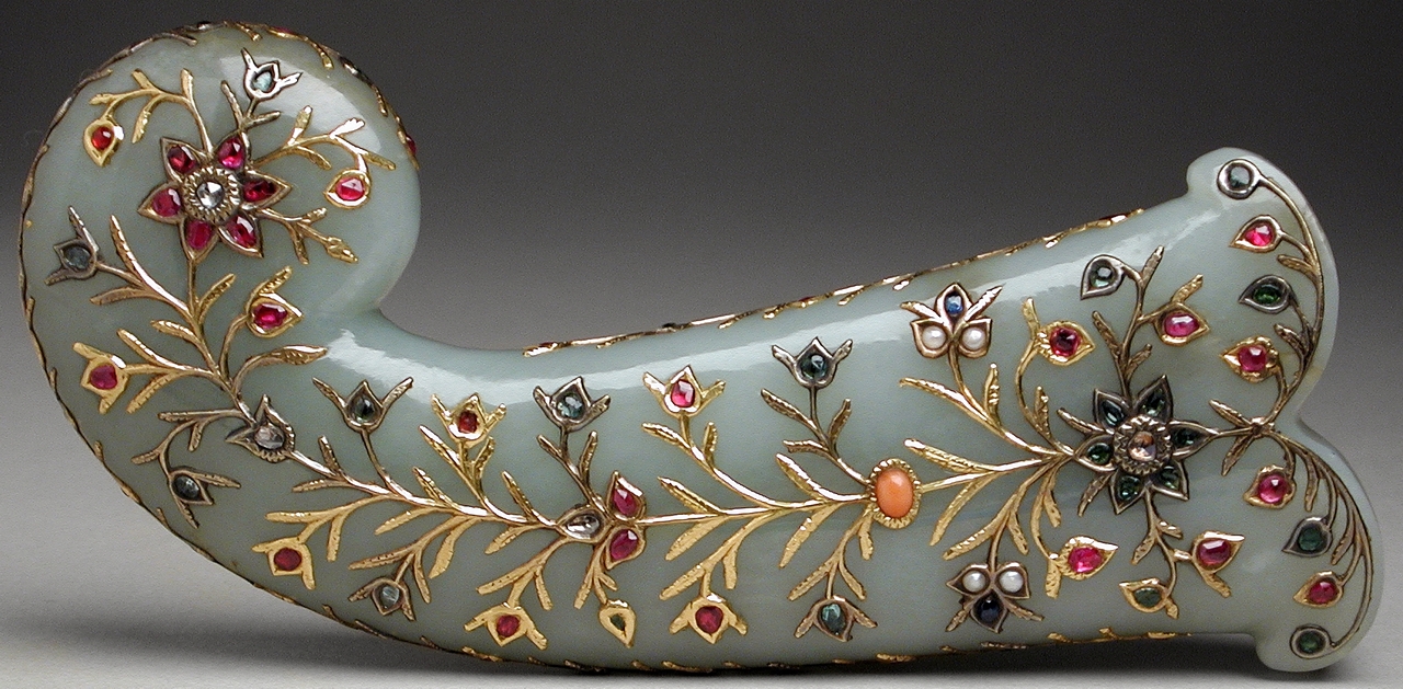

Here are few examples of kundan technique...

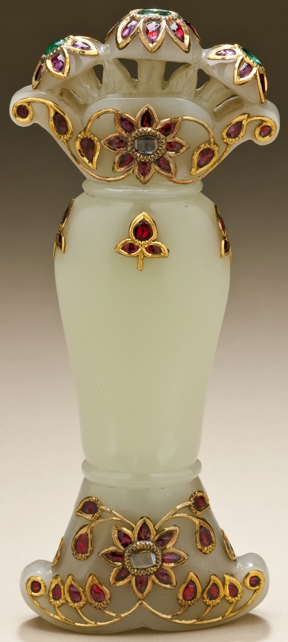

Old 19th March 2012, 09:15 AM   #7
ALEX
ALEX's Avatar
Posts: 936

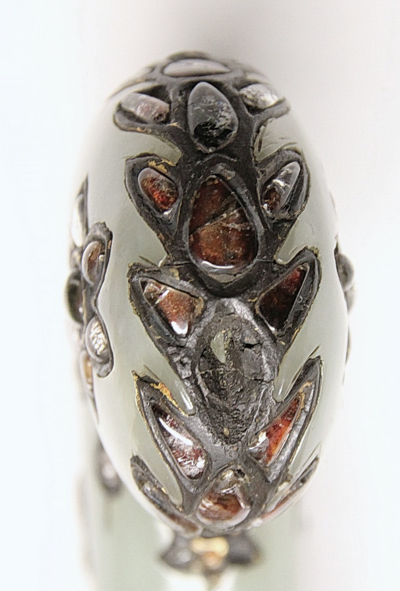

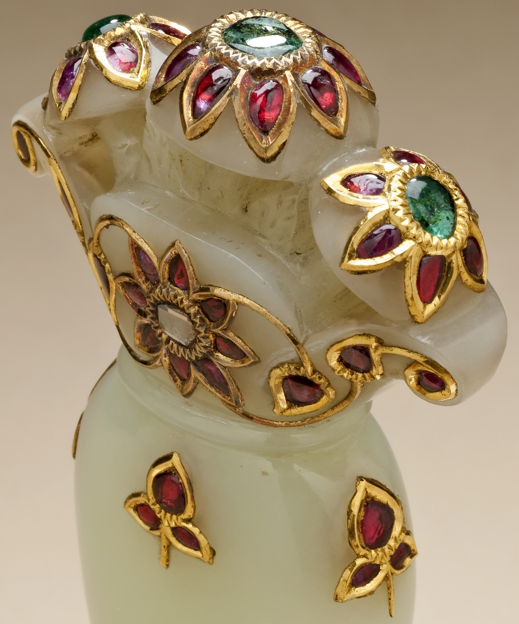

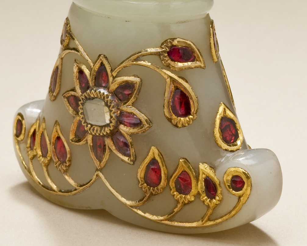

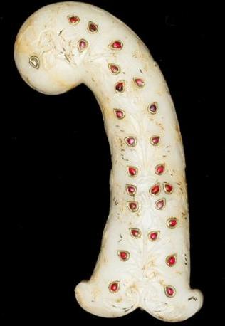

And here's 18th century nephrite jade handle with all jewels and gold removed, so you can see the original carvings before they were filled with all that bling:-)

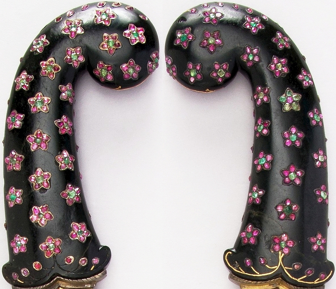

also, 19th C mughal handle with some kundan applied much later, likely in 20th C.
Old 19th March 2012, 09:27 AM   #9
Atlantia
Atlantia's Avatar
Join Date: Jun 2008
Location: The Sharp end
Posts: 2,928

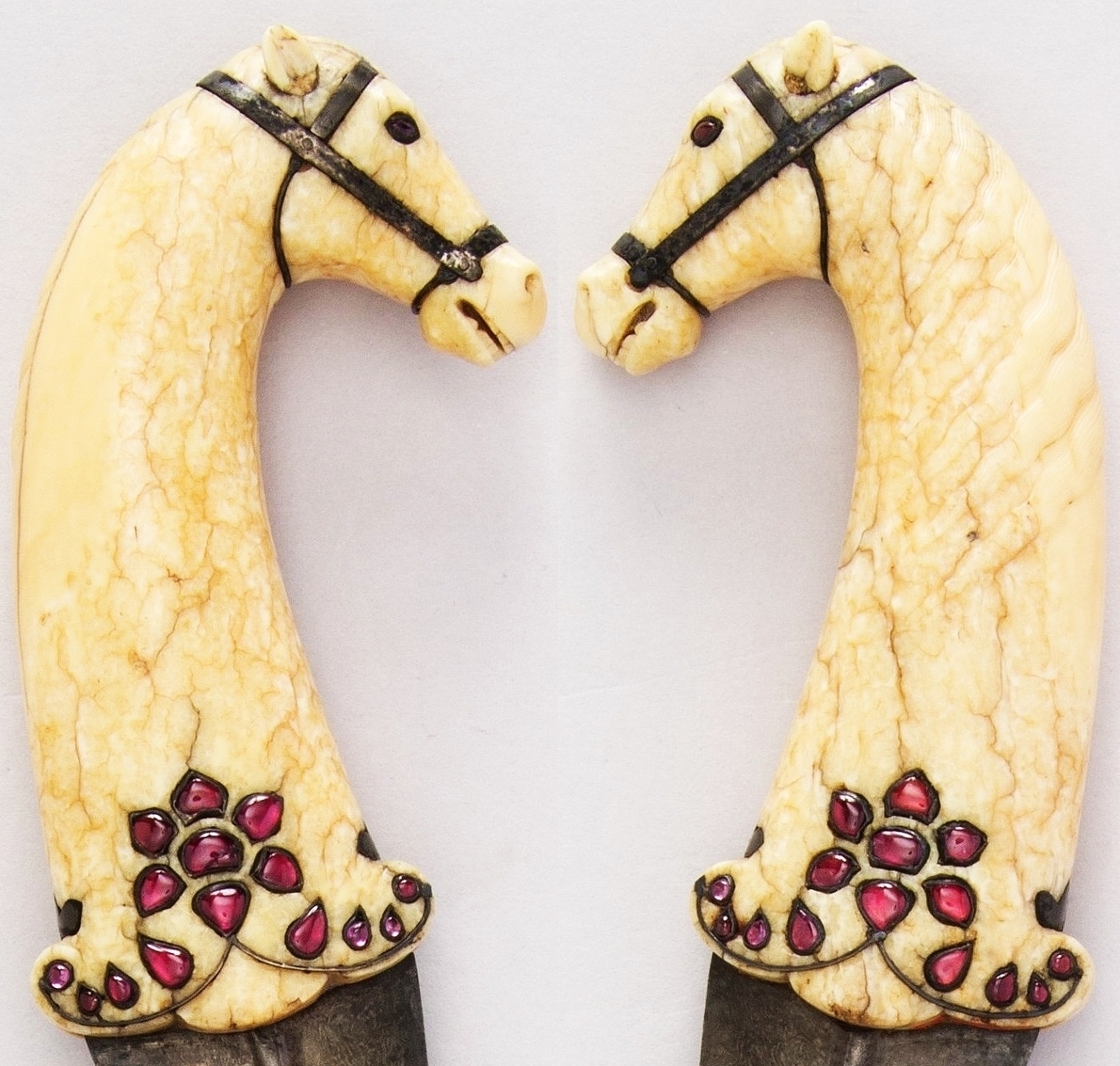

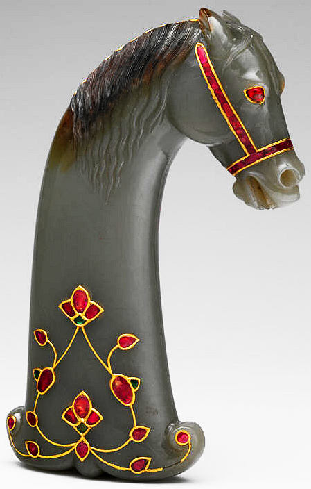

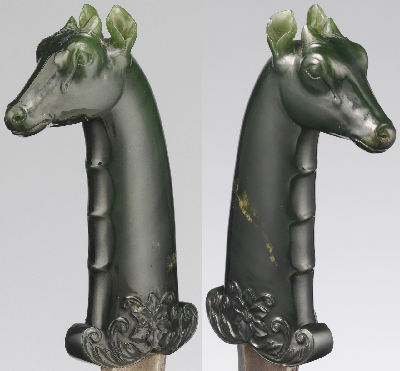

Default Mughal handle comparison

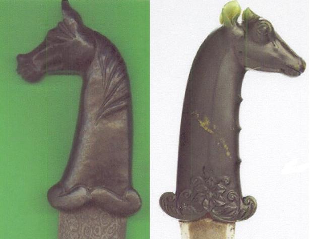

since we're on a mughal subject - here are few handles in most common mughal horse forms. Just like with new kundan - one thing is when you're looking superficially or on blury pictures, but when you start comparing with authentic mughal, the difference becomes much clearer.

Alex, the hilt to the right in post 10 is not a horse, althought it could look like the head of a horse, it is a nilgai - notice the small horns.
Jens, these are not horns, these are true inward-turned ears: a specific feature of the so-called Marwari horse.

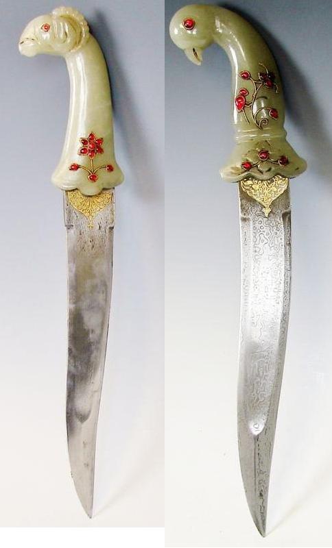

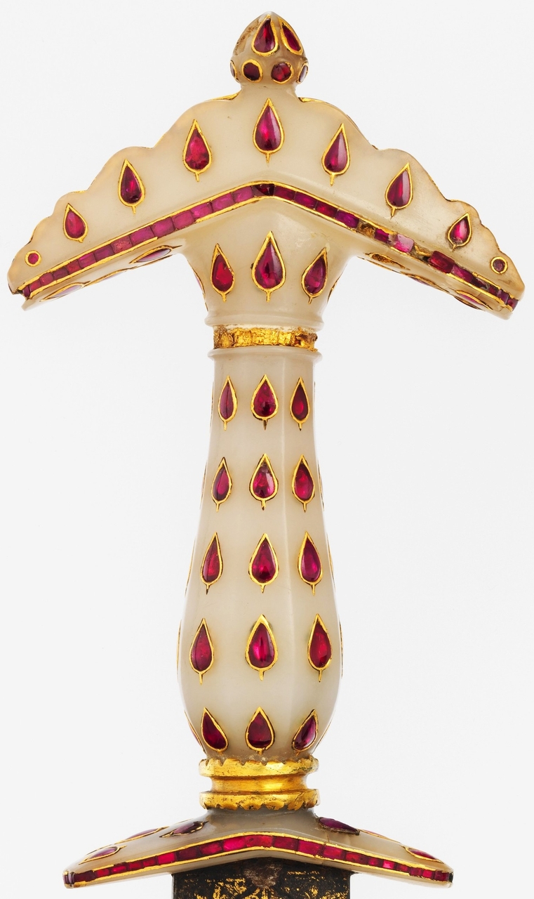

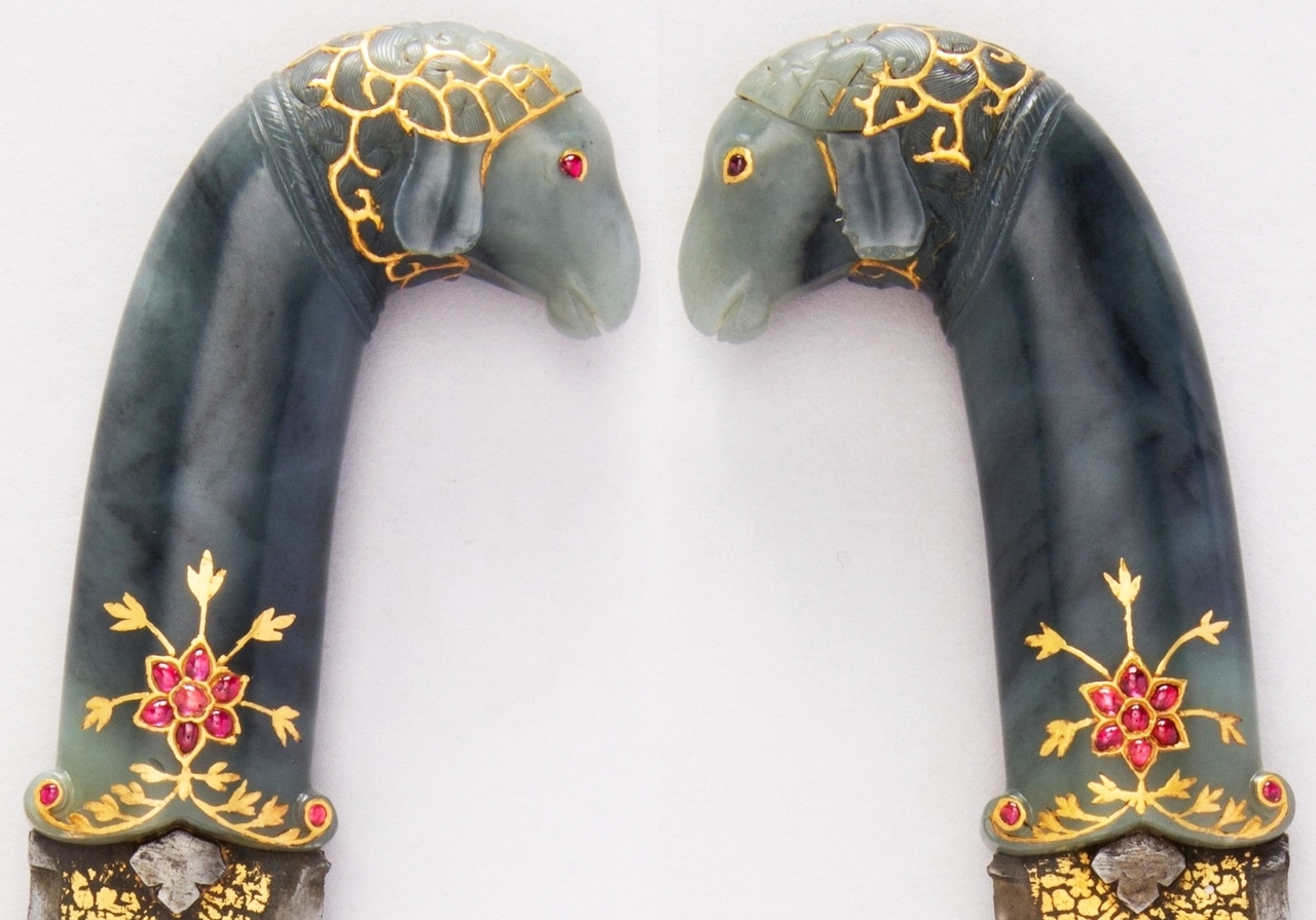

Here are a few examples from the Met Museum.

Ariel, I still think the one to the right in post no 10 is a nilgai, just like the one shown in post 18. See the text here.
http://www.metmuseum.org/collection/...&tabname=label
Jens

There's a lot of supposition re: this technique. One of the offsite posts got it right, though.
I think part of the problem is the use of translating software or not being fluent in the technical aspects of either or both languages.
Gold will NOT form a molecular bond with stone. And, for the purposes of this discussion, gold, if hammered onto another piece of gold of a similar karat, will not form a molecular bond between the two pieces. Any attachment would be purely mechanical. Think of two pieces of aluminum foil. Crumble them up together in a random, haphazard manner as when you're not thinking about it when you throw it away. The two pieces are pretty securely held together if squished together tightly. However if you very methodically, for whatever reason, decide you need to separate the two pieces, this can be done. Try it.
This is a mechanical bond. If a eutectic bond formed, there would be no separating the two.
A design is engraved into the hard stone object. The walls of the design are next undercut slightly.
The stones to be set must also have slightly sloping sides as all stones that are set have to have.
Gold, now cannot be "hyper purified". Period. Pure gold is 24 karat. There is no 24.5 or 25 karat.
Strips of 24 karat gold are drawn that have a rectangular cross section, the minor dimension should fill tightly the space between the precious stone and the matrix. The major dimension should stand proud approximately twice to three times the thickness of the minor dimension, leaving as small a gap where the two ends meet as possible. It is critical for these strips be annealed well. During the process used in the following paragraph the strips will become slightly springy due to work-hardening. The trick is to get everything in place as efficiently as possible and not to over work.
A steel chasing tool, which is similar to a small chisel but with a blunt rounded edge, is pressed to the gold and driven down with gentle blows of a light hammer. OR a tool known as a burnisher, which is a smooth, polished shape made from steel, agate, or haematite mounted securely in a wooden handle, is pressed forcibly downward causing the gold strip to deform and be forced to fill any undercuts and voids between the precious stone being inlaid and the design carved into the grip. The slight extra amount of gold that was left standing proud originally should roughly be figured to be slightly greater than the volume of the void. If during the process this is miscalculated, unless there's enough of an undercut, more gold cannot be just hammered on top of the gold in place to build it up. There has to be some undercuts to mechanically lock everything together.
One respondent mentions a eutectic bond forming without heat.
Nonsense.
Period.
Any bonding forming during this process is purely mechanical and can be easily undone with a pair of pliers, tweezers, or needles to remove the set stones.
With a bit of prep time and a clear schedule, this could be demonstrated.

Thank you very much for the explanation, which I find very interesting.
If I understand you correctly, you are saying, that the jade or whatever, is 'scratched' like in 'koftgari', and that is what is holding the gold/stone in place. Is that correct?
If it is, then it is a bit like when the enamelleded. I have a very good example of this somewhere.
Jens
Old 29th November 2015, 07:52 PM   #24
Shakethetrees
Shakethetrees's Avatar
Join Date: Apr 2014
Location: Louisiana
Posts: 363
Jens, thank you for your comment.
The decoration is not just "scratched" into the jade or other hard stone, but it to depth needed to allow the stone, once set, to be at the proper relative height to the hard stone matrix.
Once the linear aspects of the design and the larger cuts intended to support the set stones are finished, the edges are undercut slightly.
Once the 24K annealed gold is forced down, filling the undercuts, it's locked in by burnishing or chasing lightly.

Old 30th November 2015, 12:35 AM   #27
Posts: 7,403
That is why I mentioned that I have a hard time believing that heat was not used at all.
Thus I agree with Shakethetrees on everything he said. Notice too that in the jade example pictured where all the pieces and gold was stripped, there are small holes in the grooves. These are for the pounded gold to fill and grip the gold, holding it better in place as well as the undercut grooves.
This is not too unlike what is done to inlay steel. I under cut the inlay grooves in the steel so that they may "catch" the softer metal and hold it in place (like what Shakethetrees mentioned).

The holes drilled appear to be positioned beneath the settings. These are no more than pilot holes for larger holes to remove stock for the settings. Another smaller tool was used to shape it to accommodate the setting fully.
I don't know if the bottoms were overlaid with thin sheet gold, possibly, but the only thing holding the stones were the undercuts in the carving of the matrix.
Gold, well annealed, is extremely soft, softer by orders of magnitude than even fine silver, so it theoritically is like putty, smeared down and forced into and under the undercuts, cold.
If heat enough to affect the softness of the gold, (roughly 1000 degrees F.), the stone or ivory would be ruined.
This has piqued my interest. If I can find some time I will attempt to do a small demonstration piece and report back.

A few more excellent examples.

Shakethetrees, you bring up some points I haven't thought of. And I forgot about the heat effecting the stones. In fact it would change the color of the stones at the very least. Also not aware of the holes being drill holes to take out the stones and inlay.
If you could experiment and show the results that would be great. I still am a little hazy about the the process.
