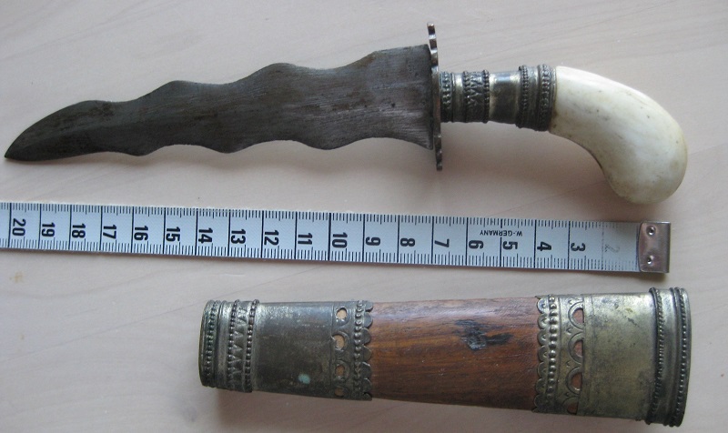

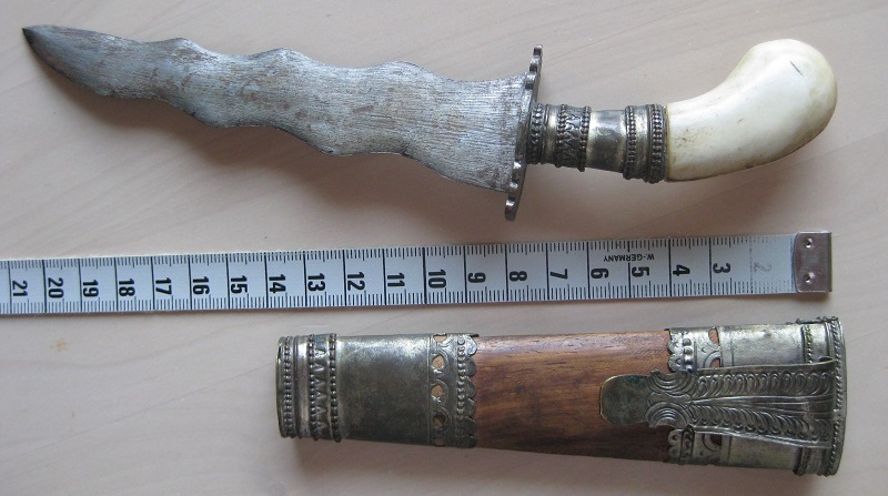

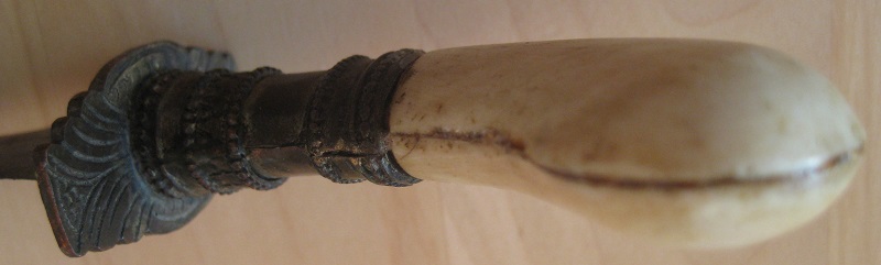

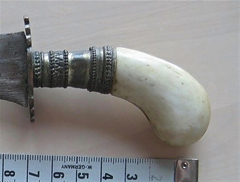

This one was bought (not by me) in Manila 35 years ago. I do not know anything about it and should really appreciate any information at all when it comes to this knife. Is it just a tourist thing or....I know the pictures are not good at all but the only ones I have for the moment. Thank you!

This is called a gunong by the Moros of the Southern Philippines, most being from Mindanao Island, and therefore being of either the Maguindanao or the Maranao tribes.
In this particular example, this gunong seems to be post 1930s, based on the shape of the ivory pommel and the types of waves in the blade. The silver plating (so it looks to me) indicates easily Mindanao Island, along with the okir vegetation motif.

Posts: 7,303

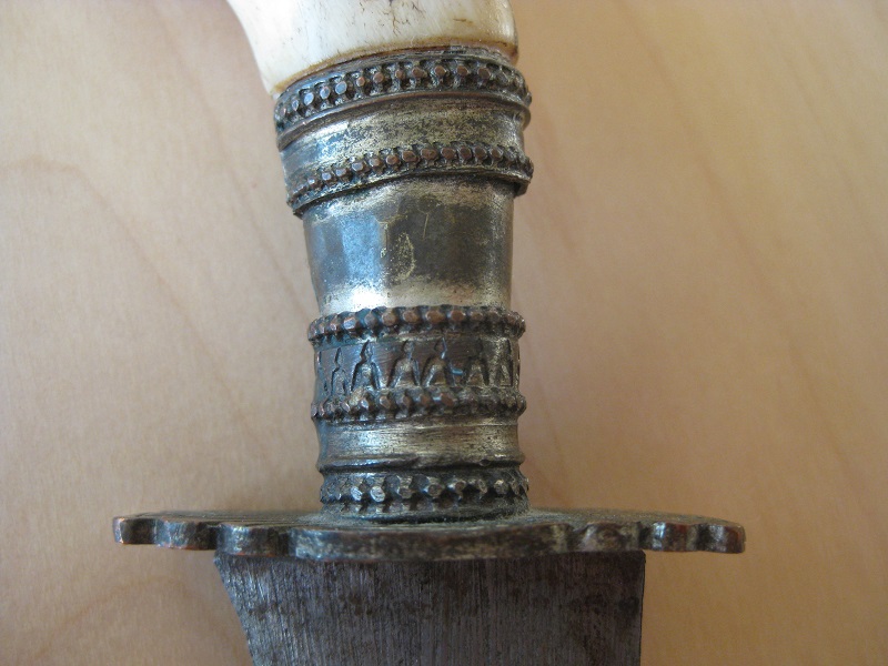

I'd love to see some better and closer images of the hilt. The color looks odd to me for older ivory and i am wondering if it is not clam shell.
Old 8th December 2015, 06:56 PM   #4
Hello Hombre,
welcome to the forum. The pommel don't look like ivory to my eyes either. How is the feel inside the hand? Like stone? Like David said it could be clam shell.

blade seems a bit roughly filed & of lesser quality than the rest of the unit. i would have expected a smoother finish and maybe even some incised line art. how thick is the blade?

Agree about the blade and the pointiness of the curves makes me think it is much later than the 1930s.
Old 9th December 2015, 12:47 AM   #7
Posts: 7,416
Now that I see the pictures on a larger screen (and not a phone screen), I agree - the pommel might be something else - close ups might be helpful!
I agree David - the blade might well be the 1950s or even 1960s. However, I have seen 1930s looks/waves in the blade just like these.
Many of these after a certain time period were indeed made for US soldiers, although during the ban on Moro swords after the Battle of Bud Bagsak in 1915, gunongs grew more ornate and even larger since they were the only weapons not banned during that same time period for Moros to wear.

Posts: 2,196

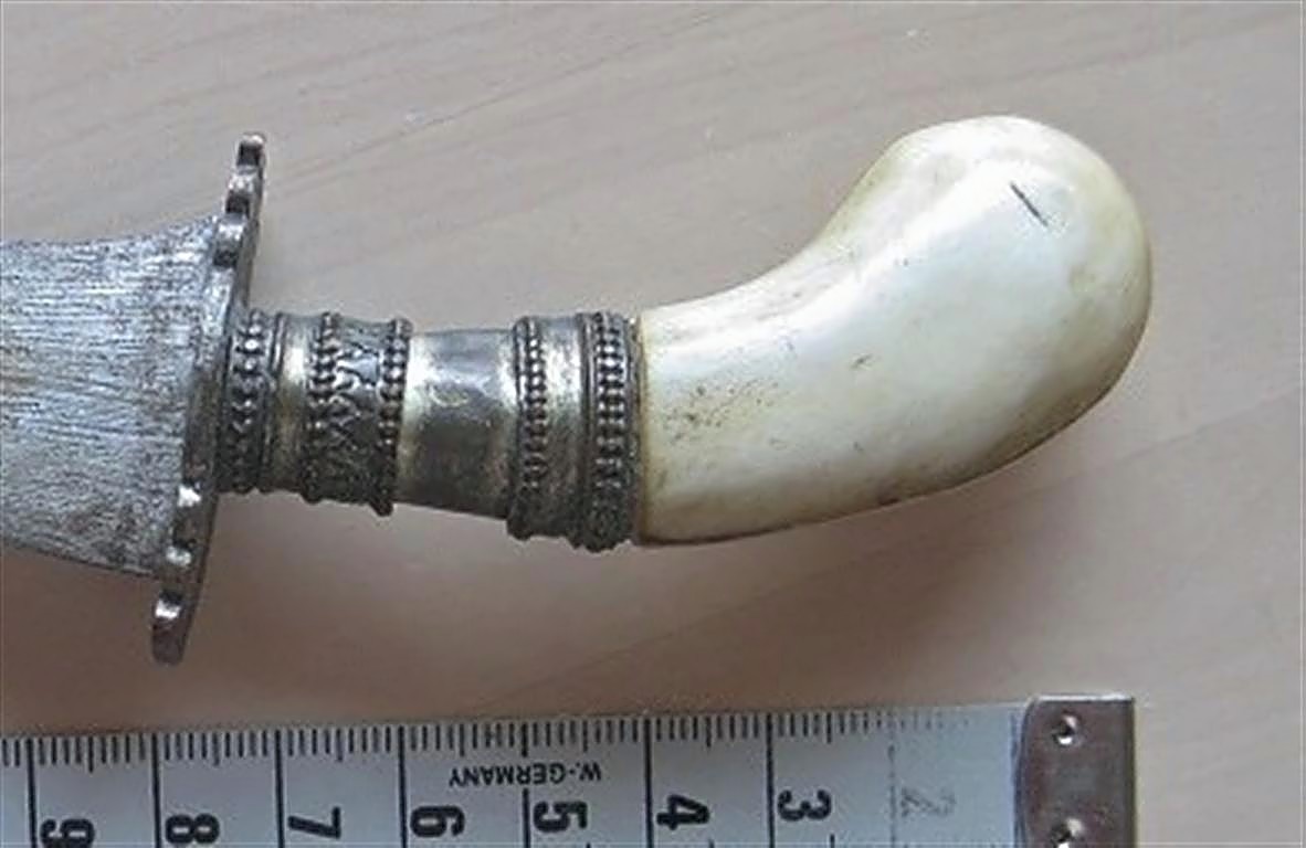

Maybr these will be of some help. My vote is for shell.

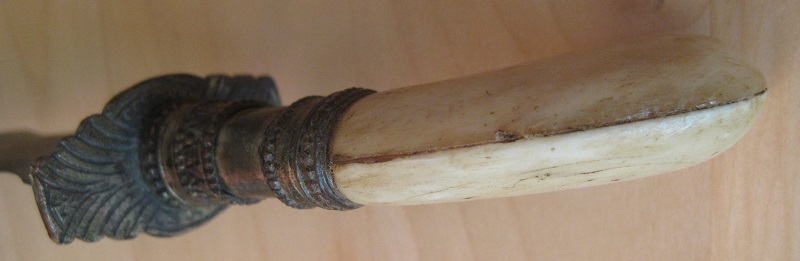

Old 13th December 2015, 12:24 PM   #10
Hombre
Join Date: Dec 2015
Posts: 232

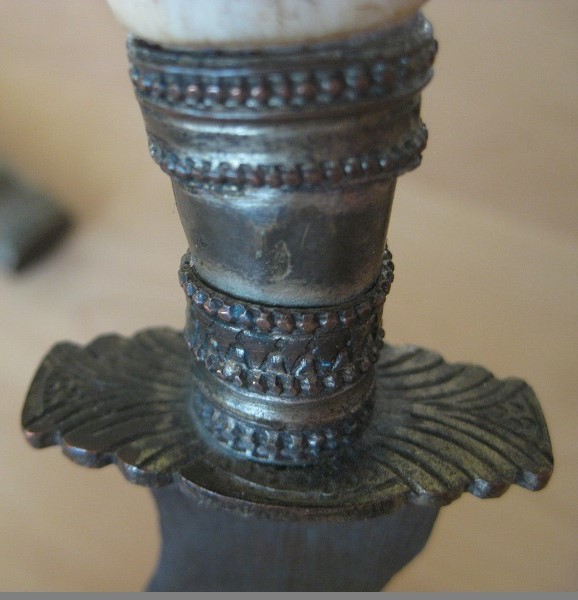

Here come some more pictures....

Old 13th December 2015, 06:18 PM   #11
bone...
Old 13th December 2015, 08:12 PM   #12
Originally Posted by kronckew
bone...
Yep, agree, two glued (?) bone plates.
