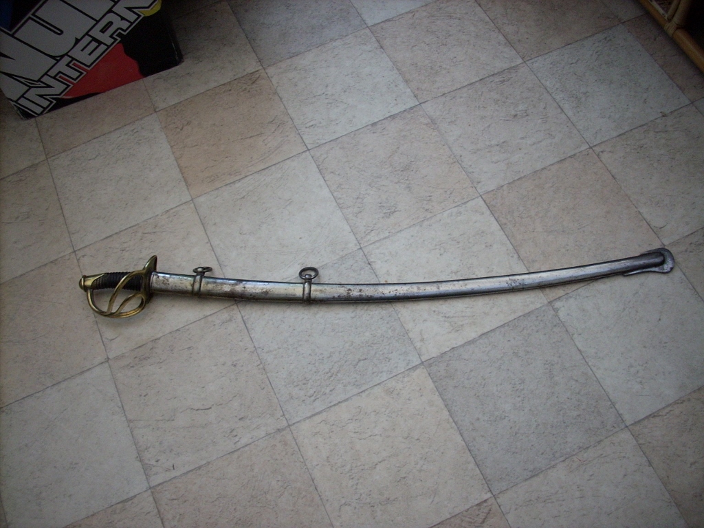

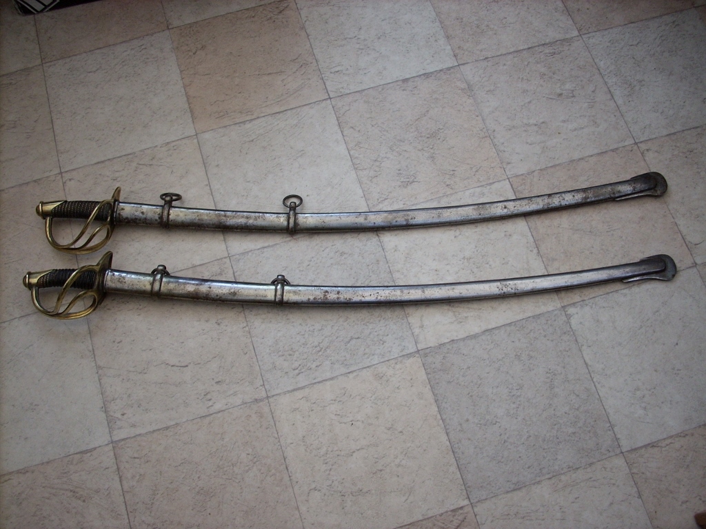

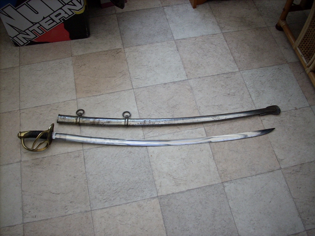

Hi Everyone,

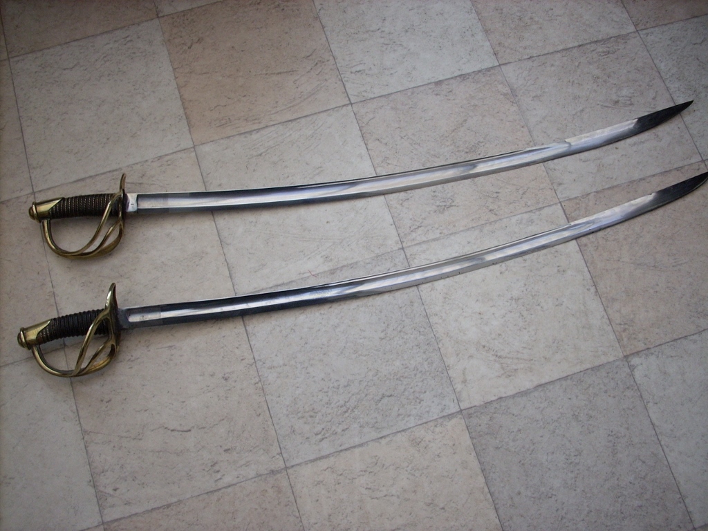

I would greatly appreciate your help in identifying these two swords. I have had them for some time but have only just unearthed them from one of my storage boxes in my quest to catalogue my weapon collection.

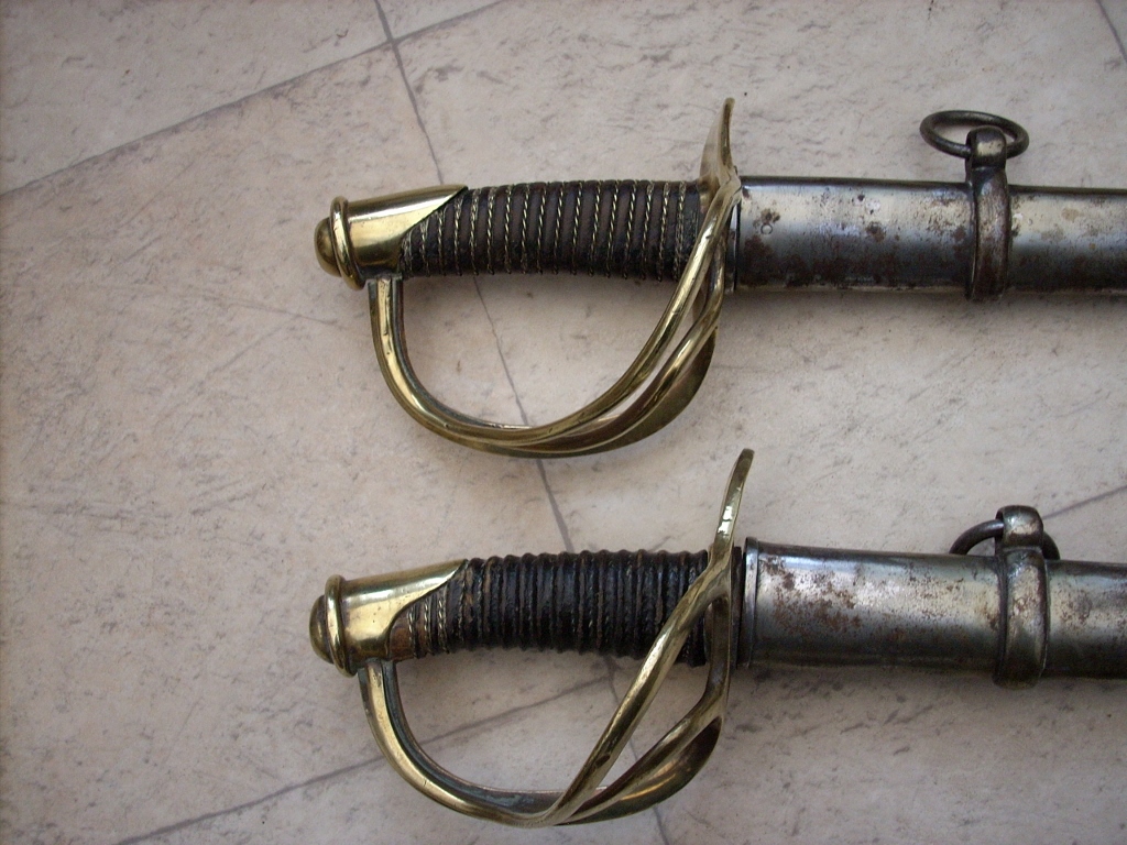

On first glance the swords appear to be identical but on closer inspection there are small differences which lead me to believe that they were made by different manufacturers. One sword is completely devoid of any makings whilst the other one has stamps on the hilt and a single number one or letter I stamped on the ricasso. The first set of photos shows both swords together, the second set shows the sword with no markings and the third set the sword with markings. Thanking you in anticipation of your help.
Miguel

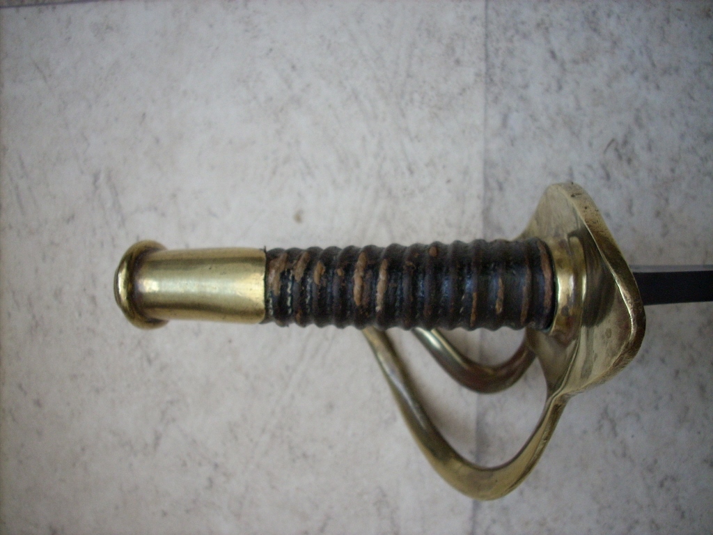

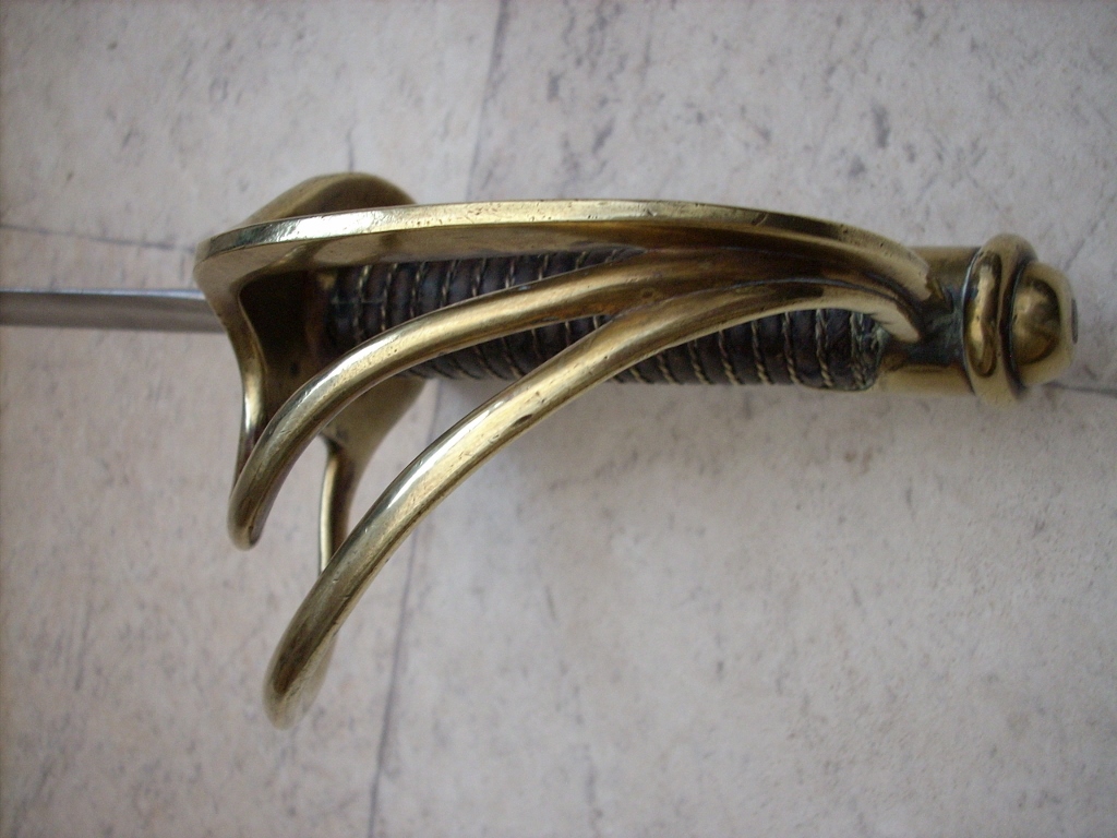

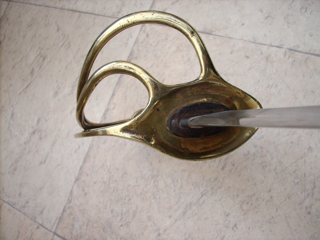

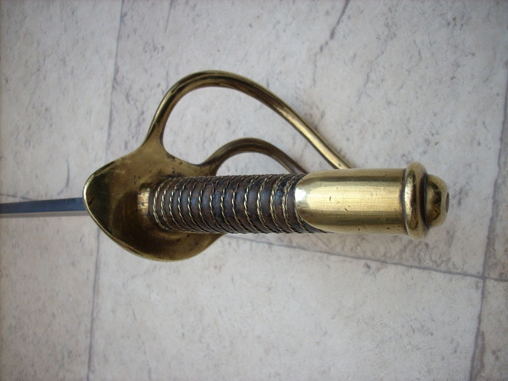

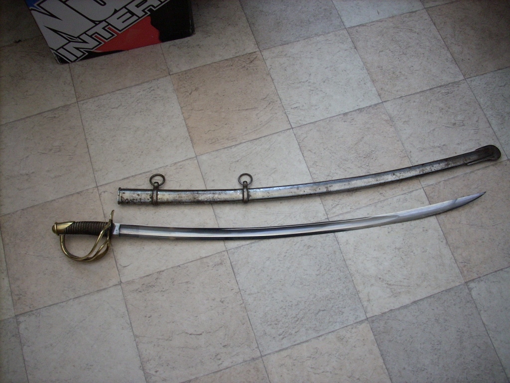

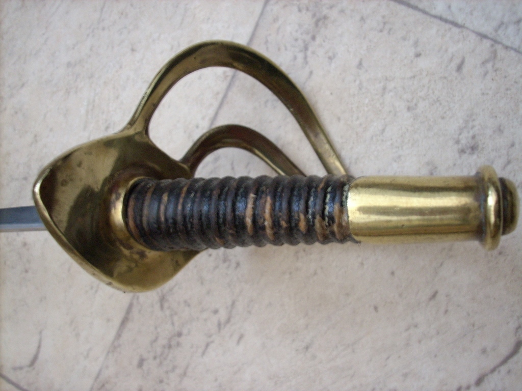

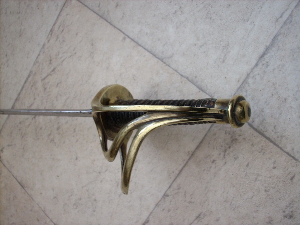

Second set of photos, sword with no markings.
O/L in scabbard is 43 ins.
O/L out of scabbard is 42 ins.
Blade length is 36 ins.
Blade width is 1.125 ins

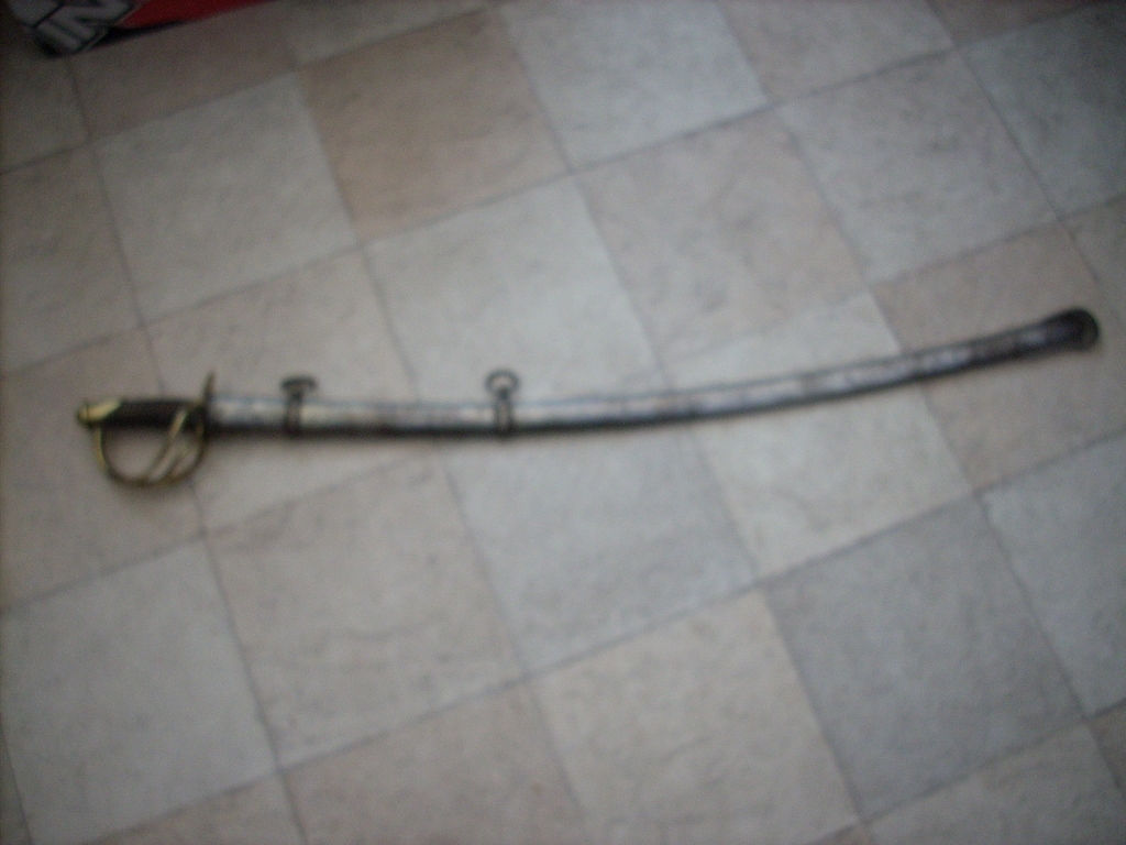

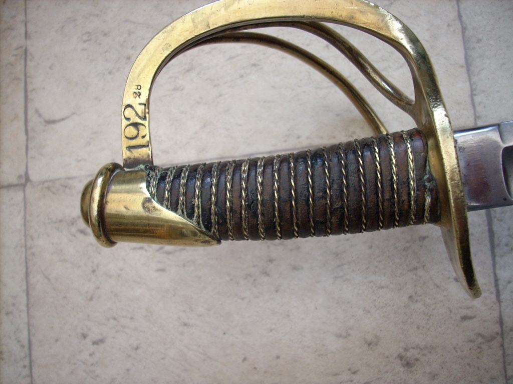

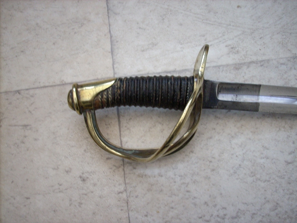

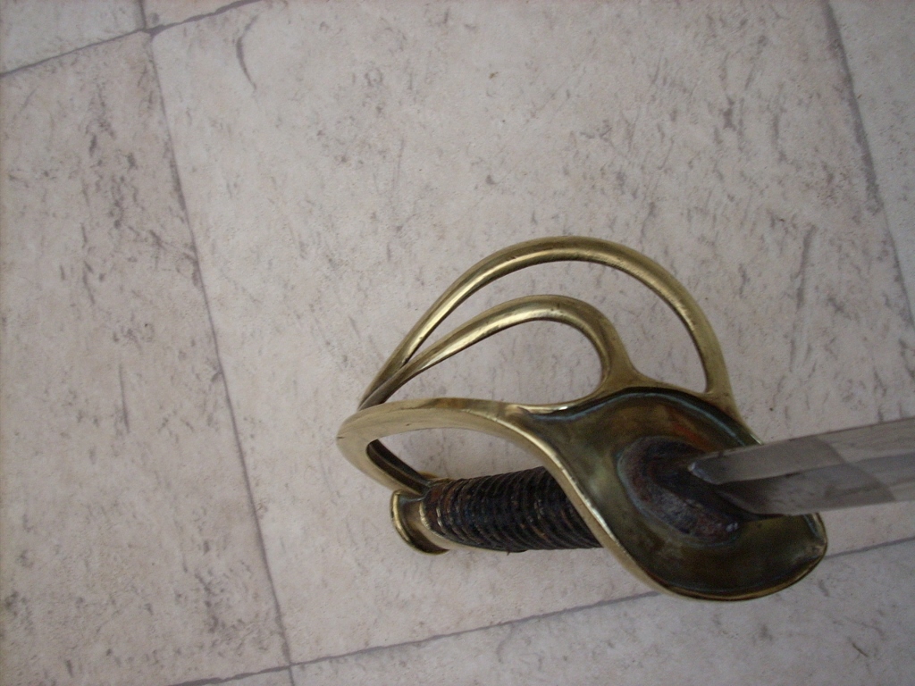

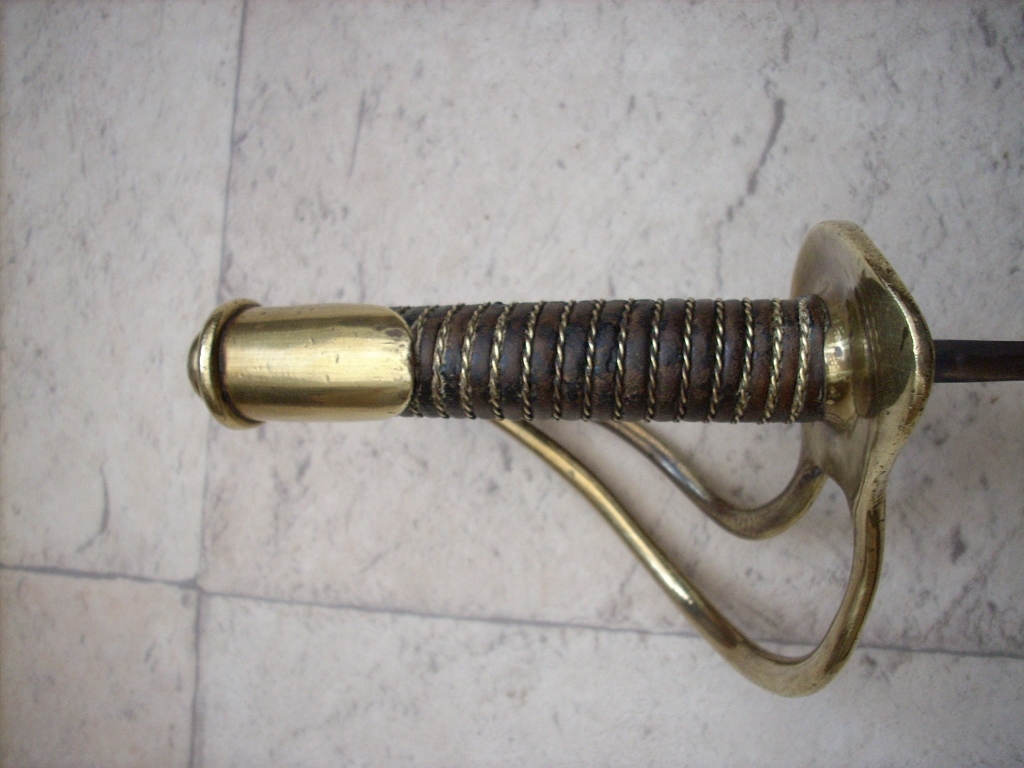

Sword with marks.
O/L out of scabbard is 41 ins.
Blade length is 35.25.
Blade width is 1.25 ins
Old 11th December 2015, 02:17 AM   #4
Hotspur
Hotspur's Avatar
Join Date: Jul 2009
Location: Nipmuc USA
Posts: 553
These both appear to be generic examples of the French 1822 light cavvalry sword. Likely produced in Solingen from many shops. Hundreds of thousands were produced and as late as the 29th century. A great many were exported and completely unmarked.
Some have cord under the leather instead of grooved wood and I would think that the use of cord was simply a production shortcut. My generic example was made in that fashion.
Cheers
GC
Old 11th December 2015, 08:18 AM   #5
RobertGuy
Join Date: Aug 2015
Posts: 135
Just to add that the US m1840 and m1860 cavalry sabres were based on this design and a good many unmarked examples were exported to both sides in the American Civil War.

Old 11th December 2015, 01:40 PM   #6
Lee
Lee's Avatar
Posts: 998
I can see traces of a blade marking on the image with a rack number on the hilt and closer examination of that may confirm or change the attribution.
Hi Lee,
Thank you for your reply, I wish they were markings but I am afraid that what look like traces of markings are in fact blemishes. I would be grateful if you would explain what " rack number" as I would like to know what these marks signify.
Miguel
