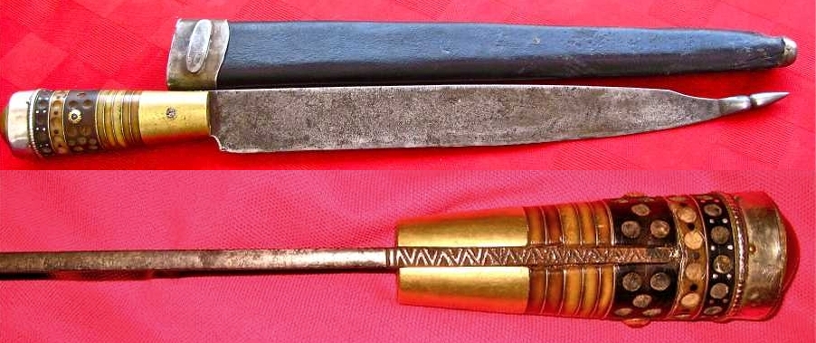

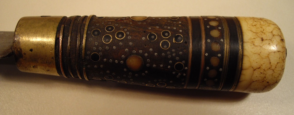

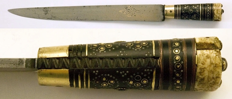

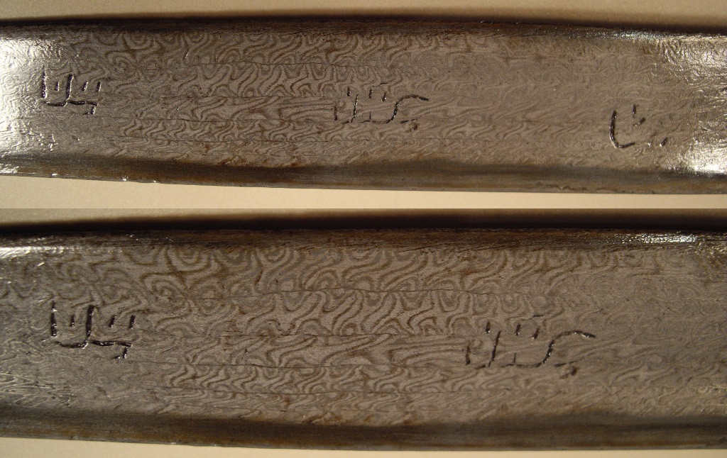

Default Ottoman Kard with Repurposed Yataghan Turkish Ribbon Blade
Here's an example of "tribal" Ottoman kard with what seems to be repurposed yataghan blade. the blade was likely damaged and re-fitted into kard at the time it was still in use. It has 6-twisted core Turkish Ribbon pattern, stylized cartouche and punched star-patterned symbols typical of Yataghan blades, and also three inscribed Arabic words/names. The handle is bone with brass studs, shell and coral inserts and ivory final. Similar handle decorations are found on Syrian shamshir handles of 19th C Ottoman period. so I think it could be of that area, or perhaps Balkan (Albanian?) Any comments are most welcome.

a very nice example! I am trying to read, think the script was more complete than this but so far it makes no sense to me.
It looks like walrus ivory.

I agree, the words are likely an ineligible writing, in suite with the primitive cartouche imitation. One would expect better quality writing on relatively nice steel pattern. Usually these blades have 4-5 rows, this one is a bit more complex than average.
Estcrh,
There's dark marble-like patina on top surface - yes, walrus ivory it is.

I suspect the writing to be part of the names of the seven sleepers, which appear often on yataghans with Turkish ribbon blades. You can look for Zifir's translations in older threads and compare the script.

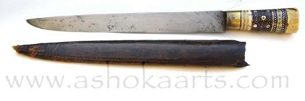

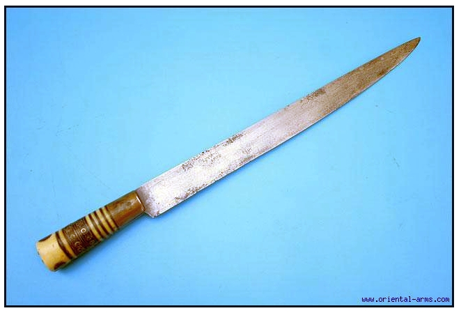

This heavy knife is a tribal, somewhat crude version of a KARD knife. Its origin is not precisely known but most probably some tribal Persian / Turkestan artifact. 14 inches long, heavy, single edge blade with a cylindrical grip made of layered discs of brass, black horn and bone, decorated with brass inserts. Bone pommel; and brass bolsters. Total length 18 inches. Very good condition. Minor pitted spots on the blade. Few brass inserts are missing. No scabbard. Very unusual and scarce of somewhat mysterious origin.

Perhaps these knives belonged to Turkmen (Turkomans), some tribes that live on the border with Turkey. It would be easy to explain the use of the Turkish blade.
http://www.ashokaarts.com/shop/large...damascus-blade

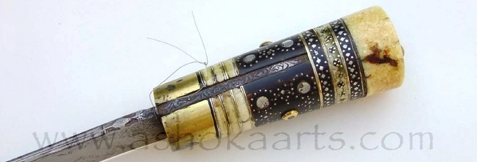

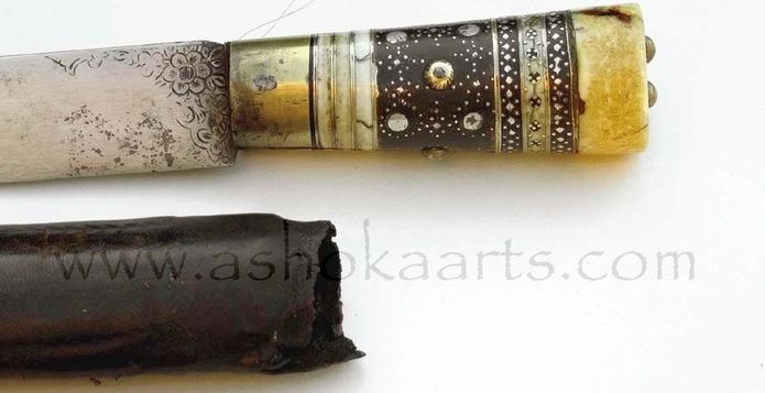

Looks like a match.
Large Turkmen or Uzbek kard dagger with wootz damascus blade
A large and heavy bladed Asian Dagger or knife of Persian 'Kard' type. The blade is of large proportions with a very thick spine which has a chiselled rib along it, the steel shows watering of a very fine wootz or 'damascus' type, the forte has chiselled flower decoration of persian style indicating that the blade was probably made in Iran. The hilt made from black horn and decorated with a large black of walrus ivory to the pommel, ivory and metal layering and inlaid studs contribute to a decorative appearance as often found on Persian, Asian and even Caucasian gunstocks. A most interesting dagger, retaining a leather sheath, age wear to areas of the blade and other parts. Early 19th century.

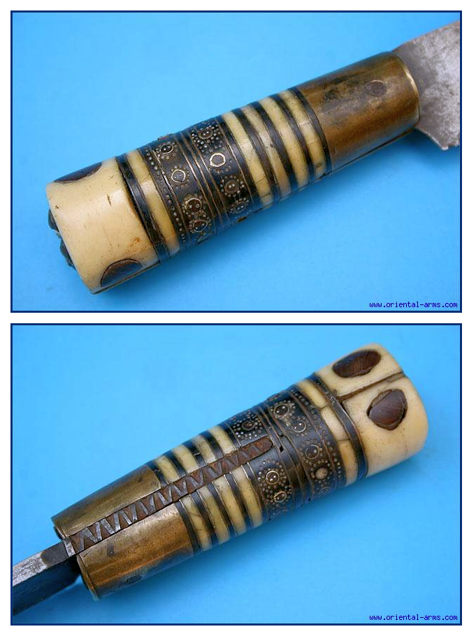

Arrow Another Example
Here is another example with the forte of a Persian shamshir being reformed into a kard blade.

Lee, what an awesome kard!
Further shows the re-purposeful nature of this type, with many having blades from other weapons. What strikes me the most is similarity of handle/blade assembly. All have identical mounting technique with similar decoration elements. I am inclined to categorize it as Syrian-Turkmen Kard.
