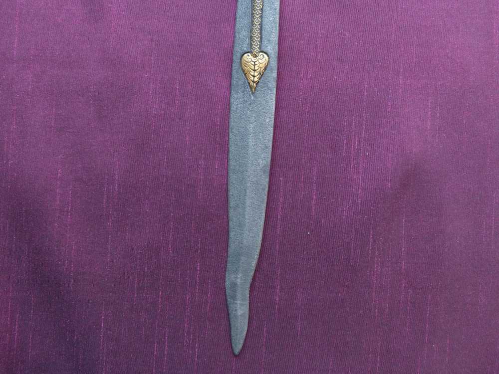

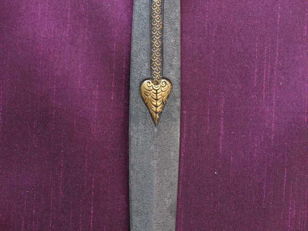

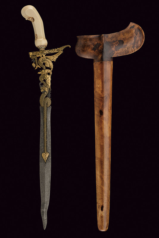

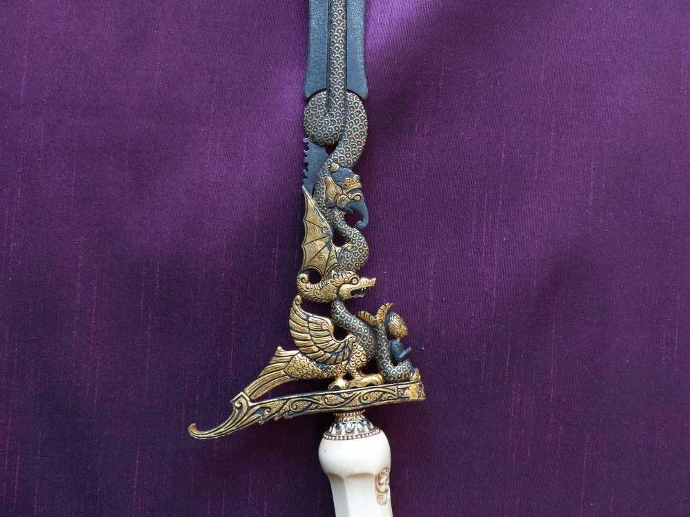

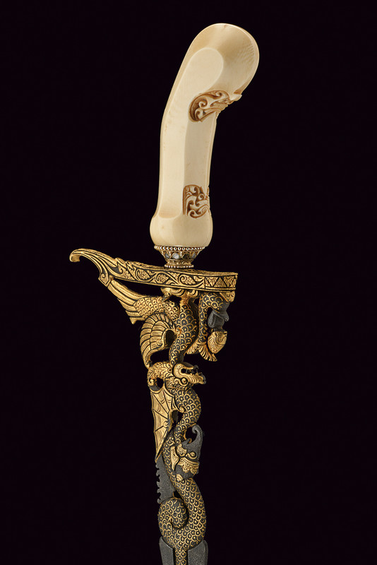

Default spectacular carving for comment
Javanese?!
Old 17th March 2016, 09:22 PM   #2
Posts: 7,255
Clever carving, but not a keris.
Art or maybe craft? Yes.
Skillful work? Yes.
A keris? No.

Old 19th March 2016, 01:11 AM   #6
Posts: 7,255
Battara, this question of yours is a horribly tricky one to answer, and it is something that keris people have debated for a very long time:-
what is a keris?
For me, it comes down to something that is keris-like needing to satisfy a few cultural requirements, before I am able to accept that I'm looking at a keris.
Other people who are very knowledgeable in the field of keris have various other requirements that sometimes relate to the purely physical appearance:- some will say that it must be asymmetric, others that it must have a recognisable gandhik, others that it must be able to be interpreted as a Gunungan, others (the real sticklers) that it must be in compliance with a known pakem.
With this object under discussion, the things that make it impossible for me to accept this as a keris are principally rooted in the design ethic which has no place in Javanese ornamental design, yet, if we were to get rid of all the out-of-place ornamentation, and fill in the holes, we would have a Javanese keris.
All the piercing in the sorsoran is strongly reminiscent of one of the things that used to be done with poor quality keris to make them more saleable.
I don't know where the craftsman drew his inspiration from, but the designs used look like something between a child's version of "Jack the Dragon Slayer", and a Chinese nightmare. The design by any Javanese standard is appalling. Absolutely hideous. But it is very clever work, well executed.
Then we have the consideration of the usefulness of this keris. These days a keris in Jawa is mostly viewed as an item of dress. I most sincerely doubt that any Javanese gentlemen with whom I am acquainted would be prepared to wear this keris under any circumstances. If the blade were to be seen he'd be too embarrassed to show his face in polite society ever again.
Then again, it would be useless as a weapon --- except maybe to wave at the kids stealing my fruit and cause them nightmares.
Nope this object is purely and simply a piece of canvas, its purpose is to permit the craftsman to display his skill, which is considerable. But he needs to go back to school and take a "Keris 101" course.
