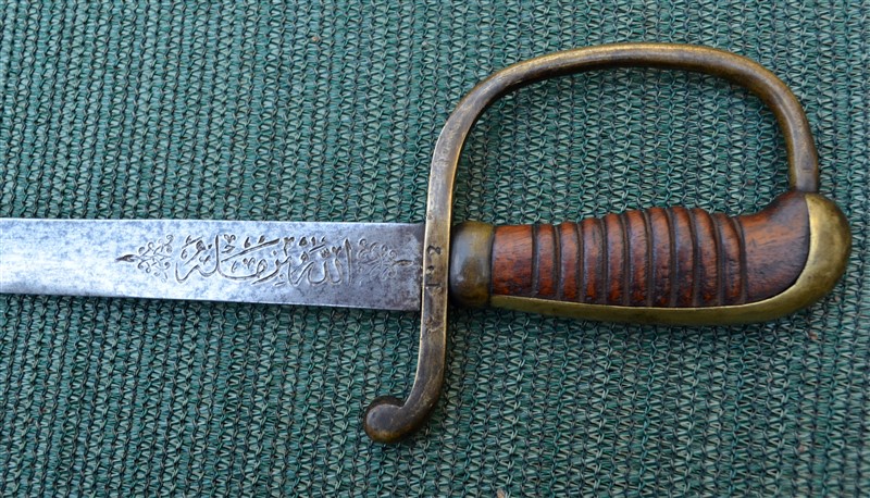

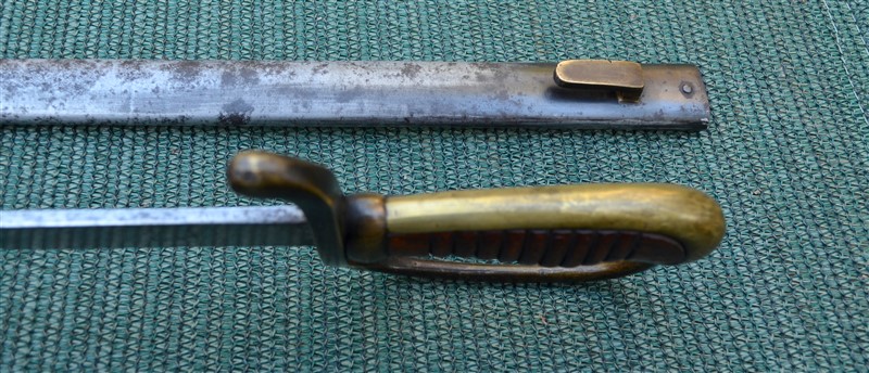

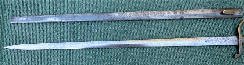

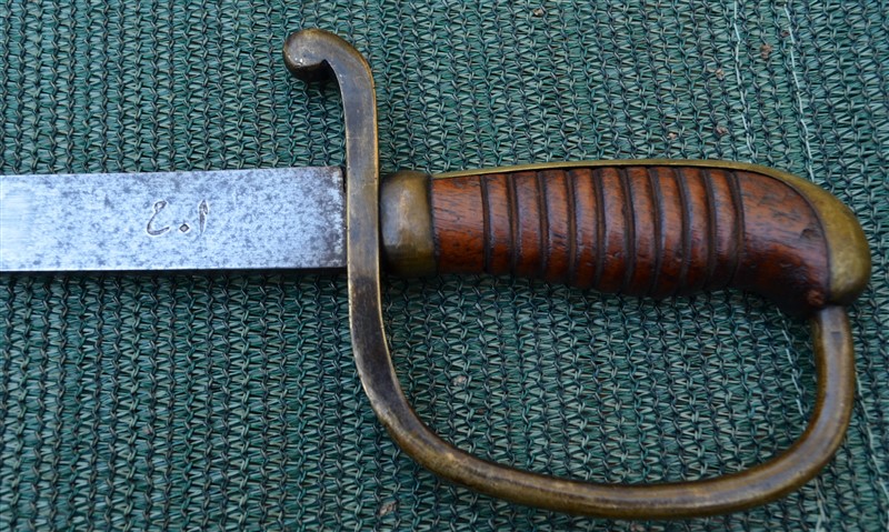

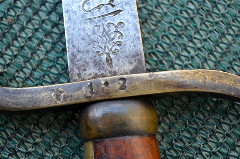

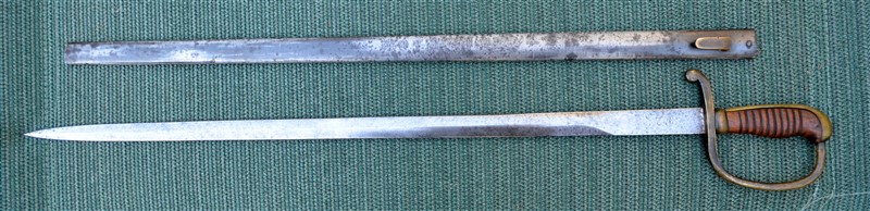

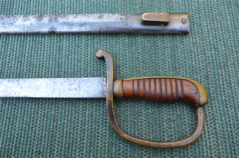

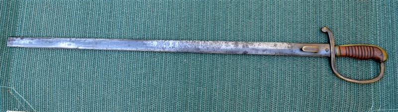

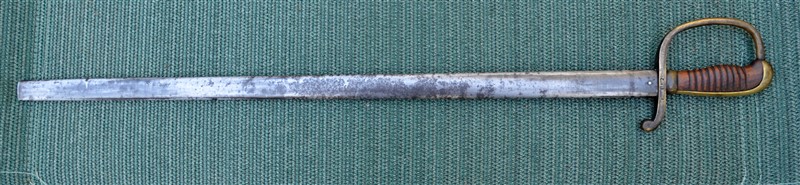

I recently picked up this 1909 Turkish "D, " guard officers' sword which surprisingly I hadn't encountered before ;especially in light of the large size of the Ottoman army.

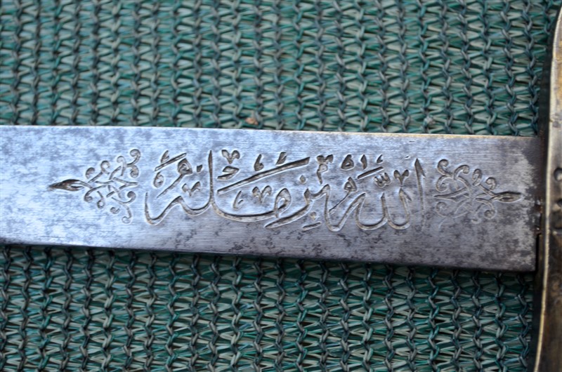

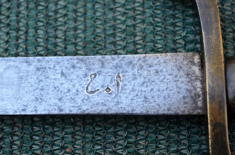

There is some type of name or dedication on the sword and if anyone could translate it, it would be appreciated !

I was also surprised that the sword scabbards do not have a drag, should be black and come with a frog.
