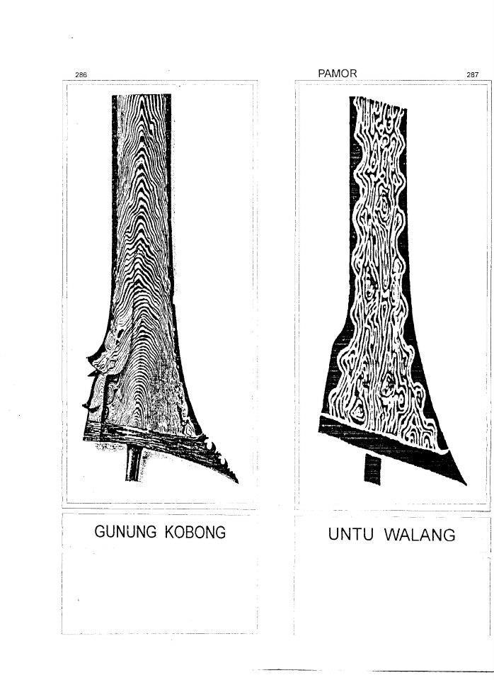

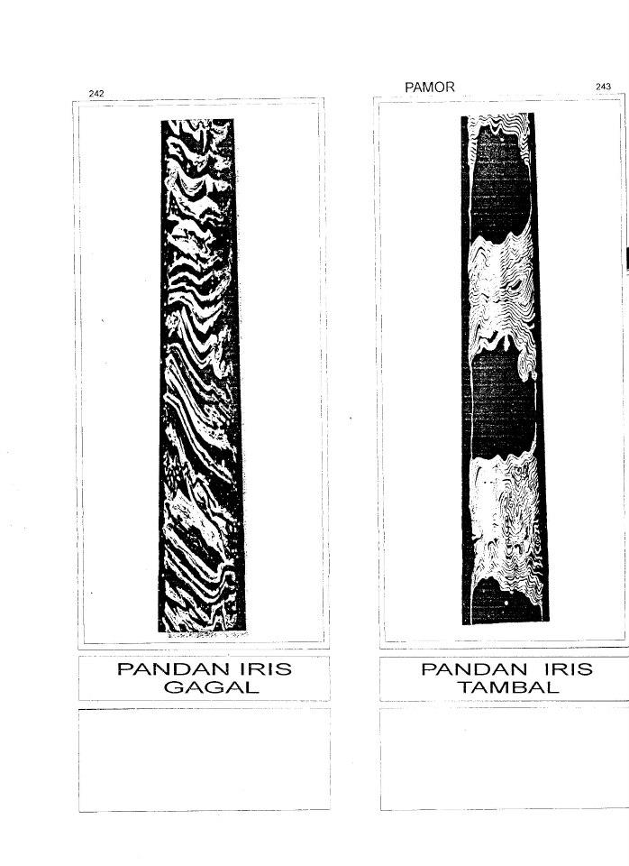

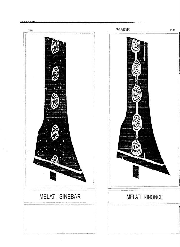

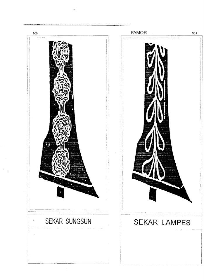

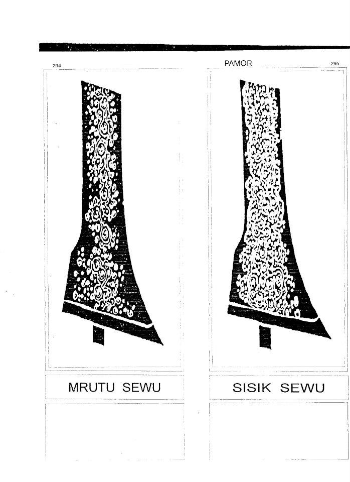

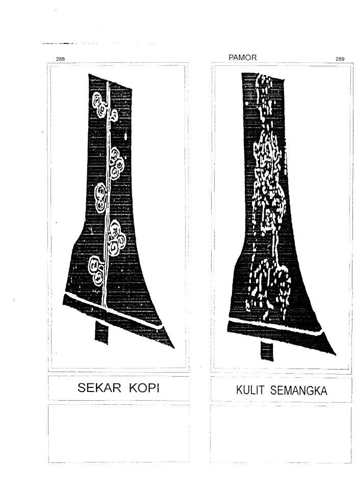

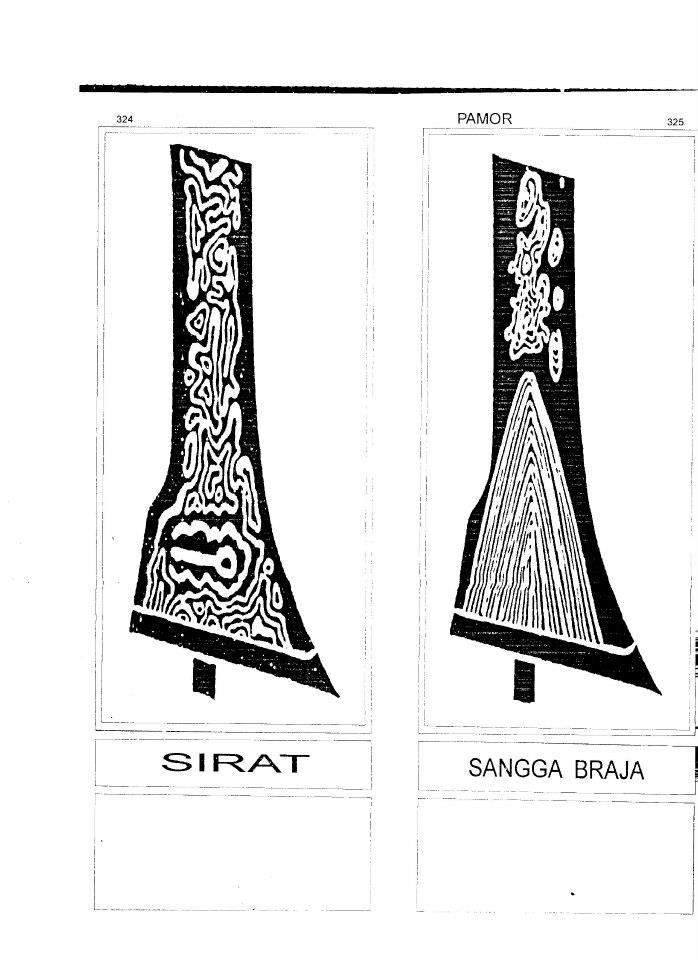

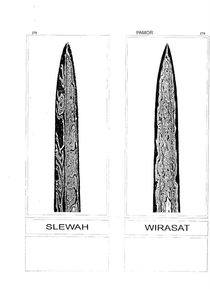

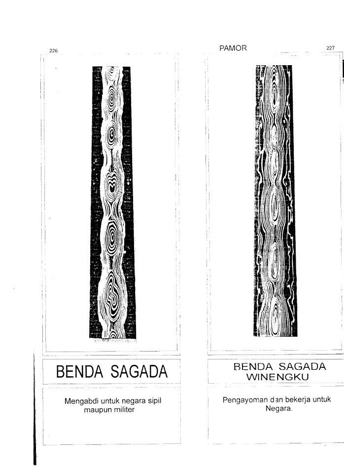

As I am a very new and uneducated keris collector, I would appreciate if any forrumers /experts /collectors can show their keris with good pamors . This will helpfully aid me in understanding pamor better and choosing better specimen to buy to upgrade my sorry collection.

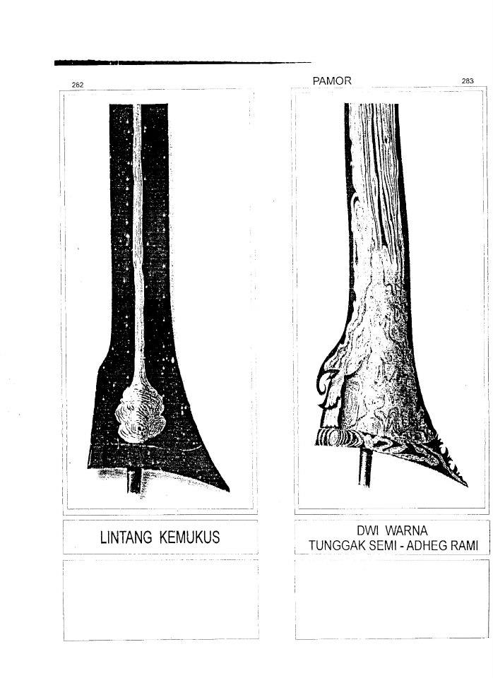

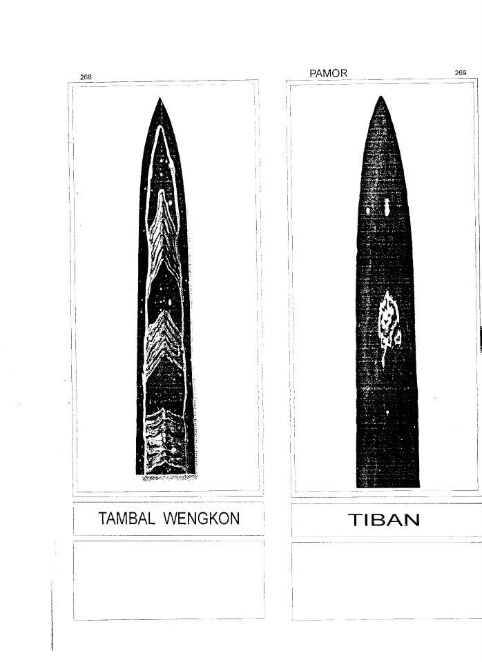

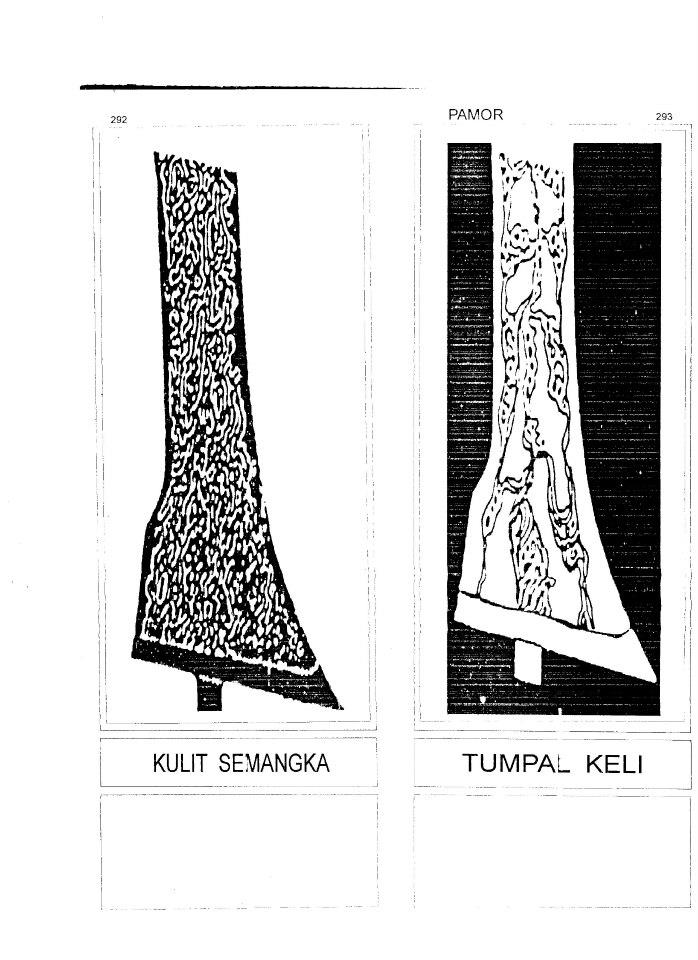

Pamor types are many, very complex and confusing to identify .Attached are some pics of pamor types/identification taken from an indonesian keris blog but I'd really like to see photos of real keris with good pamors from any of you. thanks.

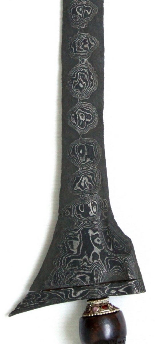

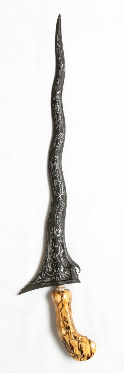

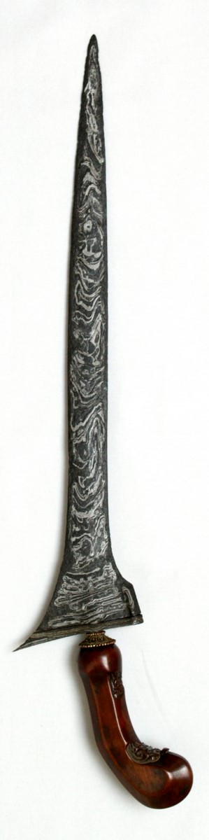

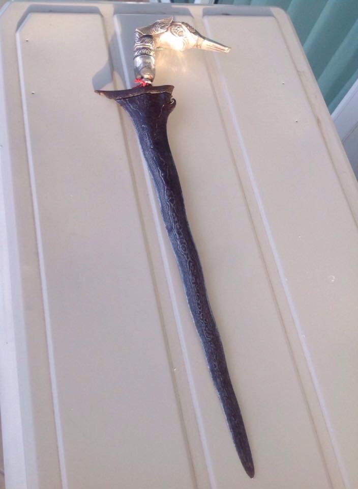

Hi Green,
The forum here is a bit quiet.
Please see enclosed example
maxbliss888 is offline   Reply With Quote
Old 6th August 2015, 06:39 AM   #4
maxbliss888
Join Date: May 2015
Location: Bangkok
Posts: 150
Default Kermis blade
Closer view
Looks like the Benda Sagada Winengku

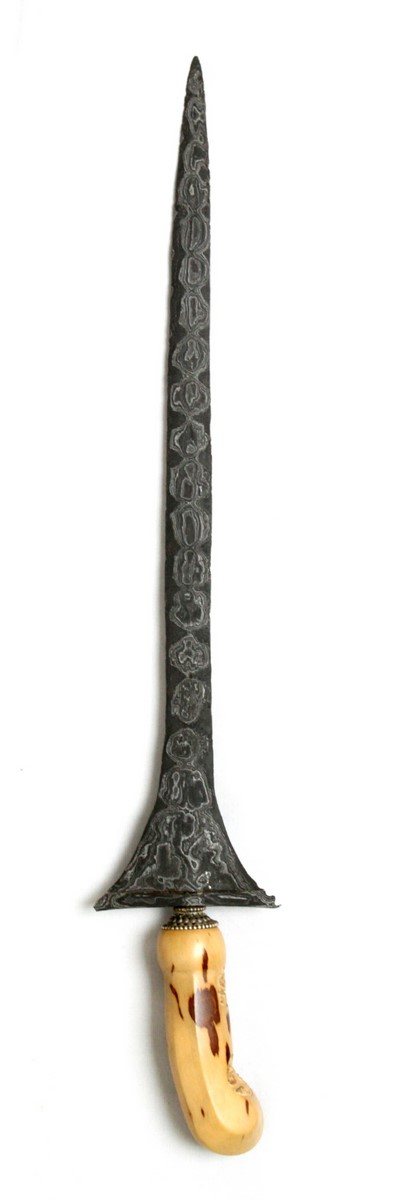

Hello Green,

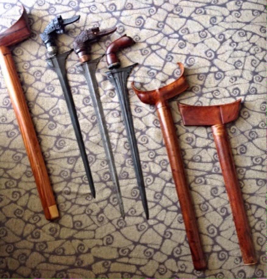

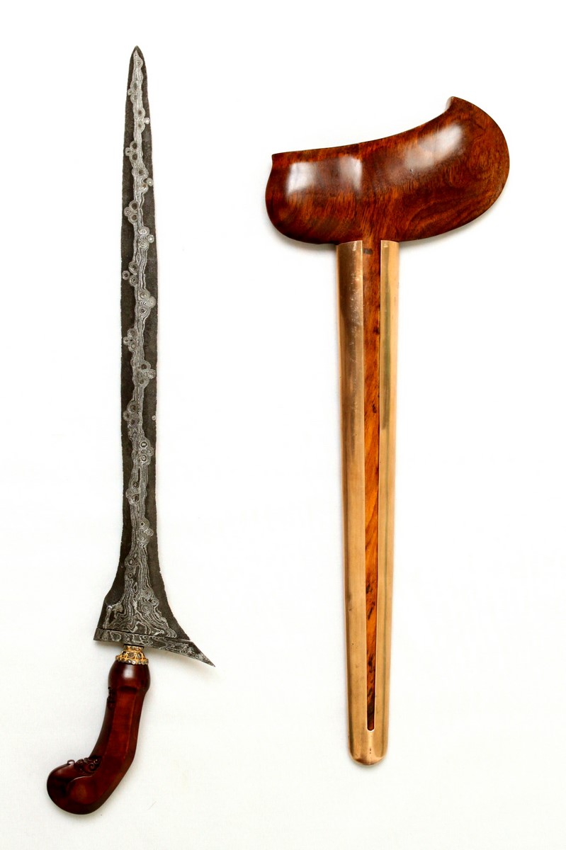

I understand your request and will try to help you but first you should realize that all these nice pamors are basically Javanese or Indonesian and it may be extremely difficult for you to find old blades with such pamor.
I attach the pics of 5 blades with a style of pamor included in your list, will you be able to identify them? I can provide more detailed pics if required.

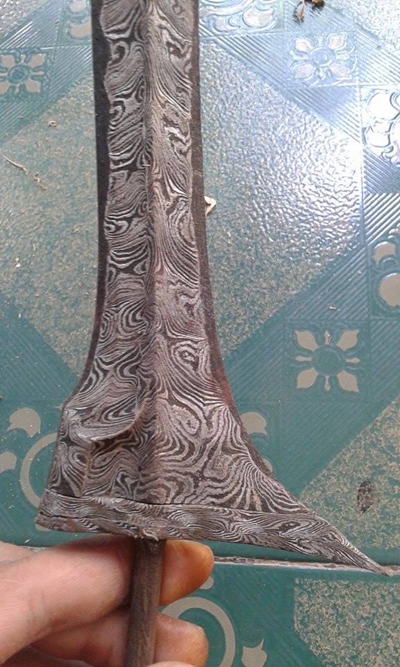

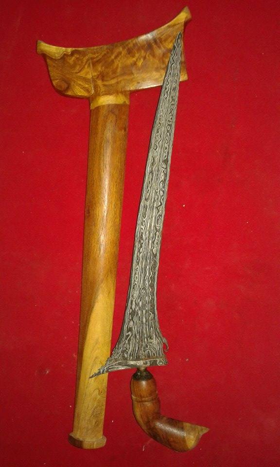

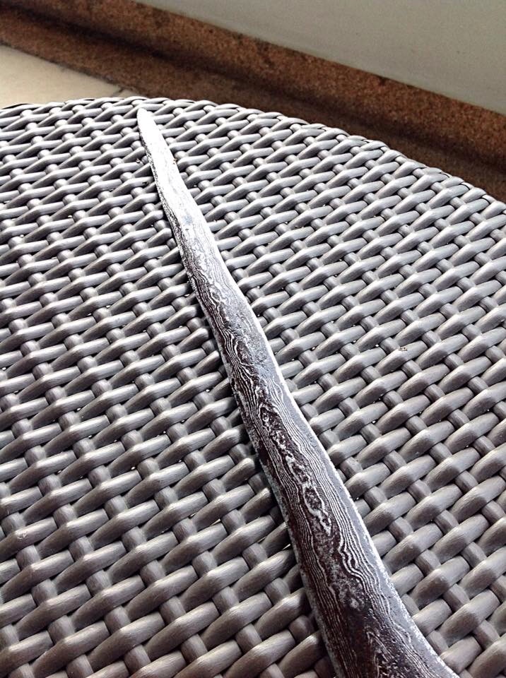

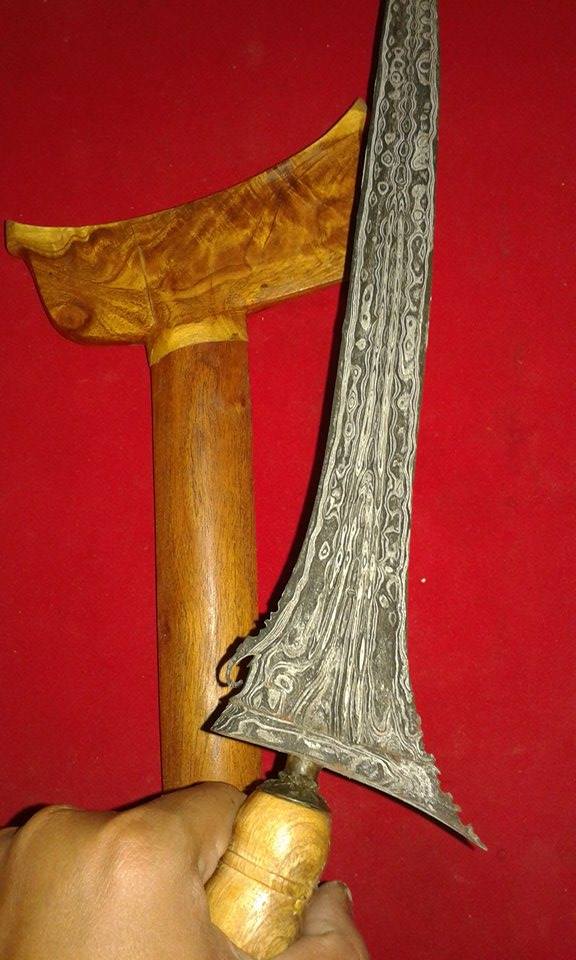

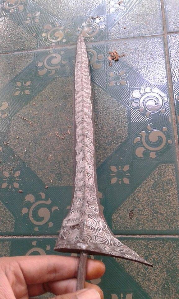

Here's the problem. facebook is full of young Indonesians trying to sell new keris for dirt cheap price (very often around usd150 or less) and based on the pics some have quite good looking pamors.
The issue is; are these really good keris with good pamors ? (albeit new ones/not antiques)...how do we judge them (from the pics) ? I guess by looking at examples of good old keris genuine antique keris pamors...? hence my original question posed here.
Here are two examples of new keris offered by fb friends... what do you think of these pamors ?
Old 8th August 2015, 09:37 AM   #14
Henk
Henk's Avatar
Posts: 1,209
Very nice pamors on both blades. Both keris are brand new. My problem with these two blades is the rust. Maybe it is slight surface rust that can be whiped away with a cloth and oil. After treating a blade with warangan it should be oiled preventing from rust. I don't know how the dress of the second blade looks like but i wouldn't be punished with those two kerisses.
You'd better do some reading on this forum. There are some threads that are discussing your question i suppose.
http://www.vikingsword.com/vb/showth...hlight=tourist
Old 8th August 2015, 10:56 PM   #15
Posts: 7,229
I wouldn't say "brand new" Henk, this type of Madura work has been around since at least the 1985. There was similar stuff done in Madura, and maybe East Jawa, in the early 20th century through to WWII, but not a lot of it, so its unlikely to be from that earlier period.
The little bit of rust on these blades is negligible, and not a cause for even the slightest concern, it can be cleaned off with patience, penetrating oil, a hard toothbrush, and a few strands of 00 steel wool wound around the end of a wooden sate skewer.
Quality of these two blades? Pretty ordinary. Certainly not bad, but also certainly not exceptional. FAQ.
Rather than focus on how good, bad, or indifferent the pamor is, I would suggest that garap should be given precedence in blade appraisal, with well executed pamor, if present, being a nice little extra.
