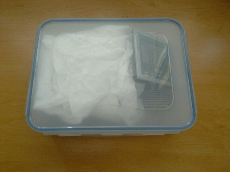

My approach to this issue is called "passive humidity stabilization". If here are any cigar aficionados around they will know the system. Its similar to a humidor. But conditioned to 50% and not 70% humidity. 50% humidity prevents to have fungus on organic material spreading and the stabilizing the humidity prevents cracks from upcoming tension due to expand and shrinking materials. It also prevents paper falling to dust and leather crumbling apart.
The whole package fresh out of the vault.
SEE PICTURE 1 BELOW

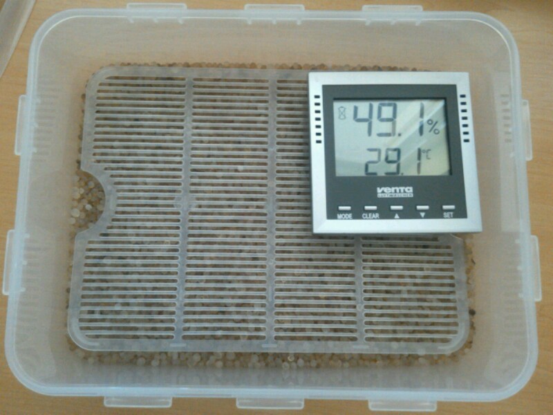

I use a airtight "tupperwarebox". Make sure its BPA free and has the food safe sign. Museums use special kind of foils which are even more airtight. But since i regularly visit my items anyway, my focus was more on stability. Please note if you are thinking now to invest in a similar system, any ivory item needs to be in a clear coloured box. Without light, ivory tends to get yellowish-biscuit coloured which is less desirable.
SEE PICTURE 2 BELOW

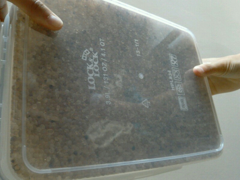

view from bottom
SEE PICTURE 3 BELOW

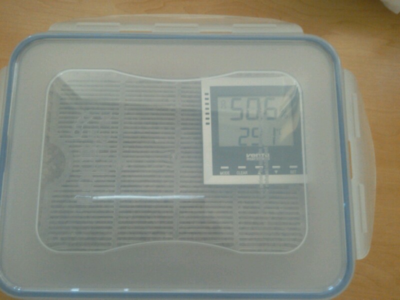

How it looks inside. (the fence thing inside came with the box and was not bought intentionally. However it proofed to be very practical to separate the pearls from the item.)
SEE PICTURE 4 BELOW

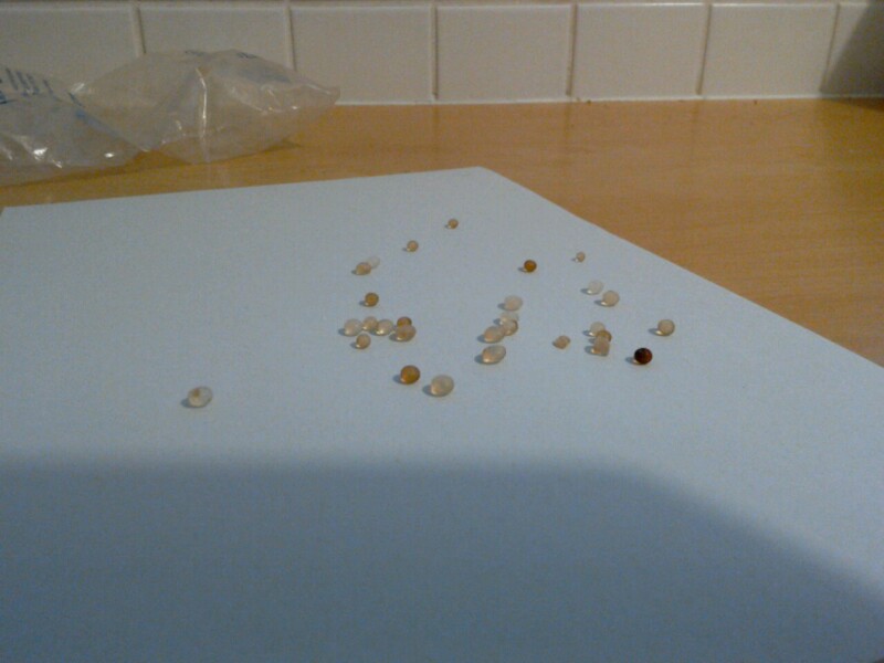

pearls closeup:
SEE PICTURE 5 BELOW

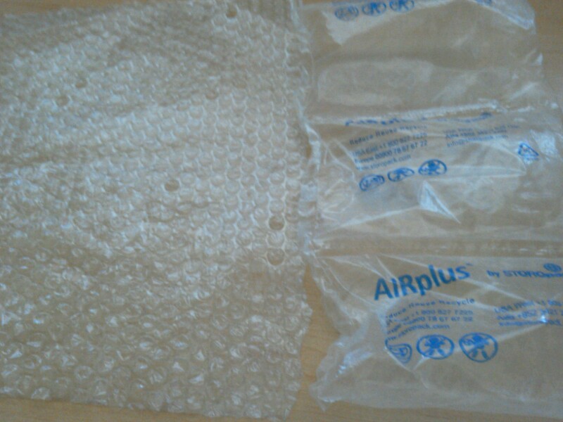

2 different airbubble foils for warehousing depending on which size of the item. i always pack my boxes additonally with them in case of an earthquake, a attacking godzilla or whatever
SEE PICTURE 6 BELOW
