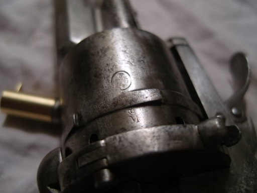

Hello all.
Not sure if this is allowed. This barrel is from an Algerian long gun I recently Posted on the Ethnographic Forum. Thought maybe one of you European enthusiests might reconize it? Looks European (?) of some sort. Thanks for any help.
Rick.

Hi,
It looks very similar to an Inspector's Belgian proof mark, of the type used between 1853 and 1877. If that is indeed the case, I would expect that the barrel would also have the EL or ELG proof mark, perhaps hidden under the stock?

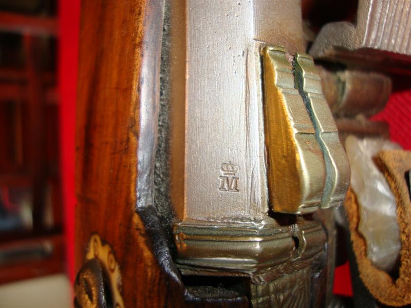

Originally Posted by Andreas
Hi,
Yes like a Liege Malherbe mark.

Posts: 96
I meant the mark of an inspector of the Liége proof bench. Malherbe was a manufacturer, they didnt use a crowned M as their trademark but " PJ Malherbe a Liége"

But they also did inspection work too. To give two examples on guns ...
1.

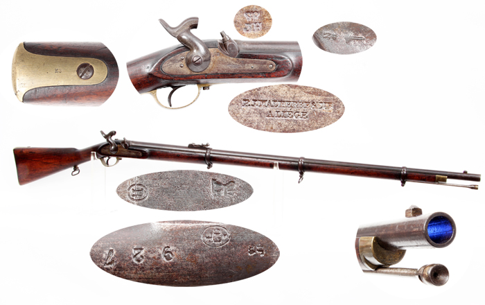

The attached picture shows a a Belgian Made Spanish M-1857 Rifle Musket .The buttplate is marked with Malherbe’s
(CROWN) / M mark.
2.
JC Militaria has a mid 1800's .59" Bore, Norwegian/ Belgian Military Kammerlader Breech Loading 'Under Hammer' Rifle. Breech Marked 'PJ Malherbe & Co, Liege'. A 554 A 554The breech
is Belgian manufacturer marked 'PJ Malherbe & Co, Liege'. The trigger
guard and action have matching numbers '148' and it has several small inspection marks including 'Crown Above M'.

Gentlemen:
Thank you very much for your responses. So, may I conclude this is likely a Belgium made barrel, with a Malherbe - Liege Inspector's mark ?
Rick.

That is what I believe is most likely, however , as we all know, native made weaponry was often 'enhanced' with European markings. Usually though, these spurious markings are easily distiguished. To my mind, this marking is genuine. But that is only my opinion.
