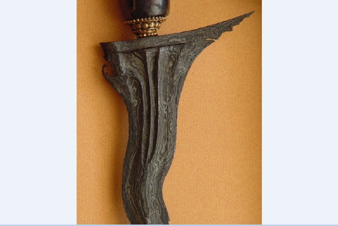

I've noticed that some keris blades on sales from western collection are over cleaned in my view. They looked shiny and feel very smooth like modern knife blades and often oiled. They looked nothing like when they were first forged which is rather dull in color and rough and grainy like fine sandpaper to the touch.
You'll never see this kind of over cleaning in any keris on sales in this region and at least to some keris collectors in my country (Malaysia) that I've met this over cleaning (?) is considered as destroying the blade and value.
I would appreciate your views on this (over cleaning).

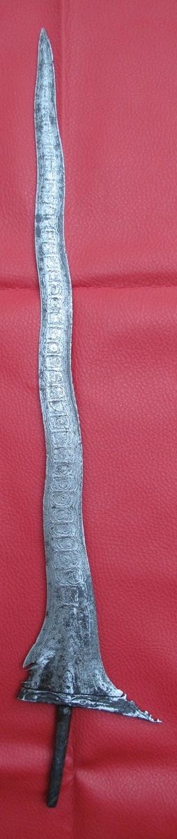

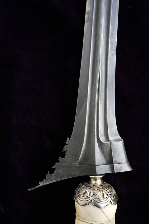

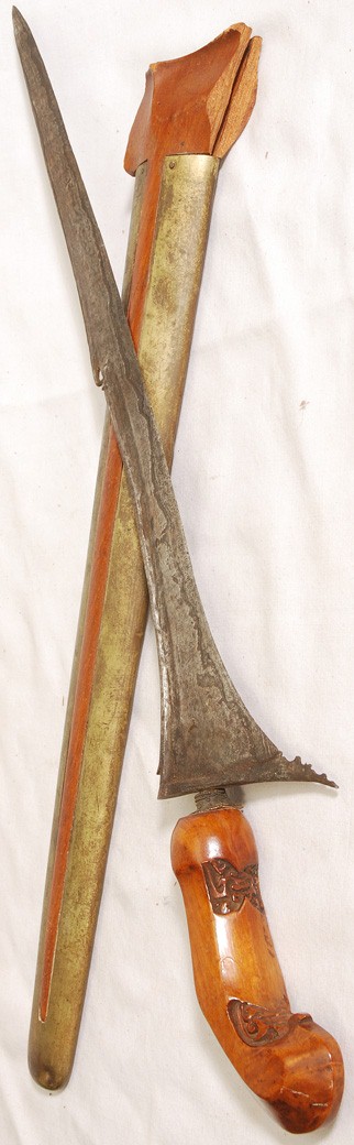

Thanks all for the explanation. Here is an example of what I would call an over cleaned blade.It looked shiny , smooth to the touch and the color is silvery. compared to what some would view as 'normal' surface which is duller original color and the surface feels somewhat like v fine sandpaper (the second pic).
Old 2nd July 2015, 03:35 AM   #6
Posts: 7,229
Two keris of very different age and very different material:- we cannot compare apples to rambutan.

interesting comment that Mr A G Maisey. The over cleaned keris is mine and supposed to be quite old possibly late 19th century/early 20th?. Do you think this is so ?
The latter I don't know as i just pluck out the pic from the net. But be that as it may , irrespective of old or new keris, one would expect the surface look would be the same ?
Old 2nd July 2015, 07:39 AM   #8
Posts: 7,229
Green:-
When we start to talk about the age of a keris blade, or any other tosan aji for that matter, we are moving into the area of blade classification, ie, "tangguh", and this is a field that is full of misunderstanding, misinterpretation, and extreme difficulty. It is not an area that anybody with any degree of knowledge likes to get involved in when all they have to form an opinion are incomplete photographic representations of a blade.
That said, I am still prepared to make a couple of comments.
The blade you consider to be over cleaned is a relatively young blade, I'm not prepared to classify it, but it probably does come from the era you have nominated, say, later than 1850.
The other blade comes from a much older period of time.
The materials used in a blade are a major indicator in classification of a blade, and they vary from era to era. We do not expect a 17th century blade to use similar material to that which is used in a 19th century blade.
Some Javanese blades from the period after 1850 used some rather odd materials for pamor material. One such material was Dutch coinage, and blades containing this material have a smooth, greasy feel.
To understand how a keris should look takes a great many years of dedicated study, combined with the opportunity to handle literally thousands of blades. In short, a 19th century Surakarta blade will not have material that looks even remotely like a Pajajaran blade that comes from a much earlier time.
Before we can form an opinion as to whether or not a blade has been correctly cleaned, we need to know what it should look like when it has been correctly cleaned. Before we can form this opinion we need to be able to classify the blade, that is, give it a tangguh. Before we can give it a tangguh, we need to handle it.
Photos are not adequate in this instance.

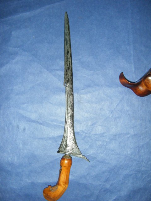

Green, it's not even just a matter of old or new, though that is obviously a factor. Since you live in Malaysia you must know that the country that is Indonesia is made up of numerous cultures with varying customs. So how the surface of a keris looks depends not only upon the exact materials used, how old it is and how many times it has been acid washed, but also the tradition of treatment for that particular area and local culture. Though the keris as we know it began it's life in Jawa, as it spread throughout the archipelago differing local customs were applied to it's treatment and care. Some areas are more aggressive with the acid washing of blades than others. Some areas like Bali polish blades to a smooth surface after washing and staining. Some areas do not stain their blades. It all depends on the area and time period that the keris is from.
Here is an example of a Balinese keris (late 19th to early 20th Century) with a traditional smooth surface and stain as well as a keris from the Malay Peninsula with a smooth surface. Both these smooth surfaces are correct surfaces for these types of keris IMO.

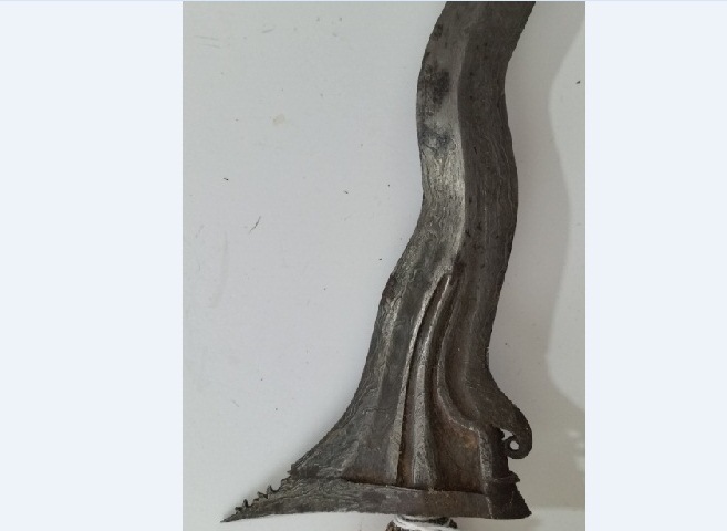

Hello Green,
IMO and by Indonesian standards your blade is not over cleaned but poorly maintained, it has several rust spots and the pamor pattern looks indistinct probably because the blade surface was polished with fine abrasive materials.
Personally I would have it professionally cleaned and stained, see an example of a blade before and after treating it with warangan.

this is precisely what I am talking about. the pre cleaned pic of the blade you posted is what I would think is the one intended to be and preferred by many collectors in this region (?). At best it should be only lightly cleaned without destroying the texture and color of the blade.
The cleaned blade you showed whould be considered 'overcleaned' and destroyed the surface of the blade in my untutored opinion.
This is only my uneducated view but based on the kerises I've seen in museums here I've not seen any keris that are cleaned as such and they all are left rusty and looking 'aged'.

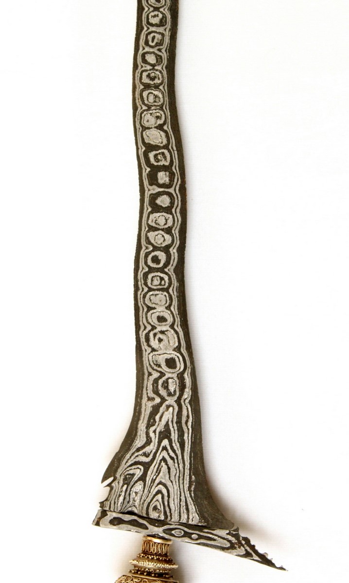

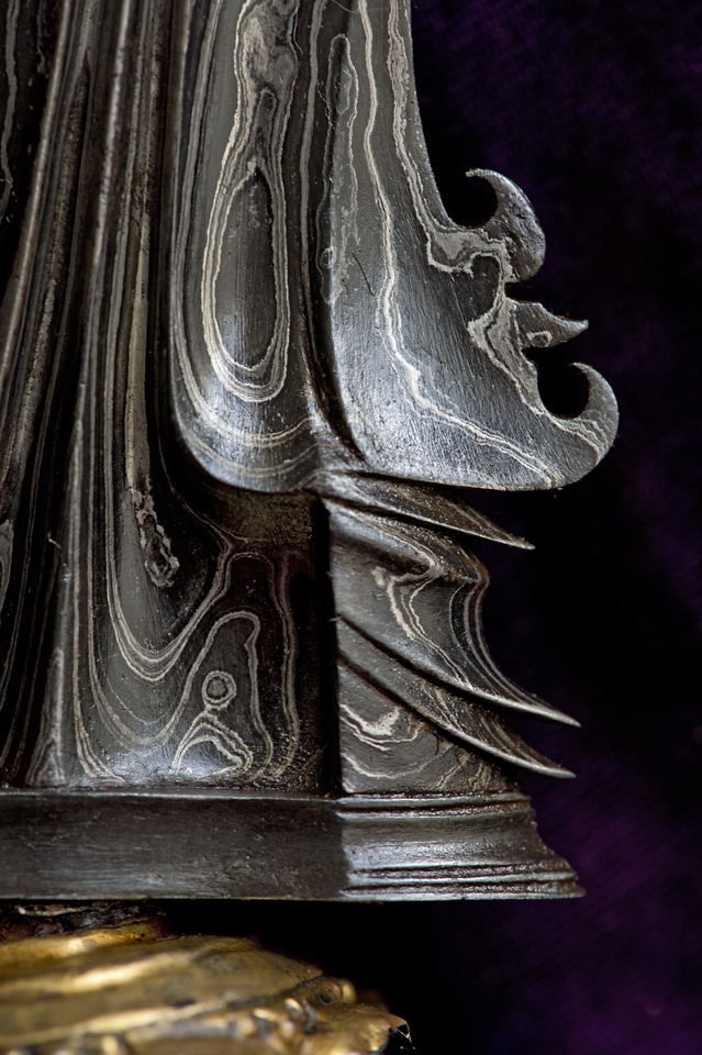

Green, you would not likely see keris in museums presented in the way Jean's stained blade is because it is not generally the practice of museums to restore a keris, but rather to conserve it, to preserve it at the same level as when it was received at the time of collection.However, when a keris of this sort was actively being used within the culture it would be part of a regular ritual process to clean and re-stain the blade.
Likewise collectors have different approaches for the care of keris dependent upon how they relate to the weapon culturally. Some like to keep keris at the same condition as when collected, other treat the keris as if it is still active within the culture and give it the treatment that would be expected of someone's personal keris.

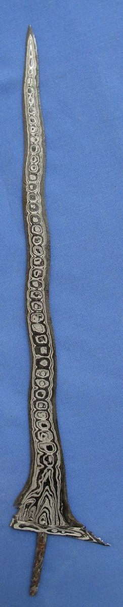

I think that Javanese collectors will clean and etch their keris blades as well. A keris from Java, Madura and Bali has pamor and to show the pamor is what it is to intended to do IMHO. A Malay keris don't have pamor normally and don't get a warangan normally.
I agree also with the statement from David in up.
Here is a blade from Java from my collection before and after cleaning and warangan.
