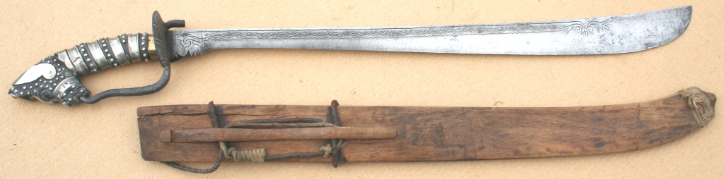

A friend recently picked up this sword on eBay, he thought it was North African. I tend to think it's from the East Indies.
What are your thoughts?

my first thought was mexican, espada ancha.

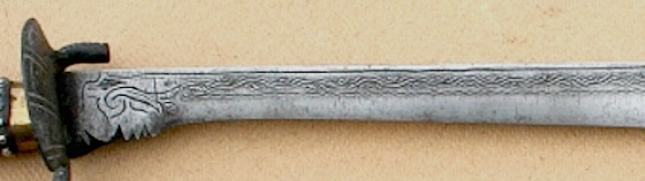

I, for some reason, am thinking of Borneo: kind of Parang Nabur-ish ricasso and blade incisions.

Looks Spanish colonial to me, especially the hilt.

that's what made me think it was an espada ancha (possibly not mex, that wasthe 1st that came to mind. )
the blade is also quite machete shaped

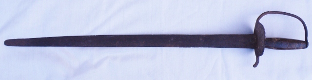

colin henshaw
Join Date: Jan 2008
Posts: 1,435
Nice sword. The hilt form reminds me of this one, on a sword I posted on the forum some time ago, also thought of as probably Colonial Spanish American.

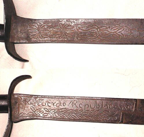

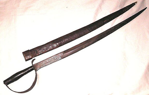

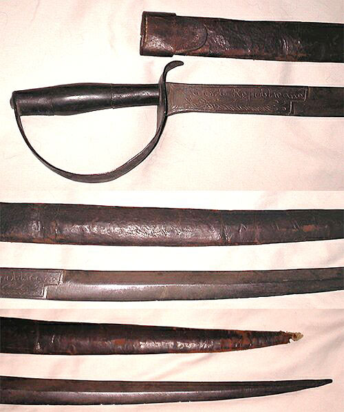

Posts: 4,749
Here is one of mine from the old UBB forum. It has a triangular blade and the inscription "Recuerdo Republicano." There are also floral designs at forte that seem similar to those on the first sword in this thread. My sword was thought to be from about the time of the first Philippine Republic in the early 1900s. The accompanying leather sheath is typically Filipino and would fit that period.
Ian.

I will give you my opinion. I'm not an expert of this kind of sword. As our colleagues said above, you have to see the Spanish colonial swords like another type that you can see in this thread:
http://www.vikingsword.com/vb/showth...berber+morocco
Philippines, Mexico, Cuba, Morocco, they were all under Spanish influence. I think that's a big mistake to try to put these swords only in one box.They were produced locally following more or less the Spanish models quoted previously. Yours looks North African to me.

Thank you for bringing up that thread Ian, and as you well note, there is a great paucity of data on Spanish Colonial arms, and as keenly noted by Kubur, it is virtually impossible to regionally classify most. The "Spanish Main" was a vast trade and colonial network which survived into the 20th century, and the influences of these sword styles diffused into many of their trade entrepots.
I am inclined to think of this particular version as from the Filipino spectrum(as seen in another variation in your post #8).
