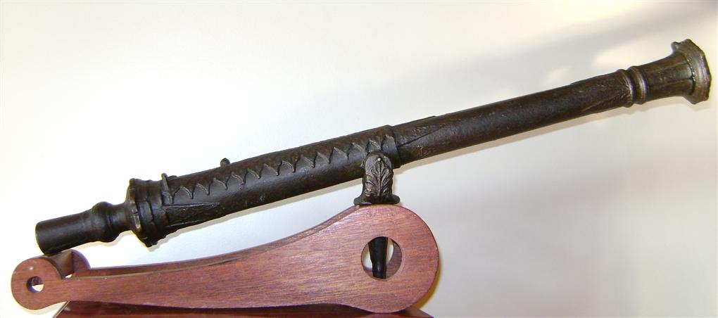

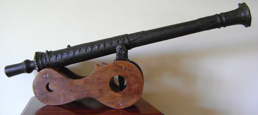

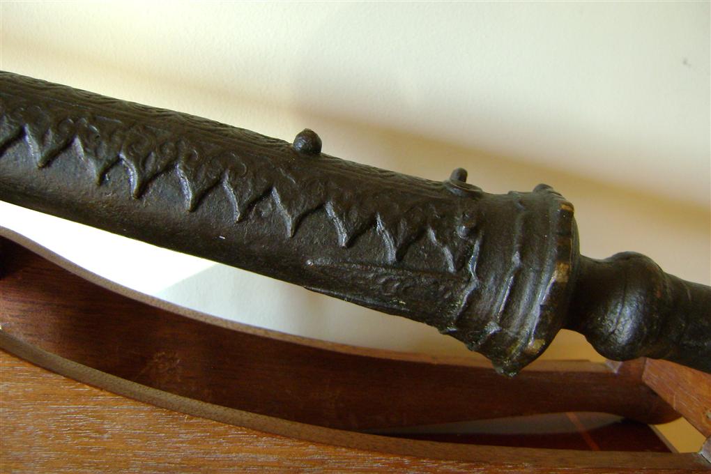

For some time now i managed to dispatch my Ethno stuff and turned into European; options, you know ...
But one or another Ethno weapons never left my wish list.
Such is the case of the lantaka, of which i have just acquired this example in London last week.
Actually there were three of them in the shop but, for budget reasons, i bought the smaller one. It measures 70 cms., weighs some 7,5 Kilos and has a 23 m/m bore.
I don't have the faintest idea of its age, provenance and authenticity.
Could you guys post your opinions on this piece? If this is a knockoff, i beg you not to hit me hard, but still tell me the truth

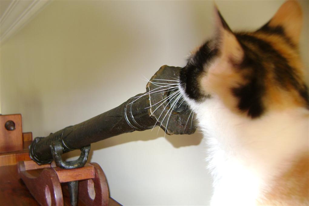

... and don't pay attention to those whiskers, in front of the cannon muzzle. This one didn't come from London; it is my one eyed Sofia, that someone decided to knock at my door with such gift.

An Indonesian lantaka, perhaps Borneo?
Old 3rd March 2013, 10:22 PM   #4
Agree with Jose. And look authentic. BTW, a lantaka is on my wish list as well!

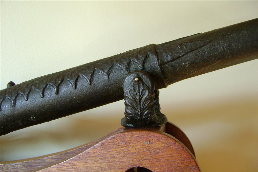

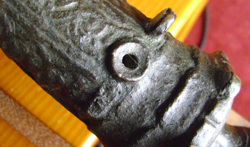

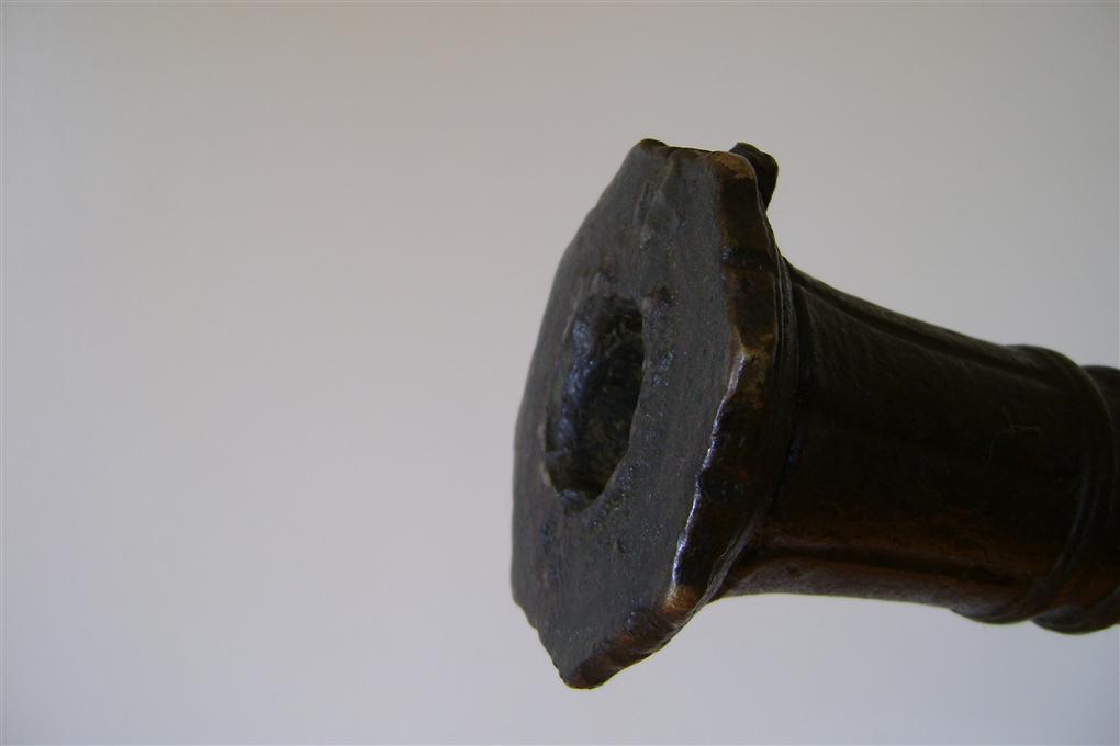

Your lantaka looks good from the photos, Nando... the trunnions are below the centerline as one would expect on an authentic example. Can you take and post a close-up photo of the touch hole?
Also, I got a kick out of the cat. Our own likes to be around anything that is sharp and pointy or goes bang - especially if there's a camera invovled...

Awesome lantaka, Fernando!! I have also always wanted one of these and hope to acquire one someday. Yours looks absolutely authentic. It shows honest aging with some wear to the decorations. Note that yours isn't as 'decorative' as other models, something that I like because it points to its use as a weapon versus as simple window dressing (poorer quality 19th c. pieces were used as currency, as wedding dowry, etc). Judging from the length (27") and size bore (just under 1"), this could have been either a signal gun or as a defensive weapon (or both!). The real small ones are less than a foot (party-poppers!), while the largest are truly huge cannons vs rail guns. They would have fired either a large shot (1/2" ball) or the equivalent of partridge shot. Based on the fact that the trunions are 'closed', yours is post-1750/1800. If the ends of the swivel were open, they would pre-date 1750 (I had to go over some old notes to find that fact!). As far as where it is made, I'll have to look over my notes on these. I seem to remember that the ones with alligator decorations, seahorse designs were Malay? The plainer ones were Borneo? Can't remember...
Good find, my friend!!
Mark

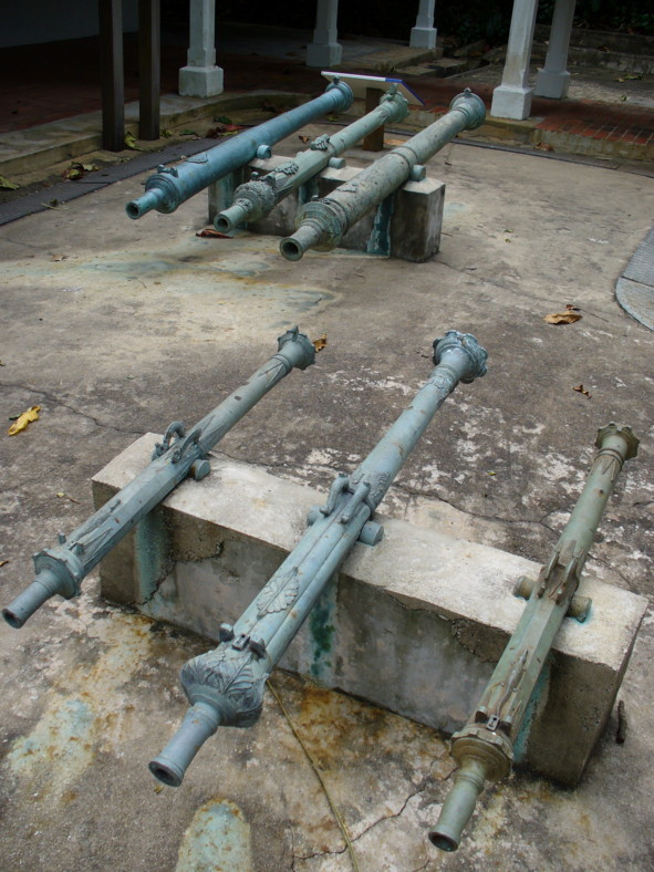

Posts: 2,833

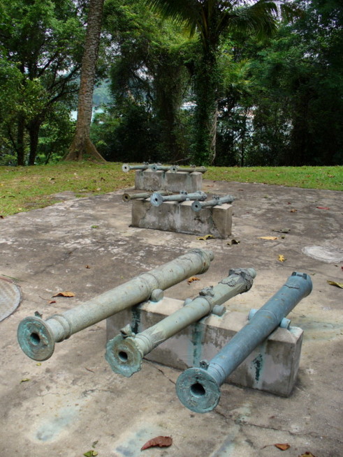

For interest, here are some on display at Fort Siloso in Singapore.
Stu

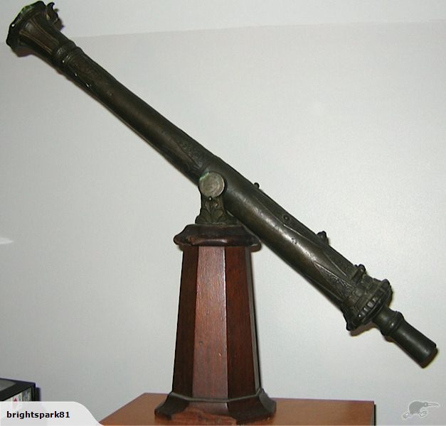

I saw a similar example for sale at Michael Backman of London.
I guess that is a good thing

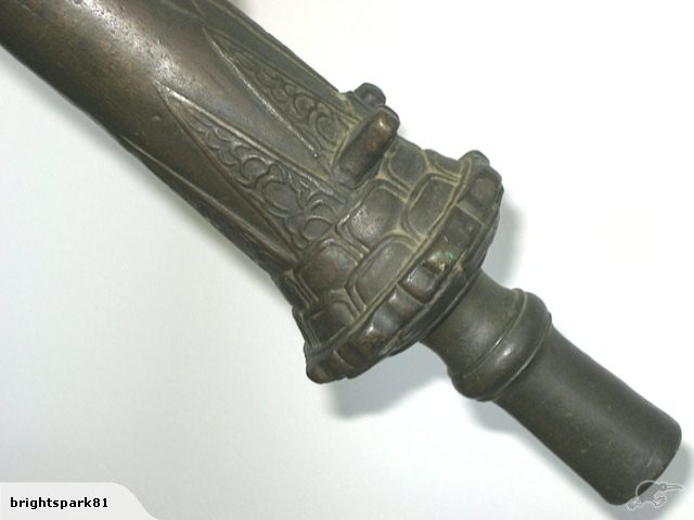

the bamboo shoot motifs on Fernando's example are longer for starters.

... Can you take and post a close-up photo of the touch hole? ---

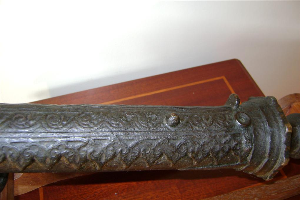

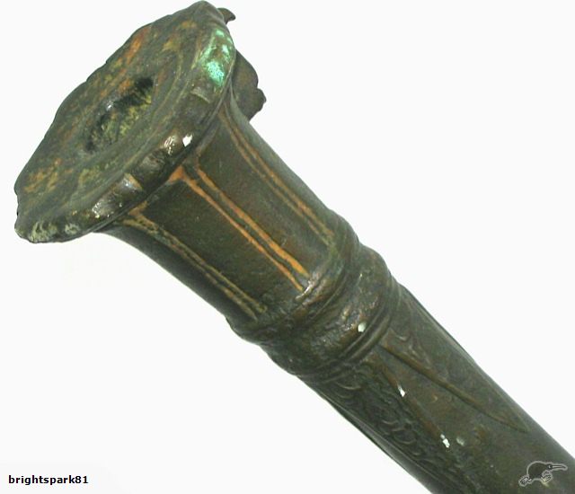

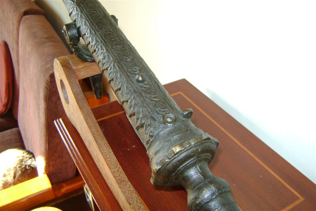

Sure thing Chris ... and also a close up of the tail interior. I think i will mount a 20 cms. bamboo cane tiller in it ; what do you think ... silly idea?

... Also, I got a kick out of the cat. Our own likes to be around anything that is sharp and pointy or goes bang - especially if there's a camera involved...
You can't imagine my struggle trying to take pictures of collection items with them five around.
That's why i usually wait for their "siesta" time to perform my photographic sessions

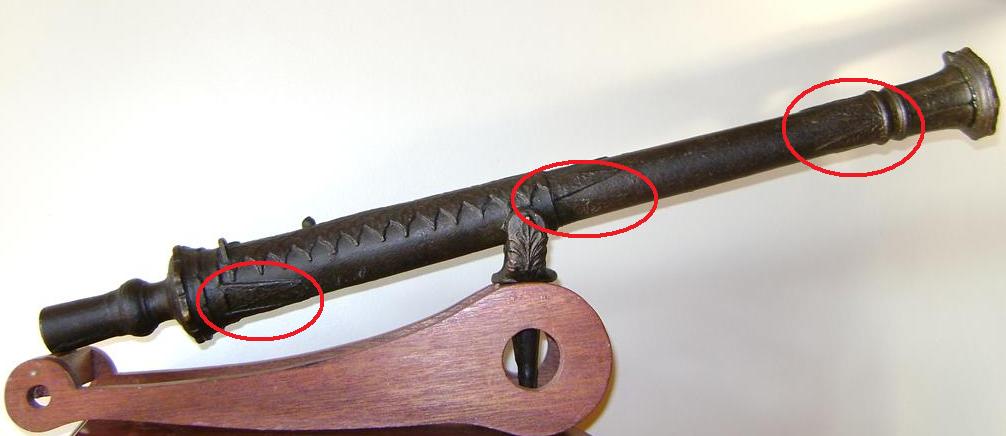

Old 5th March 2013, 02:48 PM   #16
Originally Posted by asomotif
... the bamboo shoot motifs on Fernando's example are longer for starters.
Thanks Willem; didn't know those were called bamboo shoots; any chance you tell me the name of the decoration on the breech, it if has a specific one?

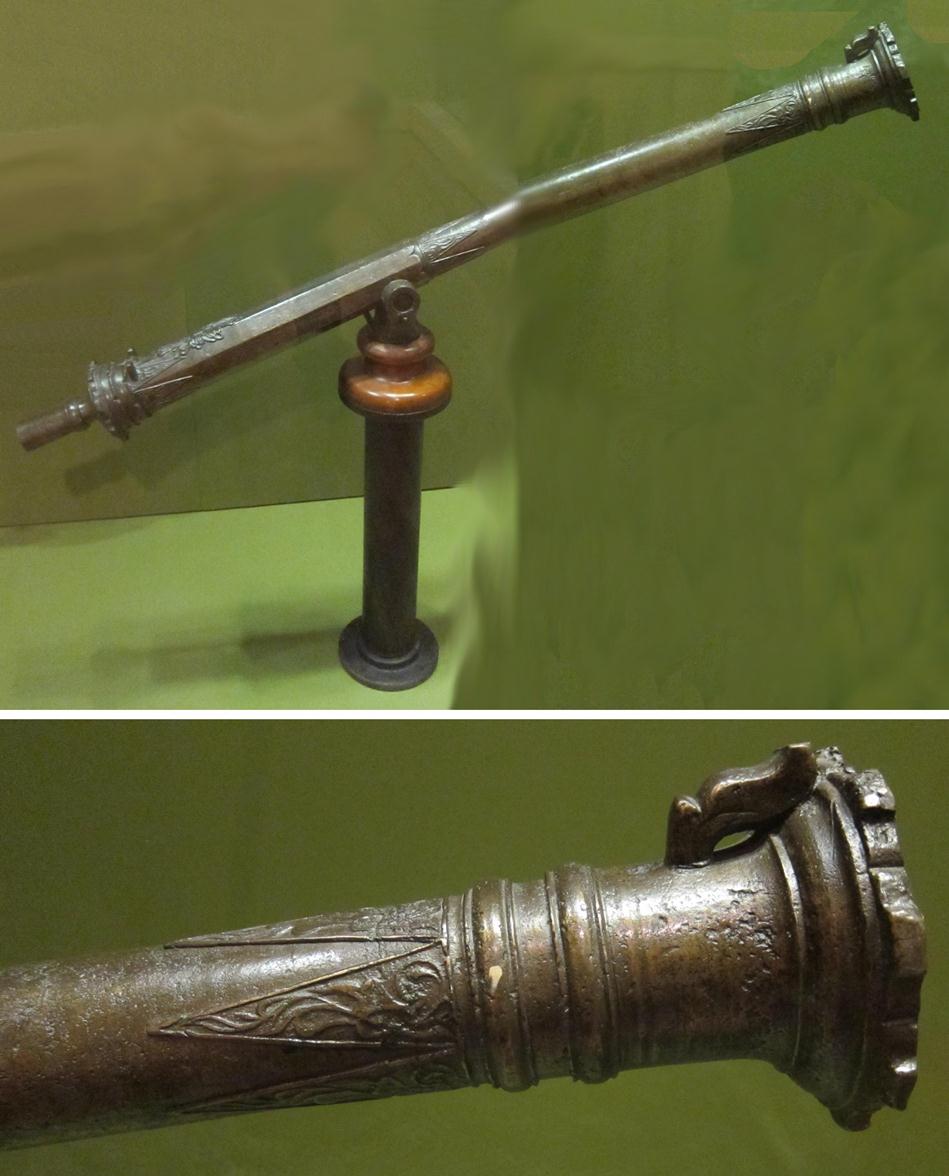

Stu
I never thanked you for those pictures, Stu .
How do you get them ? I browse Fort Siloso and the lantakas i spot there are not the same and are more distant than the ones you posted ?
Old 8th March 2013, 07:51 PM   #18
kahnjar1
kahnjar1's Avatar
Posts: 2,833
My pleasure to show. These pics were taken during a visit in 2007. I also have pics of other big guns, both old and WW2 vintage which are on display there.
Though perhaps not "ethnographic" I will open a thread and post the pics.
Regards Stu

But now i found an example with origin apparently attributed by a reliable source, said to be Moro from the Sulu Archipelago: HERE
I know nothing of these things, but the bamboo shoots (as per Willem) or fire tongues (as per local source) loock rather similar. Also the shaping of the barrel mouth and breech ring look familiar.
Does this make any sense ?

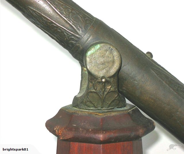

I have just checked that one. It is obviously not the same, but the similarities are outstanding; most probably from the same foundry area, where the same patterns are used.

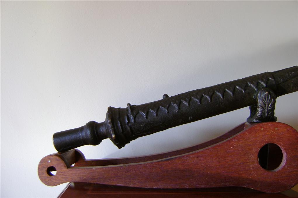

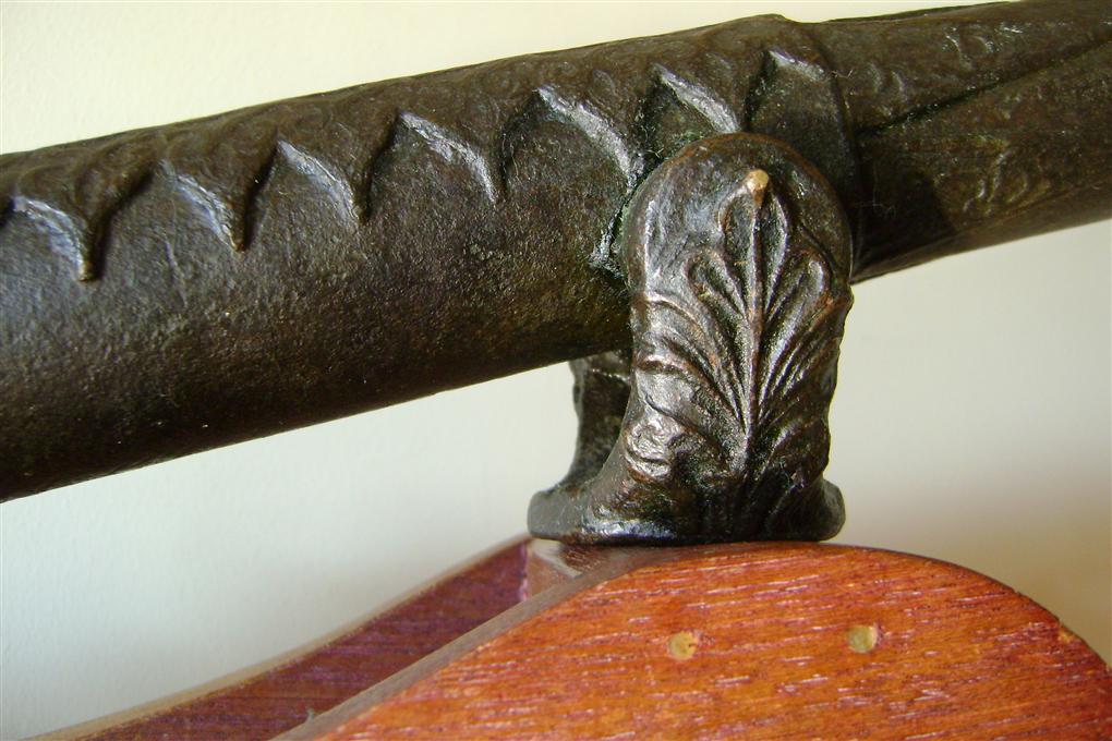

I thought i would make a different stand ... with the help of a local carpenter .
The one that came from the seller didn't look right to me; not even fitting well.
I have to get some paint to darken the nail heads.
Old 17th March 2013, 06:58 PM   #22
Good choice!
