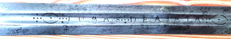

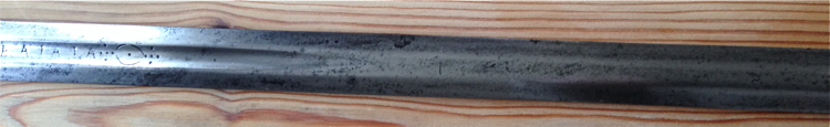

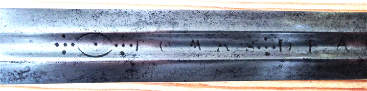

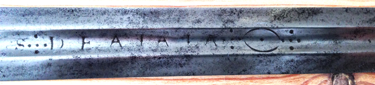

Hi,
Blade length 37 1/4 inches (94.5 cm) tang length 6 1/8 inches (15.5 cm). On one side TOMAS DEAIALA or TOMAS DEAIAIA other side IESVS MARIA. The I in Jesus looks like a J but upon close inspection it appears to be an I. I know there are many period and later blades with spurious markings but I'm not sure with this one. Looking forward to your thoughts.
Norman.
P.S. Please excuse the photography I have no camera at the moment so the wife's phone and a little jiggery-pokery on the computer was all I could do so the photos may appear a bit photoshopped with an odd colour temperature.

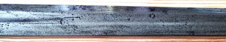

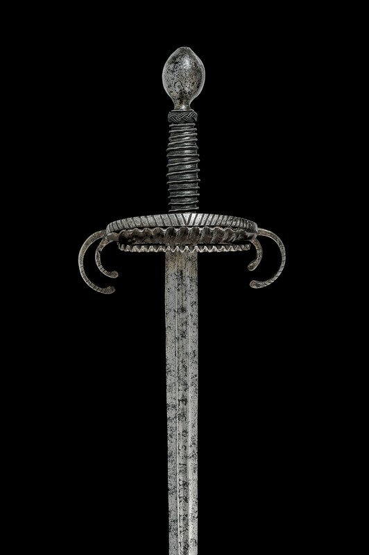

Hi,
Almost identical blade re the profile and the IESVS MARIA mark, http://www.fricker-historische-waffe..._2013_engl.pdf sixth photo down and the sword above the Cinquedea. This one in obvious better condition than mine as most of the detail in mine has worn off. On my blade there are signs of use i.e. the usual small nicks and the sword still has a bit of an edge.
Norman.

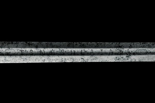

Posts: 1,657
Hi,
Images from a well known auction house.
Norman.

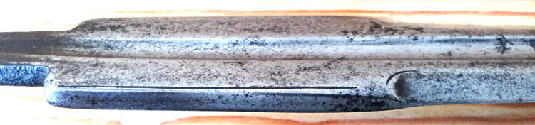

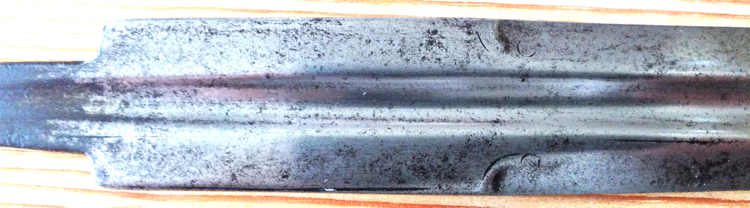

Hi,
Blade on mine is double edged flattened hexagonal cross section after the fuller tapering to almost lenticular very near the point.
Norman.

hello
In modern silk, the name is TOMAS DE AYALA
Affectionately. Fernando K

Old 11th May 2015, 11:15 PM   #7
Posts: 10,867
Hi Norman,
The TOMAS DE AIALA name was from Tomas Ayala of Madrid ( who is also noted Toledo as he was of course of these smiths) and his son Luis who was in Barcelona. They worked c.1566-1620 but more on their exact dates and locations is unclear among arms writers.
The Tomas Aiala name, like Andrea Ferara, became one of those names of famed makers which became a sort of trademark, and appeared on blades from Italy (c 1620s) and Germany later..in fact into 18th century.
The JESUS MARIA was used by Milanese armourers (Wagner, 1967, p.173) as well as apparently by the Ayalas In any case the combination of these names and variations of spurious Toledo marks often are seen.
In my opinion , the occurrence of the 'anchor' device suggests a Solingen version here probably 17th century using the Ayala 'trademark'.
I have seen rapier blades with Jesus Maria and Toledo marks as late as 18th century (with Ayala though) as a good number were discovered in a wreck off Central America in the 80s. These, like the 'Spanish Motto' blades were shipped in good numbers to Spains colonies from Solingen producers.

Therefore and most probably a XVIII century Solingen blade.
Very good catch, Norman

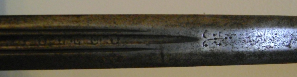

P.P.S. Is this the symbol or similar you are referring to?

Old 13th May 2015, 02:24 AM   #17
Posts: 10,867

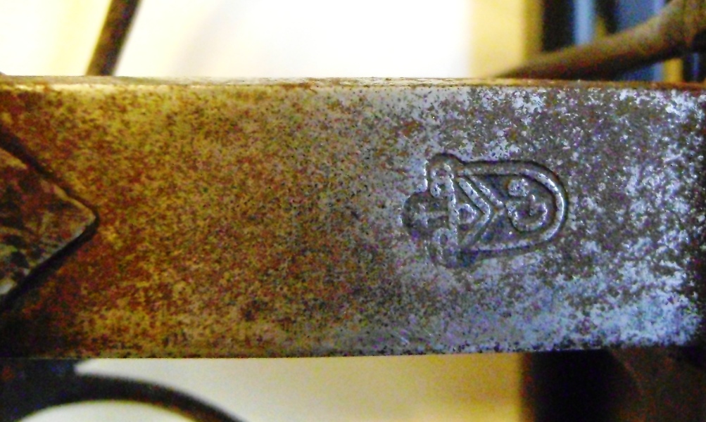

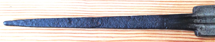

I'm really bad at finding pics etc. but what I mean is that on rapiers it seems the guard of course is at the base of the blade, and the ricasso extends to the bottom of the grip. In other words there is a section where the fingers extend past the grip and around the block section. With the cuphilt for example, the cup is at the blades end, and inside there are pas d'ane rings adjacent to the ricasso......then the grip starts beyond that.
In this type of tang, the grip is right at the blade base, there is no ricasso to be visible inside the cup or guard.
Fernando can explain this better
The symbol you show here is the cross and orb, while somewhat related to the 'anchors' in having cross symbolism, is not what I mean by the symbol on your blade.
The cross and orb relate mostly to German blades, and though often suggested 'makers marks' are usually used in conjunction with various names, invocations or other inscriptions on blades. This is very much like the way the 'anchors' were used on Spanish blades, and used in Solingen with other spuriously used punzones, names and phrases.
On the Aiala name, just an observation as the name is spelled differently on various occasions so interjection of the 'de' might be correct. Just seemed notable.

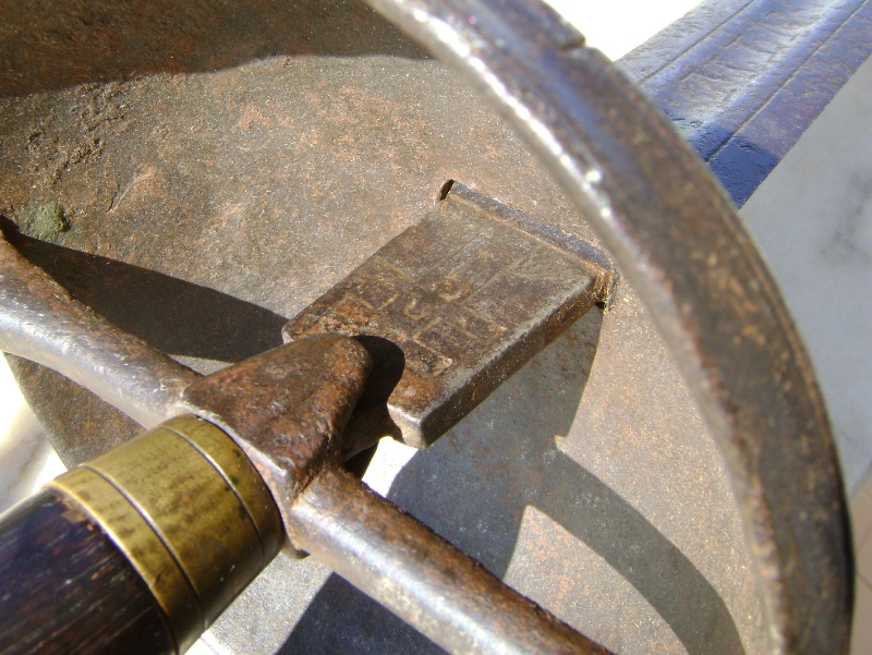

Old 13th May 2015, 01:17 PM   #18
In the plate and nomina designed and crafted by Francisco Xavier Palomares in 1762, after the listing drawn by his father Francisco Santiago Palomares, the name for these smiths (father Thomás and son Luis) was DE AIALA.
Mind you, the maker's punzon may appear both in the uncovered part of the tang, before the guard (ricasso), also in the first third of the blade section (forte).
BTW, the term ricasso may also be applied to the blade section right after the hilt when its purpose is the ( long) sword entire hand holding, which is a different story.
Whereas the blade has (or not) an assumed ricasso before the hilt, i would say such is not a characteristic of different smiths but the purpose the blade is going to serve, whether a cup hilt sword, a swept hilt rapier, you name it.
I am not sure this whole story makes sense, as i am far from having a profound knowledge of the subject.

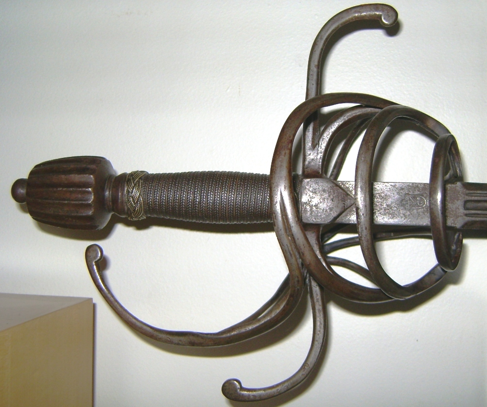

Attached are examples of marks in ricassos, the first a cup hilt sword with period symbol in both sides and the second with a makers punzon in one side; the first also with a period typical motto on the blade (MIN SINAL HES EL SANTISSIMO CRUCIFICIO) and the second with the maker's name (GONZALO SIMON).
Master Gonzalo Simon (1608-1617) also figures in the Palomares nomina and, eventually also uses the 'anchor' mark

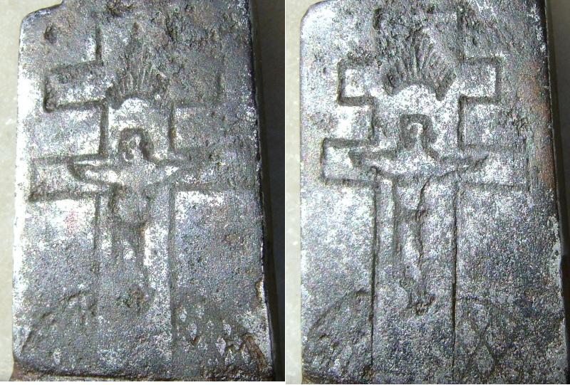

Fernando K
Join Date: Apr 2010
Posts: 672
Hola Me ha llamado la atencion el motto . No deberia ser
MI SEÑAL ES EL SANTISSIMO CRUCIFIJO
Afectosamente. Fernando K
(El traductor no permite, o no se, ponerlo como corresponde, en ingles)
Old 14th May 2015, 03:27 PM   #21
Espaderos were not so good in writing as in forging blades, Fernando .
The only letter of the motto i was not sure of, was the H, as this part of my blade was rather worn.
But i happened to locate the mentioning of a shell guard sword (item #234) in the Portuguese/Spanish exhibition of 1882 in Lisbon, with the same motto and precisely the same words ... and with the H included. Also the Christ crucified symbols were present in the ricasso. Such sword belonged to D. Jaquim Garcia Toledo from Lisbon.

Just noticed this mark on the tang. Unlikely to be a makers mark, inventory number?
Hi Jasper,
Thanks for finding the photo re Jim's post.
My Regards,
Norman.
