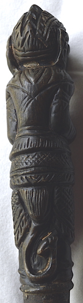

This one was a recent pick up from our favorite online auction site. It was presented as a prayer knife of the Yao people of southern China and neighboring SE Asia. While I am not familiar with this group, I doubt that it comes from southern China.
One of the features putting me off southern China is the hilt, which is clearly showing a monkey in human dress. This looks very much like a representation of Hanuman, the Hindu god who figures prominently in the Ramayama. Indeed, there are images available of Hanuman in almost identical dress. The hilt is well carved from horn, and the pictures below show some orange material adhering to the hilt in several places, as if it may have been coated with something else at one time. The hilt has an iron ferrule on which the monkey is standing.

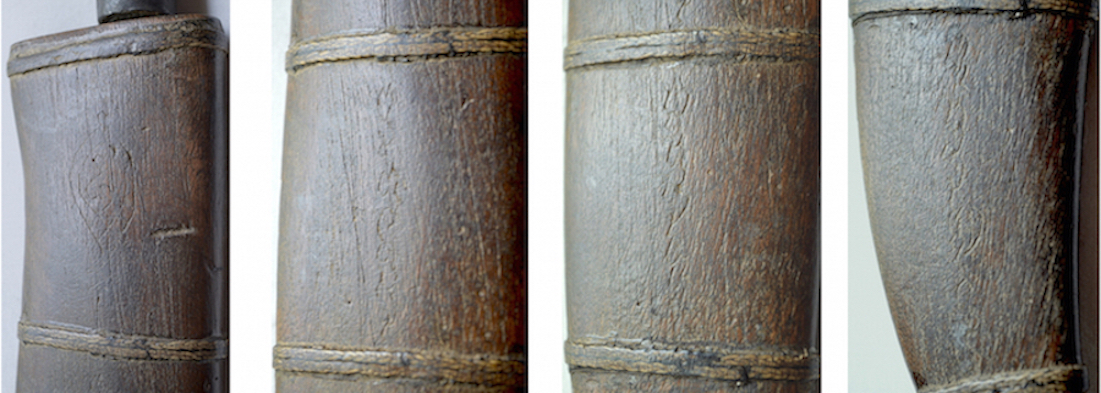

In looking for clues as to the origin of this knife, it is interesting to note the structure of the wooden scabbard held together by five thin braided bands of rattan. The braided material is actually recessed into the wood, a feature apparent in several of the close up shots of the scabbard. In my experience, this is unusual to find in mainland SE Asia and neighboring parts and I would be interested to hear of others' experiences with seeing this method of binding scabbards.
Also, along the scabbard are some faintly incised designs which I have tried to show in the pictures of the various panels of the scabbard. These seem nondescript okir style markings resembling intertwined vines for the most part. The top panel near the scabbard throat has a more expansive design that is hard to see. If anyone can make something out of these, please let know.

Interesting piece Ian. I agree. This looks like a Thai Hanuman to me in form and style.
Old 8th May 2015, 01:37 AM   #3
Posts: 6,441
The dress on the figure seems more in the Thai taste than particularly Indonesian/Balinese in style .
The blade carries hints in profile of the Pihakaetta shape along with Thai .
