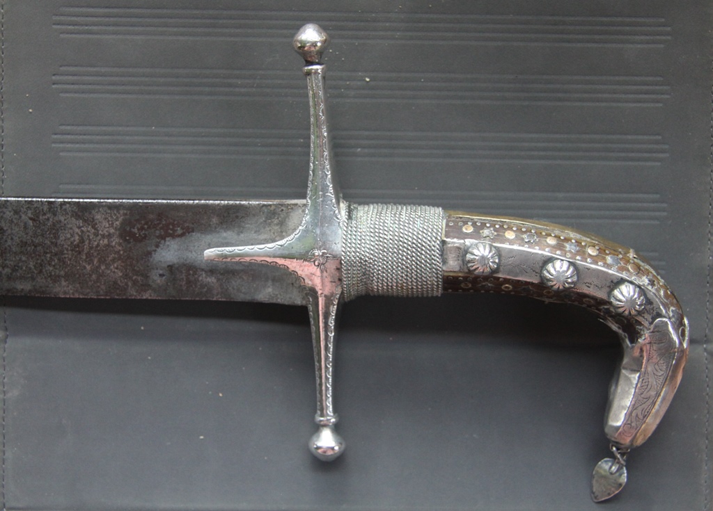

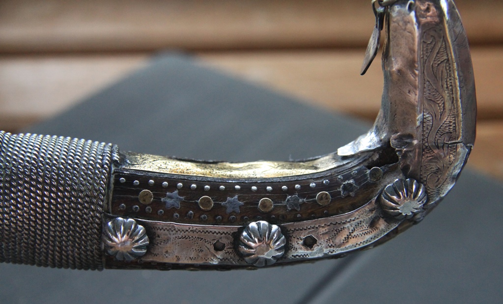

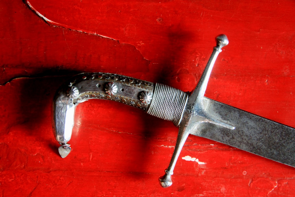

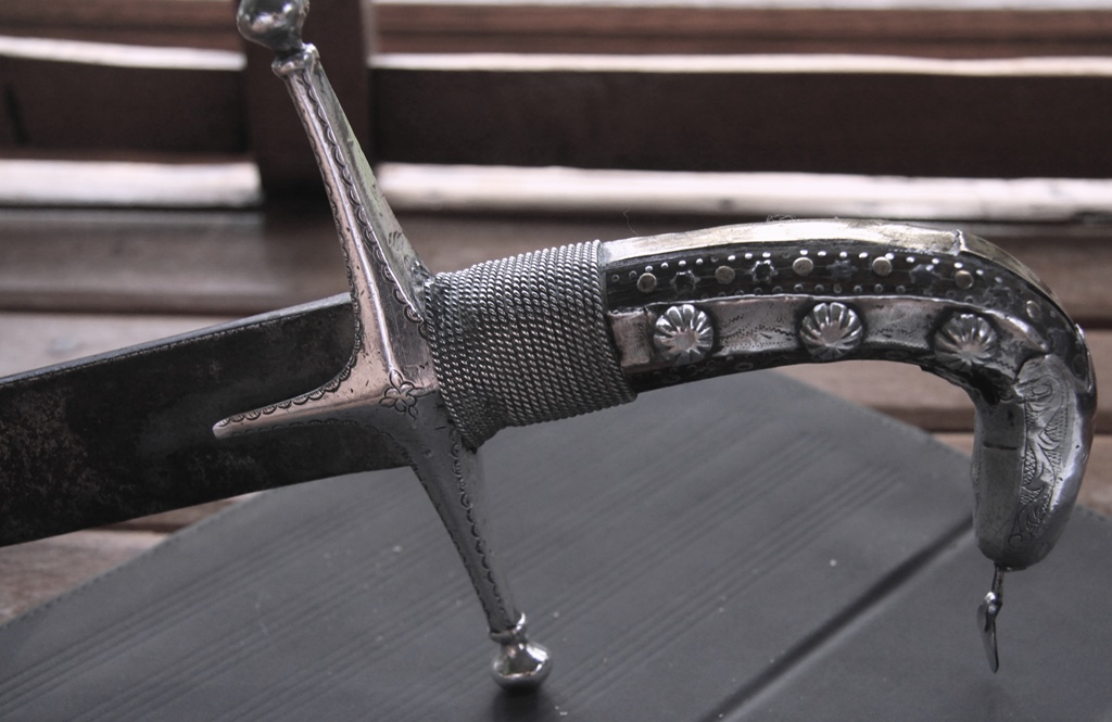

Is it still not clear for me if it is a Arab saif of Syrian style or a Kilij saber .
It is a silver mounted saber with a tear shaped silver dangle attached to the tip of the pommel cap by a loop
Overall length: 98 cm the blade 86 cm W 3.5 cm.
Is it a 19 Th century saber or later ?
Any comment on it will be welcome.

From what I can tell, it is indeed Syrian, especially in hilt style.

Yes, Syrian
But what about the blade, do you have any marks?
Could be Persian... Doesnt look styrian or Eastern European as it was often the case...

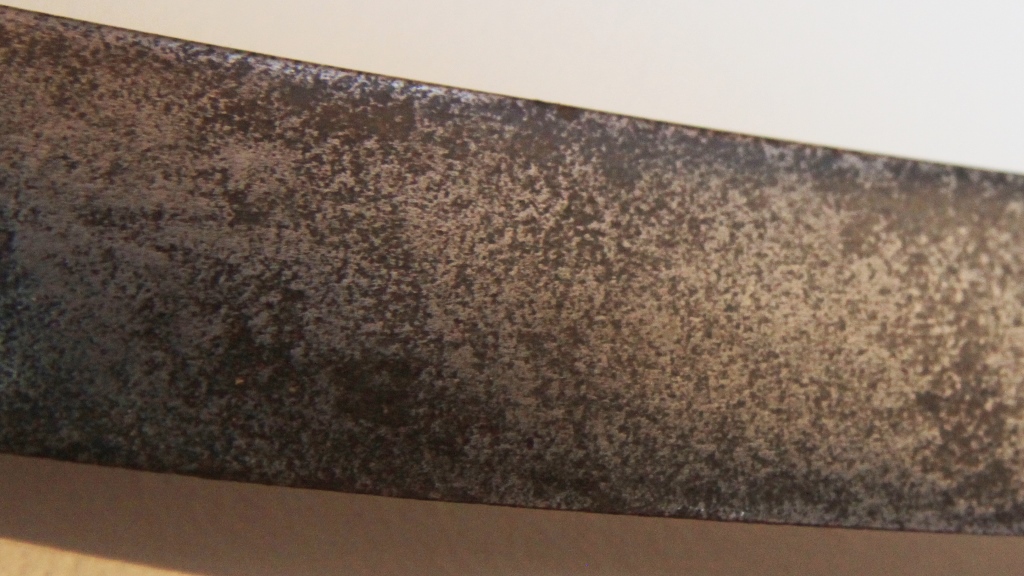

Can you provide close ups of the blade where it is clean?
Old 22nd February 2015, 11:56 AM   #6
Cerjak
Cerjak's Avatar
Join Date: Jan 2012
Location: FRANCE
Posts: 1,065
Old 22nd February 2015, 04:23 PM   #7
Posts: 7,407
Hard to tell what kind of wootz, if any, is in this blade. The type of wootz would indicate if Persian or Turkish, or if it is pattern welded.

Posts: 1,340
Hard to tell if its wootz or not without a clean up and an etch. With Syrian hilted swords I am less inclined to say something is wootz with such condition, that is because the industry there can make blades in any shape. What can help us further if you take photos of the spine, it may show a hairline crack on the spine and the Syrian craftsmen often make swords with odd distal tapering. But this one looks genuinely old, the hilt too, maybe 19th century as its silver fitted. The iron fitted ones are often early to very late 20th century. Worth checking if its silver and not some white metal.

Syrian handle, apparently persian blade, turkish-style guard (long, thin prongs).
