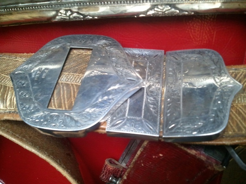

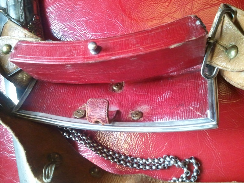

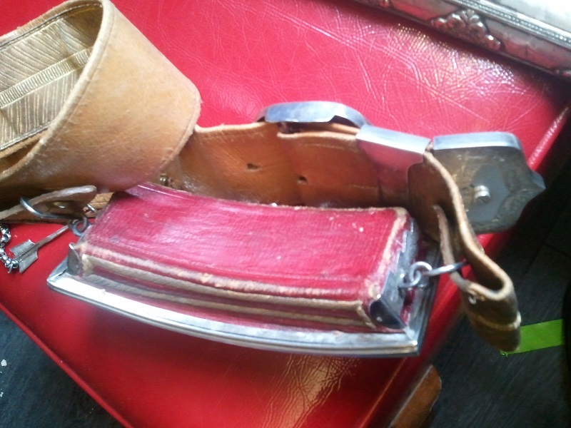

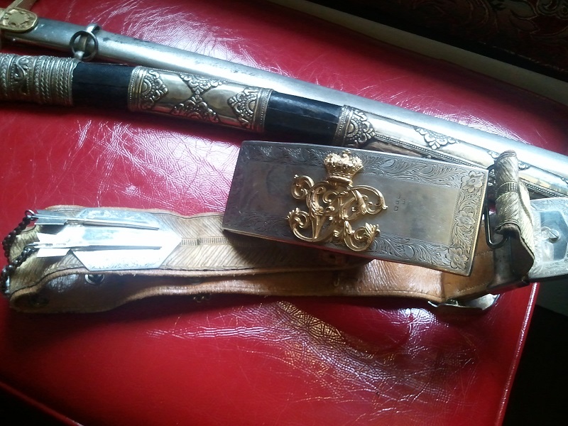

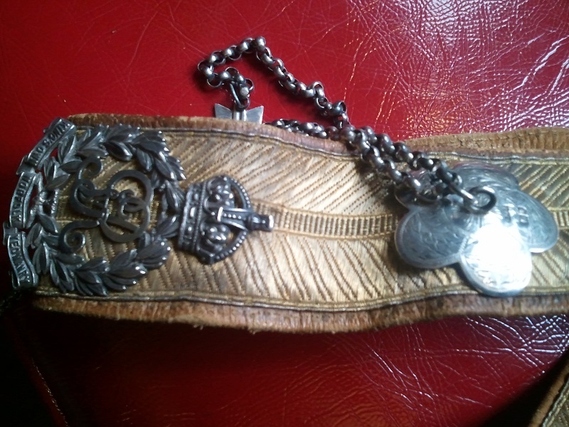

Hi. I 've come along this belt in Istanbul. All of the pieces are silver hallmarked. I request a definition and a value assistance please (you can send PM for that)..
tanks a lot in advance.

hello

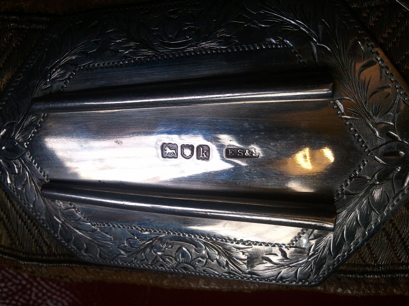

I can only help you with quality metal, which is .925 (sterling), the city is Birmingham and lowercase K is the year 1808, the Z lowercase is 1823.

Hi
No idea of value but just a bit of information

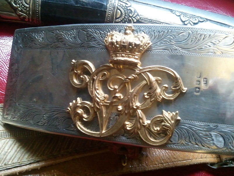

The crown on the box is for queen Victoria, reigned from 1837 ( the gold coloured cypher says VR)
Fernando has identified year as 1823 which would be William iv on the arrow part
And the badge with more rounded top crown looks to have GR with a v in the middle, he was reigning from 1910 to 1936, maybe my mistake in what I see though but it does look like this
Just checked kings own Norfolk yeomanry only formed in 1901 so it is GR V
So it looks as if there is a lot of chopping and changing going on
Looks nice overall but maybe it is a parts made piece, that I do not know

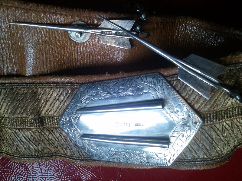

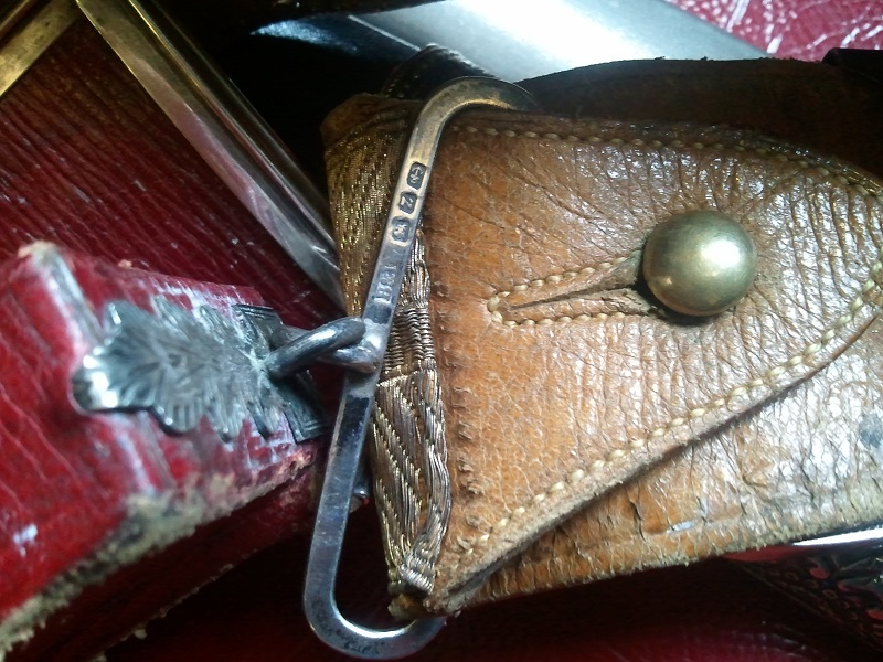

The hallmark on the vent pick holder is for London, and is 20th century. I will have to get to my library to give you the correct date.

Posts: 96

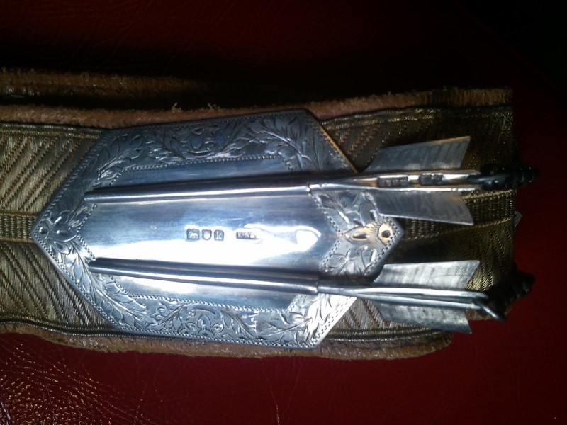

It seems to be the shoulder belt and pouch of an officer of the Norfolk Yeomanry (The King's Own Royal Regiment). Their 1/1st Battalion fought at Gallipoli in 1915, which is probably how the belt found its way to Istanbul. This is consistent with the presence of George V’s cypher. The pouch is older, as the lid bears, as noted by Ken, the royal cypher of Queen Victoria. Maybe a family heirloom, the Norfolk Yeomanry was disbanded during her reign in 1849 and was raised again in 1901 by King Edward VII.
Ken, yes the vent picks (known as “prickers”) are the dart shaped objects.
Andreas

hello
Two issues. Indeed, for the first hallmark city is London, and then the lowercase letter corresponds to 1825.
The figure is not crowned GR but VR; confusion comes from considering the bottom of the V as a fifth Romano
Ask the punches (pickers) do not correspond to an officer of artillery?

Posts: 1,204
The crossbelt has a Kings Crown cypher and refers to George V as has been observed above , and the pouch itself is has a Queen Victoria cypher . The hallmarks cannot therefore be as early as has been stated . The original purpose of the arrow shaped prickers was to jam into the vents of enemy guns in order to 'spike' them ie render them useless for the duration of the battle. They were originally carried by officers of Light Cavalry regiments for this purpose and the later silver versions were a symbolic reference to this once vital function.
The leopard face hallmark indicates London and the k is for 1905 .
