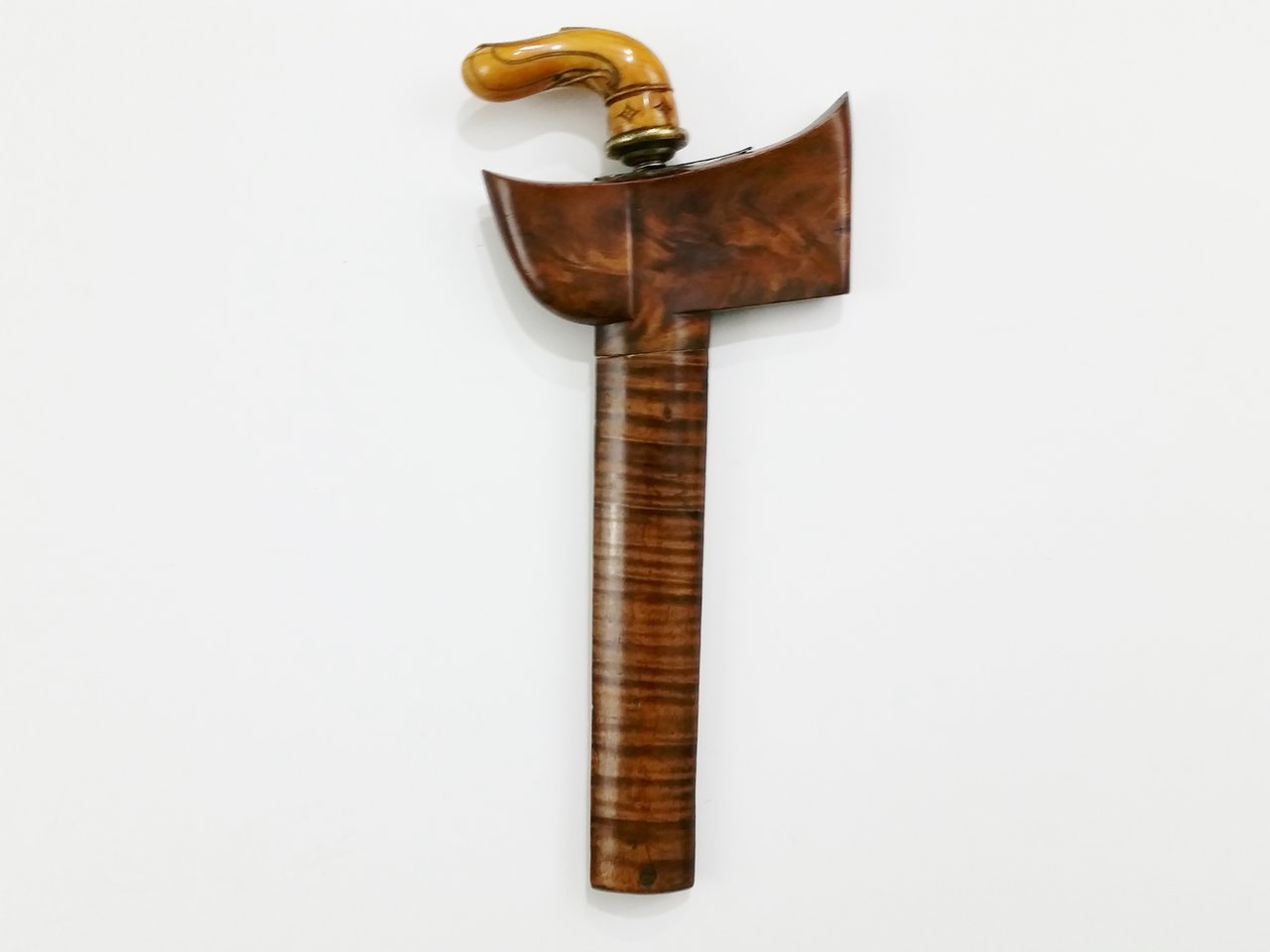

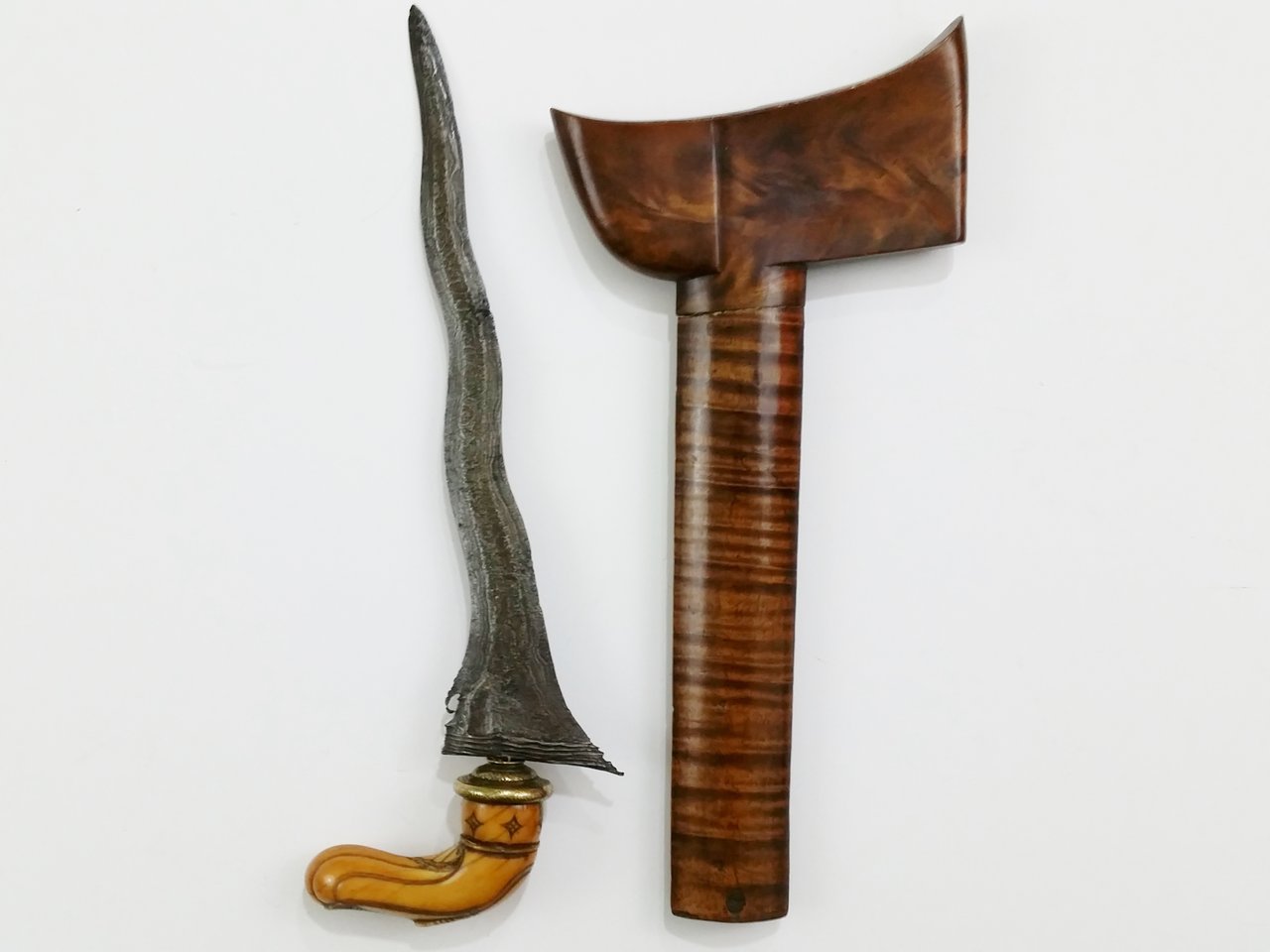

Default Bugis Keris
here's my first bugis keris. the handle is ivory, and i believe the mendak is gold, but i haven't had it tested yet. i do love the pattern on the scabbard, and i realize it needs some cleaning. as far as the blade, it needs to be stain (i think), but after reading Alan's link on a previous post, i think i'll leave that alone. i would love to hear everyone comments on this particular keris, though!

Posts: 1,740
Very nice and rare ivory hilt, the scabbard does not look very old but I could be wrong (check inside the slot), the blade with strong gusen (bevels) on the edges has an odd ganja (iras?) but which seems original. From the pics the selut seems to be from brass but again I can be mistaken. A very good kris anyway, congratulations!

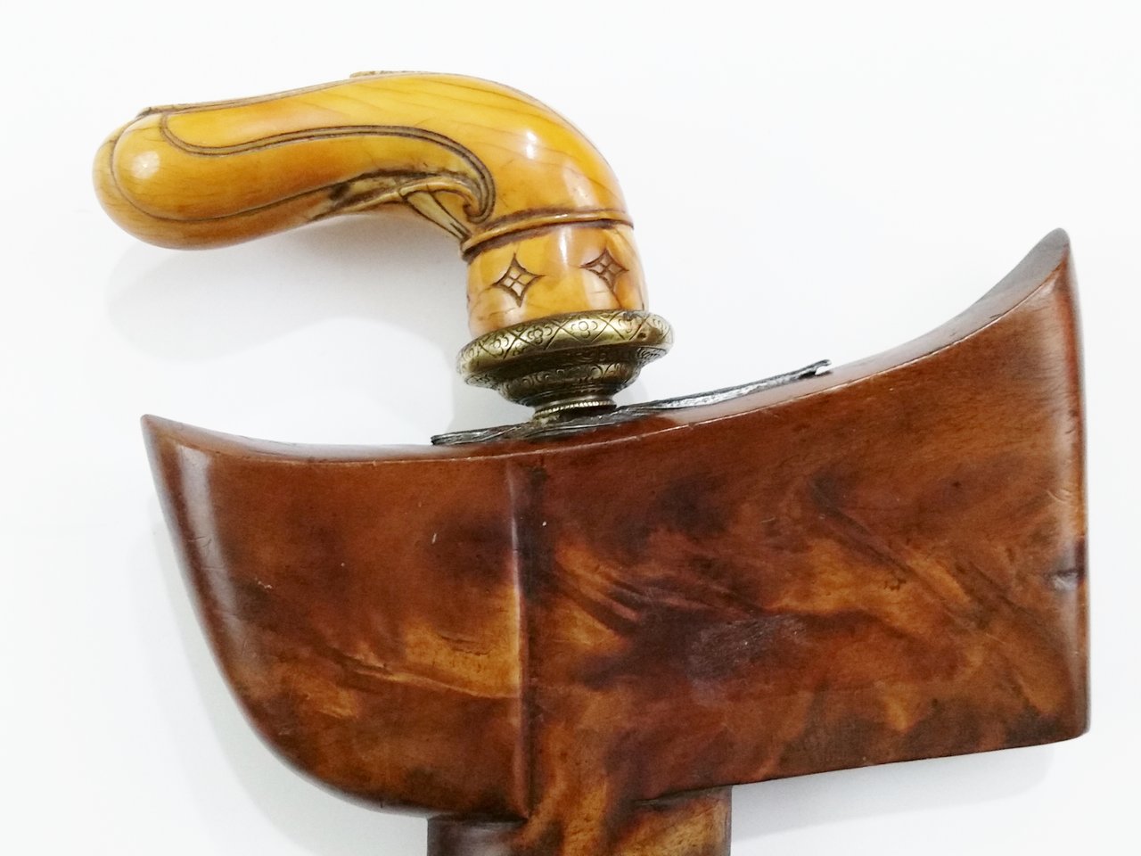

Posts: 1,730
thanks for the comment, Jean! my apologies on the terminologies. so what's the difference between a selut and a mendak? nevertheless, i will have it tested.
i looked inside the scabbard and it appears to be older: uniform dark patina all the way as far as i can see.

Posts: 1,740
The selut (javanese term) or pedongkok (Sumatra/ Malay term) is the cup inserting the base of the hilt while the mendak is the conical piece inserted between a javanese hilt and the blade.

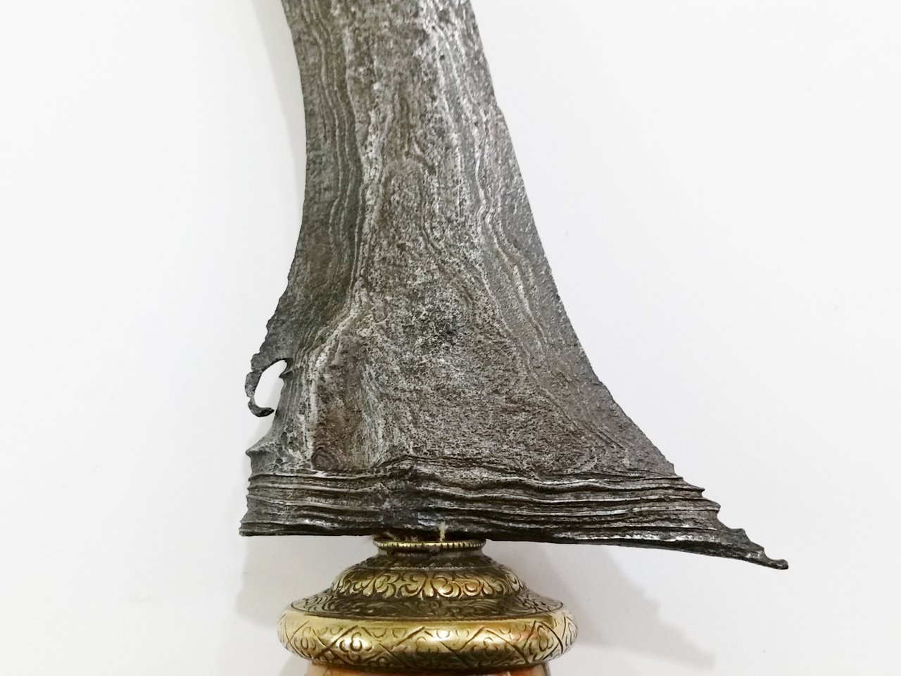

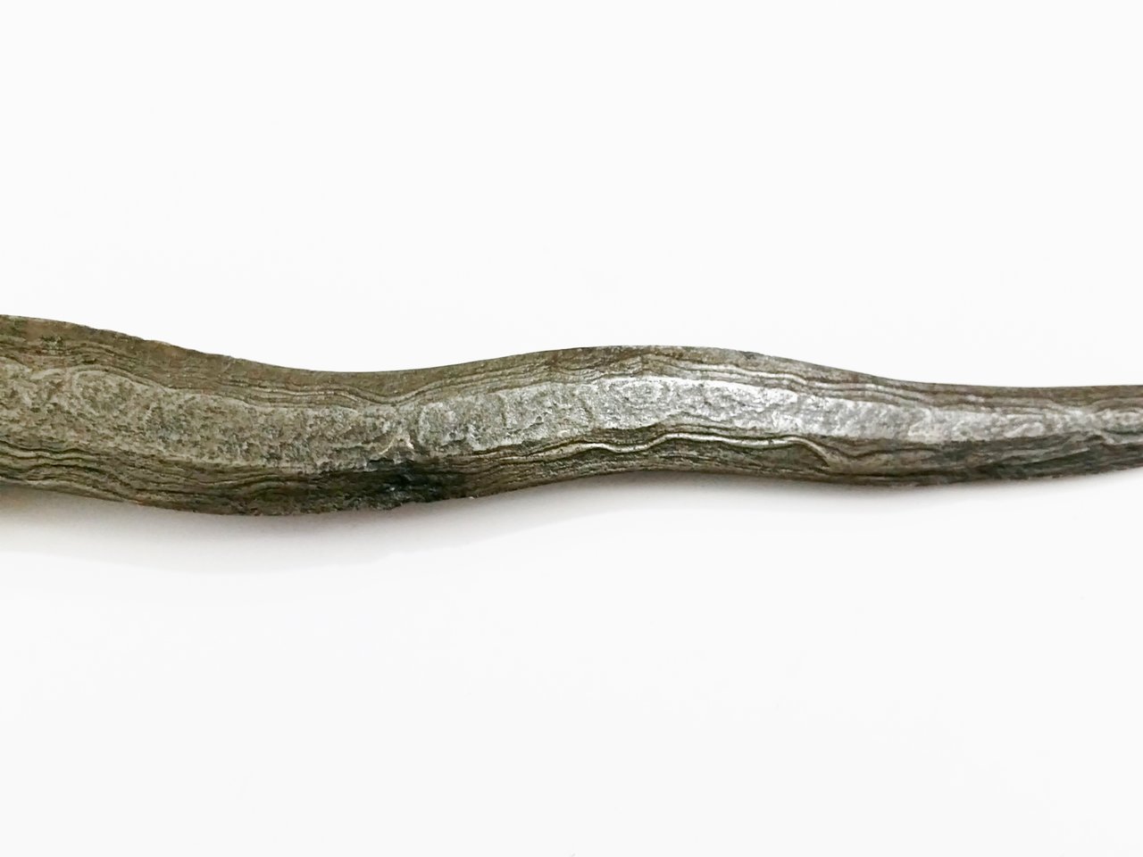

Posts: 6,418
Question
Anyone beside me wondering how the heck they achieved that ganja iras ??
Old 29th November 2014, 05:17 PM   #20
Jean
Join Date: Jun 2009
Posts: 1,740
Yes Rick, I am also wondering and expected somebody to raise it... The pamor pattern on the blade is mlumah (pamor lines parallel to the blade lenght) while on the ganja they are miring (perpendicular to the blade lenght). To me one way to achieve it would be to cut the ganja and to weld it perpendicular to the blade lenght? I can see a trace of a welding line between the blade and the ganja but I am not sure. This is the first time I see such an odd ganja.

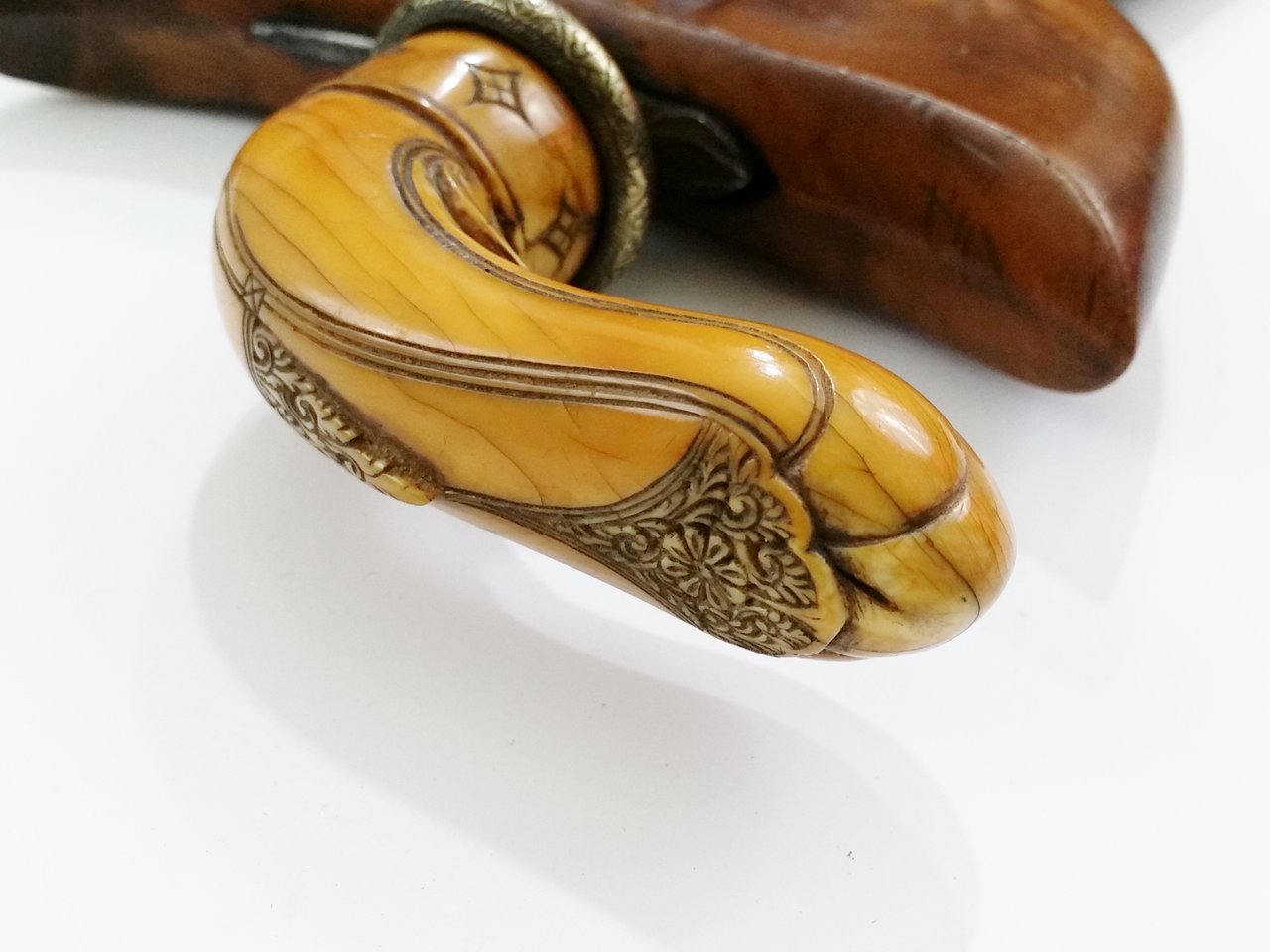

Hello Detlef,
The diamonds at the base of this hilt have a peculiar shape and they are not exclusive to Gayo hilts IMO, see this one from West Sumatra for instance. The Gayo hilts are generally in Jawa Demam or bawar style, but not Bugis? And the scabbard is not at all typical of Gayo krisses? Any opinion about the possible origin of this kris will be welcome.

Old 29th November 2014, 09:26 PM   #24
Yes, this ganja seems to have been welded back onto the blade. I doubt this is practised in Jawa - probably pretty ideosyncratic craftmanship...
I wouldn't call this a ganja iras blade either since the esthetics are obviously different.
Old 29th November 2014, 10:27 PM   #25
Hello Ron,
Congrats, a really nice keris!
While the blade is obviously influenced by "Bugis" style, the flow of lines does not seem to support an origin from Sulawesi; it does look Sumatran/Malay to me.
The gorgeous hilt is special and may be an unique one-off - at least I haven't seen any that seem to be related or with similar features. The star-like decoration at the base is carved differently from what is usually associated with Gayo and possibly neighboring highland areas. (The pendokok looks also brass/bronze to me.)

Posts: 7,210
The gonjo question.
Simple answer:- don't know.
If I had it in hand I would examine closely under magnification, and I think I'd probably find that it had been welded in position, but what sort of weld?
Gas? Electric? Forge?
What was done, when was it done, and why?
Don't know.
A. G. Maisey is online now   Reply With Quote

Is there the possibility that the edges of this blade were filed or ground to remove imperfections, and when this work was done, the width of the gusen increased?
If I look closely at the texture of the face of the blade and I compare it with the texture of the bevels of the blade, these bevels do not seem to share the same texture as is found on the face of the blade.
During my life I have handled thousands of keris of all types.
I have never seen a keris with a separately made gonjo that has been permanently fixed to the body of the blade.
There is a possibility that that this permanent fixture of the gonjo was the result of one man's idea for improvement, either the maker, or the man who placed the order with the maker, or some later owner.
When I consider all the questionable aspects of this complete keris, my present feeling is that this is a marriage that took place far away from the geographic point of origin of any of the components of this complete keris.
