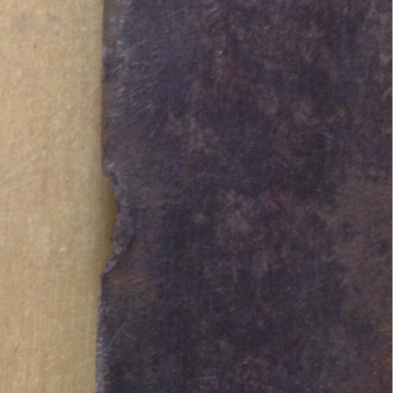

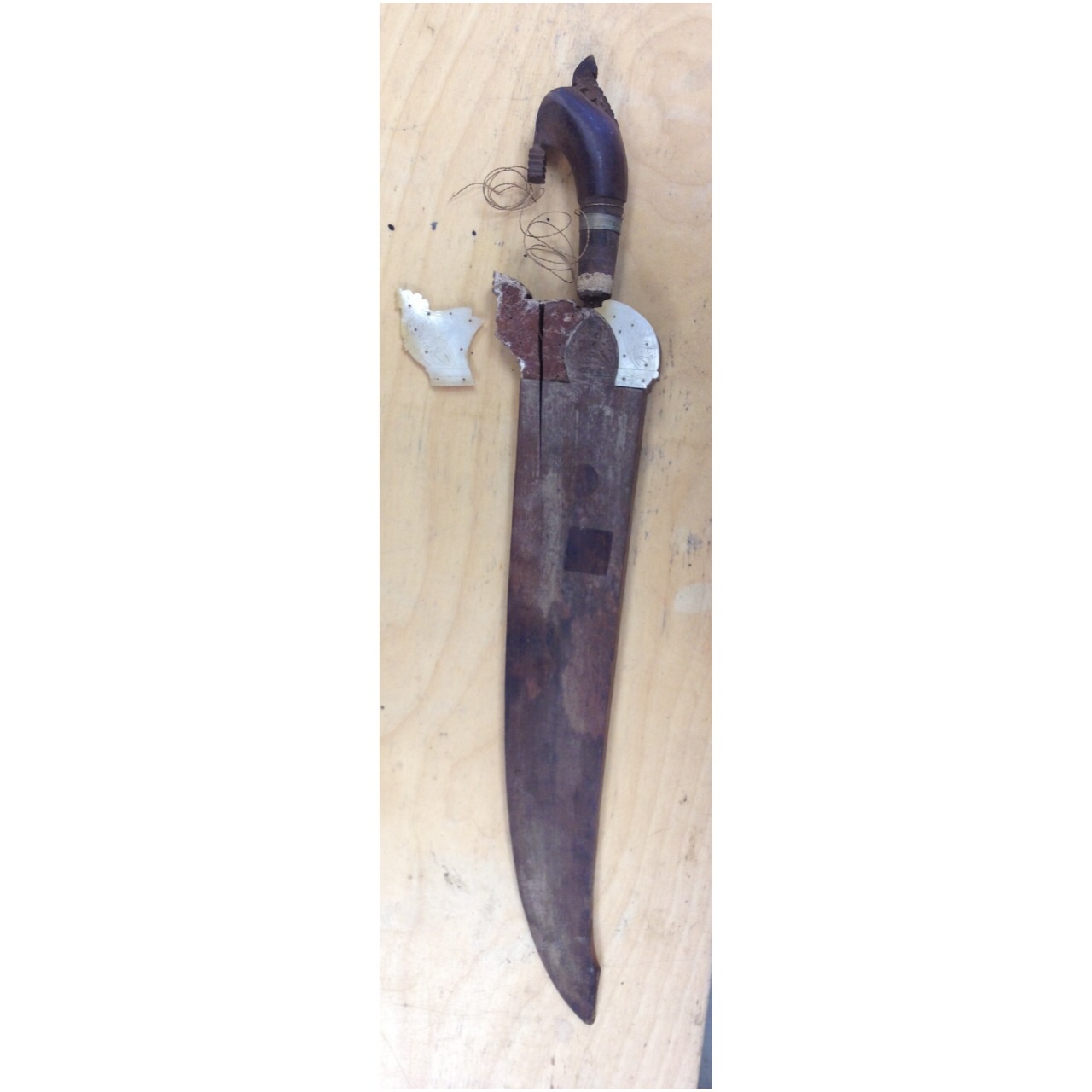

Here are a few images of a barong that I pulled out, showing it before any cleaning was done.
I will add more pictures of the work I did in the last few days.
Any comments, pro or con are welcome.
Also, if anyone can recommend a book or two to ease my transition from a kris and barong novice to someone who can at least write using the correct terminology would be appreciated!

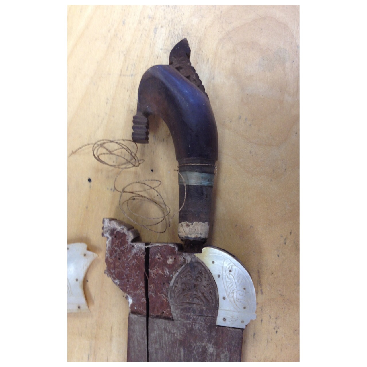

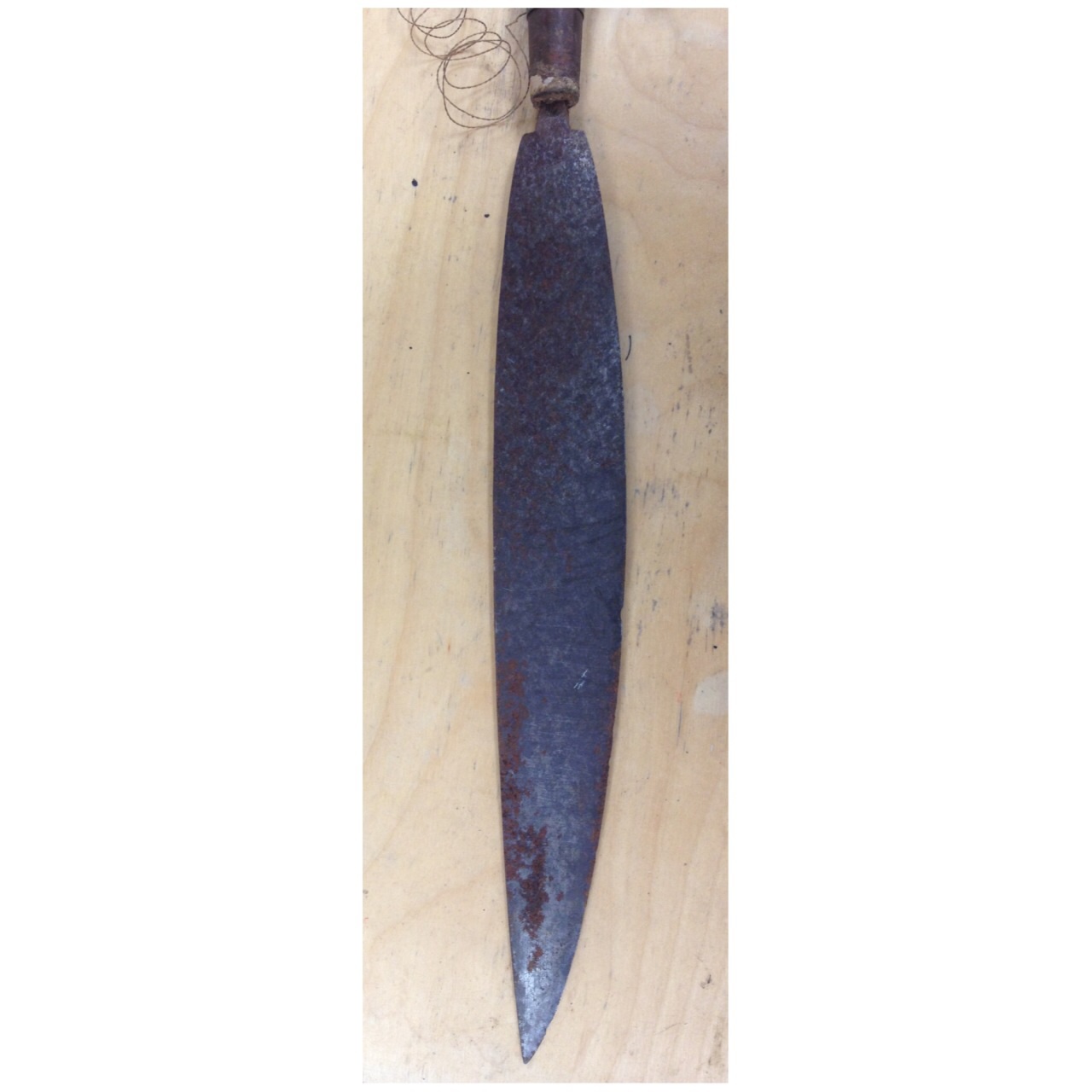

Here's an update after hours of work!
The blade is more or less clean, small dings and chips were polished out, old glue residue removed.
The scabbard appears to be made of golden teak. Once I find some I will update this post again.
Please, as usual, comments and suggestions are welcome.

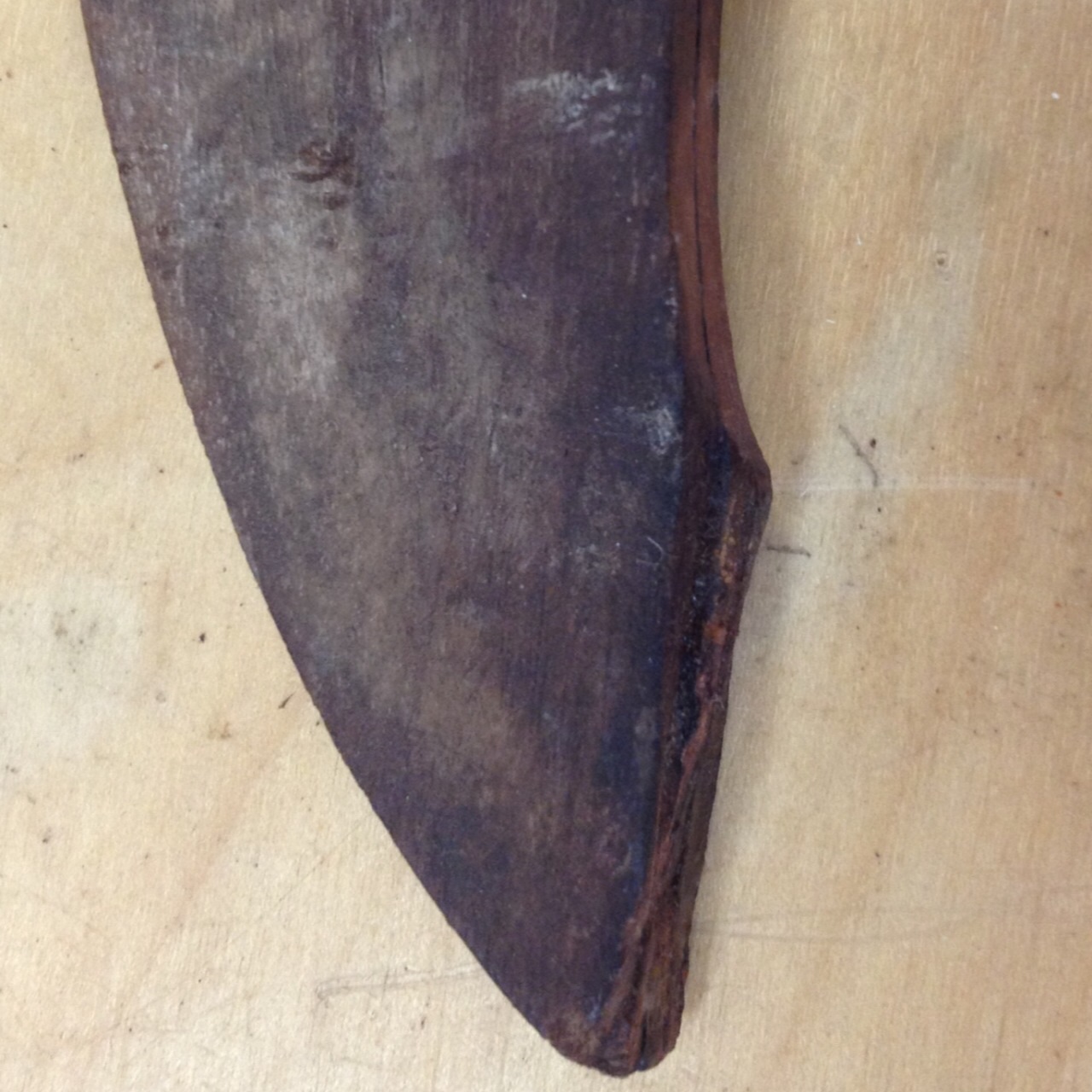

The terminal of the scabbard is missing, as well as the grip covering. I taped up and out of the way some handmade string that I don't think was external wrapping, but, again, I'm no expert!
Any guidance here is most appreciated!

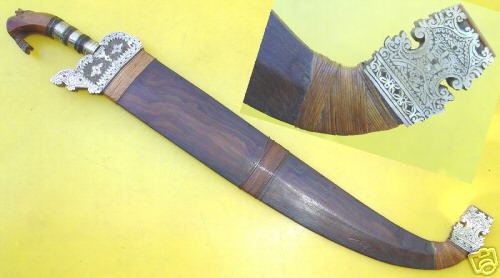

A NICE PROJECT. I DON'T KNOW HOW MUCH RESTORATION YOU PLAN ON BUT SOME ELMERS WOOD GLUE AND A CLAMP TO CLOSE THAT CRACK AT THE SCABBARD TOP WILL ALLOW YOU TO PUT THE LARGE MOTHER OF PEARL SECTION BACK IN PLACE. THE MISSING SCABBARD TIP LIKELY HAD MOTHER OF PEARL AS WELL AND THERE MAY HAVE BEEN A METAL FERRULE NOW MISSING THAT COVERED THE BLADE TANG. IF YOU REPLACE THE TIP PERHAPS A REFINISH ON THE SCABBARD WOULD BE NECESSARY BUT IF ITS NOT REPLACED YOU CAN REFINISH OR LEAVE THE SCABBARD AS IS DEPENDING ON WHAT YOU LIKE BEST. ONE WAY TO DO IT IS A PARTIAL RESTORE OF THE SCABBARD, RE- FINISH THE FRONT OF THE SCABBARD TO ITS ORIGINAL LOOK BUT LEAVE THE BACK AND SIDES AS THEY NOW ARE SHOWING THE OLD PATINA AND DIRT.
HERE ARE TWO EXAMPLES OF BARONGS WITH MOP PANELS SHOWING THE TIP. PLEASE PARDON MY USE OF THE PICTURES IF THEY ARE SOMEONE ELSE' S PICTURE I CANNOT KEEP TRACK OF WHERE OR WHEN I GET THE PICTURES. PERHAPS SOMEONE CAN SUPPLY INFO ON THE PROPER DESIGN TO MATCH THE OLD MOP OR A SUGGESTION OF WHERE YOU COULD ORDER A PROPER PIECE MADE. THEY STILL DO THE MOP WORK IN THE PHILIPPINES AND MOLUCCAS. GOOD LUCK

very good cleaning job of the blade, ready for etching. I think that this barong is much later as the other one, 1930 or later but a very nice one. From which material is the remaining ferrule? I think there is missing a second and maybe a third one. I would let work them in the same manner new, replace the missing wrapping and attach the handle firmly again in correct manner, clean carefully the wooden pommel without removing the patina and oil it with linseed oil. The scabbard don't show a nice patination so I would clean it carefully with steel wool to show the potentially nice grain of the wood. Glue the split in up and reattach the mother of pearl piece in the way it was originally. Restauration of the finish of the scabbard will be a great concern, there was once most probable as well attached a MOP piece, personally I would let it like this.
The best reference book about Moro blades is "Moro Swords" from Robert Cato, difficult to get and somewhat expensive but with good luck you will find an example.

i'm not sure how confident you are in regards to removing the handle, but if you search this "Barong restoration suggestion...", it will give you a step by step process on how to work on it. i can't add the direct link on this here post due to my current location.
as far as removing the handle, it is fairly easy. i normally use a heat gun (rated at 750 deg) and would aim it blade, about three to four inches away from the handle. just make sure you don't aim it at one place, rather doing it a sweeping motion. what you're doing is heating the blade enough so it will soften the "gal-gal", a native tree resin used by the locals. you can then either push it in to set it, or remove it if you like. if you do pull it out and decide to work on it, i would suggest pitch as an adhesive to replace the native resin. hope this helps...

STT, I totally agree with Spunjers recommendations on how to remove and reset the hilt and what to use as a replacement adhesive. The only thing I might add is that from what I can see in your photos it looks like the reason the blade has moved forward is because the wooden hilt has over the years shrank quite a bit causing the forward movement of the blade. If this is the case, to refit the blade back to its original position you might have to enlarge the tang socket a little so the tang will fit properly again. Hopefully though when heated it will just (with a little pressure) pop back into place with no problems at all.

My primary concern right now is to determine exactly what the grip should look like-how many ferrules, any and what type of wrap gets laid down between the ferrules, how does the scabbard tip look, and possibly other considerations that I'm now wondering about.
The MOP work shown by Vandoo is of a much higher quality than what I think should be on mine. Once I am satisfied as to how it will look, I have no problem making and carving/engraving it myself. I do this type of work professionally on antique metalwork and weapons for thirty years.
