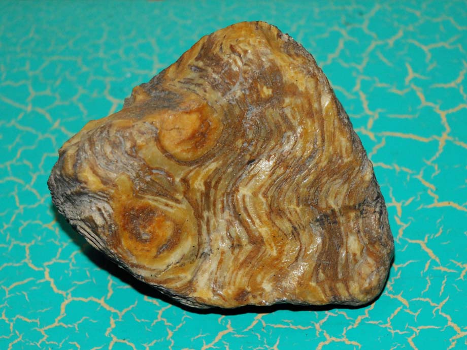

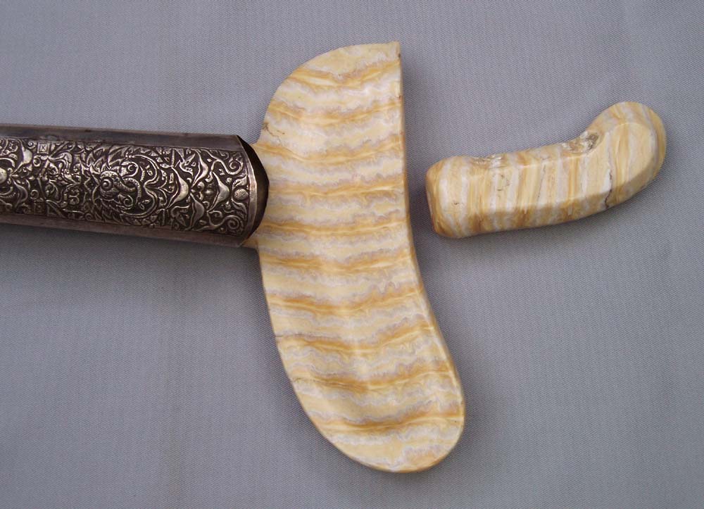

This subject was raised in another thread and I got some interesting information from my Javanese friend from Yogyakarta who trades this materials and I would like to share it with you in order to stimulate the discussion:
According to him, there are 2 types of fossil elephant/mamoouth molar, namely the hard one and the soft one, and only the soft type can be used for making kris hilts or warangkas. One possible interpretation (uncontrolled opinion only) could be that the hard fossil type is older than the soft one due to mineralization?
Also according to him the materials comes from Sumatra (from fossil or more recently dead elephants?) and since recently also from Russia (Siberia) where a lot of frozen mamooths can be found (not fossil ones since they were perfectly preserved under the ice or frozen ground). The Russian molar materials is worked in Bali especially.
I attach a picture of the raw material, which has a yellowish colour with white and darker stripes, and a sample of a finished Javanese hilt & warangka. In order to enhance the colour contrast, some traders dye the pieces by dipping it into a potassium permanganate solution which has a purple colour. Upon contact with air, the unstable permanganate compound is chemically reduced to manganese oxide which has a brown colour and is stable. I attach a picture of such a dyed piece, so the difference in colour between some pieces would not be due to their age as I wrongly said earlier but to a dying treatment.
I personally wonder whether these pieces are actually fossil ones or not, or may be both?

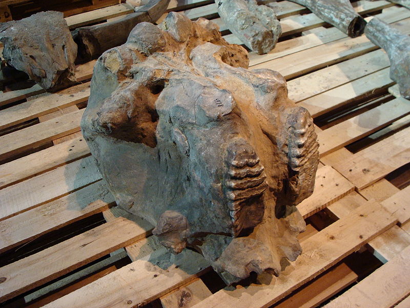

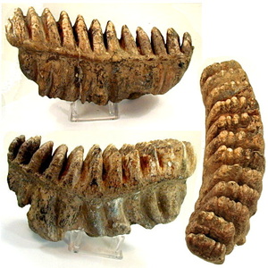

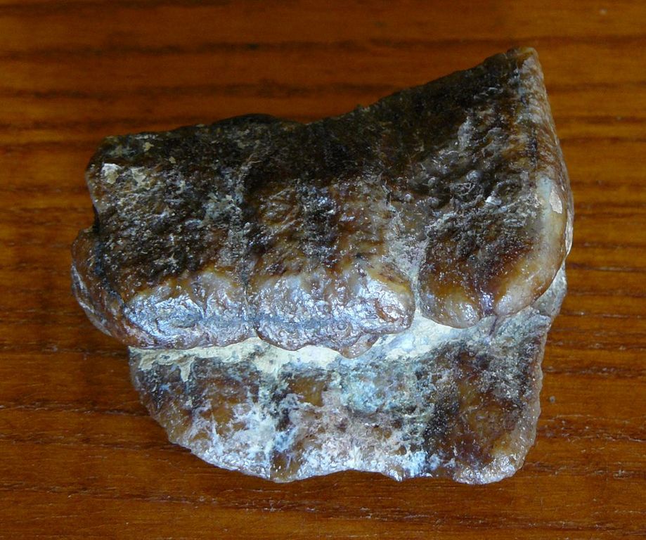

THE FOSSIL TEETH I SAW BEING USED IN BALI AND ELSEWHERE WERE SAID TO HAVE COME FROM JAVA. IT WAS MORE STABLE THAN TEETH I HAVE SEEN COMMING FROM MANY OTHER LOCATIONS. THE ONE FROM JAVA WAS THE TOOTH OF A STEGODON A TYPE OF MASTODON. MAMMOTH, MASTODON AND EXTINCT ELEPHANT FOSSILS ARE WIDESPREAD I EVEN FIND THEM HERE WHERE I LIVE. THE TUSKS AND TEETH HERE ARE BRITTLE AND NOT SUITABLE FOR MUCH. THE ENAMEL ON THE TEETH COULD BE USED FOR TAILSMAN OR JEWLRY BUT NOT FOR A KERIS HANDLE.
PICTURE OF PARTIAL SKULL OF STEGODON TRIGONOCEPHALUS
AND 3 PICTURES OF A SINGLE STEGODON TOOTH FROM JAVA MEASURES 10.5 X 5.5 X 3 INCHES. ITS THE KIND I SAW BEING CARVED IN BALI.

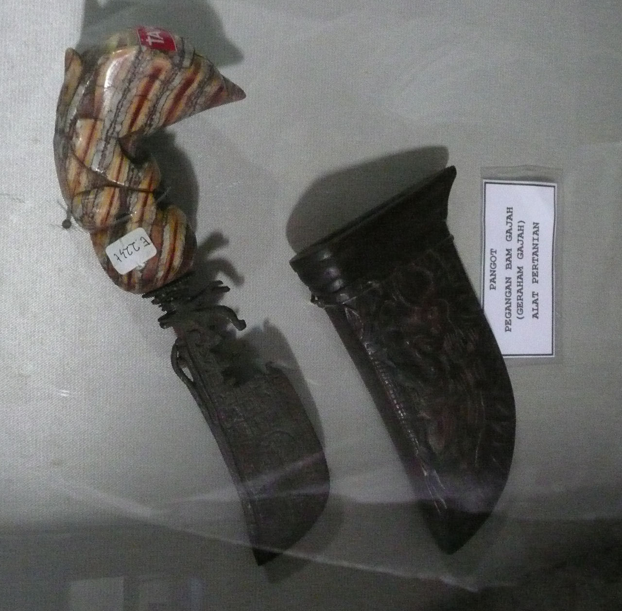

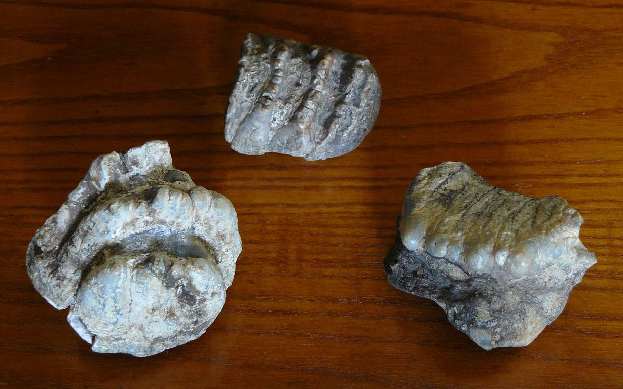

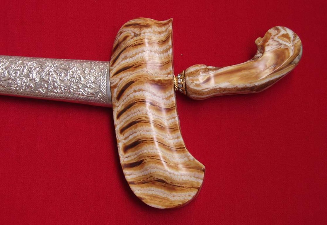

I attach pictures of fossil teeth which I got in Sangiran (near Solo) some 15 years ago, they are too small for making a hilt and may not come from a mammoth at all. I think that this site was extensively excavated and is highly controlled so I doubt that fossil teeth are still available from this location and used for making artefacts, but it was probably the case in the past.
I attach a picture of a Jogja kris in my collection with the hilt & waranga made from elephant molar (from Sumatra?), I bought it 5 years ago and the materials is still strong, as I said I think that it may not be that old so the organic binder in the tooth is still present and avoids it to be too brittle.

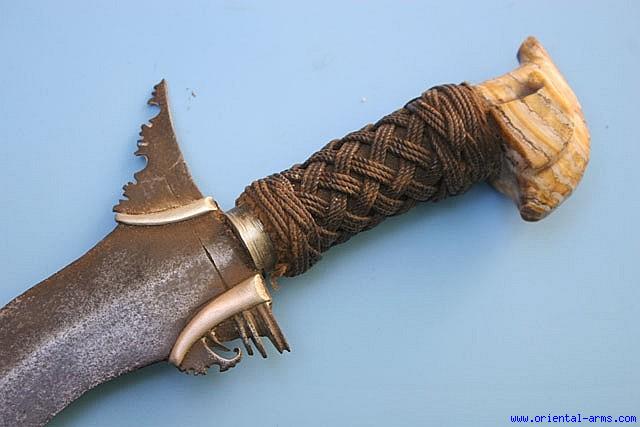

THE 3 KERIS PICTURED ARE RECENT BUT I HAVE SEEN A FEW EXAMPLES IN OLD POSTS ON THE FORUM THAT SEEMED TO HAVE MORE AGE. I HAVE SEEN IT USED ON SOME PHILIPPINE WEAPONS AS WELL BUT IT IS MORE RARE. SO I WOULDN'T JUMP TO THE CONCLUSION THAT ALL ARE RECENTLY MADE.
THESE STEGODON FOSSILS WOULD BE AT LEAST 11 THOUSAND YEARS OLD AND MOST LIKELY OLDER AS THE MAMOTH AND MASTADON BECAME EXTINT AROUND THEN.
I CAN'T IDENTIFY THE MATERIAL IN THE FIRST PICTURE BUT THE MATERIAL USED ON THE KERIS AND THE 3 FRAGMENTS APPEAR TO BE FROM THE SPECIES OF STEGODON FOUND IN JAVA. THERE HAS BEEN INTREST IN FOSSIL TEETH SINCE ANCIENT TIMES SO IT IS VERY LIKELY TO HAVE BEEN USED. SUCH TEETH HAVE BEEN REFERRED TO AS DRAGONS TEETH AND MAGICAL POWERS ATTRIBUTED TO THEM AND HAVE BEEN USED IN MEDICINE AND AS TAILSMAN FOR A VERY LONG TIME.
SO USE ON ANCIENT WEAPONS IS A POSSIBILITY WHERE STABLE MATERIAL COULD BE FOUND. I COULD ONLY FIND ONE PICTURE OF A MORO SWORD USING IT AS A POMMEL.

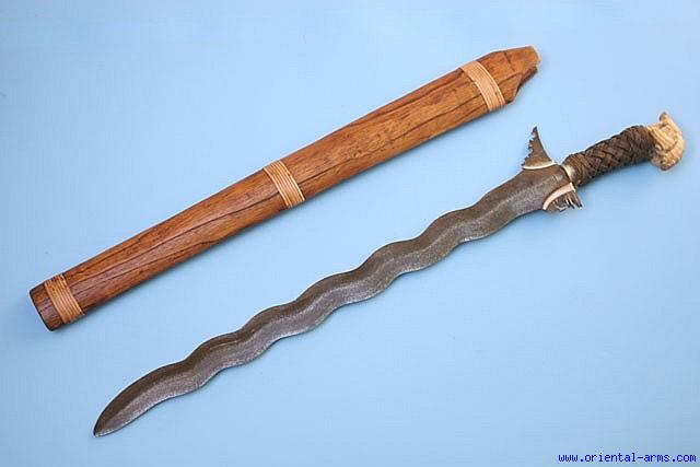

As I wrote once before in a similar thread, there is a Sumatran, possibly Minang Keris in the Moser-Charlottenfels collection, which has a huge showy molar hilt. It was collected before 1886. By huge I mean, it has a size, which don't allow to use it practically, like some balinese Bebondolan, often with Kendhit. The provenance of this Keris is absolutely sure.
There is another, very similar Keris in Amsterdam (or Leiden).
Sorry David, yet I am not sure if I understand the general sense of your lengty and somehow light-minded sentence:
"Somebody will now probably post some old keris hilt that they have provenance on for late 19th century or something, but when you say "rare use" i would have to agree that old examples of this material in keris dress is indeed rare and i would say that yes, that would explain why there is no lore to be found that is attached to it because most probably none exists."
I am confident, you are able to understand that old museum collections are OFTEN an invaluable help to pin down an object in a time-period.
Now to the material. I am absolutely not wondering myself about the fact, people in Central Java now or decades ago werent informed, what was going on somewhere in Sumatran highlands around 1880 regarding local beliefs on this strange and impractical, and rare material. I would say, they most probably didn't have the slightest interest in a thing, which were light years off from the refined esthetics of javanese courts.
It is known, that different wood species used for Keris hilts have different amount and kind of spiritual power in Malay beliefs. The same can be said about different sorts of iron.
It is obvious that a hilt made from a quite special material in a size, which don't allow to use it practically, has a power, which is beyound the practical use. Back in those days people wouldn't pick up a piece of rubbish, drill a hole in it and fit it on a Pesi. And if they would do it, they surely would find a "lore" about it.
Which sources do we have regarding Sumatran Minang beliefs from 1880-ties about minerals? Or - about Keris?
If there are no awailable, it is still quite reckless to say, there were no such beliefs, even more when lacking the available information about the physical objects from this time.
As students of Keris we most of the time are living with awareness of fact, that the most part of beliefs/information about Keris from its beginnings on are gone forever. What we know, is much less then the visible part of an iceberg.

Hi! everyone
the mollar handle from the Radya Pustaka Museum in Solo, Jawa, Alan was talking about.
