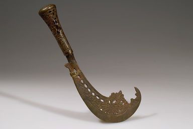

I could be on a flight of fantasy. I need lots of serious thought and comments on this piece.
I bought this on the idea it was quite a bit larger and a Dahomey/Benin ceremonial sabre. However when it arrived covered in old yellowed varnish, always a good sign to me, the size of the blade is 23cm long and the handle 22cm long. The wood of the handle seems certainly African as do many aspects to the blade which is still very sharp and the decoration. I am thinking we could be looking at a candidate for a Benin Amazon razor weapon. There is mention that they were a folding artifact. This could be that in casual observation this does indeed resemble a giant cut throat razor and outsiders may just have assumed that it folded. Why is it that such a often mentioned weapon does not appear in books on African art or weapons?
Am I unbelievably lucky?
I have some doubts but they are still smothered by my high hopes . I will post a series of pictures that will explain all. If you think you know anything valid please do not hold back. Next stop could be the BM. Or just hide under the duvet.

You can see my thinking here. The construction is fairly universal. the similarity may well be just that.
You can see that that the item in question has two rivets {the first rivet in the steel above the copper is clearly visible on the over side} like the Asian knife. The item in question also has a rivet through the copper part at the handle end.
The African stylistic similarities,
I could add more pictures if needed but I think you can get the idea? I need input on this. Thanks. Could it be seek and ye shall find?

Hi Tim,
interesting item.......I must admit that my first impression is Asian. Is it possible that it could be a pole arm ( ceremonial or functional) that has been shortened ?
When I researched the African short sword I acquired awhile ago ( it seemed likely Dahomney or neighbouring tribes.) I tried to discover common weapon forms of the area, I didn't find any reference to a weapon such as yours. I did read of references to a 'razor' but, from memory, I had the impression that this was a 'simple' blade which folded into a handle. (Sorry no pics) I'll try and find the description with the reference source.

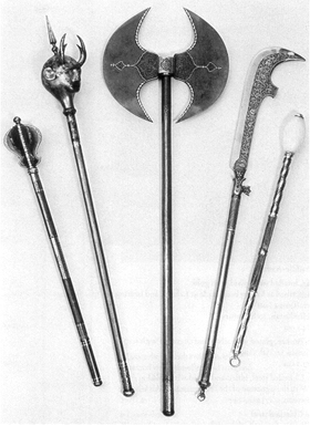

Stone shows a knife called a Bhuj Kutti, sometimes called an 'elephant knife' described as a heavy (?) single edged knife blade mounted inline with a single straight handle approx 20" long (not specified if OAL or just length of handle). The blade form illustrated is not the same, but there are similarities in the overall construction. I do not have a scanner so cant post the picture;
It is possible that yours is a varient, your pictures suggest that the knife is vintage rather than older, is this the case?

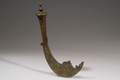

Hello Tim,
An old thread that I have just come across. Does this look familiar ?
22 inches long with an 11 inch blade.
Steel and dark wood.
I cannot make anything of the mark, even under high magnification I cannot even tell the type of script.
Nice though

Does anyone else see any similarity with these?
Spiral
linky
Old 4th November 2014, 04:45 PM   #15
Posts: 6,027
Yes. To me there is nothing African about them. The work especially the bolster looks North India to Nepal.?
