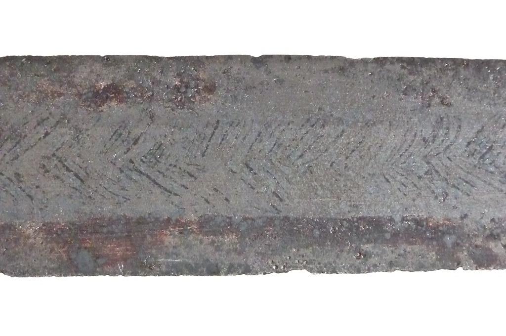

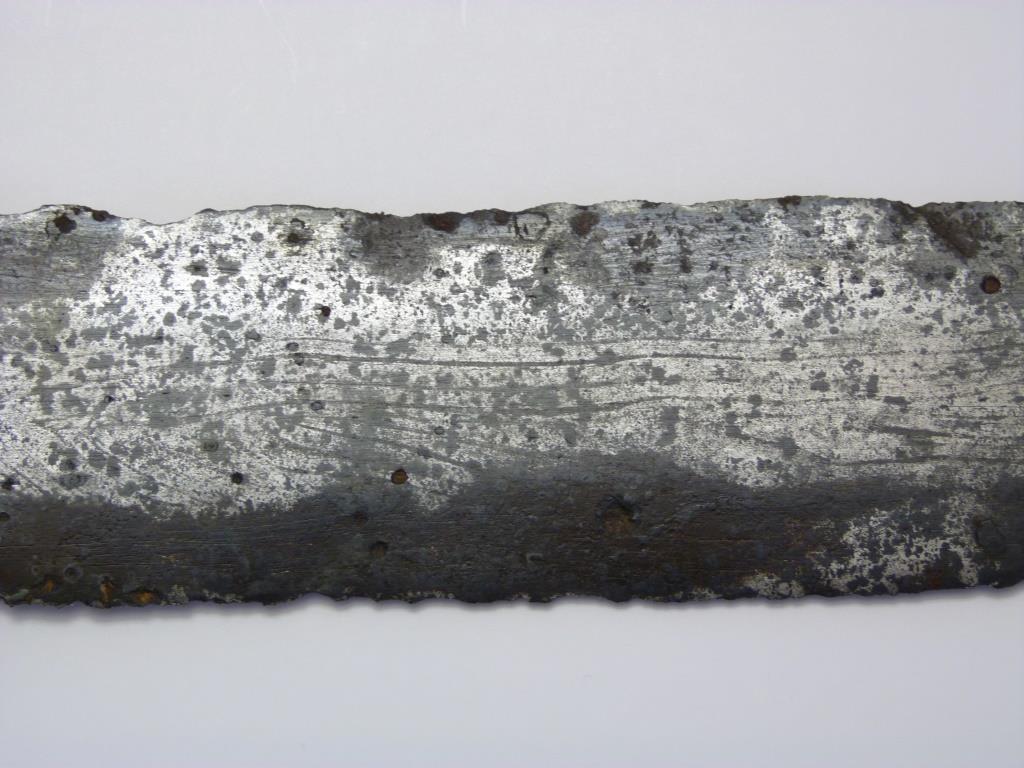

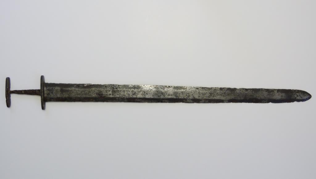

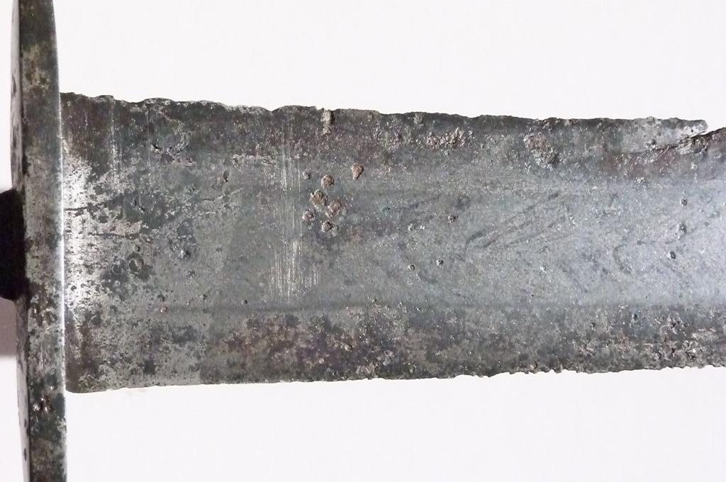

Default Help on Dating and finding informations on a early medieval pattern welded sword
This sword has been dated by the auction house as 9th or 10th Century. My first impression was that this blade could date from the 5th to 6th Century. So I hope to find further information’s (possible dating, origin, etc.) and pictures of similar swords to compare.
The blade shows signs of two twisted rods in the upper two third of the blade center, changing into straight lines towards the point.
Richard Rechsteiner

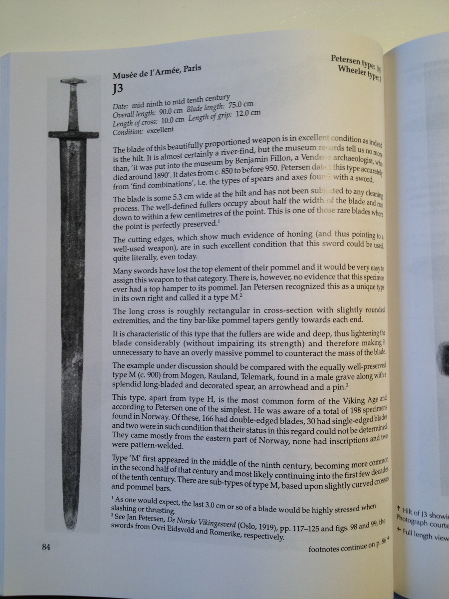

very strange that no one responds to this thread on a forum that addresses vikingsword.com !!!
I'm more at home in Swords between 1000-1600, but I will make an attempt.
the sword is of Petersen type M and wheeler type I.
this type can be dated between the middle of the ninth century and the middle of the tenth century.
it is after Petersen type H the most common sword type of the Viking Age.
The origin is probably eastern norway, here are most specimens recorded found.
Petersen describes that 198 specimens have been found in Norway, only 2 of them were pattern welded. CF swords of the viking age page 84.
so your sword is rare.
The blade corresponds to Geibig's classification type 1. (Chronology and principal styles of double-edged sword blades of the Viking age.)
and corresponds to the period of sword, the ninth century, I do not expect the blade to be much older, but it can be.
about the authenticity of this sword unfortunately I can not say anything meaningful based on the pictures alone.
hope it helps.

Hello Jasper,
Thank you for your information’s. The authenticity of the sword was confirmed by the expert for arms and armour of the auction house.
More information's on the sword:
Overall length: 87.4cm
Blade length: 76.6cm
Lower guard (crossguard) length: 10cm
Upper guard length: 8.5cm
Blade width under lower guard: 5.5cm
No fuller!

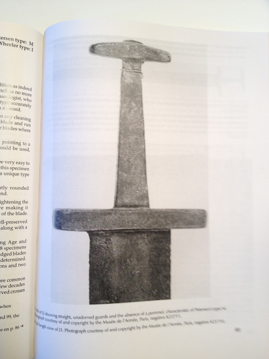

Unfortunately I don’t have Petersen Publication on Viking swords. Could you send me a copy of Page 84 where I could see the same type of swords?

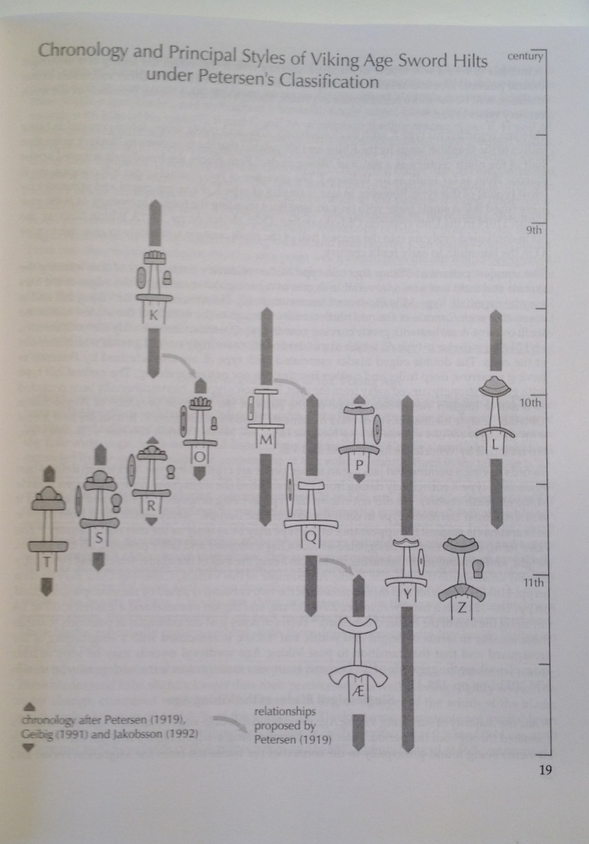

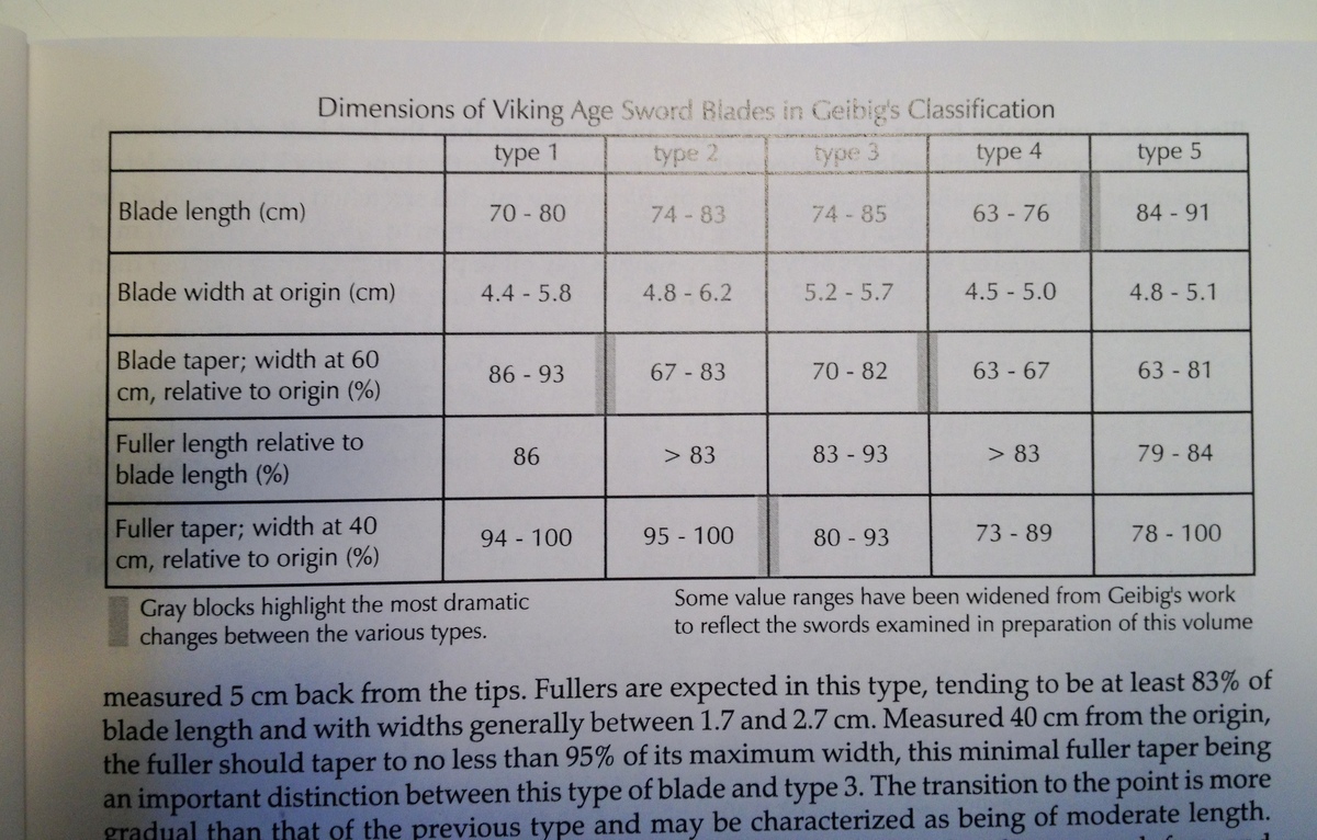

Thanks for the dimensions.
the parallel blade without fuller of length 76 cm is indeed under geibig type 1.
f/m the sword looks very good and patterns are almost impossible to forge, but also an expert of auction house can only say something definitive about a Viking sword with a metalurgic report in hand.
attached pages from Ian Peirce. swords of the Viking age.

Hello Jasper,
Thank you for your help, the attached Pictures and graphics.
Richard
