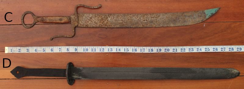

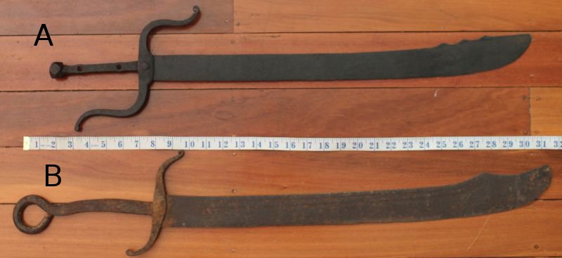

The most common are:
(a) Tang through grip and peened at end of pommel, often with a hole through grip or tang which might have a rivet/pin or tubular rivet through it (or just a lanyard, but note that a tubular rivet allows a lanyard), or
(b) A wider tang with two grip slabs rivetted to it. Often with ring pommel, but sometimes no pommel, or a butt plate (with a little projection at the end of the tang peened over it), or the end of the tang is flared and the very end flattened into a butt plate, or
(c) Sometimes, with a ring pommel or pommel rivetted to a flared end of the tang, there are no rivet holes where the grip would be. Probably just grip made to fit between guard and pommel, and then cord or cloth wrapped; the pommel will stop it from coming off. The tang can be narrower than the grip, in which case the grip encloses the tang (basically, the same as Medieval European grip construction, except for the absence of a leather grip covering), but I've see one where the tang looked to be the full width of the grip.
Some examples (see pics):
A: Tang has rivet holes. Tang is narrow and fairly square. Looks like the (two piece) grip would have enclosed the tang, and been wrapped with cord.
B: No rivet holes in tang. Two piece grip would enclose tang, wrapped.
C: Grip slabs rivetted to tang (this is the single-slab sword noted above, but it would look the same from this side with two slabs). Maybe this grip would be wrapped too, but it's optional.
D: No rivet holes for grip, tang is wide. Two grip slabs, wrapped?
Modern construction varies a lot. A common good modern construction is that the end of the tang is threaded, and a large nut and washer hold the grip on, and a small nut holds the pommel on, and a rivet/pin goes through the grip and tang. Steps towards worse quality include one nut only at end of pommel, one nut at end of grip and pommel glued on, no rivet/pin through tang, threaded rod welded onto end of tang instead of the end of the tang itself being threaded, tangs too thin and/or narrow, and single piece drilled grip instead of two-piece grip properly fitted to the tang. This last defect is very common (but can be fixed by suitable use of epoxy or epoxy putty (or by making a new grip)).
I have one old ring-pommel dao with only one grip slab, and it looks like it only ever had one. Must be 1/2 of a pair-in-one-scabbard.
Usually, it isn't too hard to replace a guard with a new one (a plain mild steel one, for example). It also isn't too hard to make a plain steel guard - hacksaw, drill, files, and some time and effort. A cup guard could be cold-forged, if the steel isn't too thick.

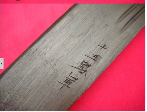

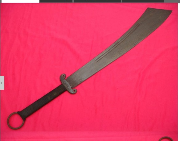

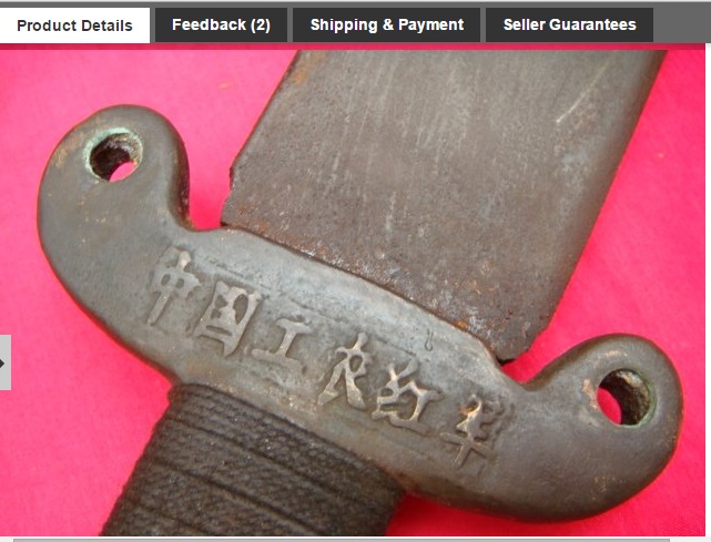

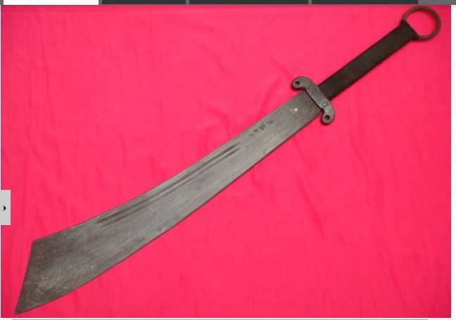

It just occurred to me to mention, the Dadao I have coming, and in the pic. is a 1937 dated Chinese Army piece, which is why the guard is somewhat "Industrial" in form. I am hoping it is the real deal, so I shall see what it is like when it arrives. See photo below for type of Dadao.

Posts: 422
Yours looks like the usual ebay fakes. Compare the guard with the ones in the picture of the Chinese troops (or, http://mandarinmansion.com/republican-dadao ). I've seen these both in cast brass and forged iron. While these "curled tip" guards aren't the only ones used (plenty of disc guards, some S-guards, some other guards), I've never seen one like the one on your incoming dadao on a known-to-be-genuine old dadao, but have seen plenty on known fakes.
(When you get it, can you post (or PM to me) some details of the blade thickness and cross-section. Basically, how much does the blade taper in thickness, and how close to a triangular wedge is the cross-section.)

I have my reservations as well, but at a price of a quarter that asked for a repro. I thought it worth a punt. I will post pics and details when I get it. More pics from the seller.
