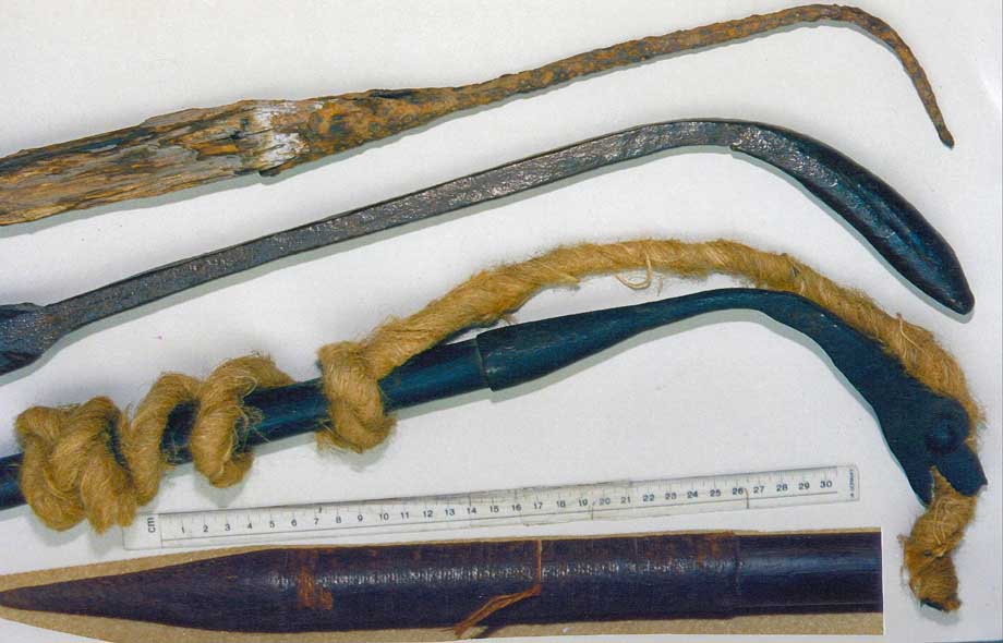

Hence forward, 15th century practical experience seems to have developped a reinforced pear like shape of the igniting head with a thin prick to it to reach down the touchhole; the larger mass of the iron was of course apt to keep the heat for longer. Due to the nature of their use - kept red hot for hours and hence calcined, then, after left rusting away for months, bearing the same procedure all over again and again - the actual touch prick of those igniting irons has in most cases gone of surviving examples.
Again, relying on illustrative sources, linstocks with jammed in glowing tinder or smoldering slow match do not seem to have seen wider use before ca. 1500 when they were depicted in the Maximilian arsenal books (Maximilianische Zeugbücher), ca. 1502-1507. Allthough match linstocks seem to have taken over for at least half a thousand centuries from now, we still know of some large samples of early 18th century heavy artillery accouterments retaining their original igniting irons mounted on long hafts and forming part of the equipment of their original carriages.
The singular short linstock, early to mid 16th c., with the two piece zoomorphic head retaining its original blackened haft together with its original tarred cord binding on the rearward grip plus a pointed iron shoe finial for ramming the piece into the ground on intermitted action, is also in my collection while most images of other igniting irons were gathered together from various sources.
