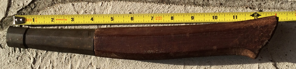

Late last week I happened to be browsing eBay soon after someone posted a basement relic sword for sale. It was reportedly brought back from The Philippines in the 1950's, mounted and hung on the wall by the seller's grandparents. The pictures were small and fuzzy but the distinctive shape of a panabas was there. I decided not to wait and took a gamble. The seller feels he got a really good deal for a rusty bit of metal, and I feel pretty good too!
The sword arrived today. Here are first pictures, before cleaning or rust removal.

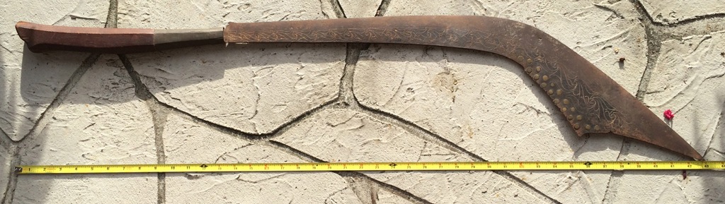

Overall length: 43 inches
Hilt length: 13 inches. Plain wood with metal (brass?) helping secure blade.
Blade width: 1 ¼ inches at hilt to 4 ¼ inches at widest
Blade thickness: ¼ inch tapering distally towards tip

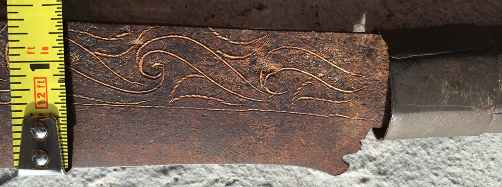

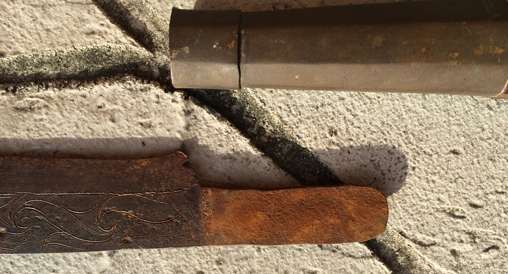

Blade is loose in hilt and easily removed; tang shows age

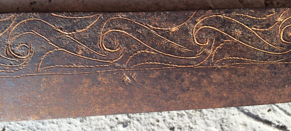

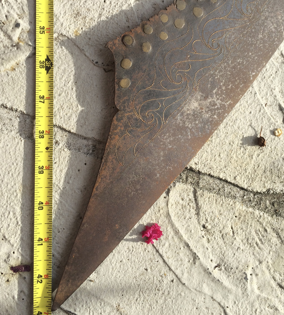

Decoration: Floral carving along entire back side of blade on both sides. Numerous metal plugs, intact. Serrated back edge near tip with small spike, concave clip point drop to tip. Overall angle shape.
Comments welcome, please. I can't recall seeing a panabas with a blade decorated in this way. Thoughts?

I think that it is a later piece, maybe middle of the last century what would confirm the given date of collecting. The older panabas swords has a different way to attach the blade to the handle, unusual to see a ferrule but frankly said I know not enough about panabas to be sure. Also the brass dots look a little bit weird. Will be interesting what the knowledge members will tell you about this panabas. Please post some pictures after you have given it some care and maybe have etched the blade.

I agree with Detlef. This style is seen post WWII, athough some earlier examples may have similar okir motifs. The hilt also looks shorter than most panabas. The "crooked kampilan" shape of the blade combined with this style of decoration all point to mid- to late-20th C. These recent pieces tend to have thin blades, being much less robust than earlier forms, and were often intended to be decorative pieces.
