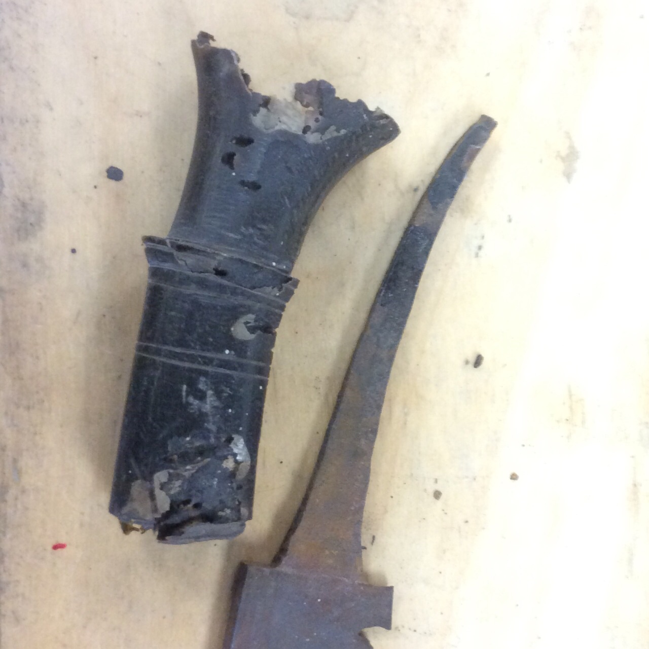

This kukri was brought back from the China-Burma-India theater by a friend of mine's uncle after WWII.
The veteran recently died and this was found in a trunk in his garage.
The grip is too far gone to try to fix, so, I proposed to him that I carve a new one out of water buffalo horn, which is what the original appears to be made of.
I thought I had some of this horn stashed away, but I can't find it!
Are there any sources out there where I can find some? Or, if any forumites out there may have a piece they would be willing to sell, I, and my friend who owns
it, would be appreciative!
In a perfect world, a piece that is solid, 5" by 2" by 1" is the ideal! Those dimensions, but hollow would work.
Please PM if you can help.

looks like a nice blade. any markings?
grips were also made from hardwood, so wood, er, would also be traditional.
there may at some point also have been a brass or steel bolster and a butt plate with the end of the tang protruding a bit & peened over a keeper. the hole down the centre was also traditionally filled with 'laha', a nepali cutler's thermal cement made from tree resin and dung, brick dust, etc. (there's a thread here on recipes for it & less smelly equivalents)
whatever you do, do not grind off the rust or use acid, naval jelly or similar agressive chemicals to derust.
use the search function here for info on khukuris, rust removal, restoration tips, etc. there are also a number of threads on identifying your model, showing the grip details of each so you can be more accurate.

Thanks for your suggestions!
I have been a blade restorer (and other antique metals) professionally for over thirty years, so I know about naval jelly, grinding, etc.
I have the bolster and pommel cap as well as a number of small bits that I will incorporate back I to the project.
I plan to show pictures when I'm finished.

Interesting project, always good to give a kukri another lease of life!
If untreated that horn is likely to be riddled with dermistid larvae that will infect any other horn,wool or fur product they come into contct with..
A week at -17C in the freezer insures all eggs & larvae are killed.

Thanks for the suggestions
The kukri was frozen for about eight weeks before I would even touch it!
The original is only around to use as a pattern.
